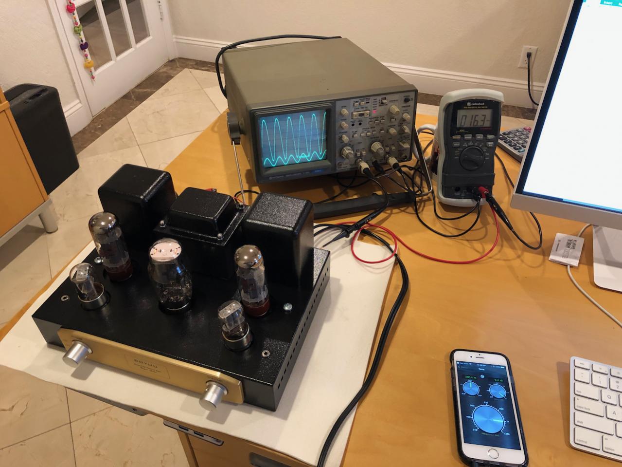

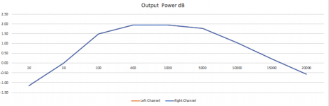

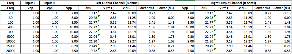

I did a frequency response test in my A9 tube amp with the original components that came in the kit. The idea is to see how the performance of my amp as it comes from china in the kit.

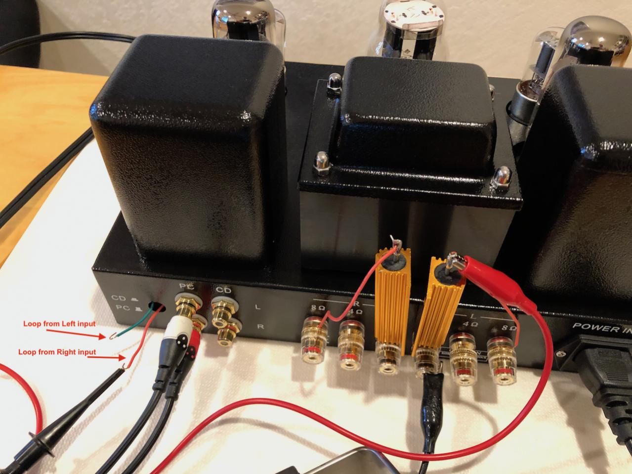

This is what I used for the test: Boyuu A9 tube amp (no modifications except the heater resistors to remove hum) 2x 8 ohms 100W resistors as loads. Hitachi V660 oscilloscope. Iphone with tone signal generator app (I know it’s a Pro tone generator but is the only one I had and, to be honest the wave form is pretty good. The problem is that is hard to set the exact frequency to “.00) Multimeter to measure dBm (I found out the meter does not respond well for low and high frequencies so I stopped using it)
Setup: I put the 8 ohm resistors as load instead of the speakers so I wouldn’t drive my neighbor’s dog crazy with high frequencies �� I set the signal generator to the test frequency and set signal level to 1Vpp, I made the measurements and wrote the results in the Excel. I repeated this to all frequencies making sure to check the input signal level was always at 1 Vpp I used Channel A of the oscilloscope to measure the output signal and Channel B to measure the input signal. Note: In all pictures Ch B (input) is always the wave signal closest to the bottom of the screen) All measurements were made using the oscilloscope. I started using the multimeter to measure dBm but I gave up because it did not respond well for low and high frequencies, so the dBm had to be calculated from Vpp.

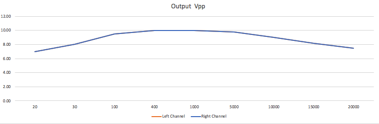

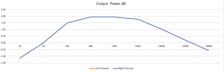

Frequency response Results:.
See the results in the Excel table.
I measured the Vpp of output and I used the formulas to calculate the Vrms, dBu, V dBu, Power rms and Power dBu. Feel free to double check my calculations.
I plotted the results in a graphic using Excel chart function. Sorry the graphics are not log but I don’t know how to do a graphic in log it in Excel and I ran out of time.
As you can see the frequency response is bad below 400Hz and above 5Khz so I definitely will have to do some mods to get a good frequency response.

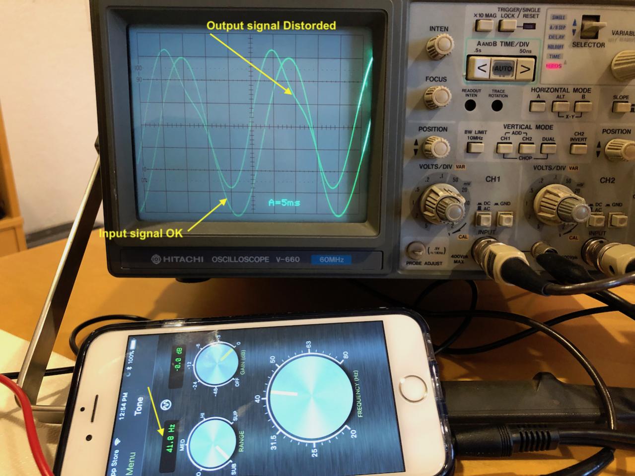

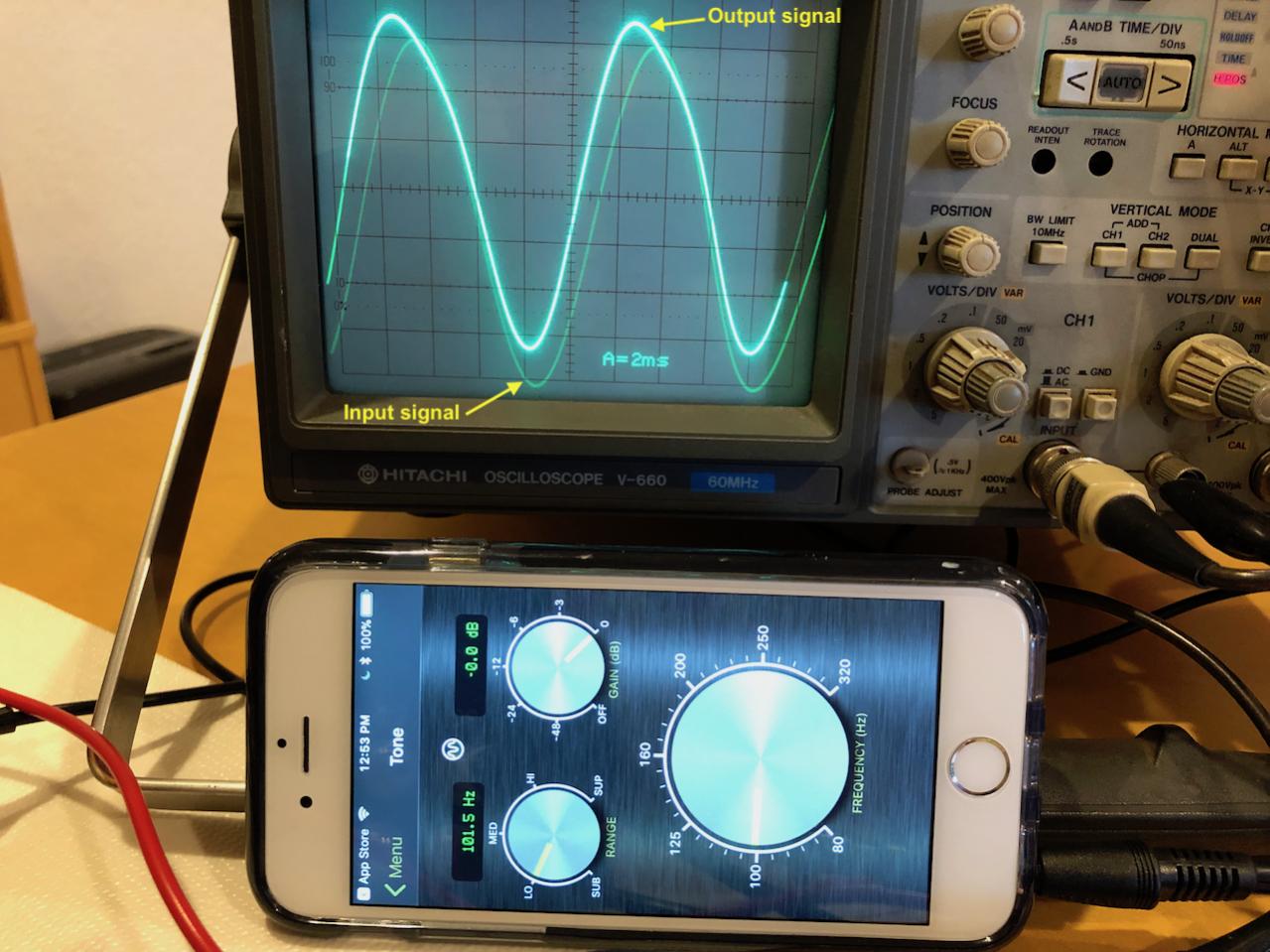

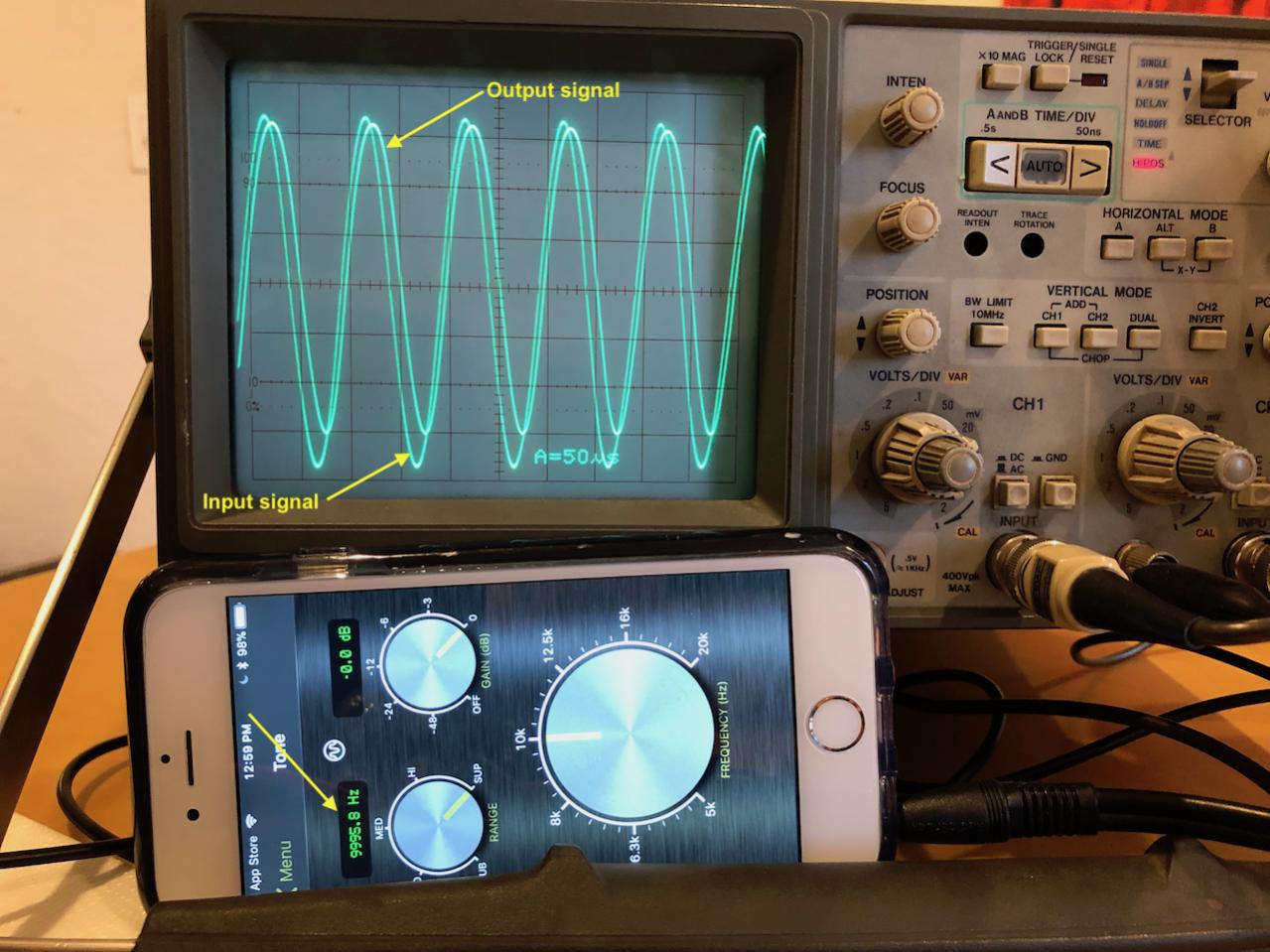

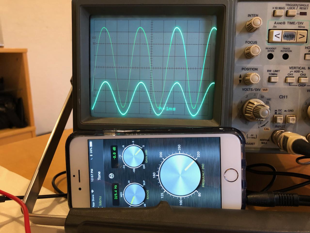

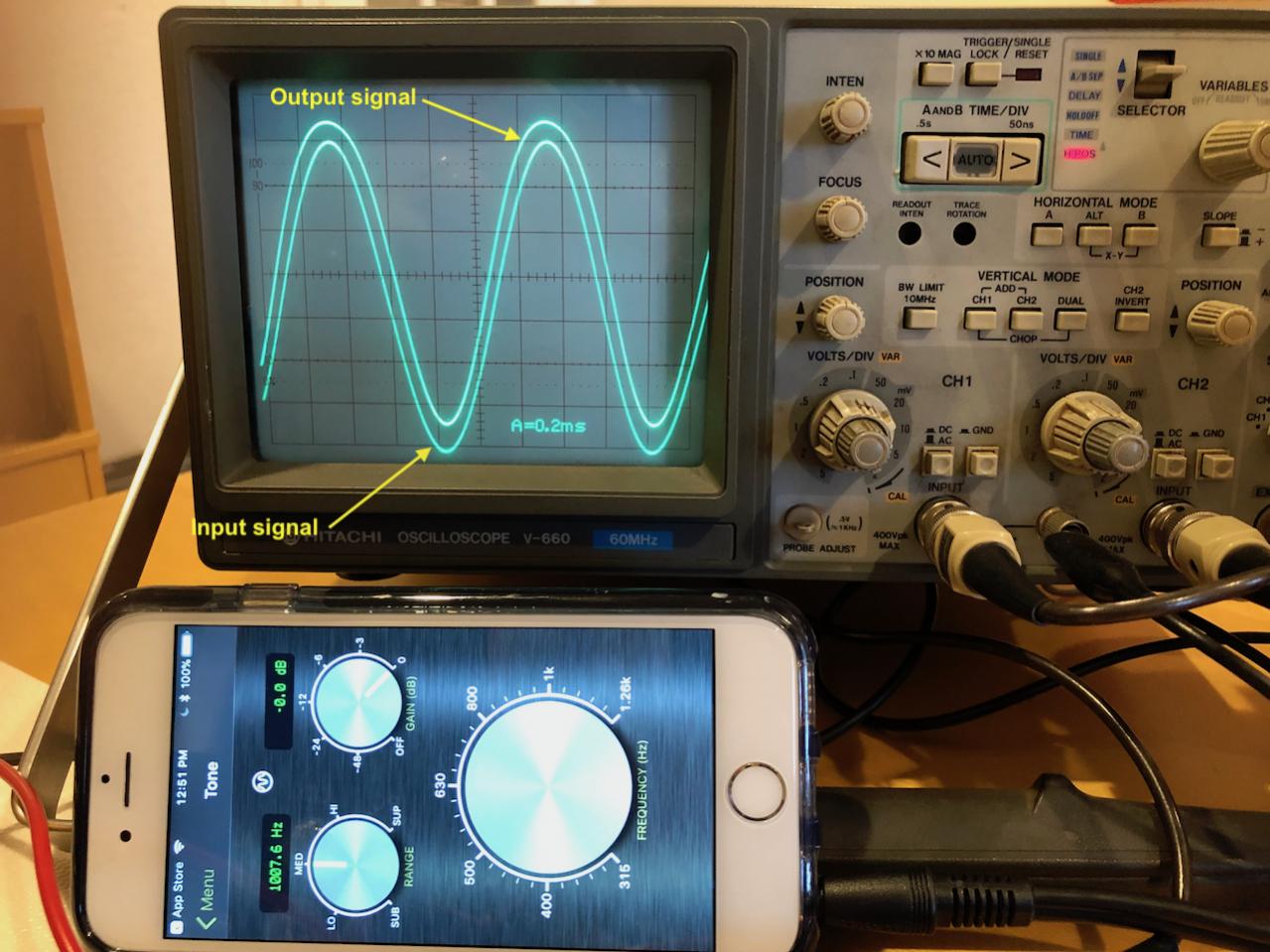

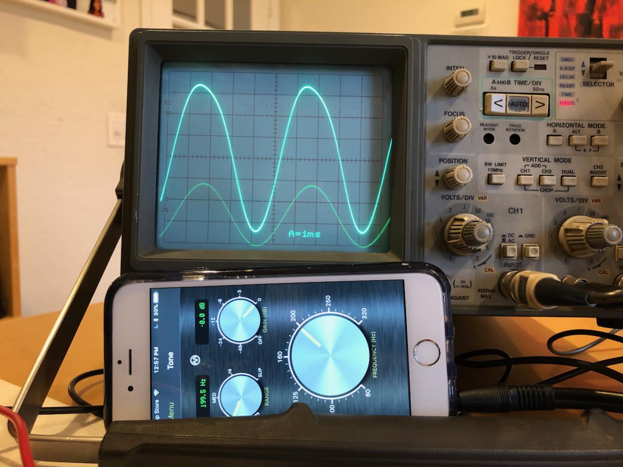

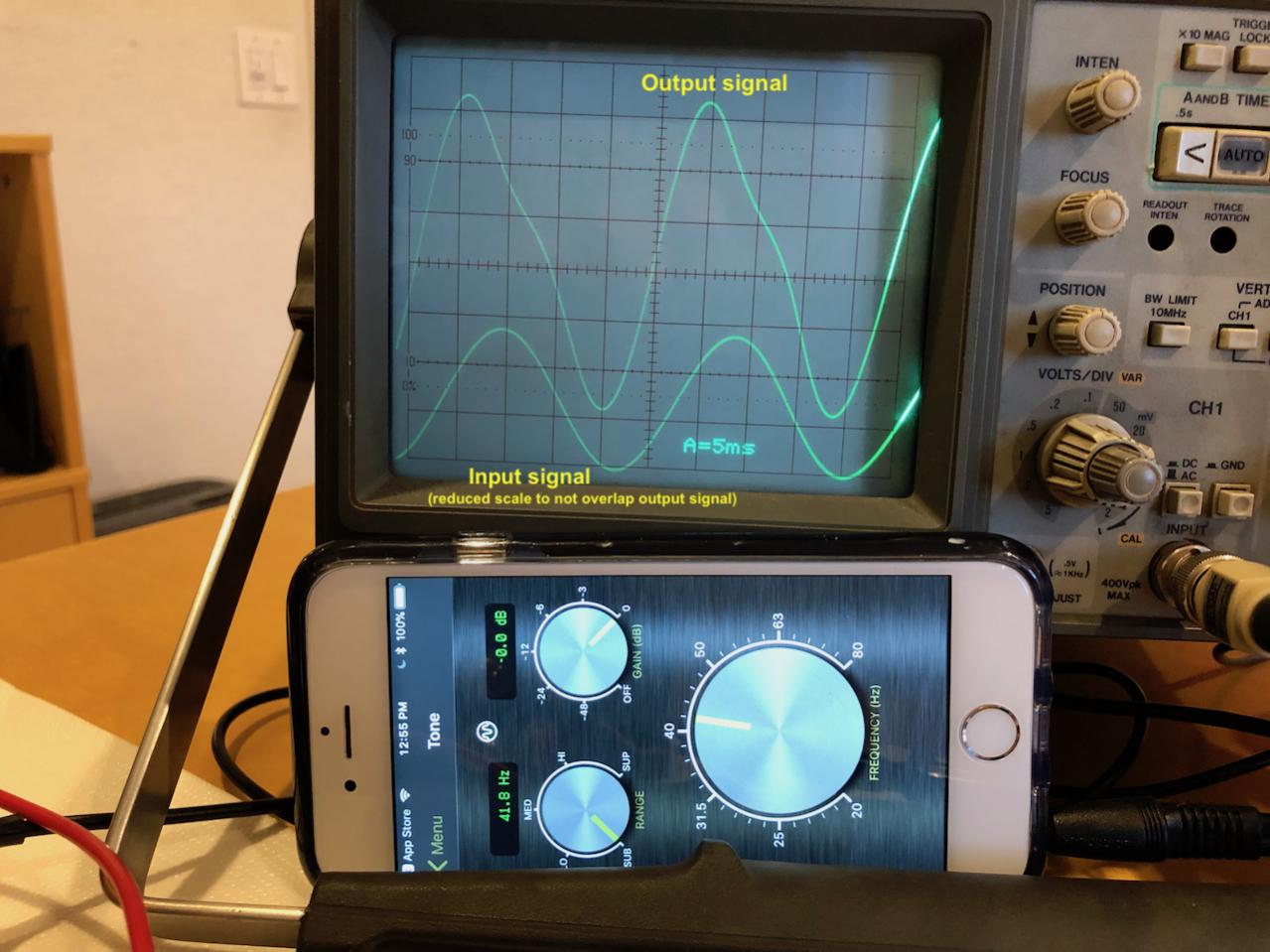

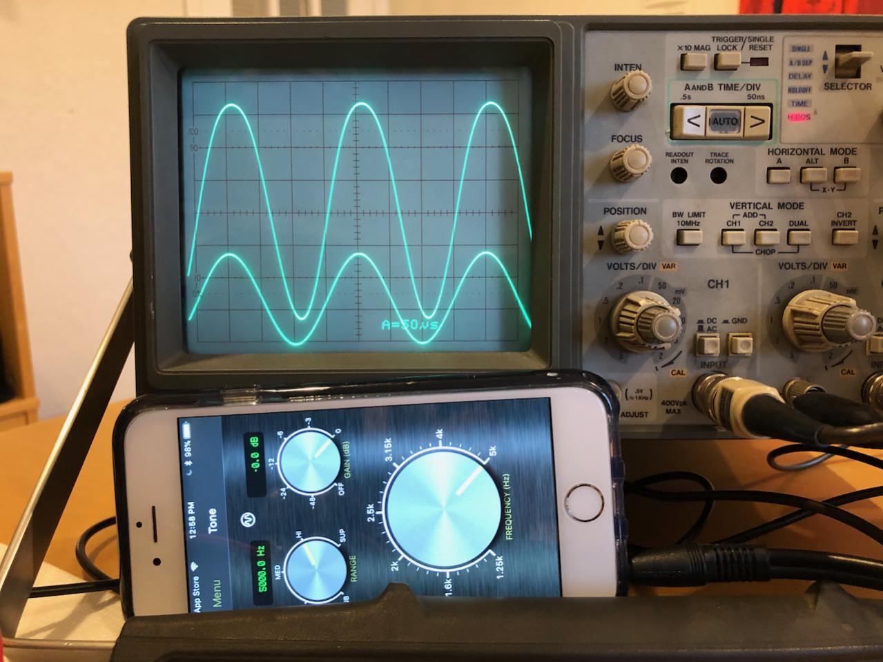

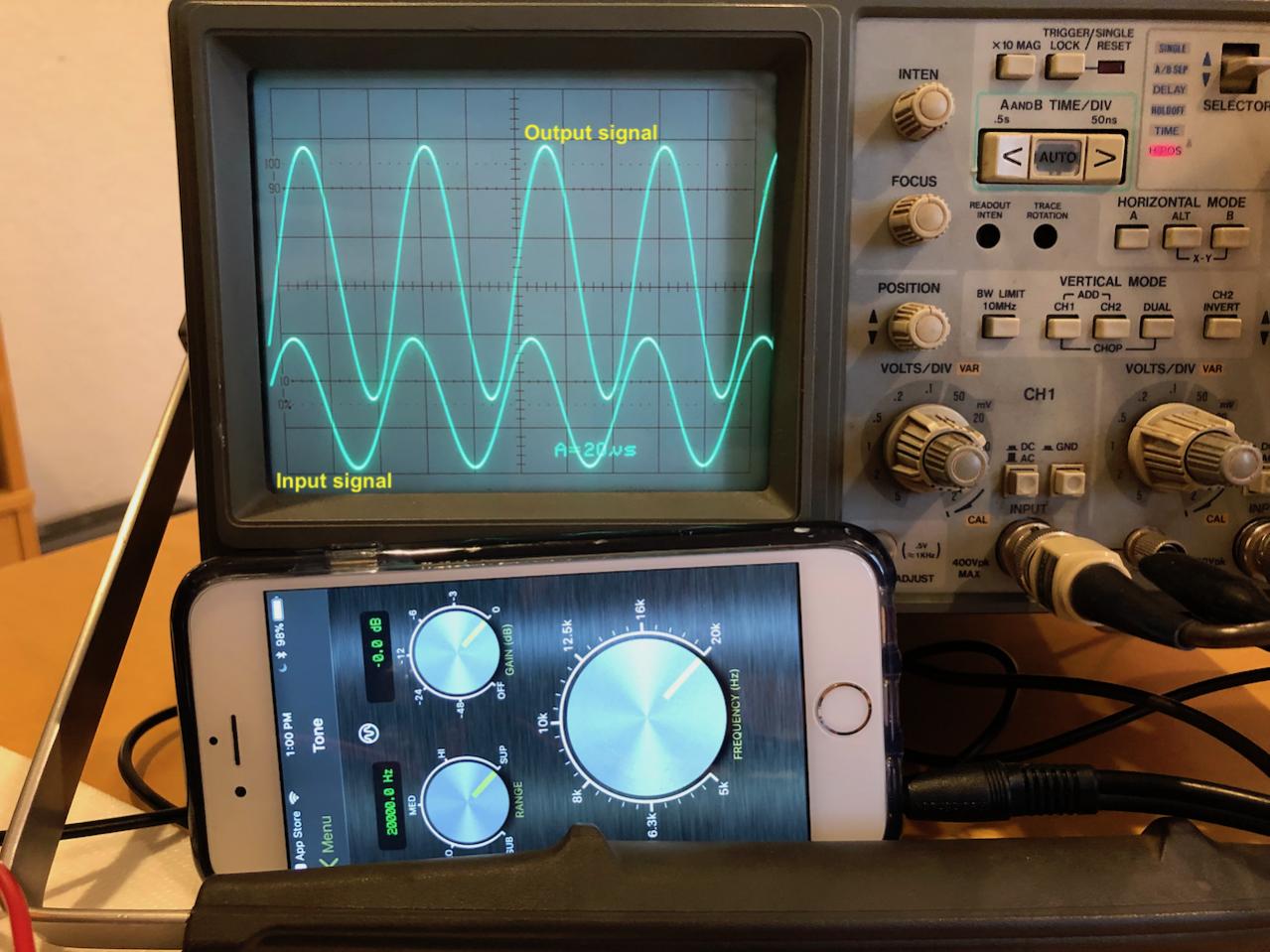

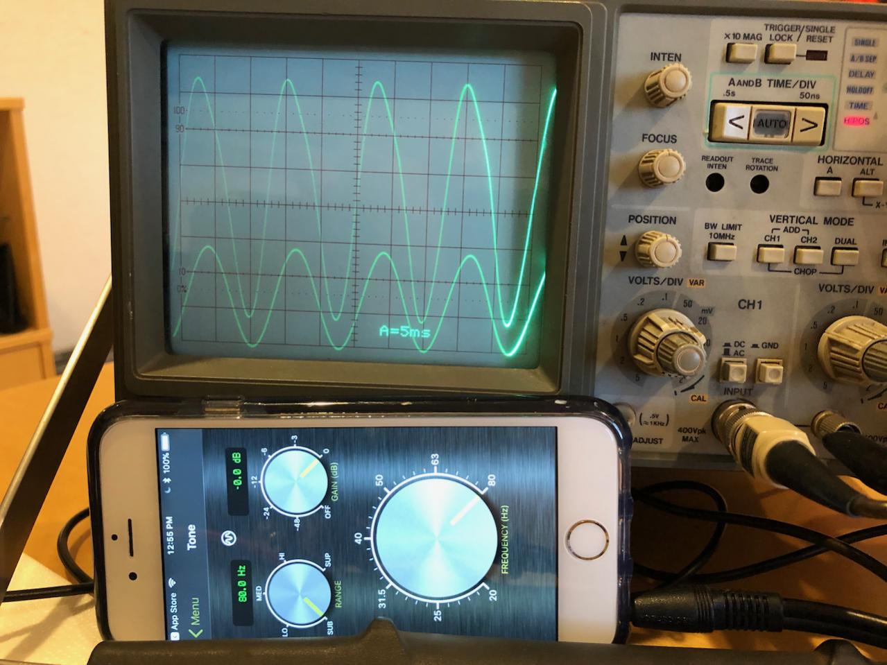

Here are the results for the Distortions test:
Please the pictures.
Note: you will see in some pictures I’ve overlapped the input and output signals so it’s easier to compare the two signals and detect distortions. And in some pictures I reduce the scale on the input to not overlap them. But independently on the scale showing on screen, the input signal was always 1Vpp.
There is a distortion on the output signal for frequencies bellow 300Hz and it gets worse at 40Hz and bellow.
There are no distortions above 400Hz, even in high frequency like 20KHz the signal is clean.
I hope this information is useful to you guys and please send me suggestions of mods to improve the frequency response.
Cheers

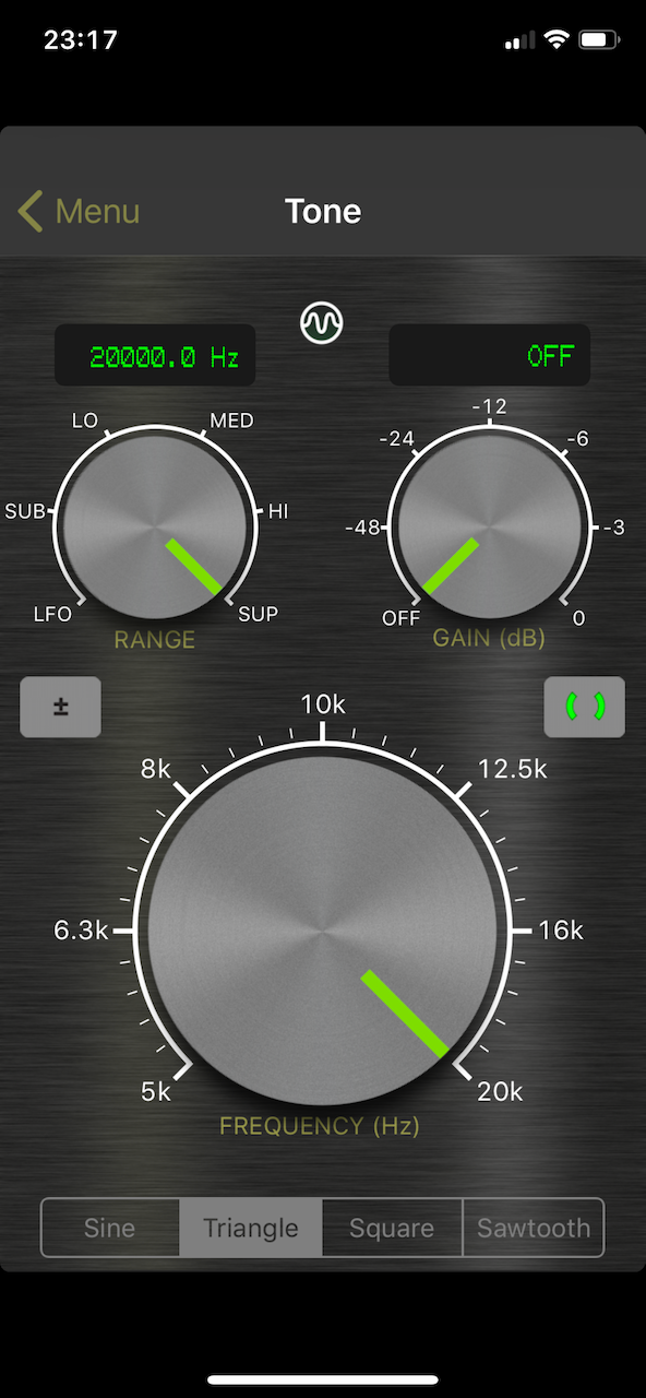

Very interesting; thanks.Here are the results for the Distortions test:

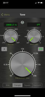

Can your phone app generate square waves?
BTW, I'm assuming you checked/adjusted the compensation on your probes by hooking them to the 'Cal' on the front of the scope.
Hi VictoryGuy,
Yes, the app can do square, triangle and sawtooth waves. The app is called SIGNAL GENERATOR and is free on the App Store.
And yes, the problem were calibrated

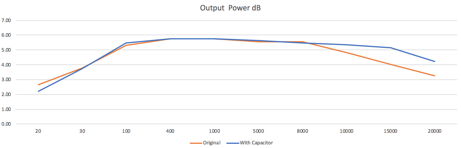

I did my first mod to the amp and added the capacitors as suggested in post#126.
I did not have a 470uF capacitor so I used a 330uF capacitor I had and I did see some improvements in high frequencies. I think the amp will have a much better high frequencies response with a 470UF capacitor when I get it.
The picture show a comparison between original and with a 330uF capacitor
@Gregas, I played a The Who vinyl album using an 1980's analog pre-amp connected to the A9 and it sounds OK but it definitely needs more high frequencies
