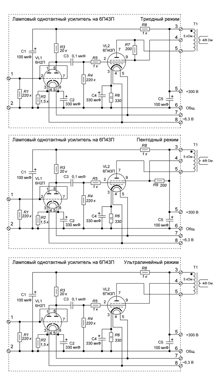

There are lots of options for UL...
Here are some other EL34 SE circuits using ultralinear output transformer taps:
EL34 SE ultralinear schematic

I don't know if there's really a big difference in performance or output power between using an ultralinear transformer tap and just connecting the screen via a resistor.
It would be interesting to know the difference in the sound of the A9 in the triode, pentode and ultraline modeI don't know if there's really a big difference in performance or output power between using an ultralinear transformer tap and just connecting the screen via a resistor.

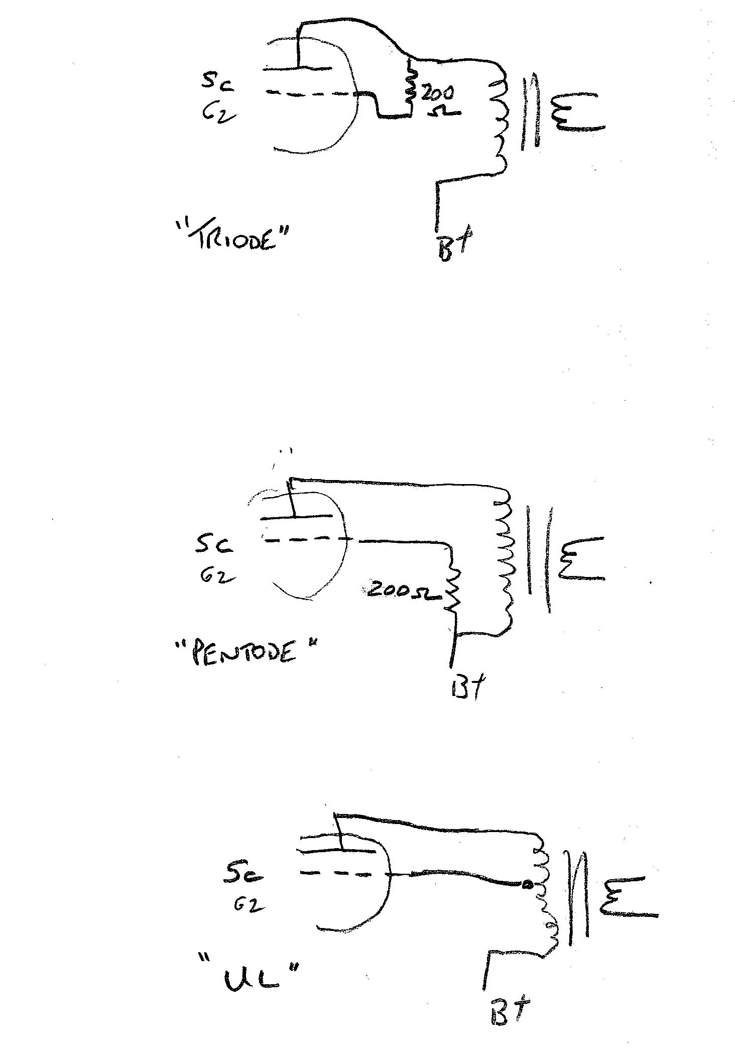

Thanks for those schematics.
I re-drew with a quick sketch - is this correct?

Yes, that does help, thanks.
By 'separate' screen voltage, how 'separate'?
Independent HV secondary winding all the way back at the power transformer, or tapped off the B+ circuit at some point?
Pentode mode:
Be sure to use a well filtered point in the B+ in the multi RC string of the power supplies. Just as you would use extra filtering for a line amp tube or a driver tube than you would for the output tube.
Screens generally like a fairly stiff voltage source.
A. Simple R from B+, and an R to ground. May want to add a bypass capacitor.
Gas regulator tubes are simple, have a plate and a cathode (no filament).
B. Simple R from B+, and one or more Gas regulator tubes in series to ground. Do not use a cap across the regulator tubes.
C. Simple R from B+, and a Gas regulator tubes in series with one or more zener(s) to ground. Do not use a cap across the series string of the zener(s) and regulator tube.
