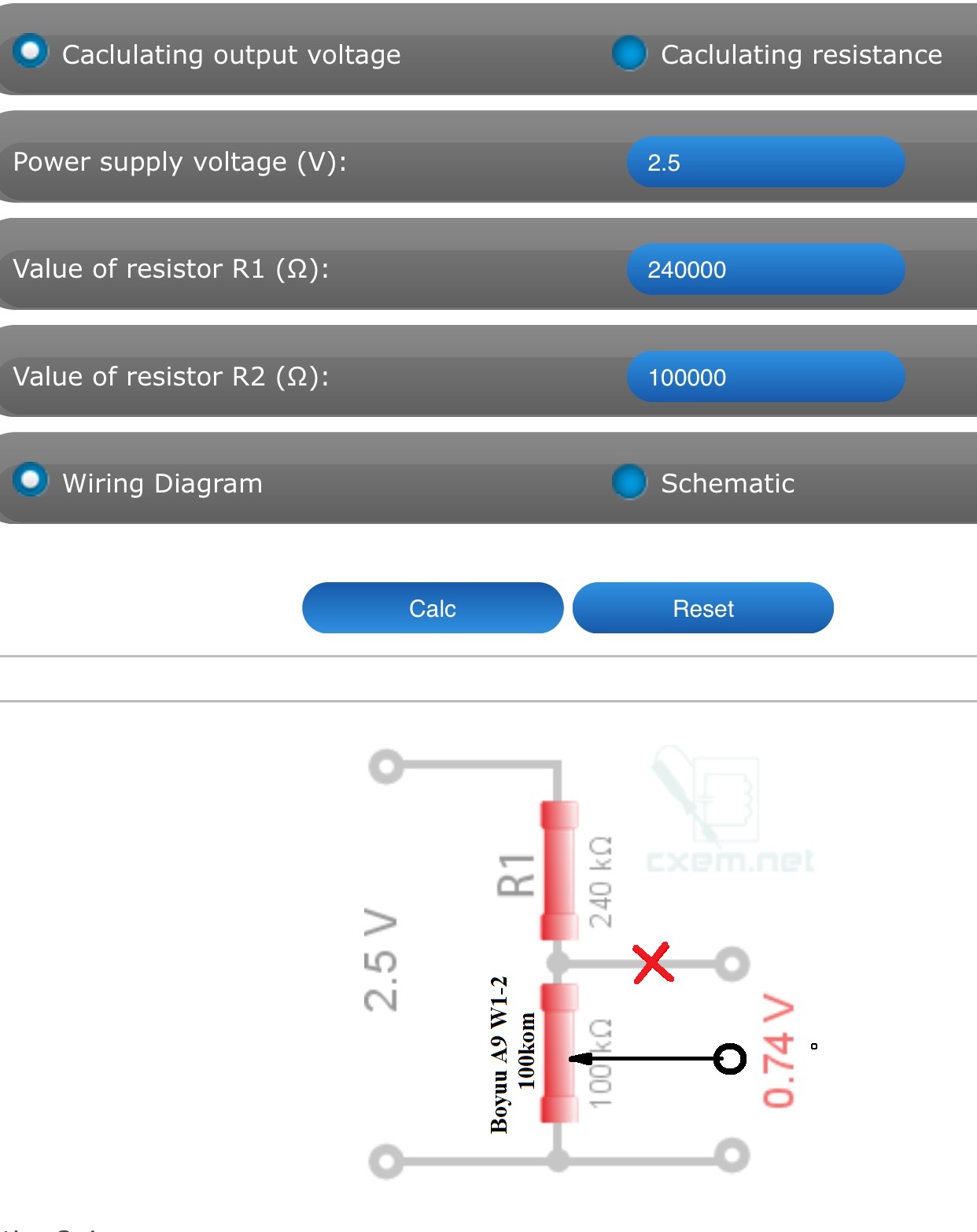

you will find divider calculators on the internet, it's simple to use, you just need to know your input voltage and what you want output, example:You found changing cap 102 and 202 gave you improvements?
Can you further explain the voltage divider calculator. I don't get it.
input voltage 2v =
0.750v output voltage
resistance 1 (signal) -10k
resistance 2 (grounded) 6k
A voltage divider is needed to match the signal level from the source to the amplifier.
Suppose your CD player or DAC outputs a 2v signal to the RCA, the amplifier has an input of 750 mv, for good operation, you need to equalize the values, a voltage divider is used for this.
You enter the necessary parameters into the calculator; it shows which resistors to use.

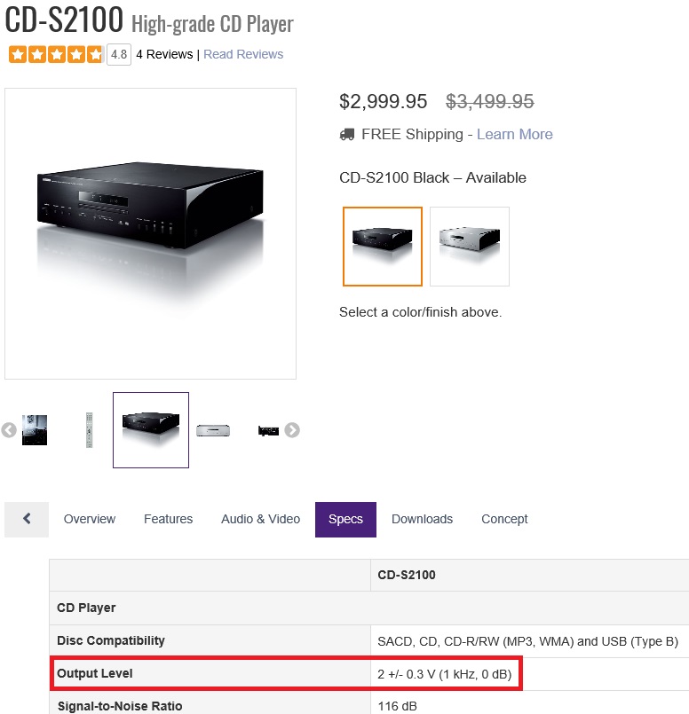

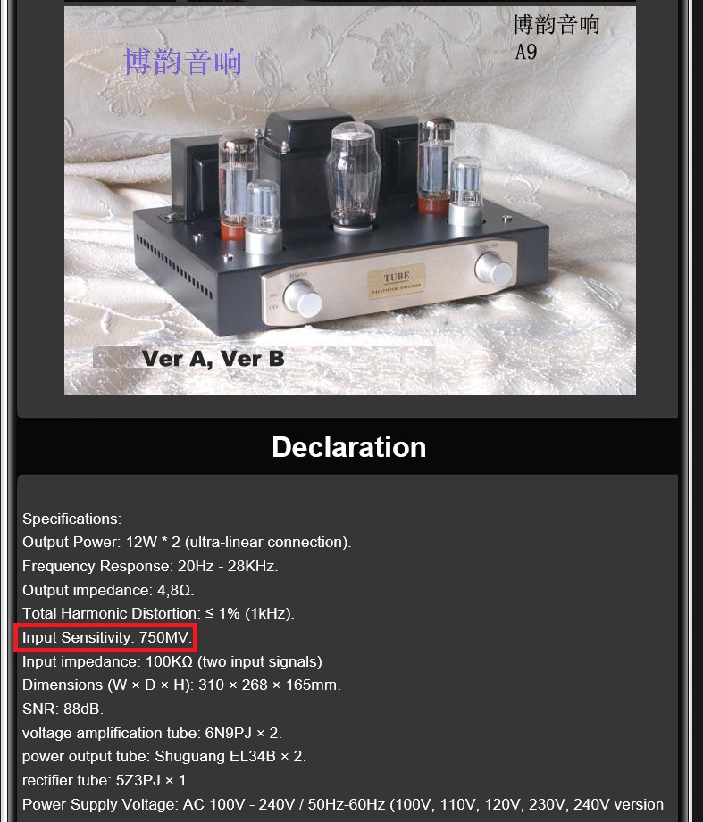

An example in the photo for you, so that you understand where the voltage comes from.
Yamaha CD-S2100 Output Level 2 +/- 0.3 V
Boyuu A9 Input Sensitivity: 750MV
if you feed amplifier 2v to the first stage (6N9PJ) of the amplifier, you get an overload, you get a bunch of distortion at the output of the amplifier.
The amplifier requires 750 mV, it requires a divider.
It's just that I don't understand how the 750mV 'sensitivity' number is calculated-or found by testing the amplifier.
The volume pot is a voltage divider - is the added divider with fixed resistors necessary?

The amplifier requires 750mV to reach full output. With a volume pot, you reduce to input voltage to the first tube, therefore controlling the power output. Why do you need a voltage divider?

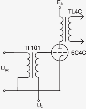

It is best to use for this matching transformer, less troublesome voltage divider.
"Matching transformers are designed to change the voltage level of electrical signals carrying useful information. They allow you to match the source of the signal with the load with minimal losses and minimal signal distortion."

The output level of your device (player, DAC, etc.), you can find out in the specifications of this device. Calculate it is not necessary.I don't doubt what you have said and shown from the specs.

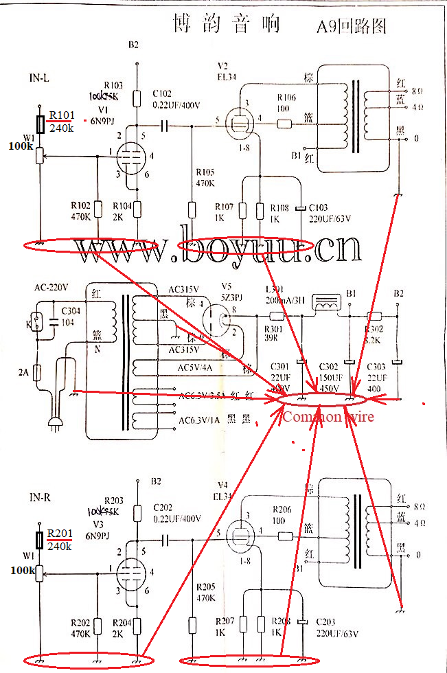

The Model A10 is not my amp (for some reason A10 schematics keep getting injected into this A9 thread discussion) - Mine is the Model A9 as per the schematics I uploaded in post #697. I think the A10 and A9 are different beasts are they not? Also mine has a PCB so it is not all P2P wiring as the schematics allude to which I think is why some of these discussions are confusing to me....
It seems to me that you did not encounter devices with a 2-2.5 V output, it is simply impossible to listen at 30% volume.
All you're doing is attenuating the input signal, so that your volume control has a normal range. I understand now why you're doing this, but you make it sound like a mandatory modification, which it's not.
The A10 has 6N2P input tubes, and all tubes appear to be PCB mounted, but the basic topology is the same.

The schematic would be the same whether the amp was built P2P, with eyelet/turret board, or with a PCB.Also mine has a PCB so it is not all P2P wiring as the schematics allude to which I think is why some of these discussions are confusing to me....
It's baffling at first but with more time spent comparing the schematic with 'the real thing' on your bench, you will get more familiar with it.
Printing out the schematics for the A9 and A10 and looking at them side-by-side will show you that they are very similar.
The caps that LongRoad is suggesting for possible replacement are the coupling caps (.22 or .33 uF) between the 'preamp' tubes and the power tubes. They pass the AC signal but block DC. Changes like that can sometimes make subtle differences in amps that are already working well.

You understood correctly. So the volume control works in full you need to lower the input signal to the specified value in the characteristics of the amplifier. As a voltage divider, you can use the volume adjustment potentiometer.All you're doing is attenuating the input signal, so that your volume control has a normal range. I understand now why you're doing this, but you make it sound like a mandatory modification, which it's not.
Using a calculator, you can consider the volume control as a resistor divider. As a result, we get the value of R101 and R201 see the scheme. Breeze Audio DAC SU3 high level Audio decoder ESS9018 XMOS Asynchronous USB DAC
