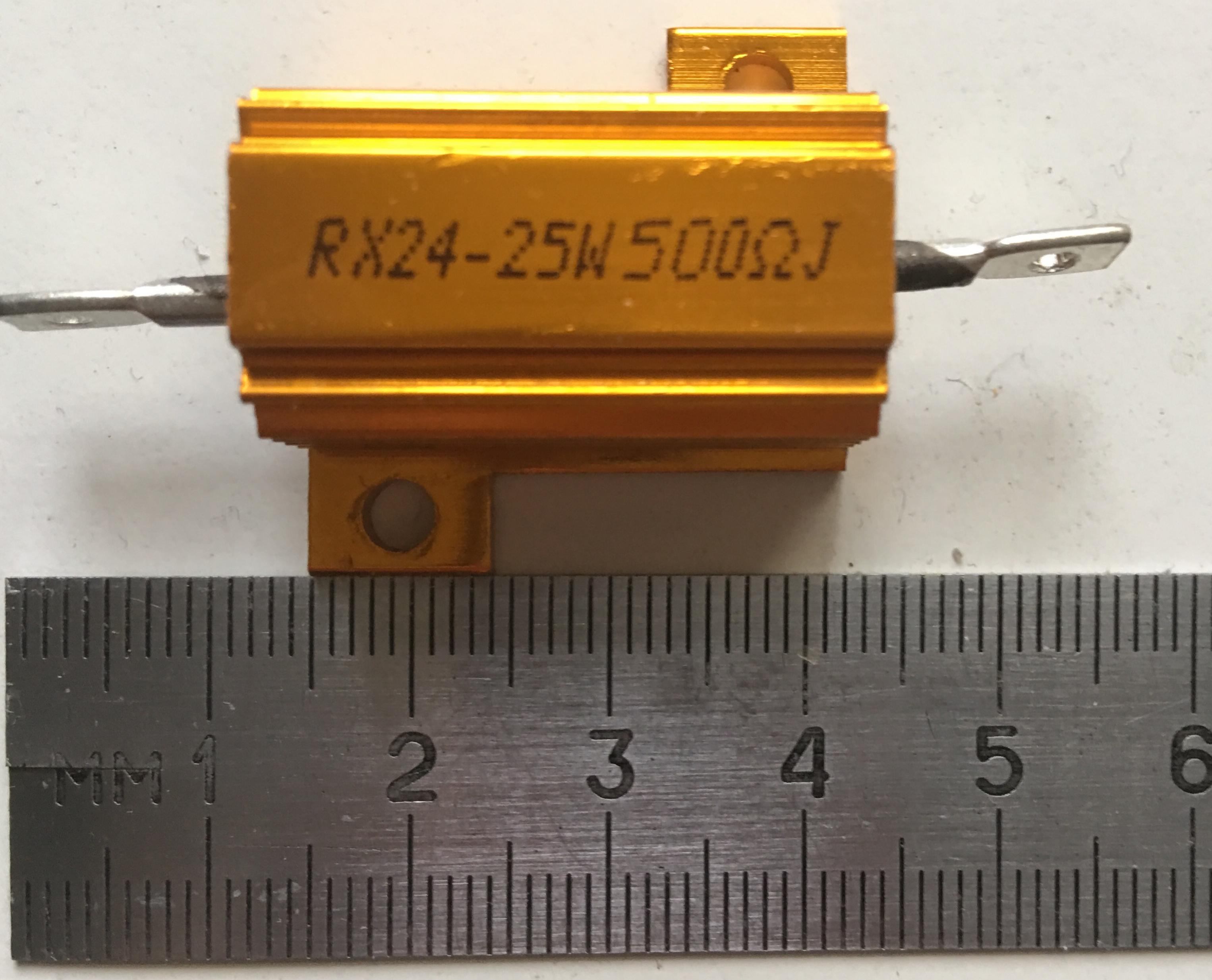

A very good result is the choice of resistors R107,R207 with a tester for each amplifier channel using RX24. (pic)
with a nominal of 500 ohms, on measure ~ 430 ohms
Resistive current EL34 ~ 52mA
