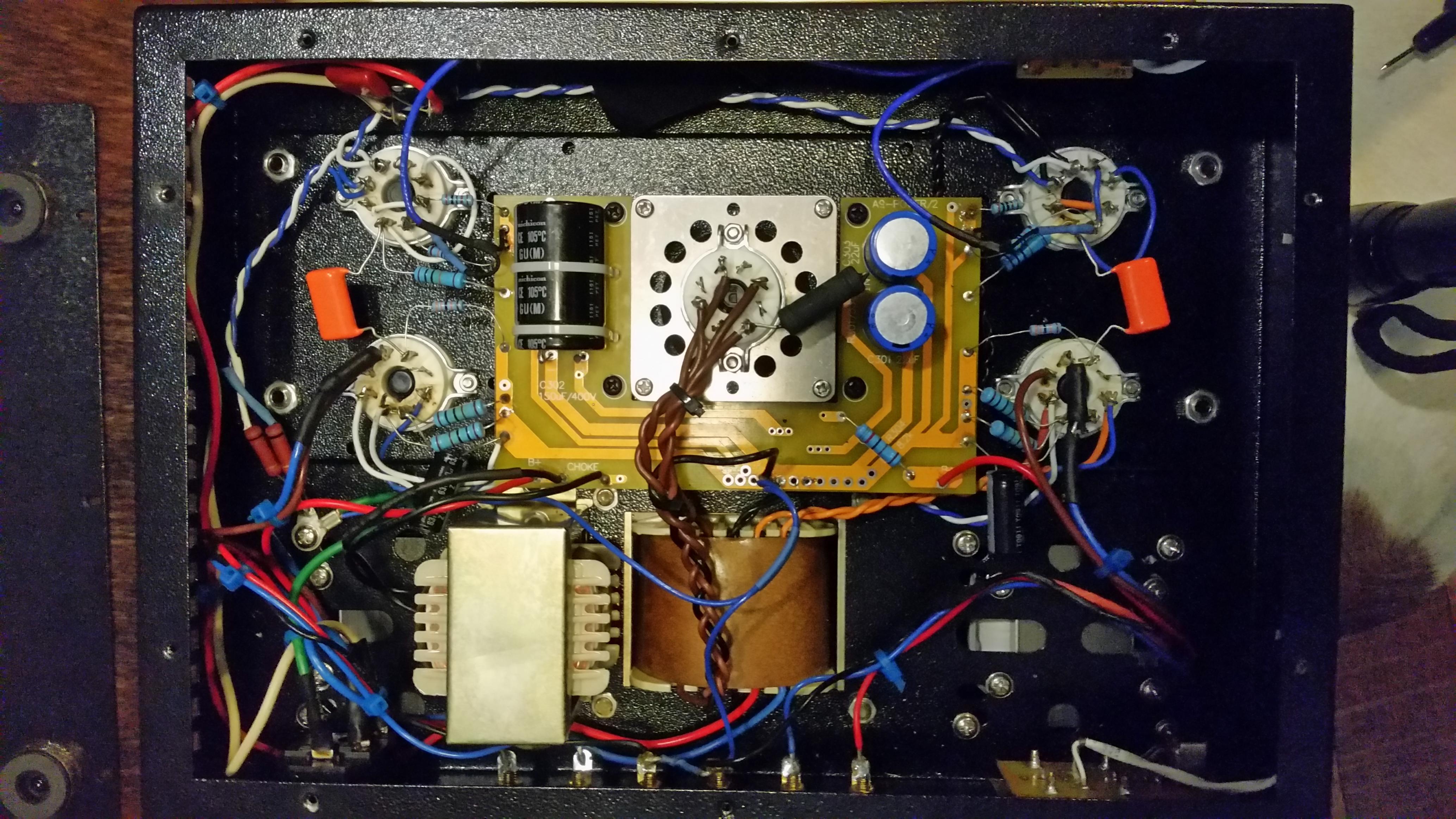

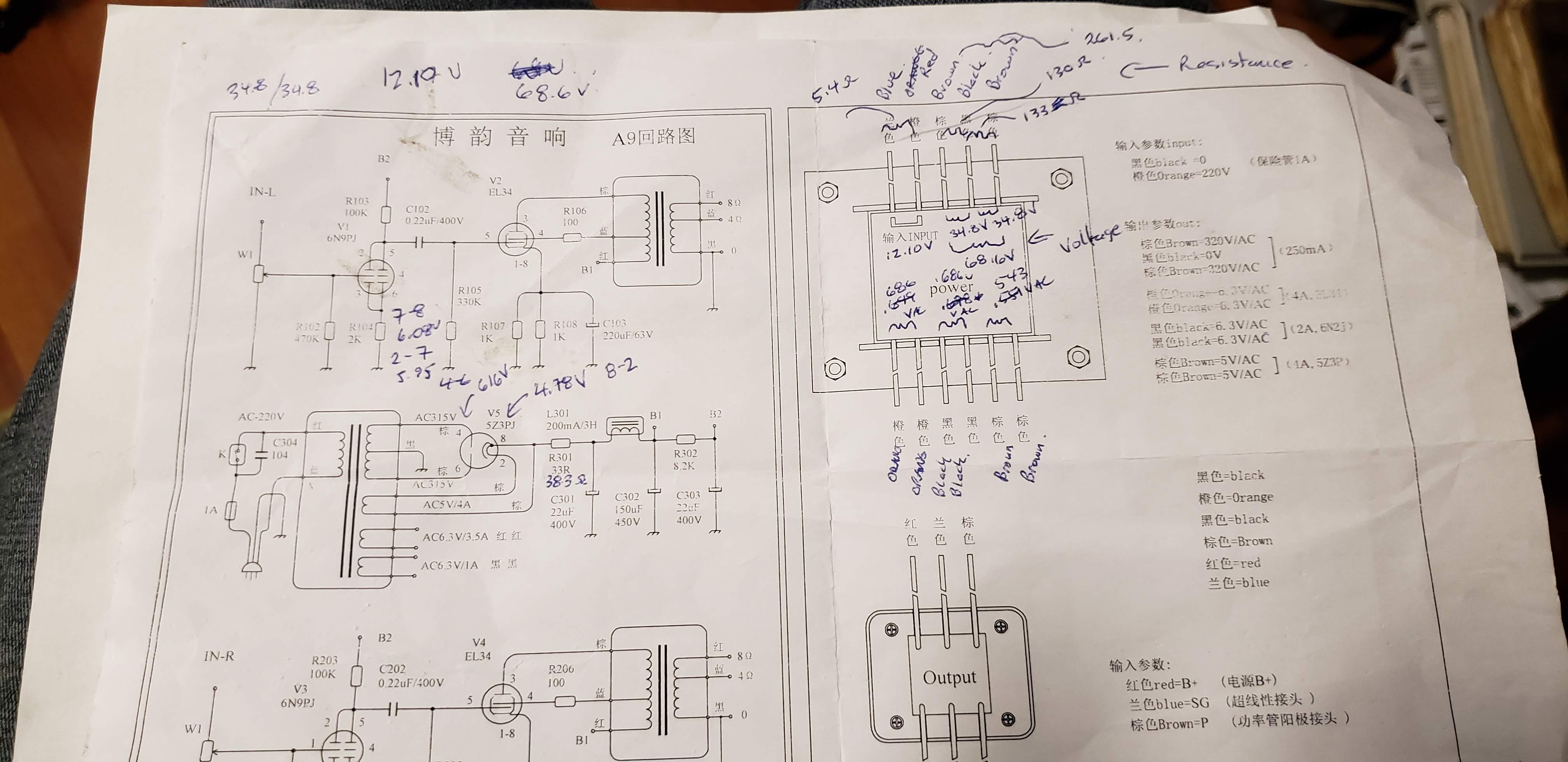

Is there anything in particular that you'd like folks to look at?This is what my amp currently looks like.
Well my issue is harshness at louder volume. I'm going to double check the wiring today as you suggested In terms of hum it's quiet. Still trying to get my hands on an scope. Also I'm considering other grid resistors aside from the 3.3k I got in now.

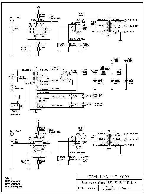

The schematic of post # 609, shows input tubes V1 and V3 have unbypassed cathode resistors.
If the tubes have filament to cathode leakage, that could cause hum.
Are you using the same circuit?
Swap input tubes V1 to V3, and V3 to V1; then listen again.
I do recommend two resistors, one from one end of 6.3V, and the 2nd from the other end of 6.3V, and the other ends to ground (a virtual center tap to ground) try two 47, 50, or 100 Ohm resistors.
Do not just tie one end of the 6.3V to ground, that is unbalanced.
Be sure to connect Both grids of each input tube. The schematics all show pin 4 not connected.
Do not let pin 4 float. These are parallel triodes. But because they share plate load, and share cathode resistors, it is even more important to use grid stoppers to partially isolate] the grid connections from each other.
Use 2 separate grid stoppers for each tube, 1k Ohms each. Connect one end directly to the tube socket tab # 4.
Connect the other ends to the resistors to the grid resistor that goes to ground, and to the volume control wiper.
Now, swap the output tubes to the opposite channel.
The B+ filter choke is under, or near-under one of the output transformers. Depending on the orientation of the two magnetics versus each other, that could cause hum.
Steel (non stainless) chassis conducts magnetic hum everywhere.
Otherwise, it sounds like one of two things:
A ground loop in one channel (ground return Locations of input triode grid resistor, cathode resistor, output tube cathode resistor), or input connections of RCA phono input jack, volume control and grid resistor, and Where they return to ground.
A wire that has hum (6.3 AC), or B+ wiring from transformer, rectifier, or first or second capacitor that comes near a sensitive point (grid of input tube, grid of output tube).
Are the DC voltages on both channels about the same?
(Plates, Cathodes, of both input, and both output tubes)

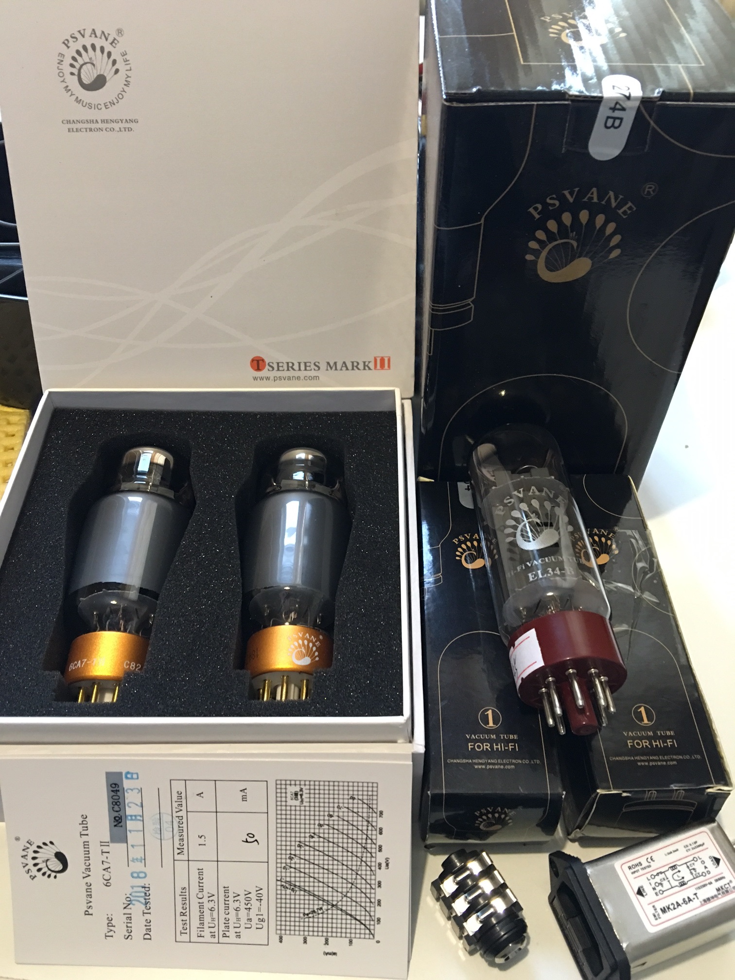

Anyone know a place here in Victoria, BC where I can buy inexpensive replacement tubes so I don't have to wait forever for an out of town order?
You have EL34's in your amp? Some of the guitar stores here probably have some. I have some old Shuguang's here that you can use as testers if you like. They worked fine in my amp, but have been sitting collecting dust for a few years.

try swapping tube from the left side to the right side. does the problem follow?
i will try the amp with other speakers. I spent a few hours and I've double checked all the wiring it looks good to me. I did notice that there is a discrepancy from the wiring diagram and the actual components i got.
capacitor c301 and c303 should be 22uf 400v instead they are 33uf and 400v
capacitor c302 should be 150uf 450v instead it is 200uf 400v

Thank you for your patience. Had my channels reversed in the video but same effect. In essence read left channel hum and no right channel hum because the unit was sideways I had the speaker wires inverted when I shot the video. Anyway I went ahead and flipped V1 with V3 tubes as suggested and repeated. No change in effect. It did not flip over to the other channel.
I am really confused by the meaning of the above statement. On both V1 and V3 I have the secondary 6.3V heater power going to right channel pins 2 and 7 via twisted black wires off the Pwr transformer. From right pins 2 and 7 I have a twisted pair yellow of black relaying power to the left side tube socket pins 2 and 7. I then have a 100ohm resistor off of each pin 2 and 7 going into a Yon a red wire that goes to the circuit ground on the PCB. THis drawing more accurately represents my wiring for this project that I found much earlier in this thread as the component values represented what I had in my kit that did not agree with the crappy Chinese schematic I received.

See better (so I thought) schematic I used above - it shows that pin 4 is connected as well - thoughts on this schematic?
More comments of yours with my answer in red (Quotes are becoming bothersome)
Now, swap the output tubes to the opposite channel. - Have not tried this yet in light of new schematic but will do shortly.
Steel (non stainless) chassis conducts magnetic hum everywhere. Several others including Smittie this forum have reported success with this design so I have to think it works and that I am doing something else wrong at this stage rather than blame the design at this juncture...
A ground loop in one channel (ground return Locations of input triode grid resistor, cathode resistor, output tube cathode resistor), or input connections of RCA phono input jack, volume control and grid resistor, and Where they return to ground. Possible
A wire that has hum (6.3 AC), or B+ wiring from transformer, rectifier, or first or second capacitor that comes near a sensitive point (grid of input tube, grid of output tube). I was lead to believe that 60Hz hum was usually a tube failure as per the the second Youtube link in my post #692

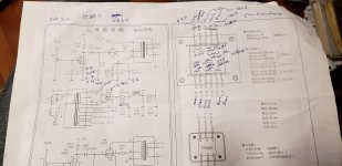

(Plates, Cathodes, of both input, and both output tubes) Here are my earlier measurements - will do an updated set of measurements right after posting.
see(pic)Yeah, same as my above comment mostly - If I catch the drift of what you are saying here, I thought I had done this... Do I do this V2 and V4 too?
