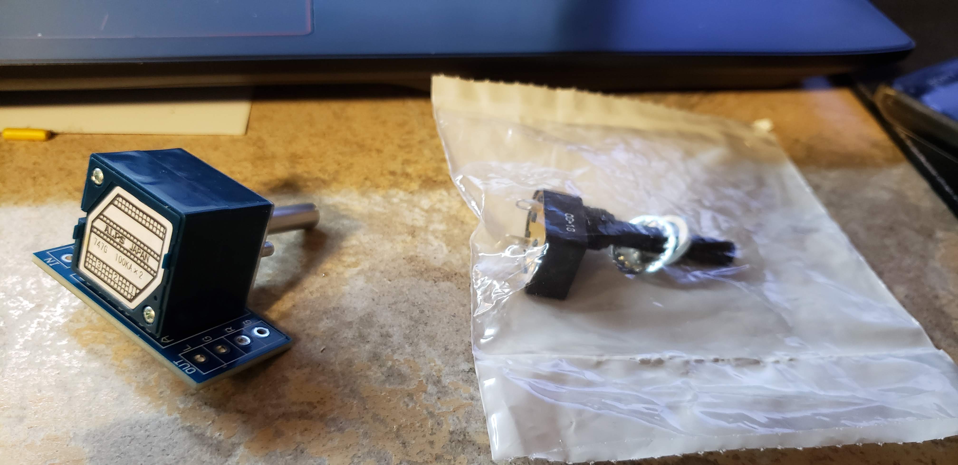

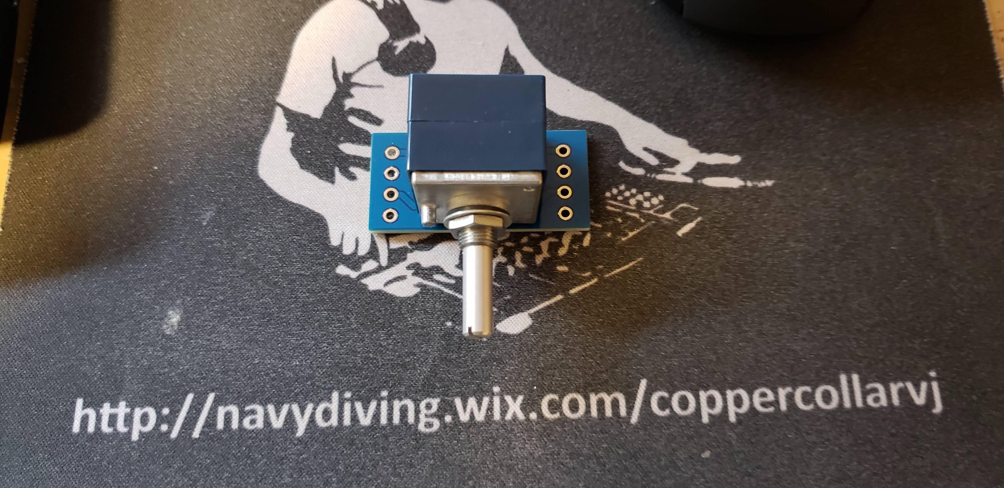

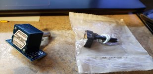

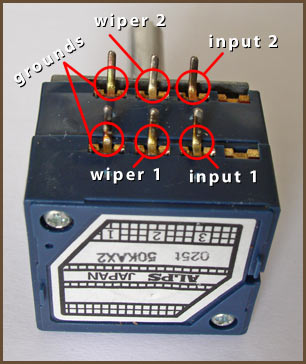

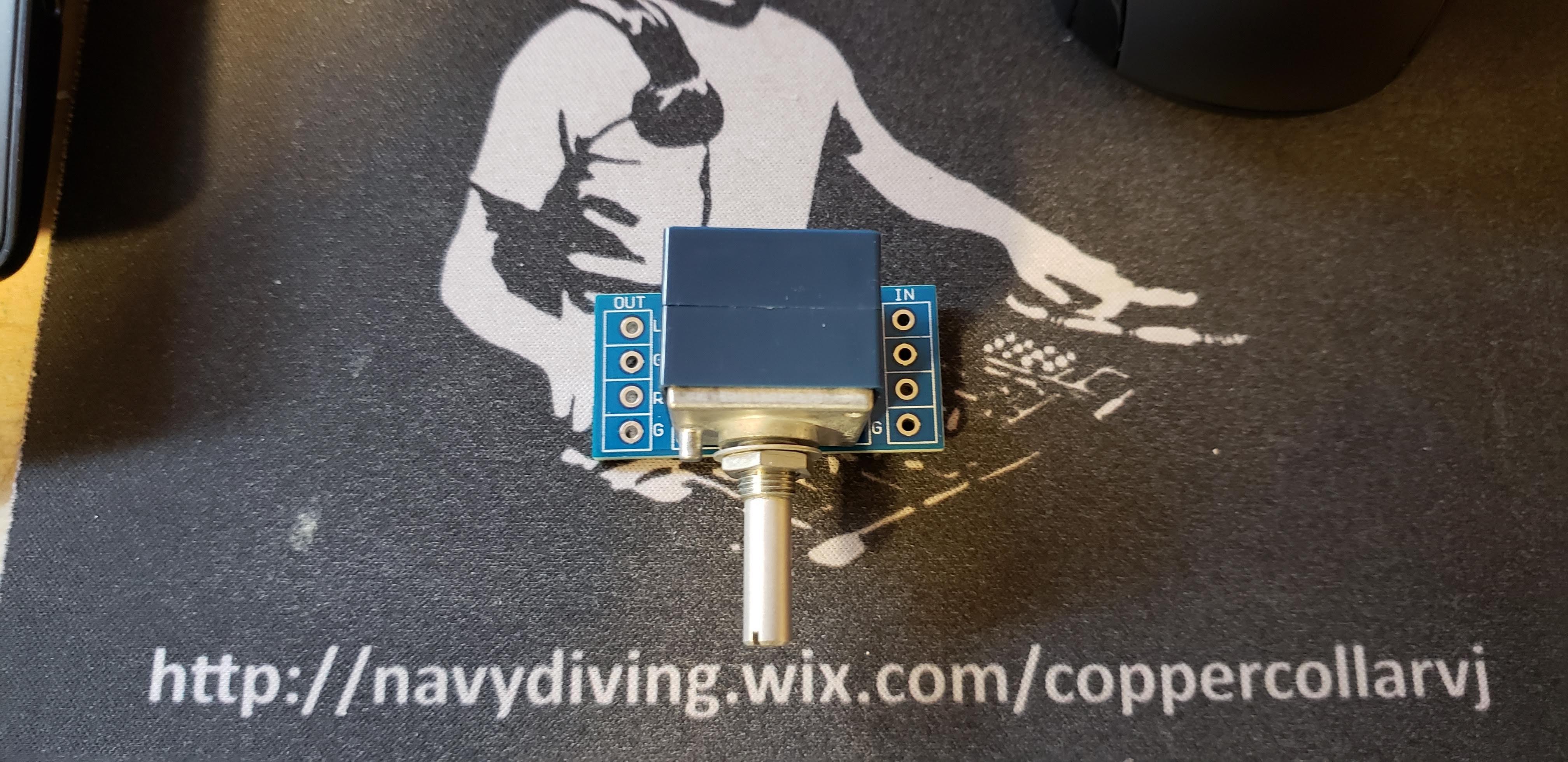

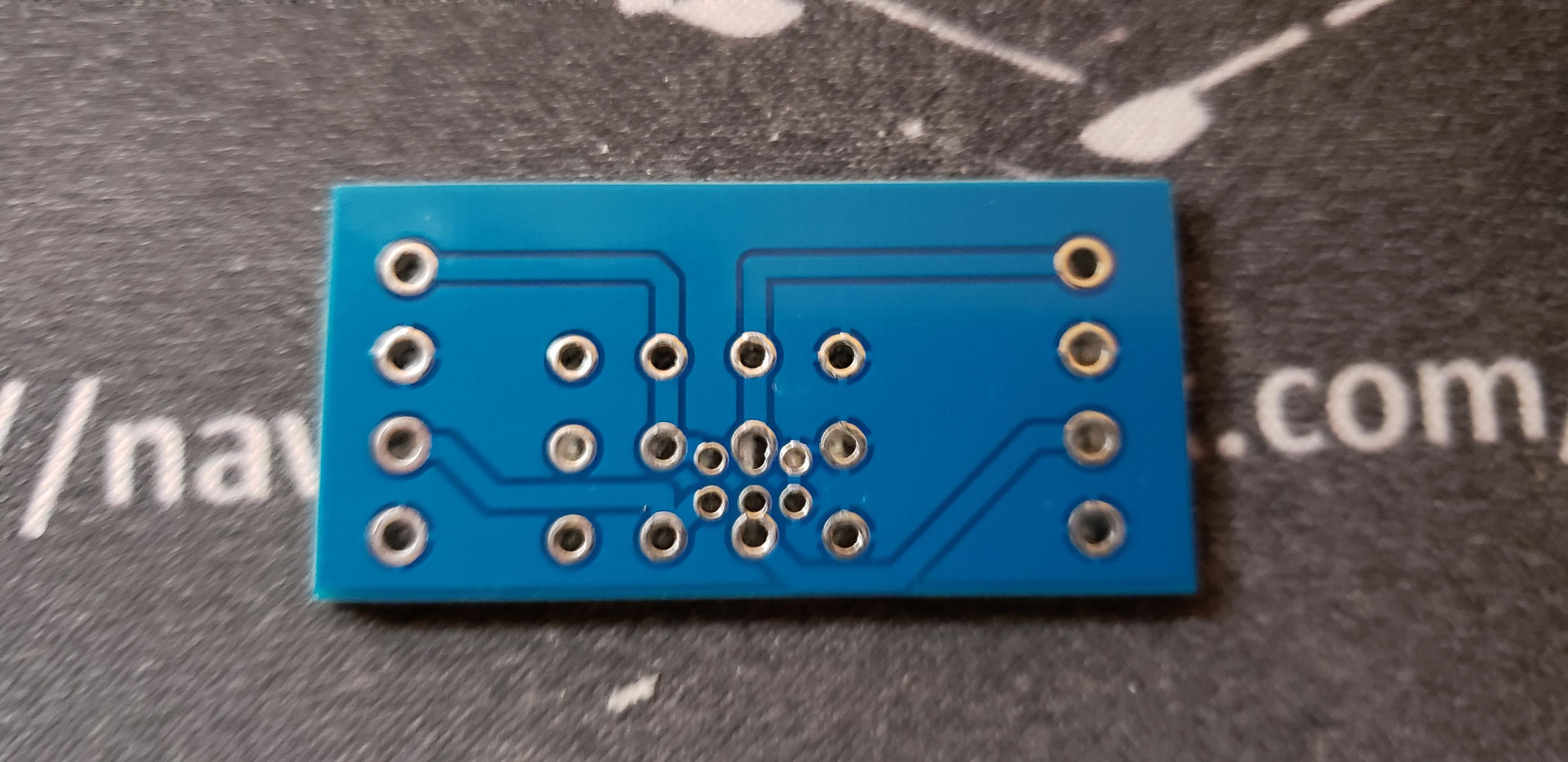

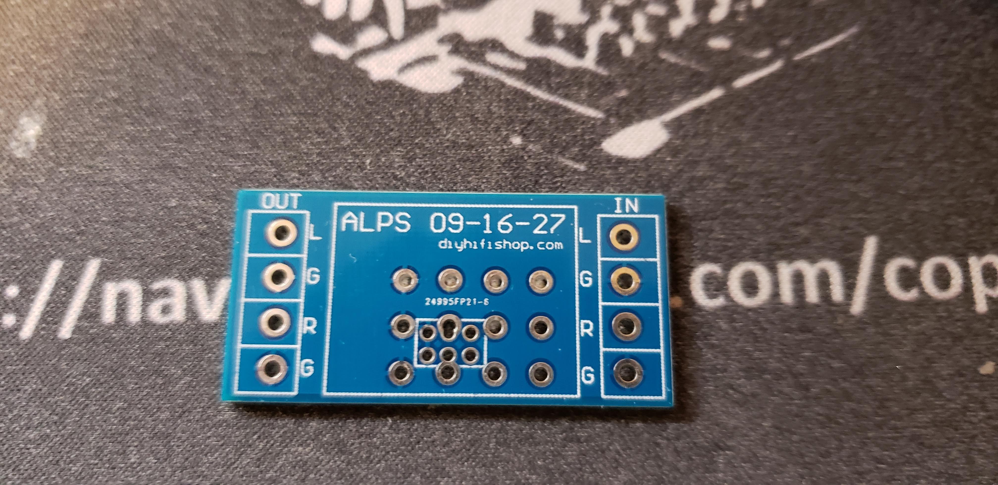

As an aside I just received a new on/off switch as recommended herein as well as an ALPS volume control to hopefully improve the chintzy ones that came with the Boyuu.
The usual 'convention' with PCBs is that the components go on the side of the board with the silkscreened labels.
There's no need to trust that though.....a minute or two with the multimeter and schematic will tell you the answer.
Or, you could just cut into an old RCA cable and tack the pot into place between the CD player and the amp input on another amp - sometimes a quick experiment is the easiest way to get an answer.
I have the same pot in my preamp, just without the pcb. I'll have a look at it, and double check the connections. Personally, I wouldn't use the daughter board.Alas, got no instructions with the ALPS so wondering if anyone knows the proper convention for mounting one of these bad boys on the daughter board so the volume goes up the right way? Would it be A or B?
Edit: Ok, the connections in the image check with mine.

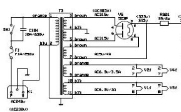

Check out the schematic:
Those pins are connected to the (HV) secondary winding of the power transformer, so they will have AC voltage present (no DC). So you need to put your voltmeter on 'AC' volts, and at the correct range to handle the voltage you expect (>650 volts ? between the rectifier plates; half that between the center tap and the end of the HV winding).
With AC there's no 'positive' or 'negative' meter lead. You can measure the voltage between the center tap of the secondary and each of the rectifier plates. The center tap should be grounded to circuit ground, so one lead could be clipped there.
Be careful- I'd usually use clip leads for that measurement rather than the probes. Clip the leads on and then power up the amp, power down before removing leads.
Once you move to the DC side of the rectifier (pin 8?) you'll need to switch your meter to DC volts.
Be careful - if you are nervous, it's easy to slip with the probe, so it's safer to use alligator clip leads when doing this.
