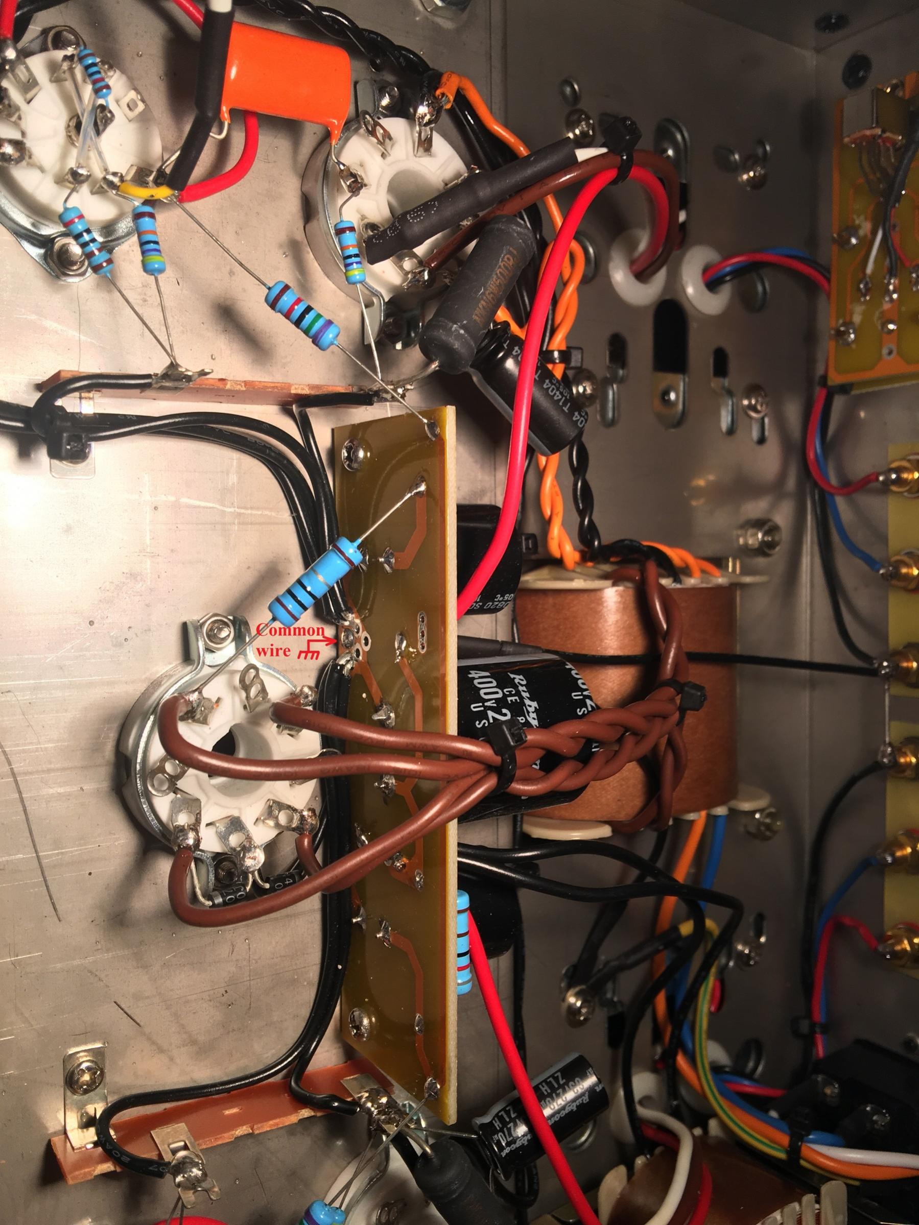

There's been a lot of talk about grounding and how best to do it. Can someone post some images of the amp so we can see exactly where on the circuit board. Or on the chassis?

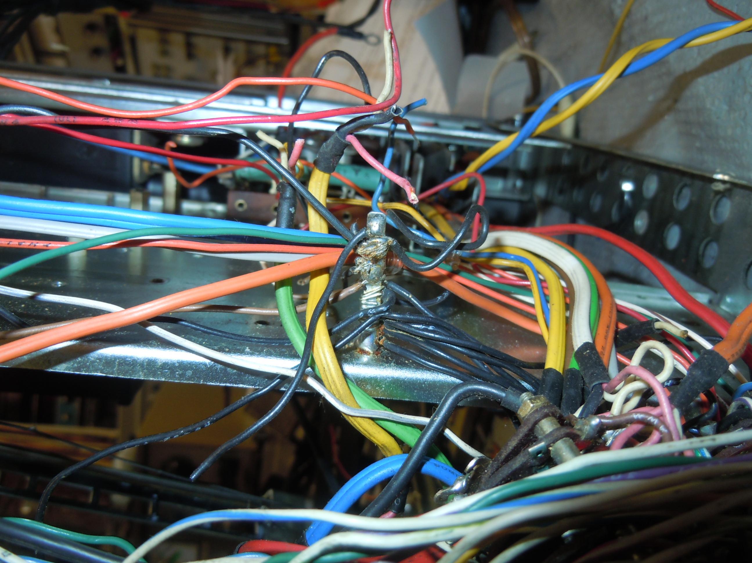

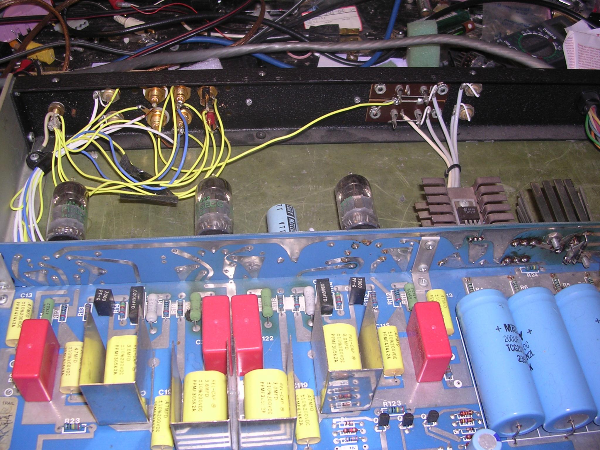

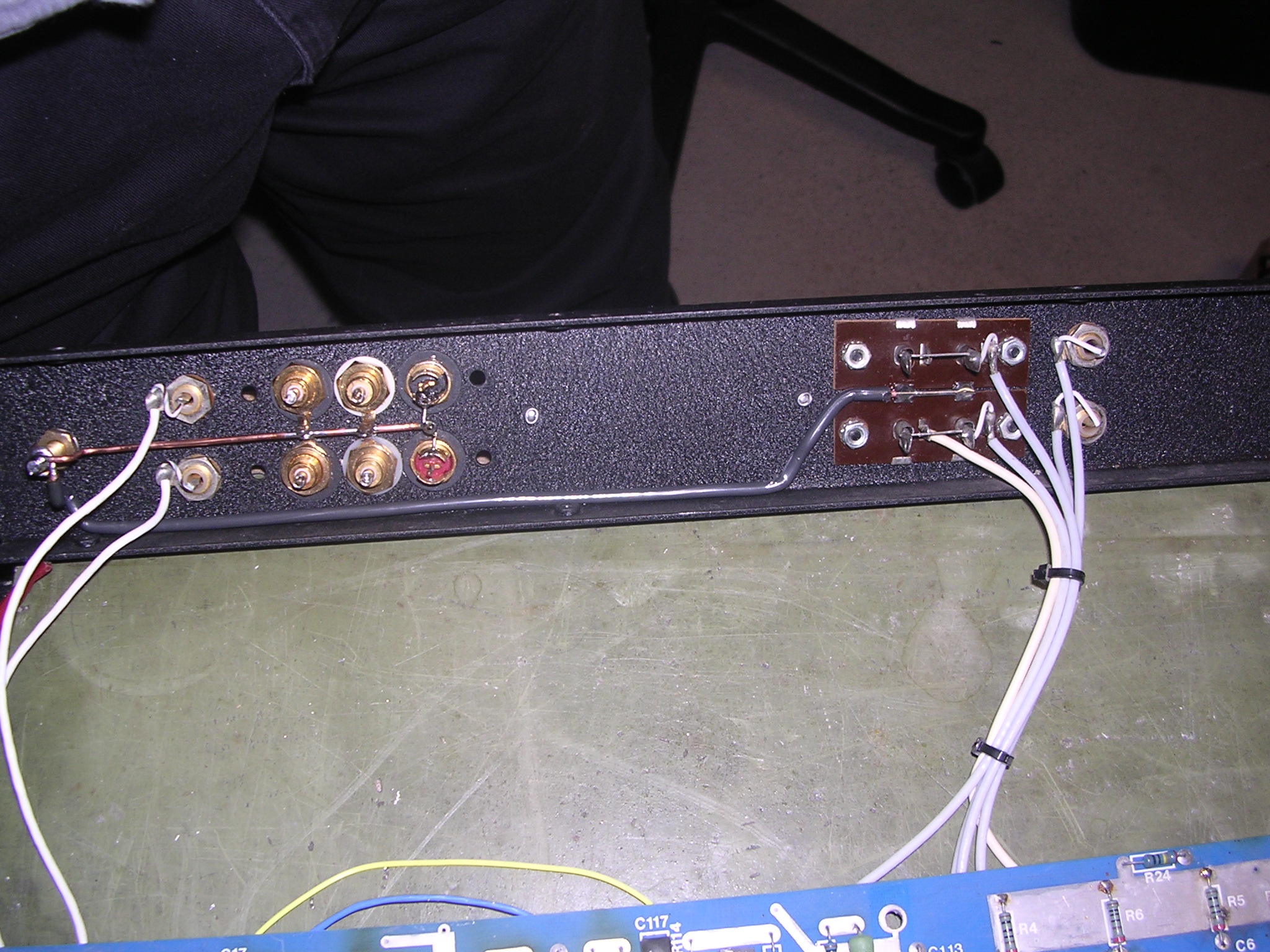

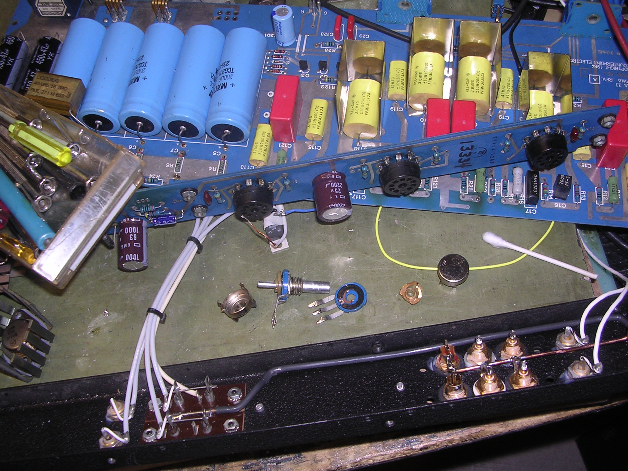

This is how I found one poor little Counterpoint SA-3.1. All the ground wires do connect to one spot near the input jacks, but the wiring is a disaster! Each ground wire was found to be close to the same length, so whoever did this is following some bizarre advice, or had their own little brainstorm. The later pictures show how I reran the grounds for both the input and output. Notice how the output ground connects to the ground point at the same location as the input grounds, but they are separate until they meet at the grounding post.

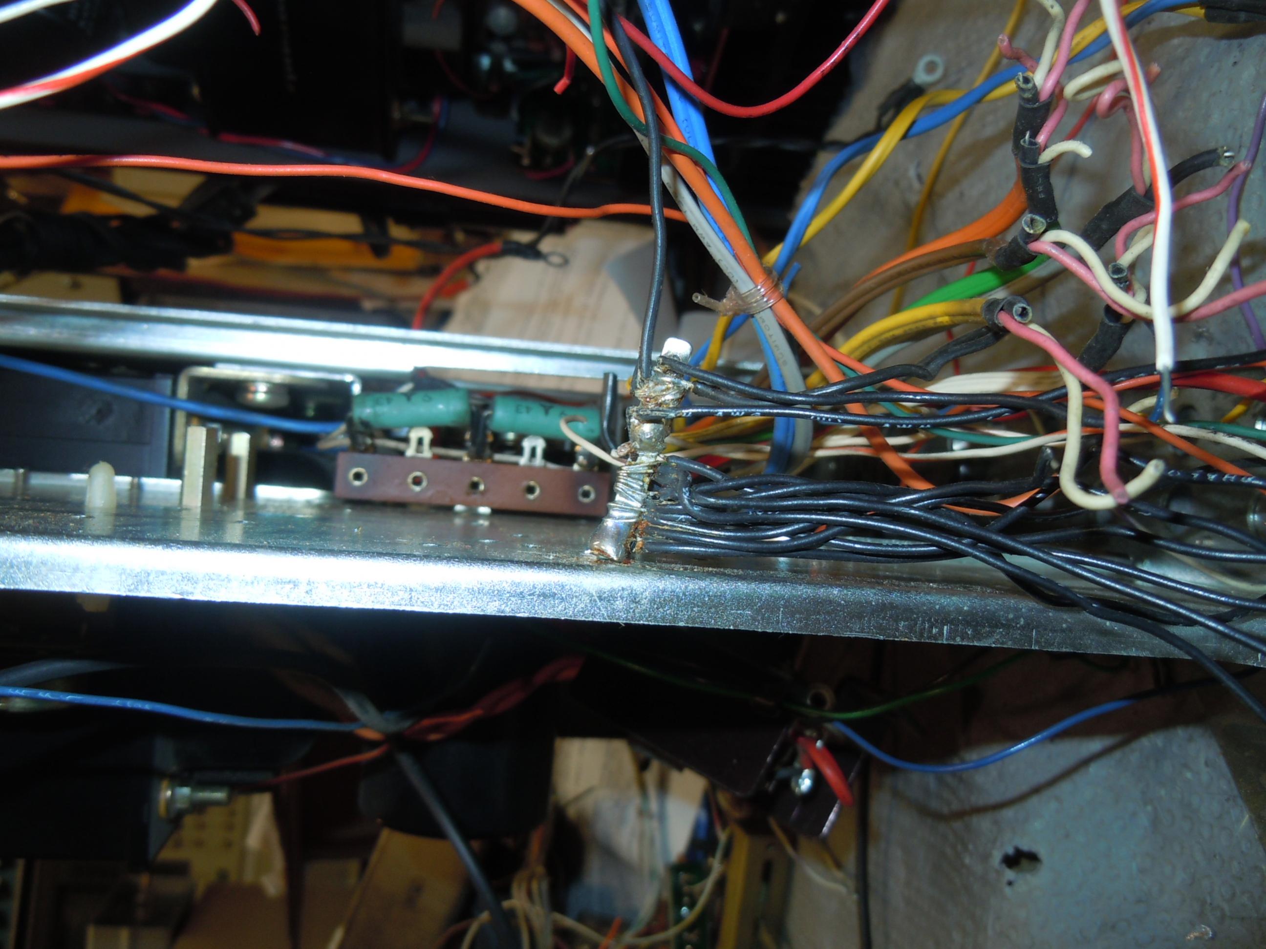

The last two pictures show "the ground" in a Marantz 2325. I pulled all the ground wires to one side to show the sheer number of ground wires that connect at this point. Impressive no? The 2325 is a quiet receiver, no hum at all. This ground is located close to the front panel on the right side of centre.
So here are two examples of proper grounding, one of which does not follow the general guidelines. But, it is still effective and done properly. Just as an aside, many receivers do not have one common ground point. They still manage to work okay, but they are not as quiet as the Marantz.
-Chris

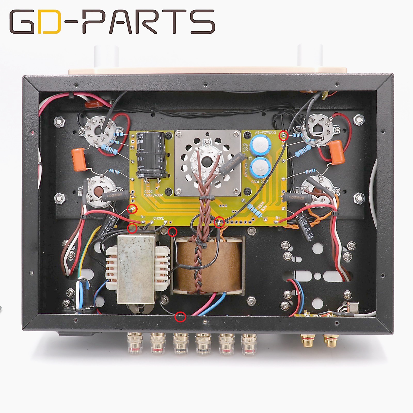

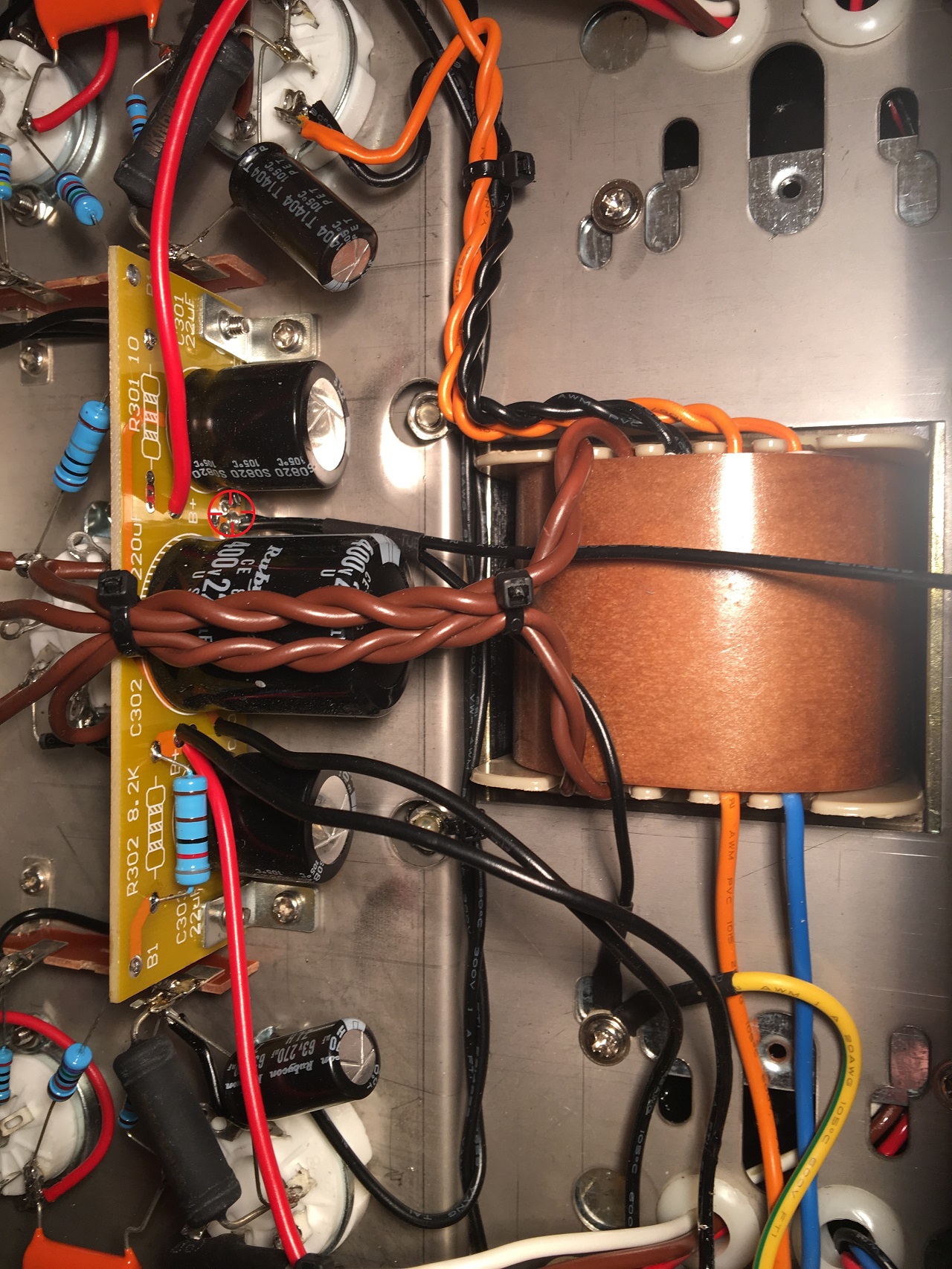

Thanks for the reply guys. i see how you've done the grounding on those amps. How about speficially the A9. Does anyone care to share pics?
What are your thoughts on this way of doing the grounding. I've red circled what looks to be grounding points.
Speaker connection ground to chassis and circuit board a/c plug ground to chassis Ground connection from volume control to circuit board Grounded for el34 and 6n9pj heater circuit to the board.

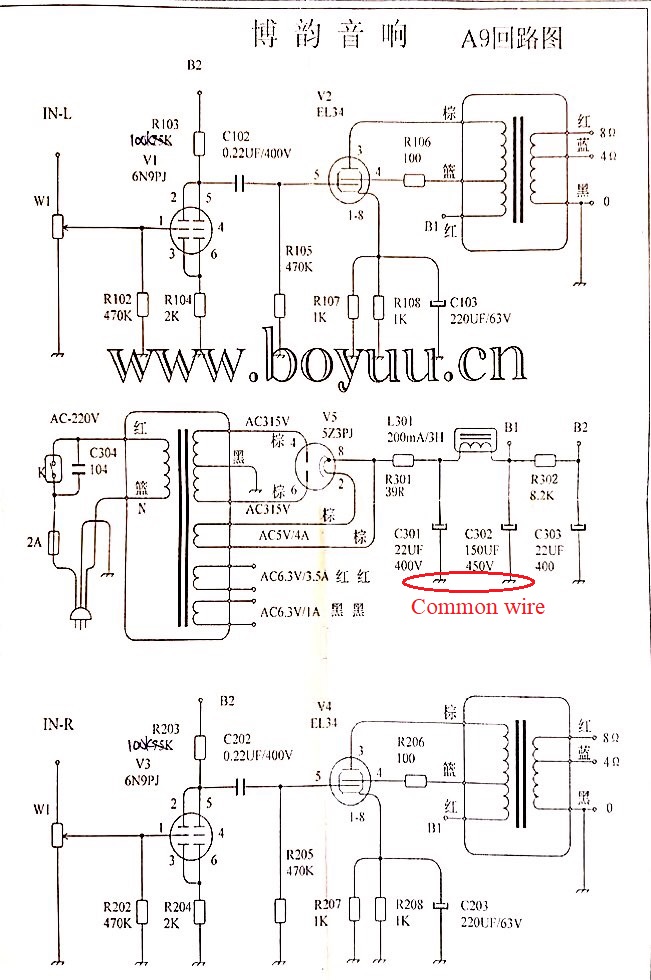

navydiver,
Is it possible that one output transformer is wired out of phase?
If it is, the bass on the two speakers will cancel. Also, there will be no music in the middle between the speakers. Instead, it will appear to be only on the left and right sides, and can even appear to be outside of the spacing of the 2 speakers.
If the signals are out of phase, then just reverse the plus and common wires on just one (1) speaker. If that fixes the problem, you have to check the output transformer connections (or very unlikely one output transformer was made incorrectly).
Other possibilities: (versus schematic in post # 609; no global feedback, Ultra Linear mode) If the component values of C102 and R105 are wrong. If the values of C103 and R107 and R108 are wrong (too low of capacitance to bypass bass frequencies; too high of resistances will have less current in the EL34 and too high of a plate resistance to drive the output transformer inductance).
Too little inductance in the output transformer.
The same goes for the other channel: C202 R205; C203 R207 R208; Output transformer inductance.
Mis-wiring the output transformer primary: One incorrect wiring would have the B+ going to the Ultra Linear Tap, but would probably oscillate, if no oscillation it would certainly have less bass.
Another incorrect wiring with B+ on the transformer 'plate' lead, and tube plate lead on the transformer B+ lead would be closer to Triode mode, but would be better in overcoming the transformer inductance, and give more low bass, not less.
The third incorrect wiring would have the B+ on the transformer 'plate lead, and the tube plate lead on the ultra linear tap, and the screen on the transformer B+ lead. That would be hard on the EL34, and might possibly oscillate as well.
Actually there are 6 ways to connect the primary, but only one way gives the right result.
For either Ultra Linear operation, or for Triode wired operation, the total of the primary windings needs to be used: B+ to tube plate. That gives the most inductance load for the tube.
For Ultra Linear, you could use either 40% or 60%, depending on which ends of the primary B+ and EL34 Plate are connected; the Ultra Linear Screen tap always needs to be somewhere in the middle of the primary windings.
