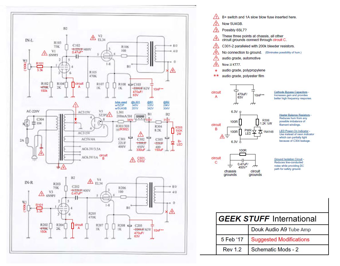

The recent schematics in this thread still have a glaring mistake.
The Dual Triode input tube has a floating grid, pin 4. That will affect gain, distortion, etc.
The fix is to connect pin 4 to pin 1.
Whether you are using a PCB or point to point wiring, you need to check those connections.
If you want to, you can use two grid stopper resistors, 1k Ohms each, one on pin 1, and one on pin 4, then tie the other ends of the grid stopper resistors to the volume control wiper that is also connected to the 470k Ohm grid resistor.

If there is any tendency to oscillate, or if there is RF floating around, it reduces both of those at the input stage. Most find that they are not necessary.
I have experienced some tendency to oscillate when I had an amplifier that had the plates tied together, and the cathodes had separate self bias resistors, but they both had bypass caps, so the cathodes were also effectively tied together for AC and RF frequencies.
If you do decide to bypass the cathode resistors, it would be a good idea to install grid stoppers.

I'd follow the advice to put the resistor right at the tube socket (lead trimmed short), as 6A3sUMMER advises. That's actually what the 'mods' schematic below shows, but I've seen builds where the grid resistor and the grid stopper were joined together, with a wire from the junction to the tube socket.
Sometimes schematics are missing details, 'assuming' the builder will know what to do, following standard building techniques. The assumption that builders will 'know' to tie the preamp tube grids together, since the plates and cathodes are joined, is in that category. Not obvious to a beginner at all.

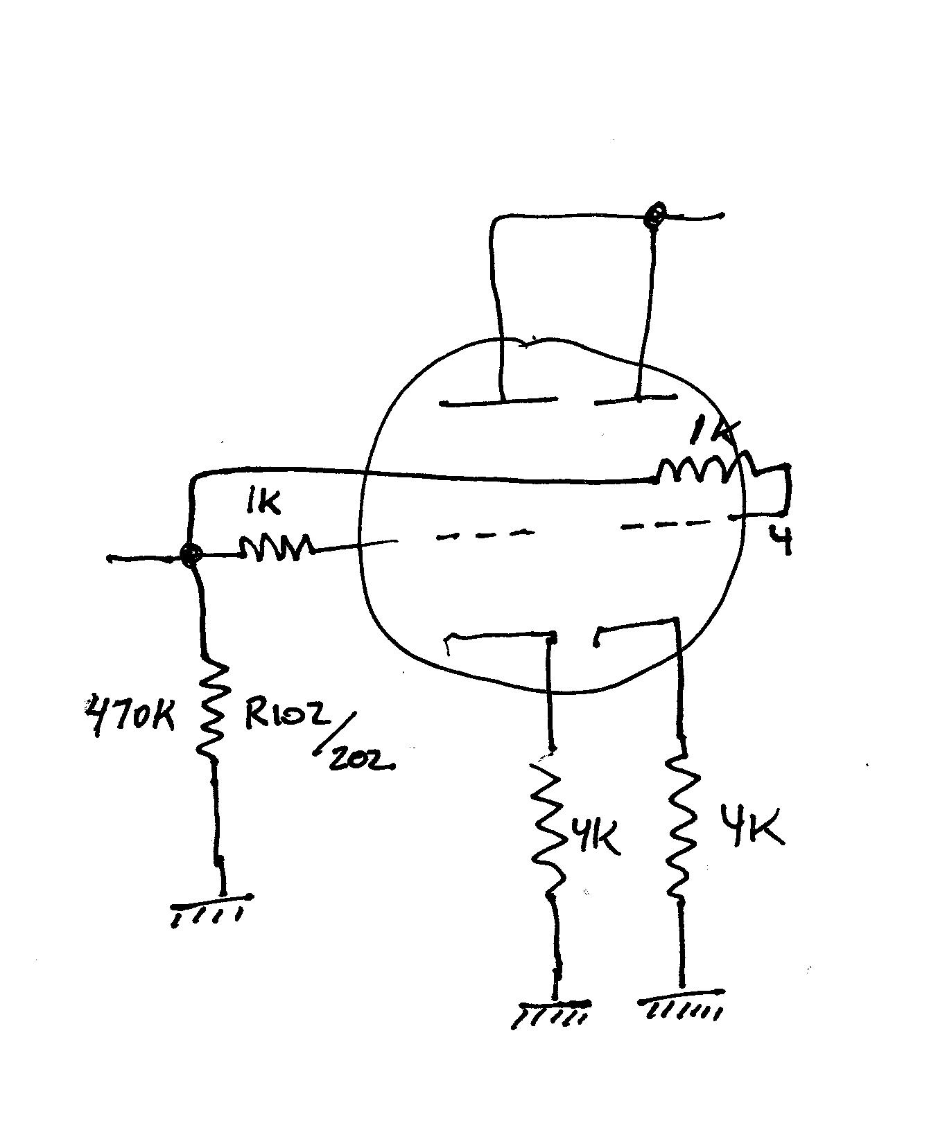

The proper way to use the dual input triode in parallel is to use separate self bias cathode resistors (do not tie the cathodes together). This is true, whether or not you also add separate bypass capacitors across the separate self bias resistors. This was all discussed in the very last issue of Glass Audio, in the cover article "Paralleling Tubes Effects". If they used two 1k Ohm resistors in parallel and tied the cathodes together, then use 1k to one cathode, and another 1k to the other cathode, and do not tie the cathodes together (they will balance much better that way).

Like this?
VictoriaGuy,
The connections are correct, but I am not real familiar with the 6N9P (seems to be like a 6SL7).
The only question is about the 75k plate resistor, and the 4k cathode resistors. Those
values seem reasonable. If the voltages are in the linear range of the 6N9P, that will work well.

I sketched the ideas that 6A3sUMMER was describing to make sure I understood correctly. (Doubling the cathode resistor, etc...)
