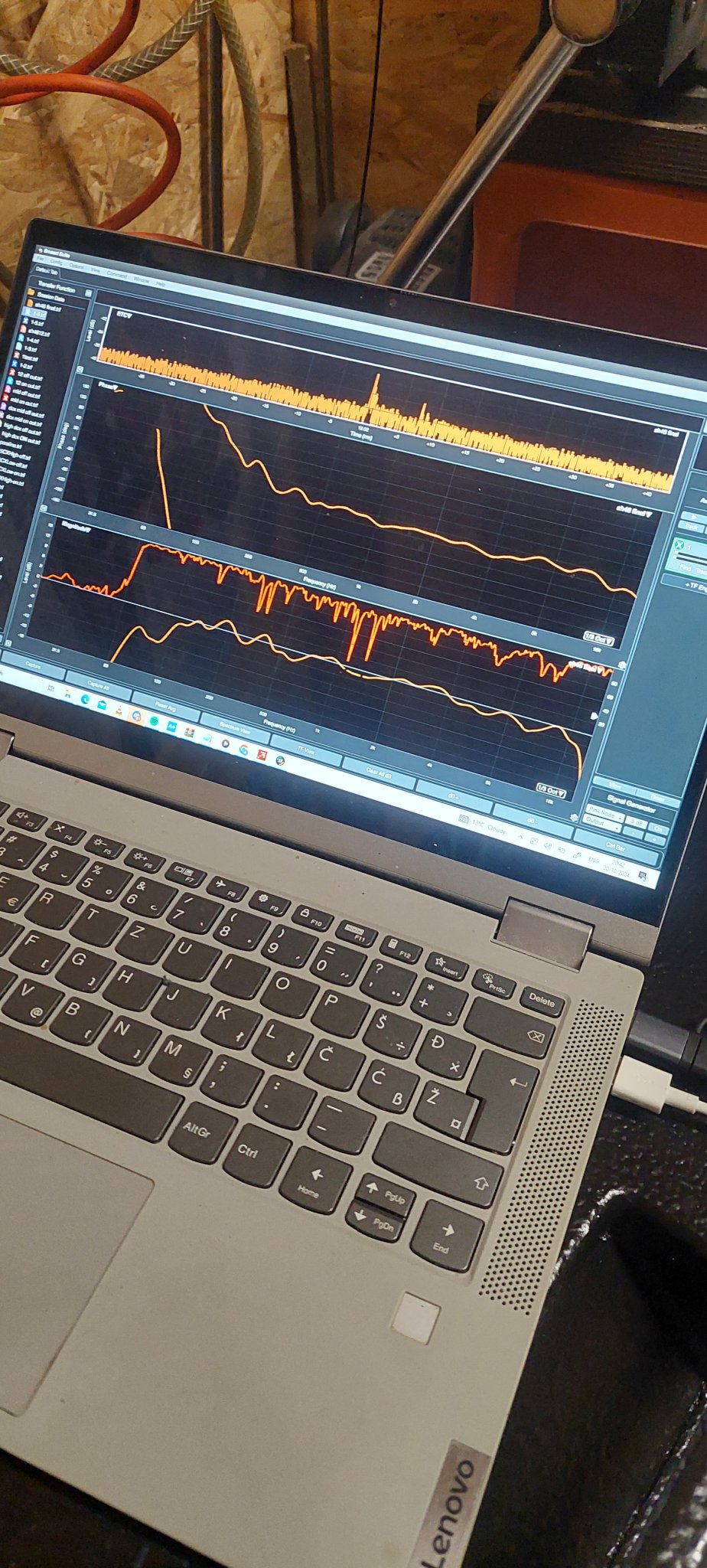

Actually MF and LF require minimal eq correction, crossover between those two is 400hz so FIR could still be used. DCX on the other hand requires relatively heavy correction (nothing crazy tho) also MF section of DCX requires phase correction. Other 2 crossover points are 1200hz and 4500hz.
Used only 6/12 db slopes for lowpass of sections since design also provides acoustics rolloff and sections couple perfectly. Now on Version 3 of dsp settings already 🙂
As for headroom and sensitivity between different sections, 2x12 inches are far behind MF/HF section and require quite a bit more power. 2 midranges actually have a bit more headroom than dcx, that is preety amaizing. Was worried 2 midranges would not be enough but they have more output than DCX, sensitivity is similar.
found this picture i took of smaart, measured inside so some inconsistencies, especially at lower mids.
Processing is nothing too extreme, then just correct delay is applied to get correct time alignment.
For limiters I use powersoft calculator, set power at AES power and had no issues.

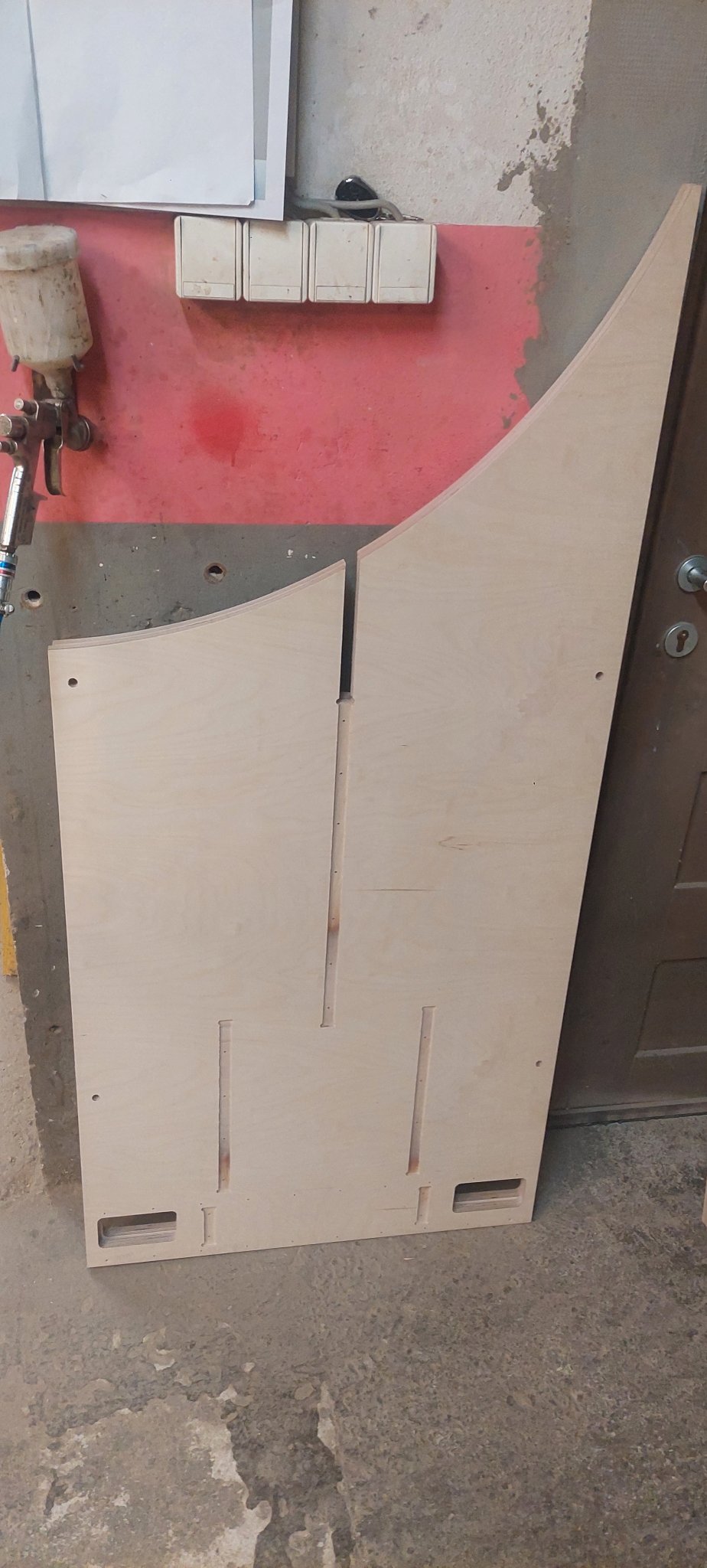

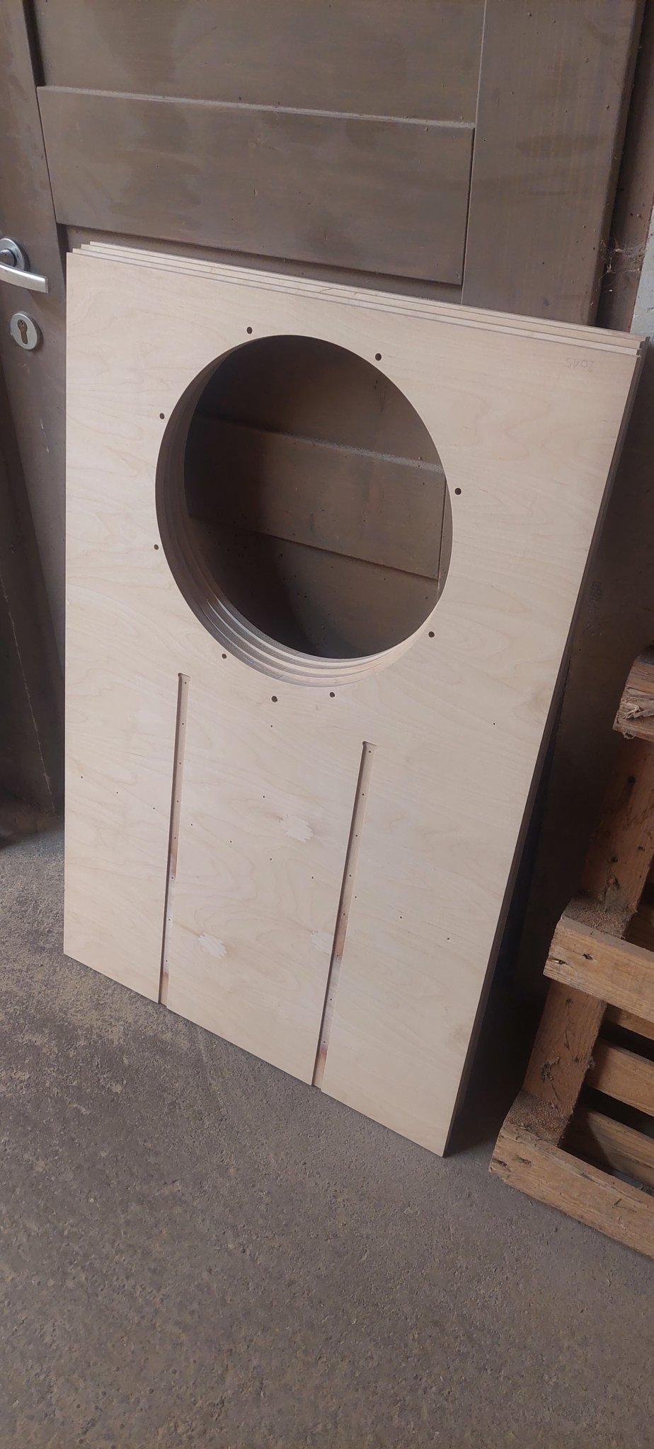

Still want to stay on thread and not go offtopic. Plywood will be finished next week.

we are eagerly waiting for the CNC to finish and the BC cabinets to be assembled 😎

how many you ordered from the CNC shop, i am eager to read your report on how they perform !!
Super!! Hey so those are arranged in a way that you see a complete hole in the center right ?
Each cabinet is like 1/4 of the mouth, so when you cluster the 4 cabinets you have one big A....mouth
Yes, that is correct.
One thing to note is that not all 4 subs are identical. 2 are left and 2 right (symmetrical).

Cabinets will (hopefully) get built this weekend. Still waiting for 18Ipal and Ipalmod system from our local distributor, but we have a few 18SW115 available so we could test with it.
