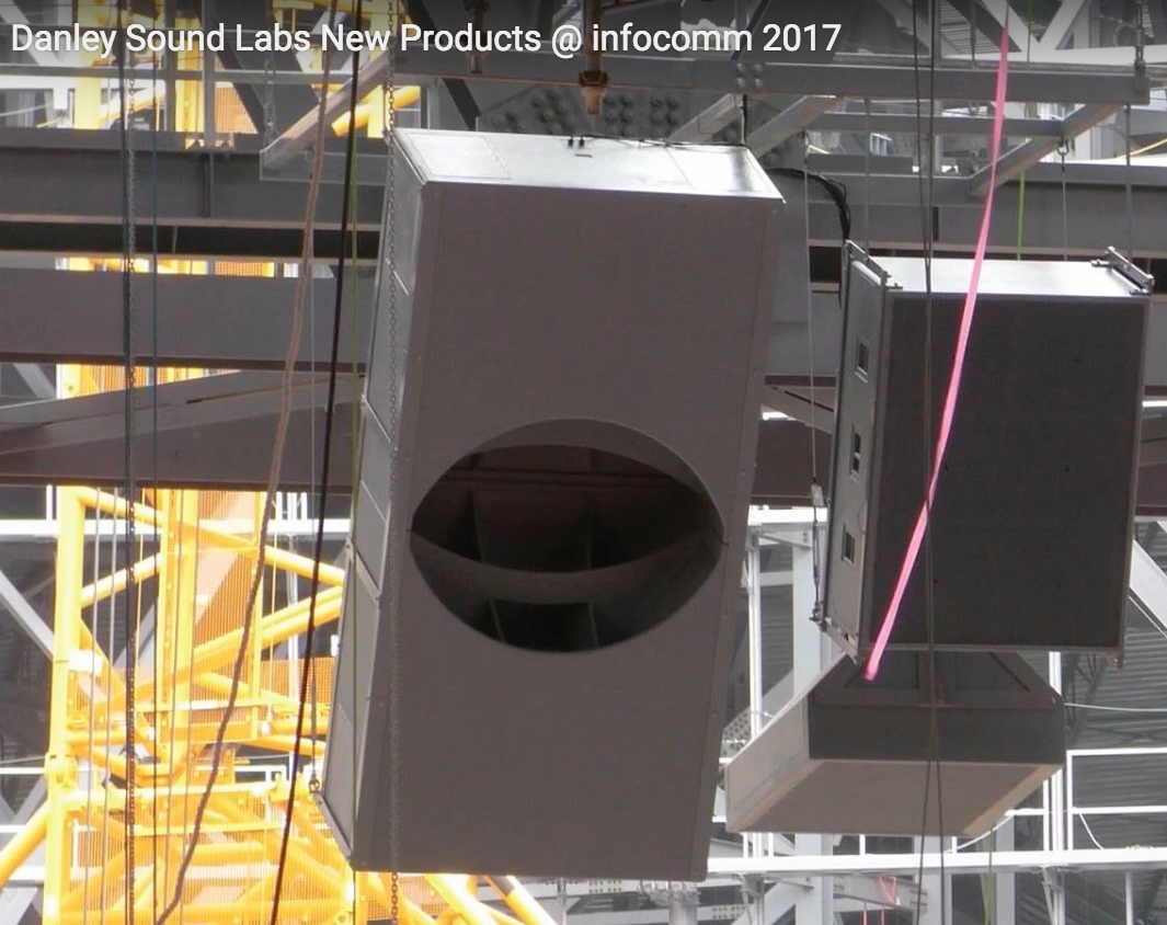

of the a Real one, or the one on this threadSomeone posted a couple pics of the BC218 in that thread.
All_1 has not completed his yet, the photo was a screen shot from the 2017 DSL InfoComm YouTube video of a pair of DSL BC218 and top cabinets rigged beneath a rectangular grid flown from the high steel in an arena installation.of the a Real one, or the one on this thread
That configuration gives the most forward gain below 70Hz and most narrow vertical BC (Boundary Control).
That stack eliminates the "BC" (Boundary Control) feature.
You may prefer the smaller frontal area stack (for some reason..), but you wrote "The best version of the BC218 stack" which it is not in terms of output where most would want it, in front.

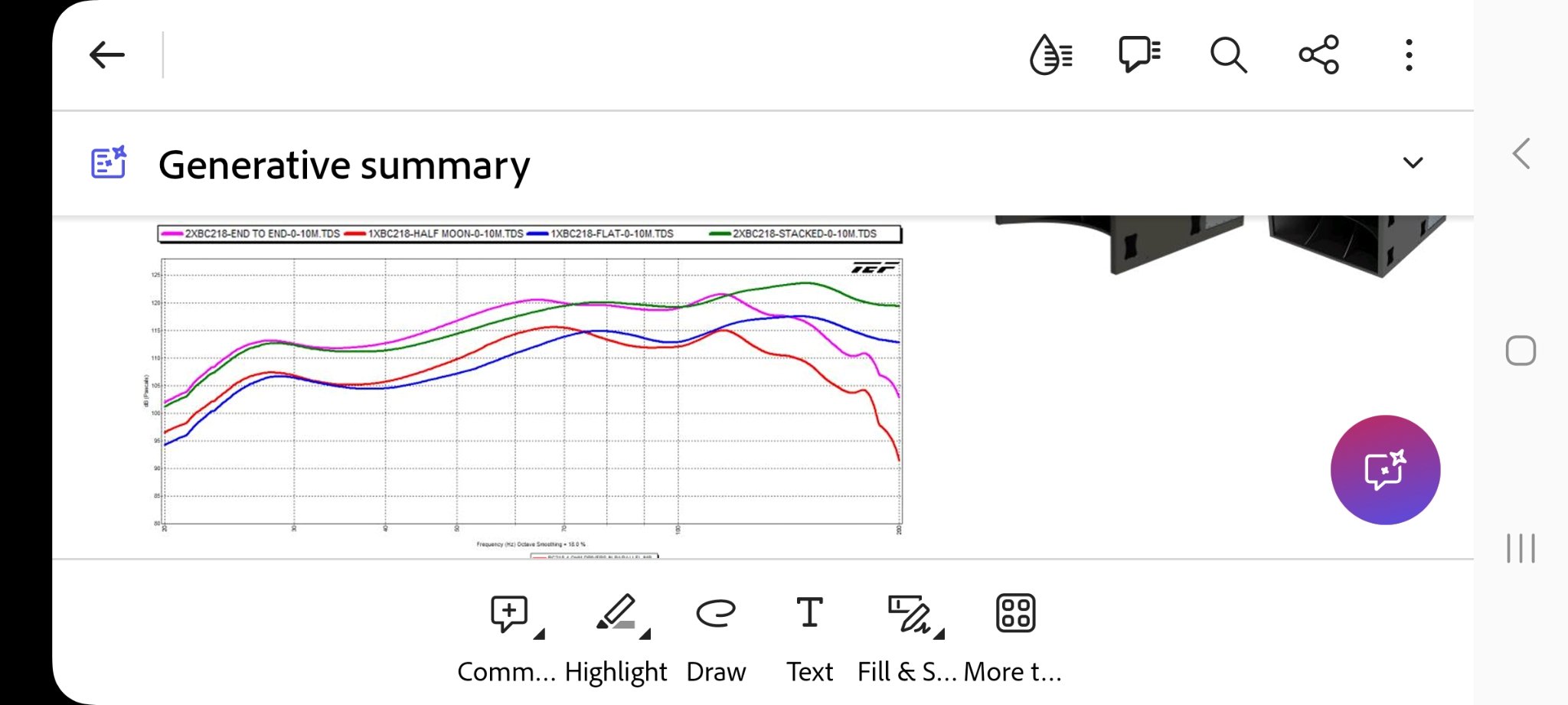

The vertical "center eye" stack has ~2dB more frontal output from 40 to 70Hz, and ~+1dB below 25Hz.
Yes I believe "center eye" config is optimal in most uses. Hardly see any point of using standard FLH configuration except maybe for better coupling of more than 2 218 cabinets or in scenario where are limitations with placement. Maybe also better for live music in FLH config, but that would be based on preference.
This might be 1 of those cases of form over function.
Be real, you know the FLH view looks better than the center eye view with all that bracing.
Hilarious, for once y'all highlight the narrow BANDPASS bandwidth of the center eye versus the wider BANDPASS bandwidth of the FLH stack.
The 60" depth in the FLH configuration would be too deep to work on deck in theaters with fire curtains, 30" is near the maximum for most. 60" depth is too deep to put in front of most stages with fixed seating, even 45" depth is too deep for many venues. That depth is also problematic with the out phase 1/4 wave rear reflection when near a wall boundary.This might be 1 of those cases of form over function.
I have no preference for the look of either, and would choose the "center eye" configuration for it's boundary control function providing more forward gain, and reducing level behind, which is particularly important for events with live instrumentation.
The BC has plenty of bandwidth for the usual under 100 Hz range a subwoofer of this size would generally be used for.
The additional gain the BC provides would reduce power compression for a given power input, an important consideration when using a small sealed chamber. The additional ~8dB reduction in output above 120Hz should reduce harmonic distortion compared to the FLH configuration.
At any rate, the BC configuration allows several advantages over a standard FLH, which is why DSL and All_1 decided to build them.
