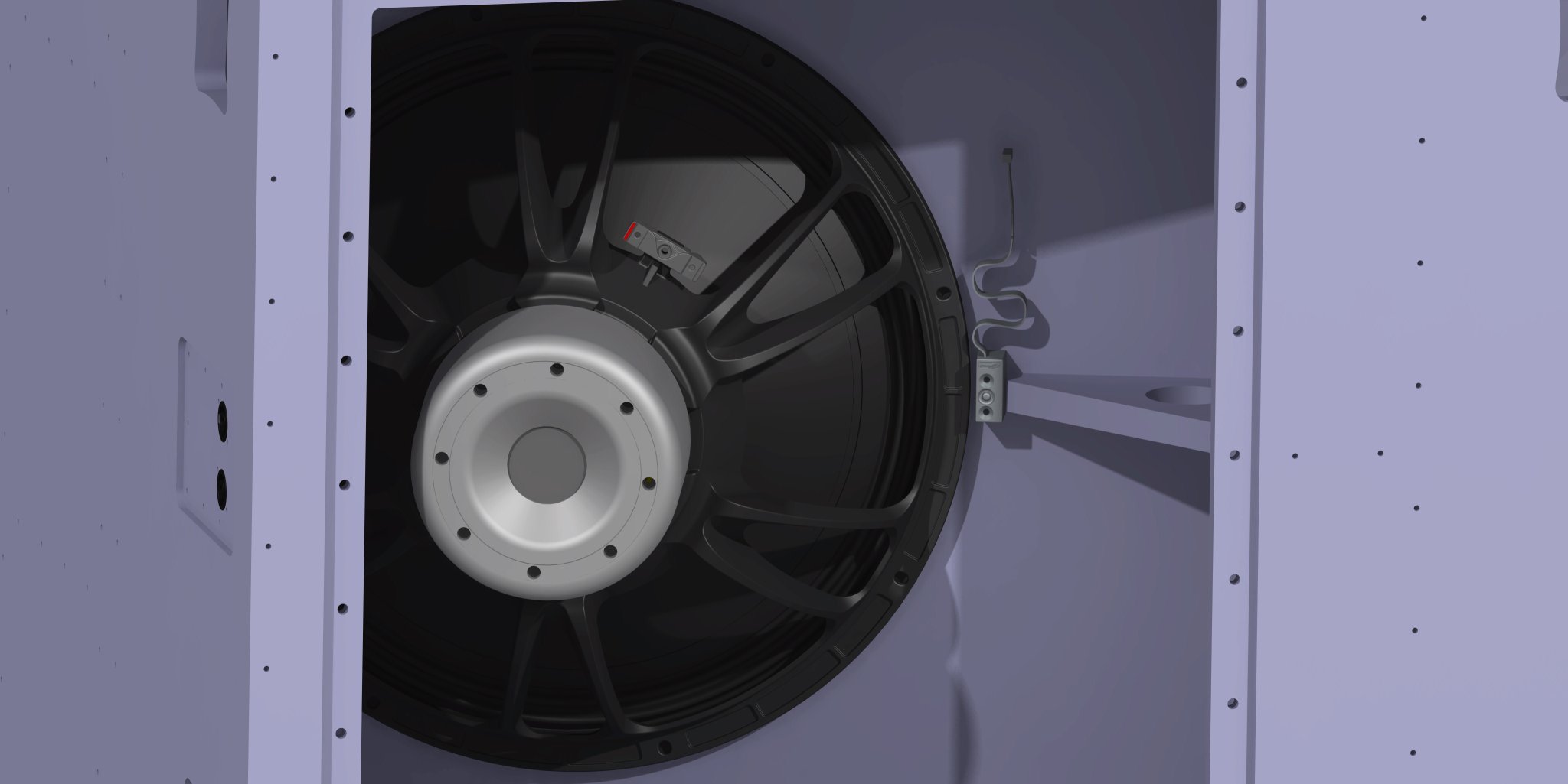

Yes, I tried it with original 3D 18IPAL (DS is only 6mm bigger compared to SW) model and just about fits. I wonder how much would cooling be impacted since it's angled and firing directly at aluminum plate.
Plate is only 6mm thick, that is the reason it fits. If 18mm plywood was used it wouldn't.

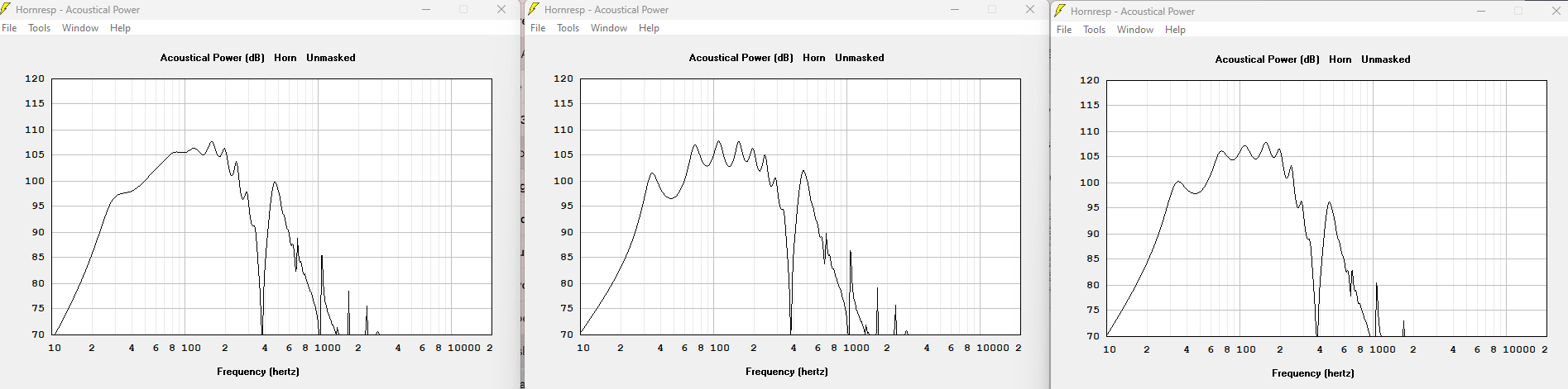

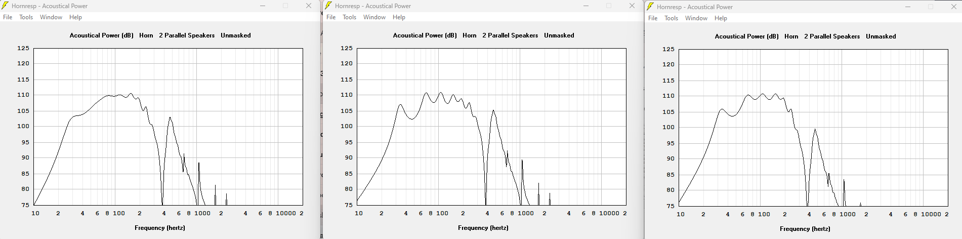

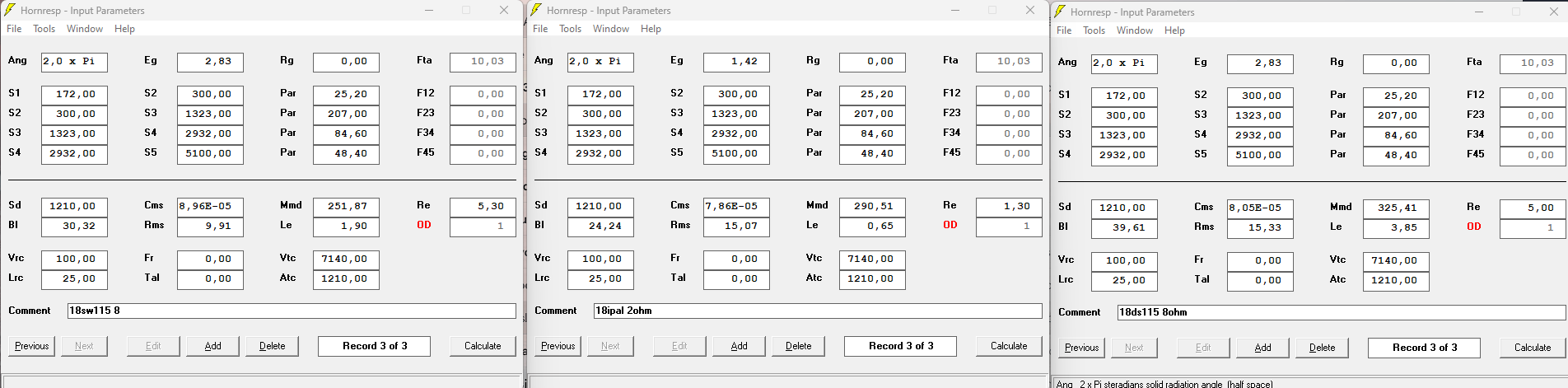

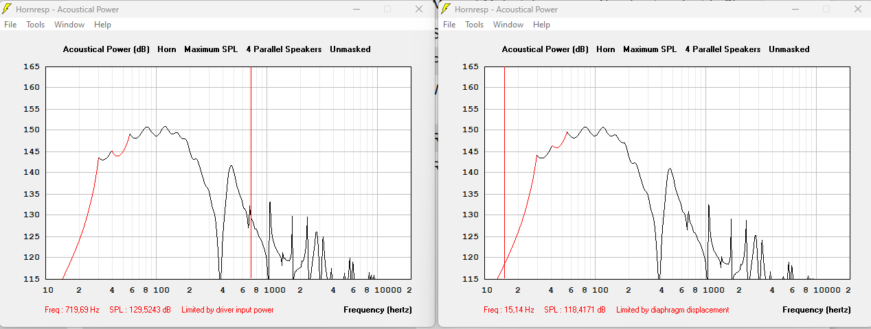

I did some quick sims in hornresp
Inputs;
1 driver 2pi:
2 drivers parallel 2pi:
Max spl 2 drivers parallel 2pi:
Ipal looks to be a clear winner here but might require some eq it seems? Opinions?

If it was my money I would probably go for the smooth frequency response and proven SW118 speaker. This is based on no experience whatsoever regarding these speakers, but you asked for opinions ;-). I do use the 15DS115-4 and the 21SW152-8 and they are great.
However, if I were to start with a new horn design and I got the results you showed for the Ipal and DS speakers I would not be satisfied, and change things (design, or speaker).
If looking at maximum output graphs ipal seems to get kinda similar shaped graph. Since dsp is available it should be easy fix for flat response and also actually use less power for same output? For all drivers I used 3400W max power for sims and ipal output is quite a bit higher and would also probably have lower power compression since it has better cooling.If it was my money I would probably go for the smooth frequency response and proven SW118 speaker. This is based on no experience whatsoever regarding these speakers, but you asked for opinions ;-). I do use the 15DS115-4 and the 21SW152-8 and they are great.
It looks like drivers with high Bl figures like to be eq and still keep maximum output. Any experiences with people doing this? More driver displacement around 40-50hz region would be beneficial for cooling

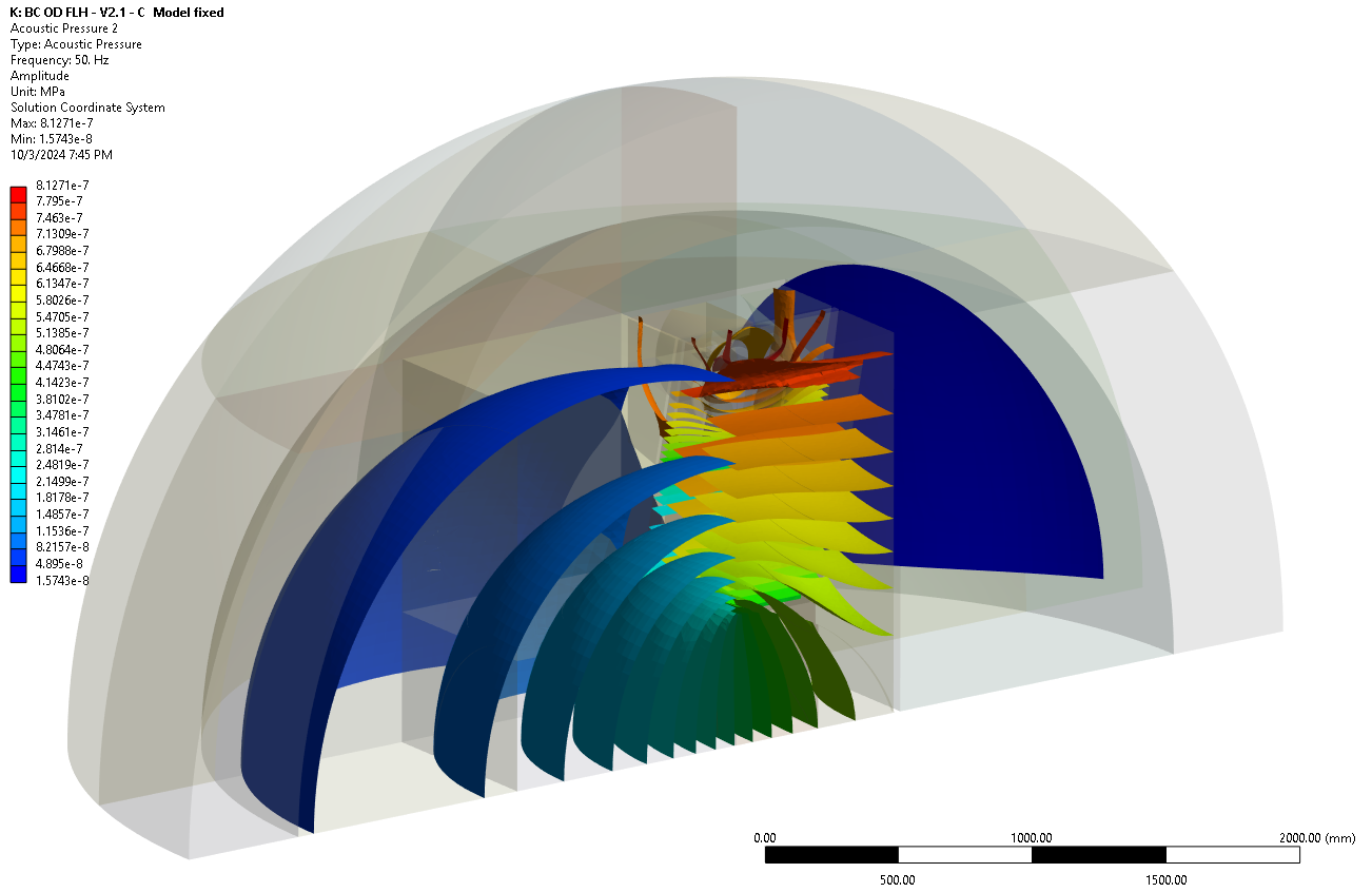

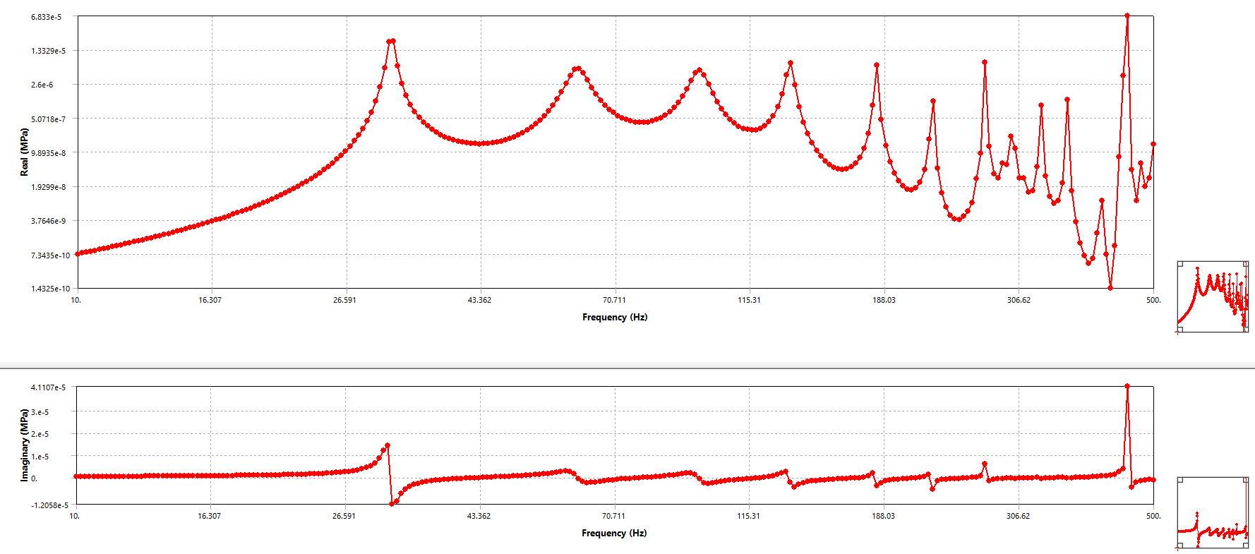

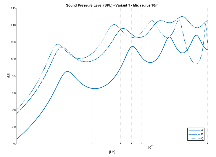

The IPAL, 14.2V RMS, mic at 10m (beyond the mesh domain):
A: 1x18", single configuration.
B: 2x18", horizontal configuration
C: 2x18", half moon configuration

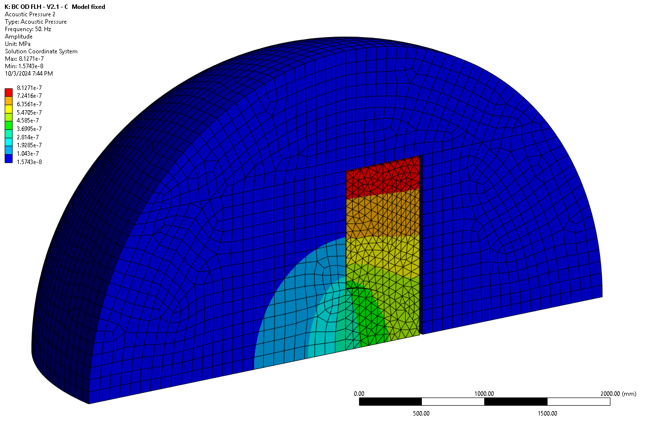

Some colorful images to get an idea how the acoustic impedance is retrieved:
Note: the images are for an older simulation. It is easy to think 'this is great and we can do everything with FEA', but in this case it is only used to get the load on the driver's diaphragm, shown below, and we do nothing with all these nice images, besides printing it and hanging it on the wall 🙂. In this case the ANSYS simulation only takes care of the acoustic part. Without the electric and mechanical part you cannot simulate the complete package. It is ofcourse useful if directivity results are required.
In ANSYS Mechanical the diaphragm is excited by a fixed (complex) velocity and by exporting the average pressure on the diaphragm we can calculate the acoustic impedance. Example of complex pressure on front side of diaphragm:

Okay so if i get this 10m graph correctly, even if 18ipal response looks worse (we could probably fix that with ipalmod) it is still more sensitive than 18sw115 even at dips (or about the same)?
With using ipamod many TS parameters can be "manipulated''. Not exactly sure which ranges since info is quite limited but i found you can adjust virtually:
Mms
Qes: 0,2 - 0,3
Qts: 0,2 - 0,4
Qms: 5 - 10
Re
Le compensation
Bl
So in theory we could get 18sw115 response with better sensitivity and better control?

My gut feeling says the graph shown above cannot predict the real world results, and the only thing to do is try, measure, and see if this "Virtual driver Mode" or "Differential pressure control mode" can improve SPL, quality, control etc. over a 'standard' driver like the SW115.
One of the reasons is that (as shown by Mr. Bennett (B&C) in his interesting Youtube videos) parameters are highly excursion (and temperature) dependent. I do not have experience with running these speakers at nuclear levels for several hours, so I will not guestimate what the result will be. However, it sounds very interesting if I read the PDF of the Ipalmod! 🙂

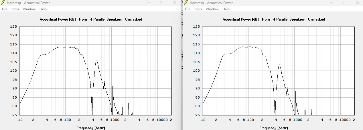

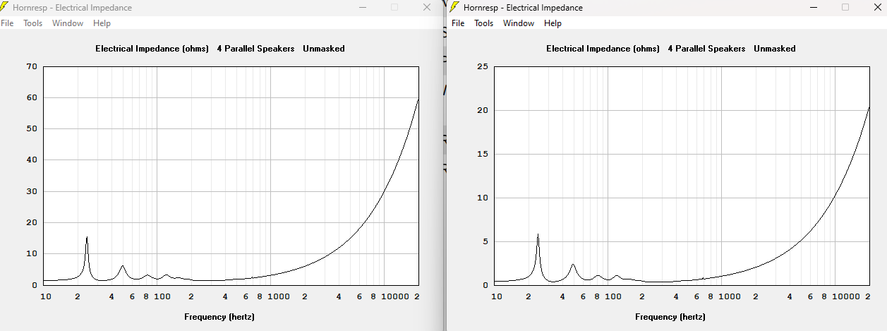

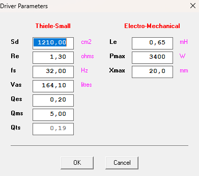

Did some sims in hornresp using slightly modified 18ipal TS parameters
Raised Qes to 0.2 and raised Qms to 5, this causes Bl to drop to about 20,5.
this is only to see what happens, other parameters might be even more optimal
Here are results 18sw115 left 18ipal right
1cab:
4 cabs:
Impedance curve(really close to original danley?):
Maximum spl 4 cabs:
Really close, I suppose 18ipal has slight edge here in real life since probably it has better cooling and better limiters

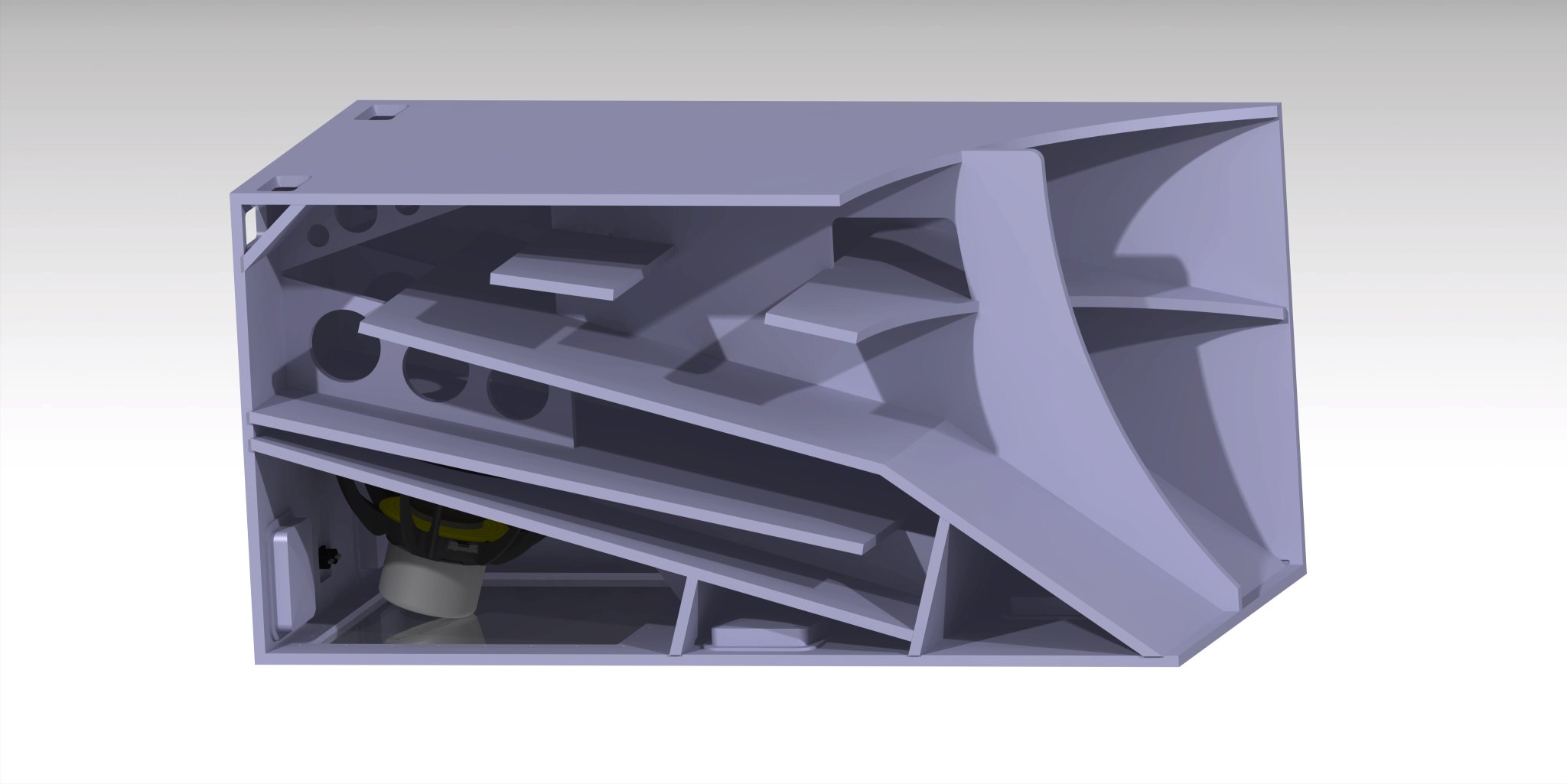

Here are some pictures of final model
Position of pressure sensor:
A bit updated bracing:
I hope build will be complete till the end of the year. As said we will test 2 boxes with ipal and 2 boxes with 18SW115 8ohm. I could borrow some original cabinets from local companies. Main brands are Meyer and d&b.

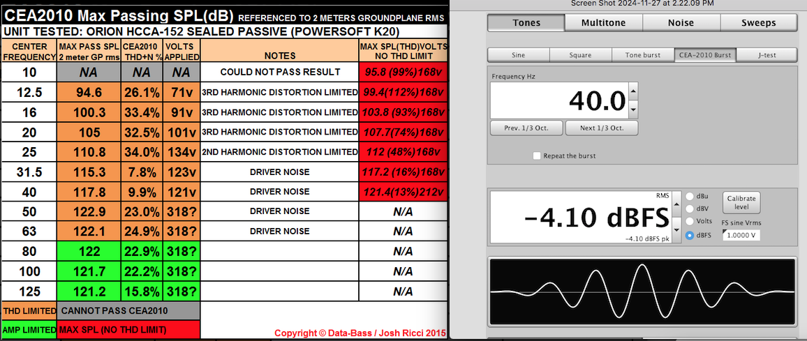

The CEA2010 burst test like Josh Ricci performs would also make for a good comparison:
https://data-bass.com/articles/5cc0bc36a75a260004255c88#a8818f1098c631a55c361b06d9fad10f
REW has the burst test tones included in the noise generator.
Thank you for suggestion @weltersys . Those are the test that seem to reflect real world preformance most realistically.

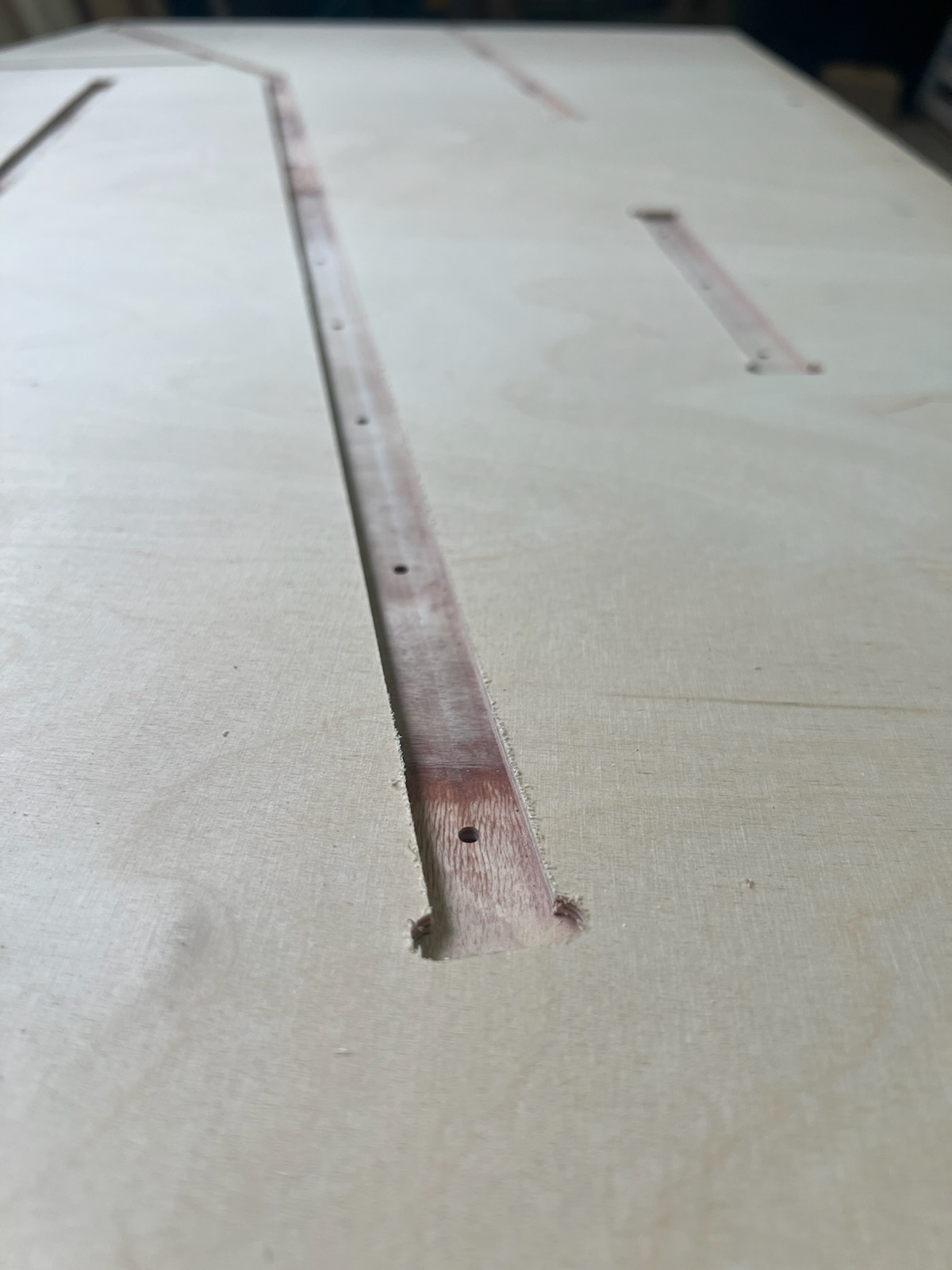

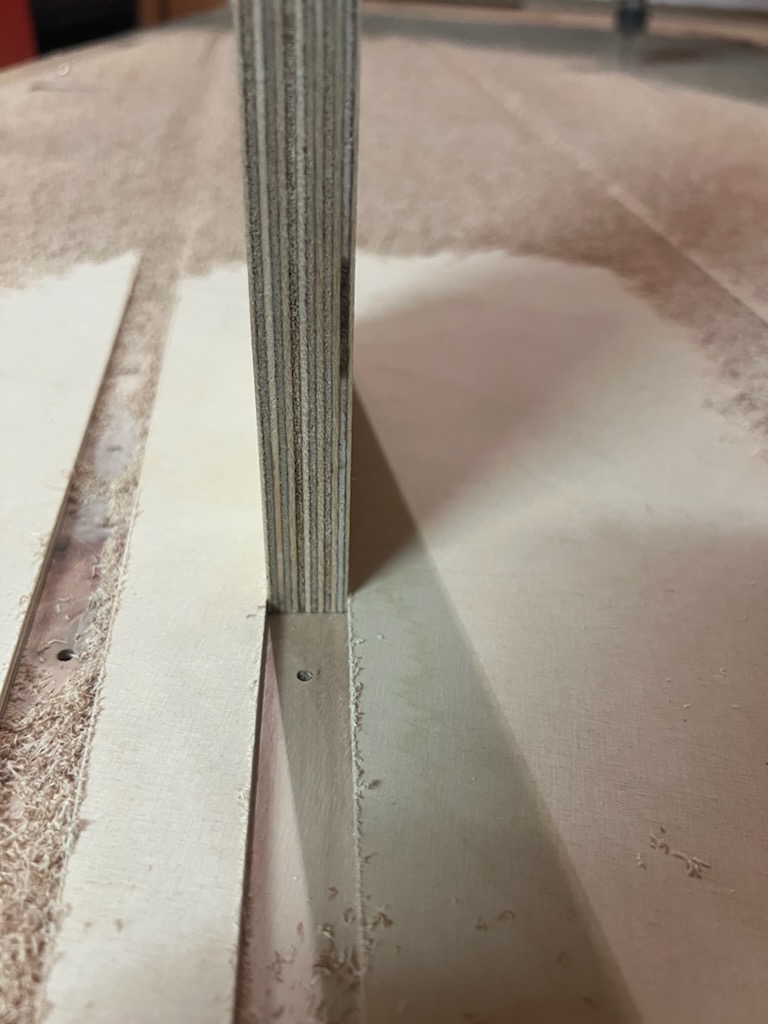

Also some updates, finally making progress:
Will post more pictures soon 🙂 trying to document entire build well, so anyone could build it. Also will post my detailed 3d model and my dxf files for CNC, just want to wait a bit to see for sure if they are without any mistakes.
