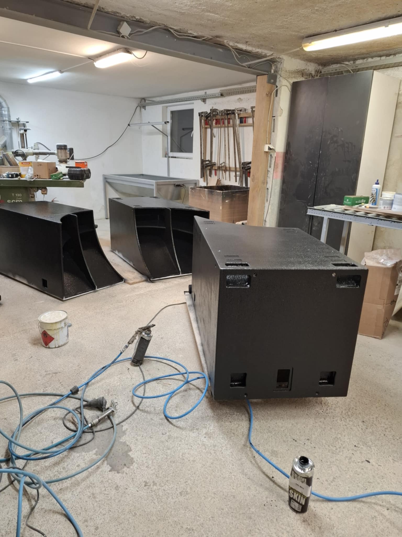

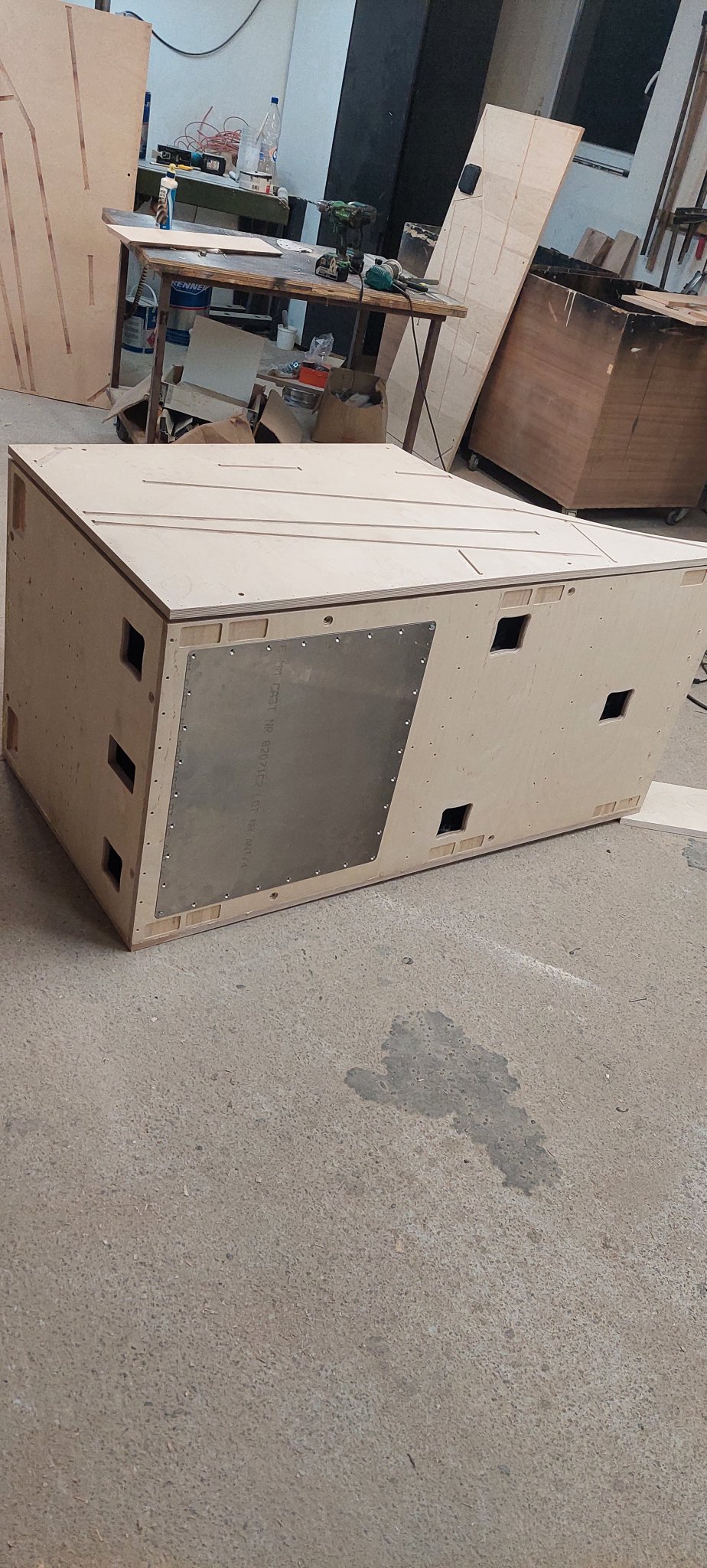

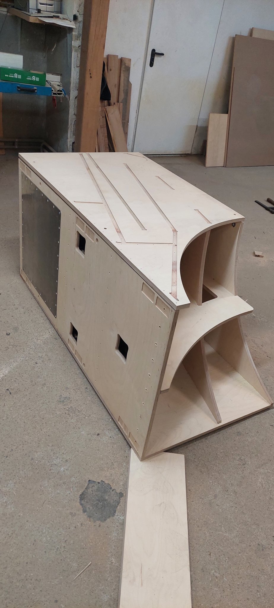

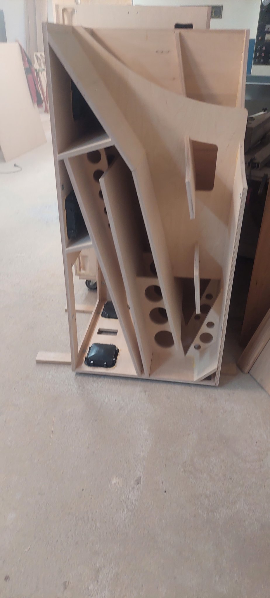

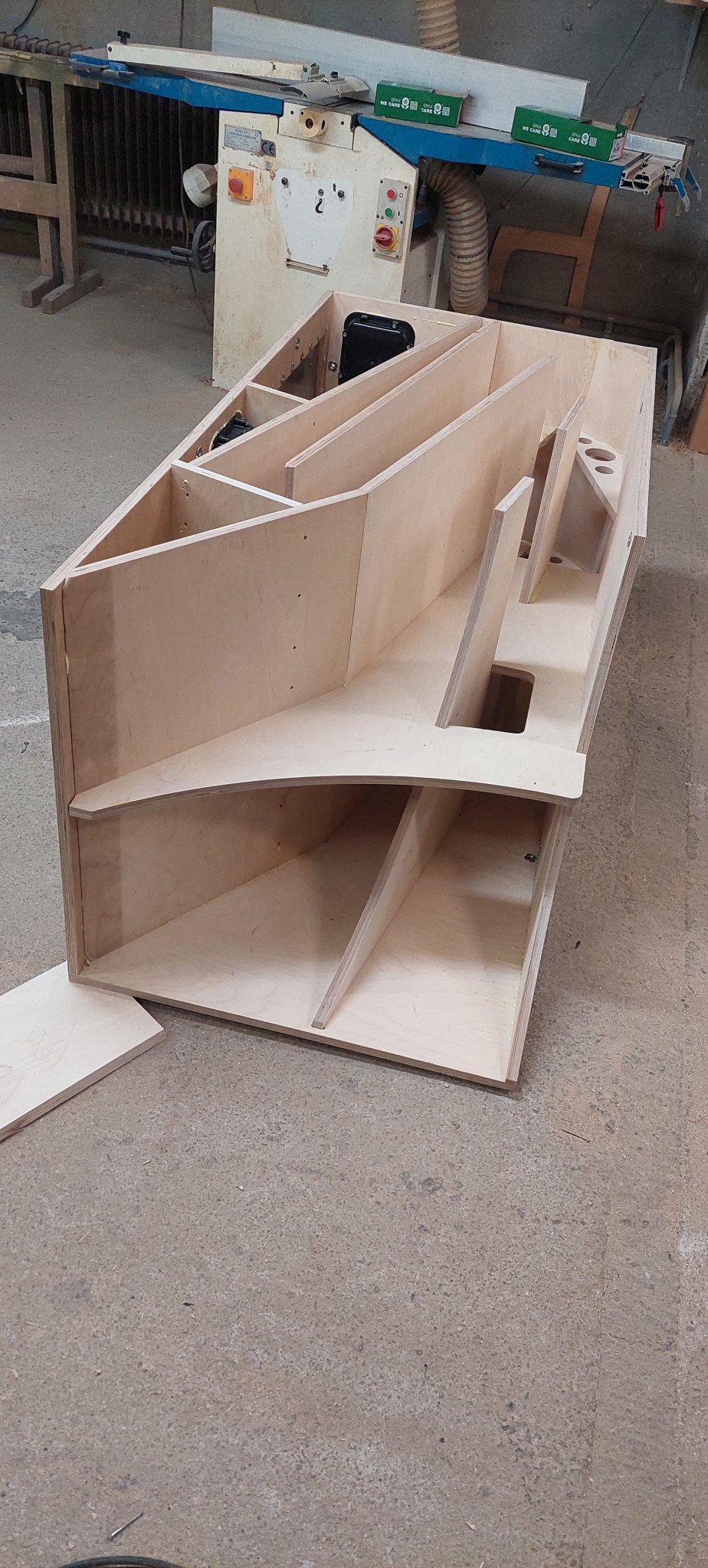

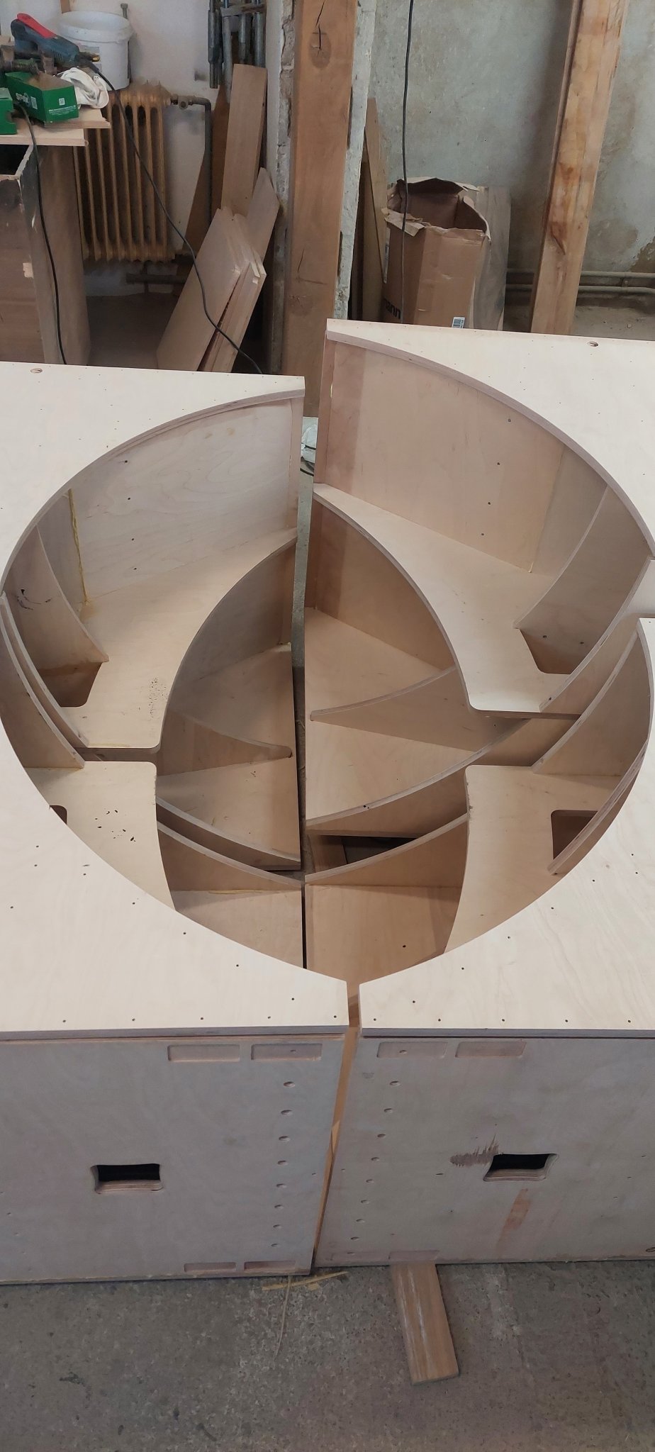

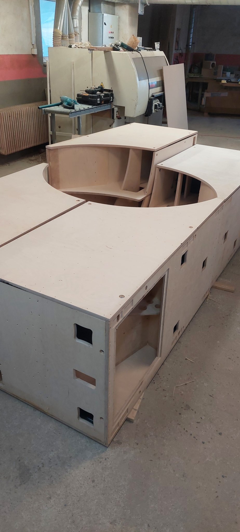

Here are some updates on build:
Still 3 more to go, hope to get them assembled this week

Looks very good when doing some minor cleaning of the edges and coating 😁
I am very curious of you manage to achive your simulations and get close to the originals performance wise.
Will you messure all 3 setup options ? So stacked ontop of each other, than the side "eye" arrangement and them just pointing downwards coupling with the floor?
And yea I am still open to Chinese clones might do it for the start when building subwoofers that are demanding wattage wise like these 18 inch but I honestly like also the sensitivity route using small drivers. I do projects usually with a big crew so we got luckly enogh hands if it would be just me alone I would tho 100% agree to skip the whole Class A/B/H... Maybe exept for HF section if you can't afford a nice HQ class D.
My friend always says "Having heavy things is stupid, But cops won't confiscate it atlest 😂🤣"
Looks very good ! Some small cosmetic work getting the rough edges nice and smooth and some paint will prob tie it togather nicely altho atm anyways does not matter I guess you will messure them first.Mentioned sinbosen since we have d2 4200 that we use regularly without any issues, powering 4ohm loads close to limits often.

I take a lot of time after assembly to make boxes visually perfect. It is an important thing to me, testing will be done in all possible configurations when build is 100% finished, I do not want to rush things. Can't wait to turn them on 🙂Looks very good when doing some minor cleaning of the edges and coating 😁

Boxes are relatively heavy but not unmanagable in my opinion, will weight them accurately as possible when completed. 3/4 assembeld, 1 more to go.
Handles are from ADAM HALL, ordered from thomann, very nice quality, and relatively cheap.
IMO it should be a well preforming horn sub, I doubt there are many things that could really be improved significantly.
Nice fast progress! You should probably put a messurments sensor in the rear chamber and maybe a contact thermostat on the driver if you have when testing just to monitor the temperature because it's a closed chamber design. Especially when measuring you wanna keep a simmilar temperature to compare It well maybe and also adjust possibly the RMS limiter.
Have you tried out in your simulations other drivers potentially? Or only for the pair you have yourself ?
I am curious how the difference will be sonicaly to the originals in the messurments because the slightly diffrent internal folding and horn opening the original expands the horn a bit later in the relation to the middle separation "wall".

Cant think of another driver that is comparable other than 18 Sound 9601C. I have a pair of 18's that simulate well in this cab also. (Beyma 181000fe v2) But these drivers are no where in the same league as the BC. Will see what the future holds as I have had these sitting on a shelf for a little while. Wondering what I was going to build with them.
