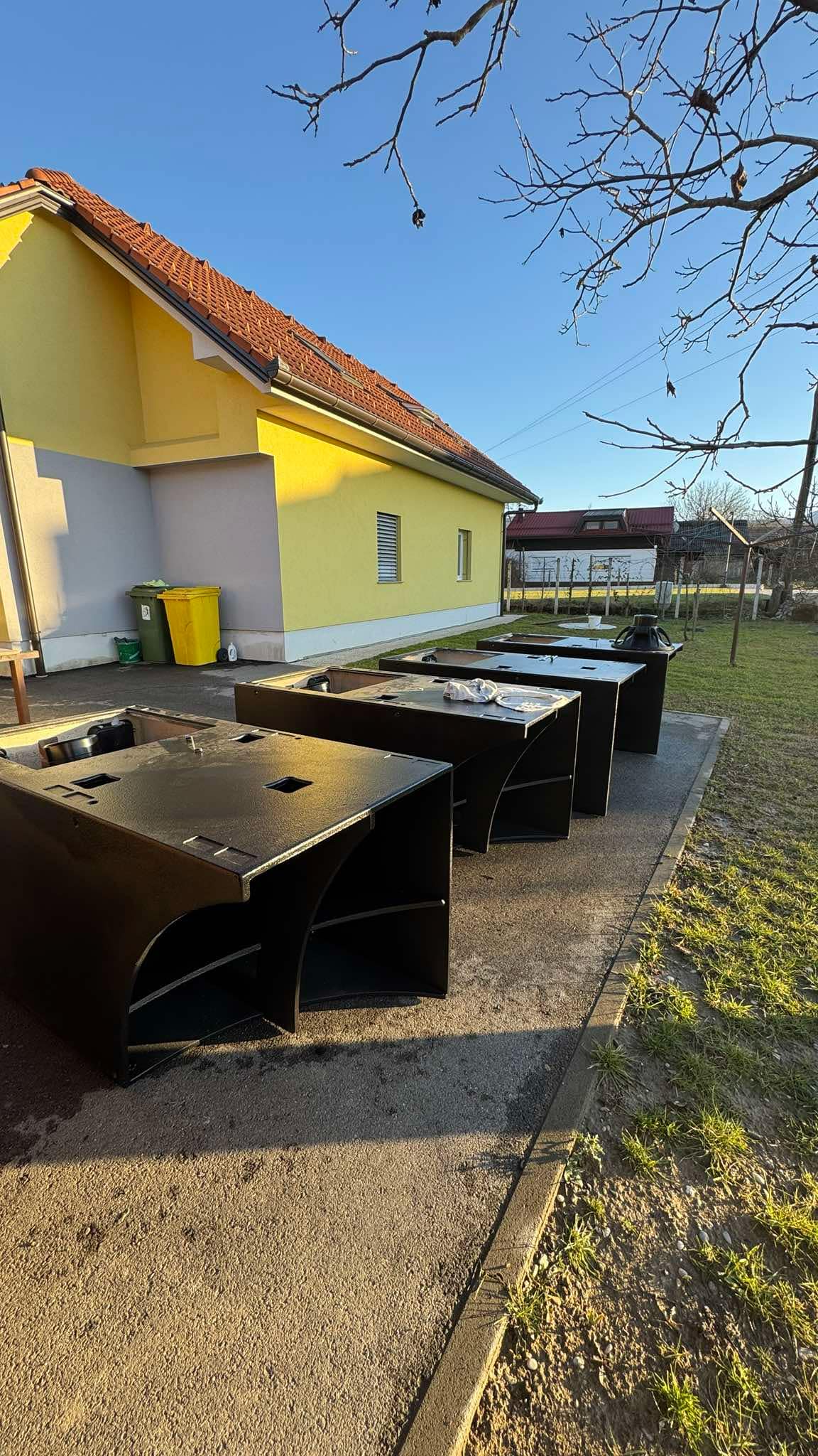

Testing with 18SW115 drivers for now, those things are brutal, go to 30hz with real authority, modulate voice, you name it 🙂
Subjectively quite a bit more output than 4 tapped horns (similar to Xoc1 th18).
Directivity is excellent also, a lot better than i expected, paired with synergy horns this setup offers excellent rear rejection, bass is almost non-existent behind.

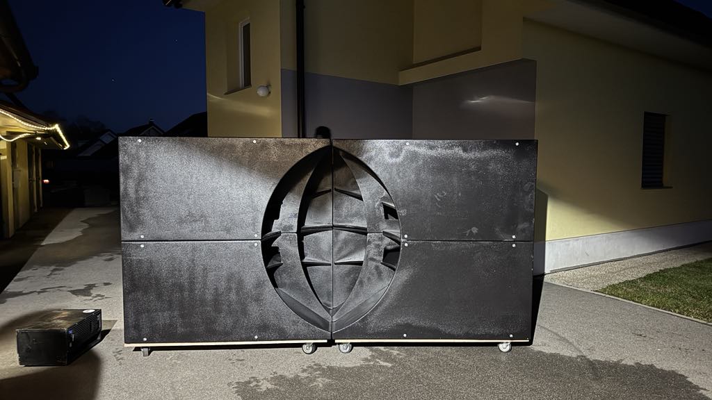

Wow!!!Testing with 18SW115 drivers for now, those things are brutal, go to 30hz with real authority, modulate voice, you name it 🙂
Congratulations Amigo!
The build looks fantastic and very symmetrical!!
What's the configuration possible with those cabs, just the big eye?
Or you can put a pair with the ground plane as half eye? 👁️
I will call your build "Big Eye" 😎
Yes, this design actually offers more possible configurations than original design, there is eye, half eye pointing down, standard flh stack and even half eye config consisting of 2 cabs horizontal for not high enough stages (2 cabs are then 3x0.75m in dimension)

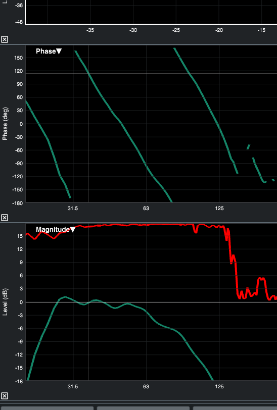

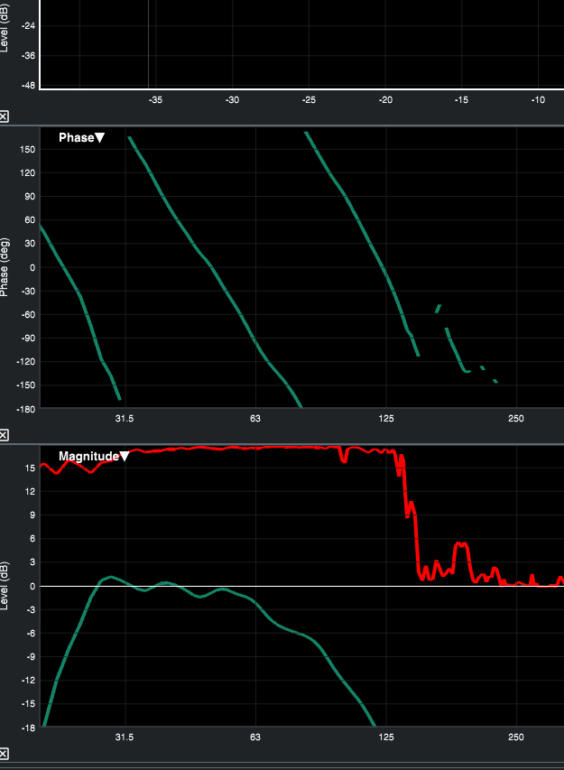

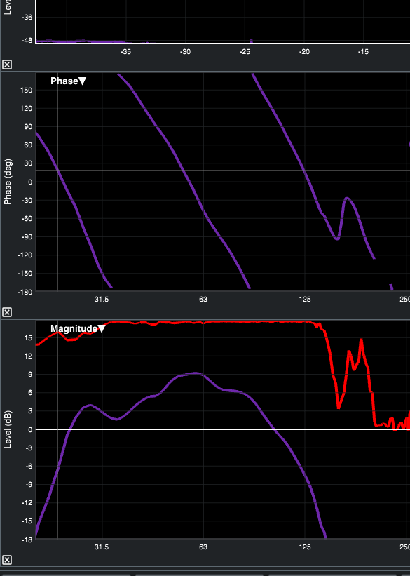

Here are response graphs, really close to original I think
No EQ, only crossovers BW24@22hz and LR24@80hz
Corrected response, same filters:
Flat 28hz, -3db is at approx 25-26hz, -10db at about 22-23hz. In corrected response only high shelf is applied to upper frequency reduction and gentle 40hz bell boost, Measured at about 5m distance from 4 cabinets in eye configuration.

Intresting happy to see them completed with the first messurments.Here are response graphs, really close to original I think
Directivity is excellent and VERY noticeable, I expect at least 10-15db reduction, will measure it when weather gets better
Without EQ comparable indeed with a simmilar peak. I would be interested if these can also play as high as the originals to around 150 Hz or atlest ?
Seems like they probably could tho but hard to say when having the cutoff filter that low. Especially the corrected grath rolling off around 60Hz is rly early for a sub like this but i assume you must be running kicks with them.
Besides that when you measure them again would you be able to measure also the distortion? That would be also quite interesting 🙂
Also the sensitivity at 1W would be quite intresting.
And as a tip for posting Smaaart measurements sharing the smoothing would be great 🙂 or ideally posting it with and without smoothing.

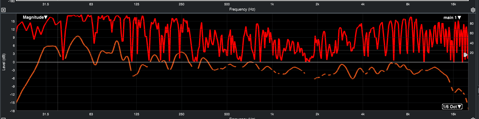

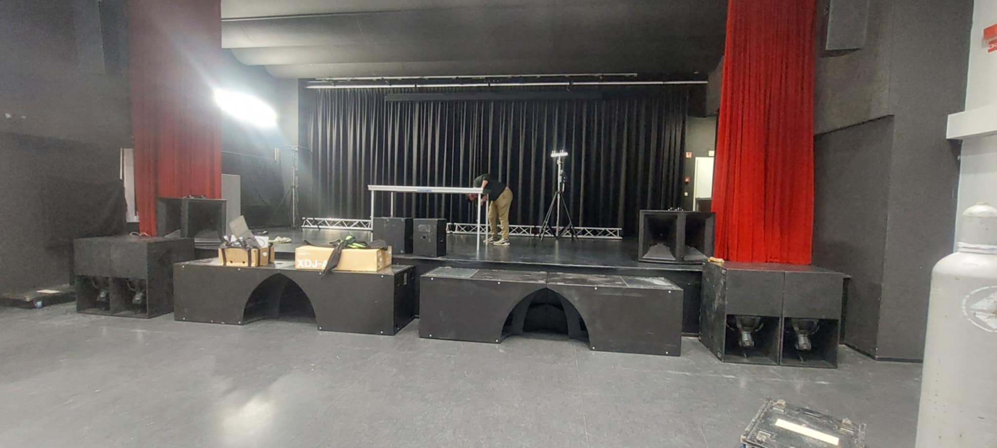

Here are this weekend show results:
Setup picture (Tops were flown later ofcourse):

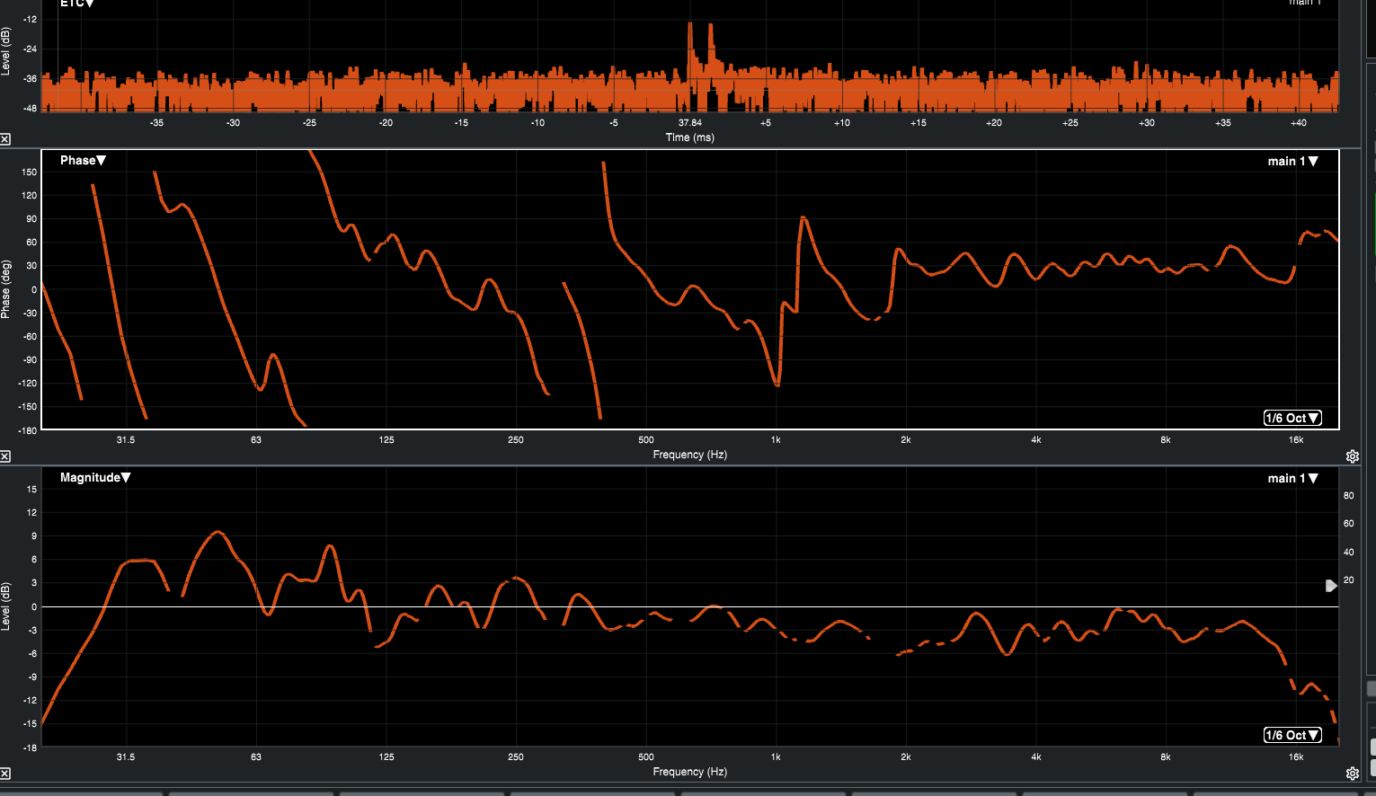

Frequency response without any EQ (Except a bit of 60-120hz reduction on BC118 as mentioned in first measured graphs), only delays and crossovers set. This place is acoustically very very difficult. Here are smaart measurements 1/6th octave smoothing.
Coherence is really bad due to bad acoustics:
Subjectively it sounded decent, BC118 integrates nicely with tapped horns, only a few minor dsp settings were needed. Overall SPL was just too much for building, windows were rattling on all floors so we were asked to turn it down a bit, Aluminium plates were completely cold entire night, I think we hit about 120V on peaks sometimes, so did not push them too hard. Waiting for outdoor season to really push those boxes, indoors tapped horns might actually be a better solution IMO.
Any questions welcome 🙂
Also sensitivity seems to be similar comparing 2 BC118 and 2 tapped horns (40-60Hz) - BC118 goes quite a bit lower tho
