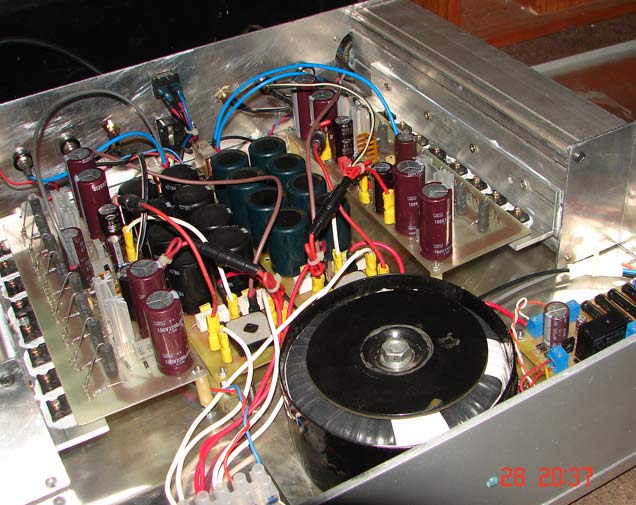

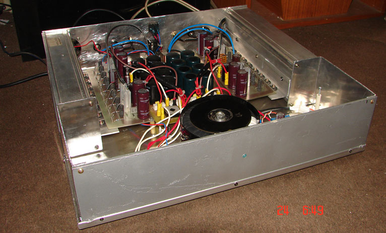

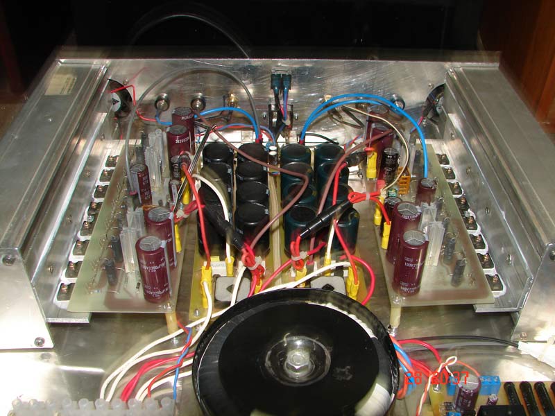

Only 33C??? 😱Send us few pictures.
Hi vicktor,
Here are some pics of my amplifier. It's not very clean because this is the first time I am putting amplifier into the box and the enclosure is also completely home and hand made 🙂

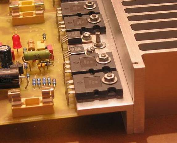

I can see why Wasim's fanned heatsinks run @ ~ 33degC.
The thermal resitance of that thin angle bracket ensures the output devices run much hotter.
Excellent remark AndrewT, I haven't pay particular attention on details on those pictures, but you pointed it right. L-profiles are not thick enough. Material should be at least 5mm for such amps. With lower power amps Wasim, you can use lighter L-profiles, but for such power as StageMasterMK2, they should be of a heavier gauge! Also, thermal paste have to be applied between L-profile and main heatsink!

Yes AdrewT is right the L bracket is not very thick. But sir, I took the temperature rating of the both the heatsinks and the L bracket and the temperature of the both are approximately the same.
I biased the amplifier on 50mA per pair and the heatsink was hot like 50C to 60C and now I adjust the bias on 30mA per pair per FETs. On 30mA it's producing 33C temperature. This was the whole situation.
But I am convinced that I should change the L bracket to 5mm thickness for its long life 🙂

increasing the output bias from 30mA/pr to 50mA/par should not increase the Ts from 33degC to 50-60degC.
there is something wrong.
Are you sure the 33degC is as much as 30mA/pr bias. It seems more like 3mA/pr bias.

I have replaced the angle brackets with 6mm thick brackets and now the heatsinks are getting quite warm. The bias is the same that I had before 30mA per pair total 120mA.

Finally, that’s OK Wasim. Now you can see why AndrewT suggested heavier L profile… heat transfer is now much more efficient.
