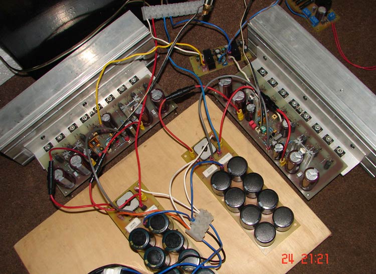

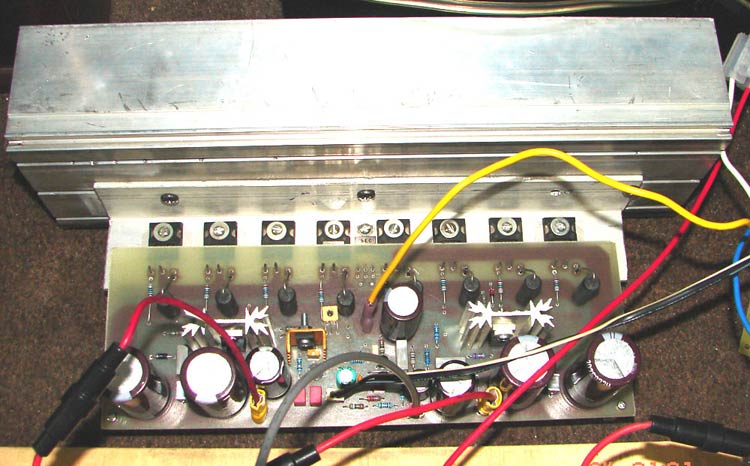

Hi everybody,
I have just finished Legend stage master, one of the Dr Bora's amplifier design. I have tested the amplifier and it sounds really good. I really appreciate the help he has provided me during the project. Dr. Bora is very nice and helpful guy. If somebody really wants 250Wrms into 8 Ohm he must try this Legend stage master design.
Once again I am thankful to Dr Bora (Sir)
Regards
Wasim

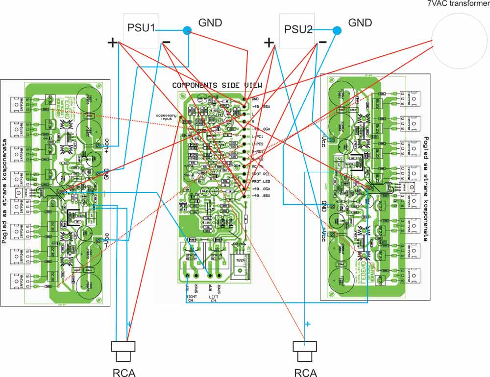

Hi everyone,
Can anyone check this interconnection diagram and correct it? I am using two powersupplies. I would also like to use seperate transf. for 7VAC.
In other diagram can anyone guide me if I use +/- 70VDC what are the values of these * marked resistors. I am very thankful for the help.
Regards
Regards

Hi everyone,
Regards

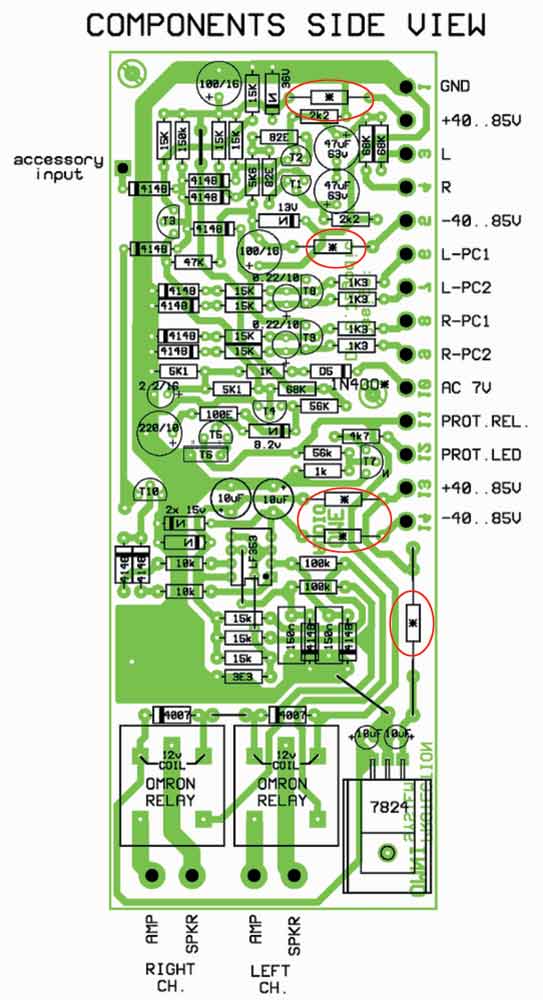

I'll help you around the resistor values, but above all should pay attention to several things.Capacitor of 100uF 16V should be replaced with a capacitor of 100uF 50V-63V because it is parallel with the Zener diode of 36V.Two of the 68K resistor at pin 3 and 4 I replaced with two resistors of 56K because I wanted to reduce the response DC protection.All Zener diodes are 1.5W.Capacitor of 100uF 16V would be desirable to replace the 100uF 25V because it is parallel with the Zener diode of 13V. Accessory input serves to add some additional protection such as temperature protection. resistor of 56K may need to be changed
with 47K or 33K, so if the LED is not glowing then reduced to 47K ... 33K.
2 * 10uF next LF353 are 25V. Resistor of 4.7K, above T7, determines the current through the LED, with a 4.7K current is approximately 2.5mA if Vf diode approximately 2V.Resistor of 3.3ohm sets minimum impedance speakers will be connected to an amplifier. Two capacitors of 10uF next LM7824 are 50V-100V.
You watch the picture from above ...
Resistor that goes to the + V is about 3.9K, better to take 2W.
Resistor that goes to the -V is about 12K, better to take 2W.
For the two resistors in a red circle take the 7.5K or 8.2K, better to take 2W.
Another resistor should be calculated from the pin 13 and LM7824, this is perhaps the most difficult part of the job! Protection has two states, one state relay when switched off and another when engaged when the amplifier connected to the speaker...
You have to choose the relay and immediately see that the resistance spool, or find information how mA spent relay. Which relay are thought to use?

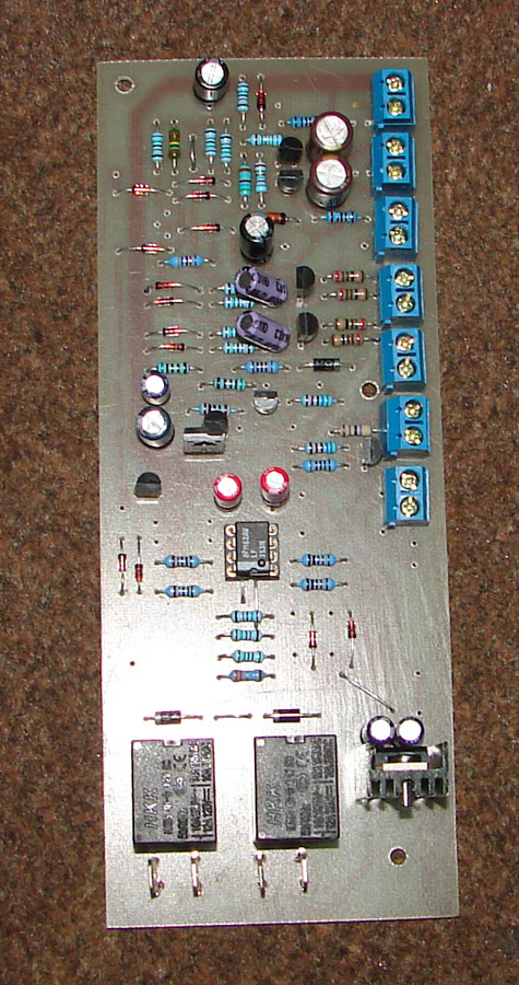

Hi viktor1986,
Thanks for the reply. I will change the components as you described. Look at the OMNI protection and The relays I am using. Can you please`also check the interconnection diagram. I also need to correct it. Can I use a separate transformer for 7VAC ? I really appreciate your help.
Regards

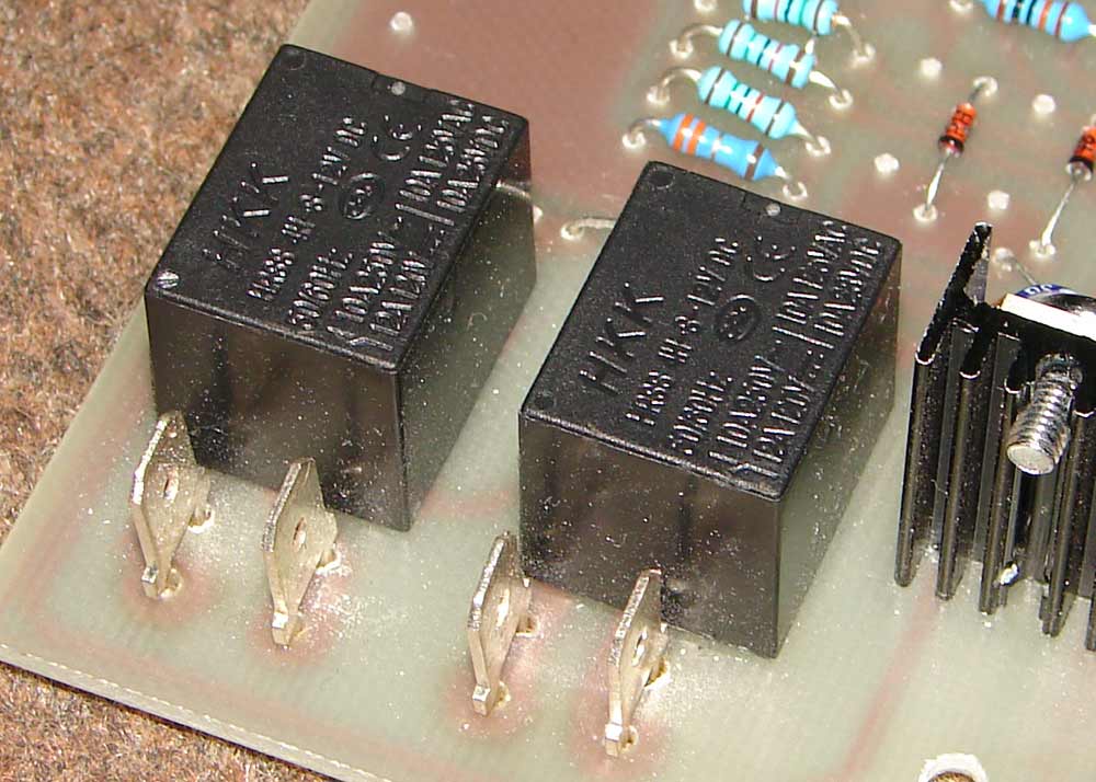

Find on Google Datasheet for the relay and see resistance of the coil.If you can not find data on the resistance of the coil take good multimeter and measured. Using Ohm's Law get electricity! This is the total amount of electricity which passes through the relays as relays are connected serial.
Find information about the resistance of the coil relay or measured and write down here.Ok?
Connection is not good, after we see it, the first around these resistor values
If you are sure that the resistance of the coil is 400ohm, the current through the relay is then 12V/400ohm=30mA
View image!
Is the relay of 10A? I do not know whether it works reliably as Ipeak Legend is 7.9A
http://img132.imageshack.us/i/slika072.jpg/
View image!
