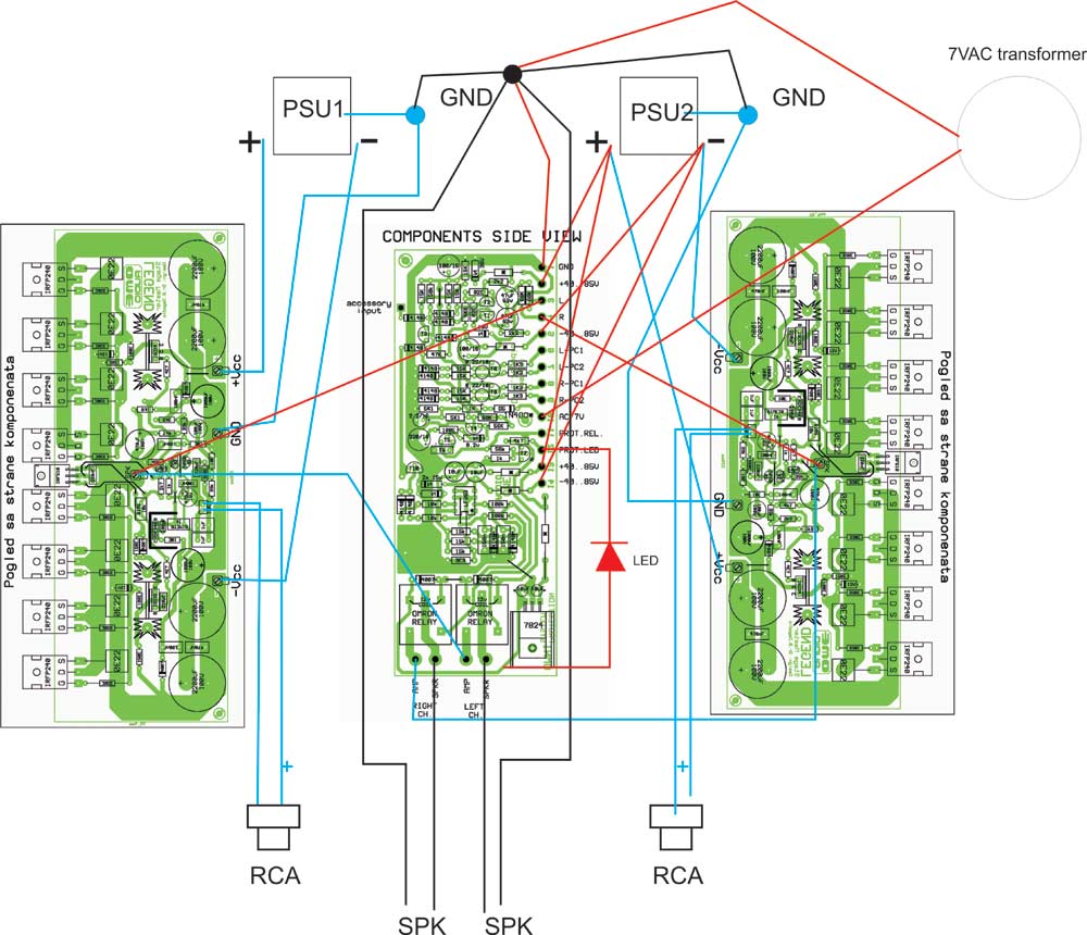

Yes relay is 10A. I understand your diagram. Thanks a lot for the help. Can you tell me about the interconnection thing?

It's better to use 16A relay... Just worried for the relay of 10A ,not to stick contacts!
Now we have to solve the cross connection...
I apologize for the bad picture but I really did not have time to do better.
Pins 6,7,8,9 are free, they should not be linked because they have no purpose for such construction
No Problem I am trying to understand it I will make refine diagram and post here. you just double check it I will post it later today. Thank you very much for the help

No, the LED goes exactly according to the scheme, the anode goes to +24 V and the cathode to pin 12, pin 11 not used.
Another thing, CT transformer goes to the ground by the power of the electrolyte and also minus the speakers and then the one common point GND
You do not have to use a transformer for AC voltage of 7V, using two resistors with existing tranformer 2 * 50V AC get 7V AC.

Hi I just have redraw the interconnection diagram please just double check it.
I would like to ask one thing; In this configuration when I turn on the amp will both of the supplies will turn on silently?
should I use Two separate supplies for separate channels or one big supply for both the channels?
Currently I am using 40,000uf + 40,000uf capacitance bank for two separate channels is it fine?
Just advice me on that. I want my supplies to turn on silently.

You did not connect well, see the corrected image
How do you think that the power supply include silent? Have you thought of "tump" in speakers? At inclusion, a few seconds after the relay will include silent speaker.
Please read this, http://bas.elitesecurity.org/OMNI-english.doc
You need soft start for power supply.

changing from 10A rating to 16A rating may make little to no difference in the risk of contacts sticking/welding/arc not extinguishing.It's better to use 16A relay... Just worried for the relay of 10A ,not to stick contacts!
The DC rating for breaking a continuous fault current is a very onerous specification.
You may, maybe should, take other steps to ensure the relay stands a real chance of breaking a DC fault current when you expect it to do so.
Opening the speaker feed AND shorting the fault current to ground improves the situation.
Fitting supply rails fuses that are close rated helps.
Fitting an input mute helps when it is the input signal that is generating the fault current.
Rail crowbars are another option to consider.

It is working LED is on now. Thanks a lot. Now I have to put all in a case and then see the result.

Do you changed the value of the 56K resistor? What is the new value of 47K ... 33K?
