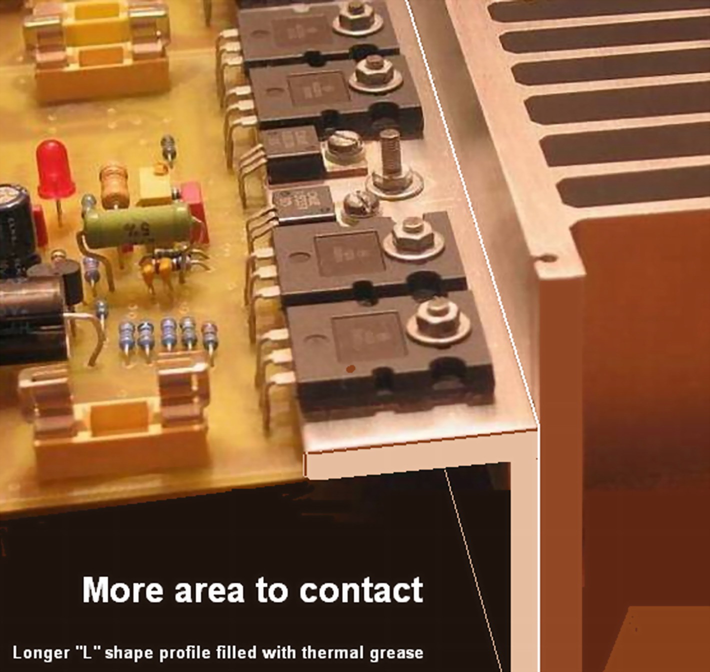

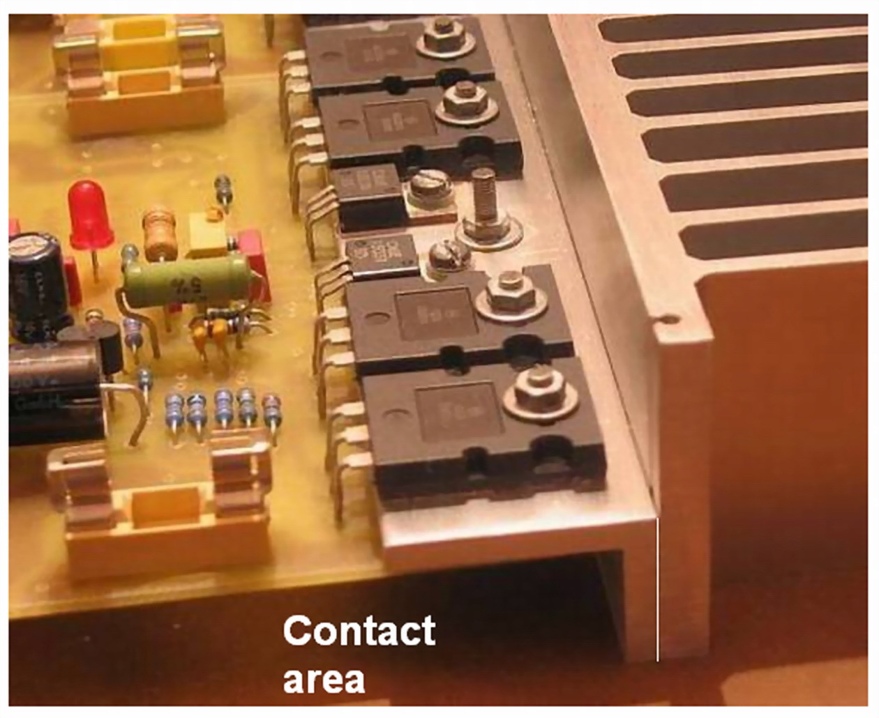

I love this way to build things folks... the "L" shape profile or a flange
into the main heatsink (better to thermal transference as you know)
I feel worried about heat transference from the "L" profile to the main heatsink..even using thermal grease, the area is not fine.
I am posting images..showing a better option for the "L" profile dimensions.

I have posted that picture mainly to highlight a necessity of using heavier (more thick) material of L profile, but it is certainly always better to have contact area as big as is convenient! You are absolutely right there Carlos. I am personally not against L-profiles because if they are of a sufficient thickness and contact surface, they won’t be much behind “directly on heatsink” approach. On the other hand, L-profile will have much lower thermal inertia than the main heatsink, allowing faster thermal--bias regulation.
Finally, that’s OK Wasim. Now you can see why AndrewT suggested heavier L profile… heat transfer is now much more efficient.

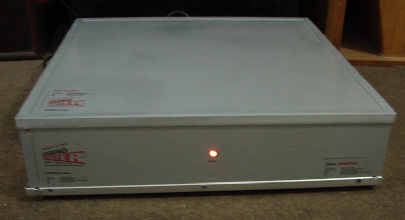

One more thing, where are the air-inlets on your Legend amp housing? I can’t see them on those pictures!
That shouldn’t be a problem Wasim, but I am curious for what will that next project be intended for? Both amps you mentioned are for home listening and belong to higher quality class. MODUS (old name TECHNO) will produce about 80-100W and SIGMA will deliver about 150W on 8 ohms. MODUS might be better and easier as your next project. PCB and Layout files for MODUS are available from me on a direct mail.
Hi dear Sir,
I would love to make Modus amplifier but I am trying to find out the transistors here locally. I will email you for sending me all the files.
Sir, for air inlet I placed two fans at the back of the amp panel is it not enough?
Regards
That is probably enough, but I am talking about openings where air is geting into the housing! If fans are sucking air from the case, that air has to get in somewhere? (or fans will soon start blowing out the "white smoke"! 😱😀)
