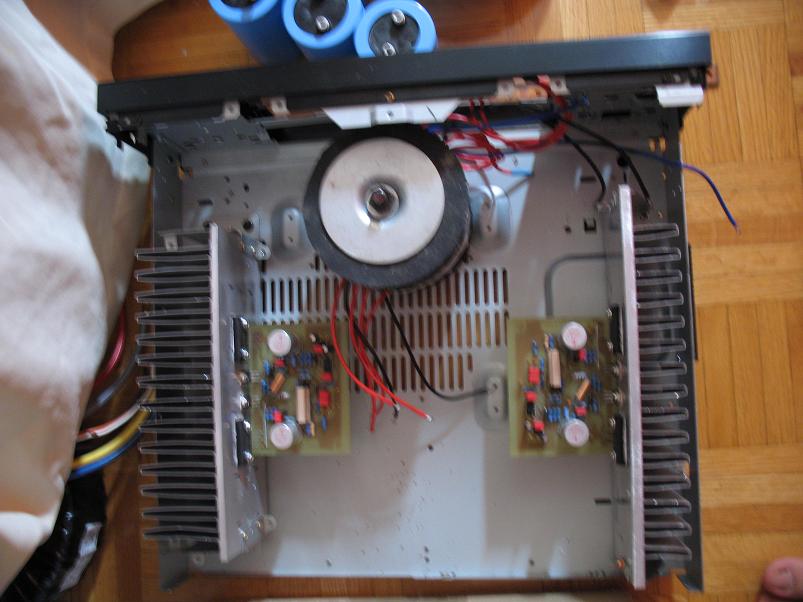

Hello Dr Bora
I just find two toroidal transformer for the amp 27.5-0-27.5VAC 265VA each .
The transformer firs I tought to use the VA rating was to small for two channel and the voltage was a bit to high 30-0-30V AC. The capacitor (1000uF only 40V rated ) I do not want to change those capacitors (made by Frako) I did some test in a another amp about the 1000uF capacitors in the Symasym amp about two years a go . I did com pared many different caps like Panasonic FC series , Rubicon , Nichicon Muse etc but the Frako was far the best capacitor . Of course I didn't kept the Symasym amp it sounded somehow to thin with my speakers .?? Not my taste . Not much involving into the music .Somehow sound dry and almost clinical like the M Hiraga . I know many people say all capacitors are the same but that is far from the reality .I did tested one channel com pair to another channel with same set up . I can tell there is a huge difference between capacitors . Of course sometimes is more important which capacitor feet better in the project you working on . Even BG can sound bad in some circuit .
So now son I can set up at least one side and test it .
I will definitely let you know the result .
I spent to much money on it , it would be vaster to not to finish it .
I have a question do I need a preamp or if I use a pot that would be OK ? Or I need min. a buffer ?
Regards

Hi friend!
DOGC-MK3 is designed for +/-42V DC supply and it is shame that your electrolytic caps are limiting factor forcing you to reduce that voltage. But, that's your decision. Just expect less power… say… 50-60W.
I know you will be pleasantly surprised with fullness and depth of sound of DOGC-MK3 compared to Symasym, even thou Symasym is a very good design but it might be that it don’t suite your “taste”.
In most cases you will need some kind of preamp and a high quality pot but I don’t think you need a buffer. DOGC-MK3 will certainly work even without preamp but it is very likely that you won’t be able to excite it to full power with standard output levels form today’s CD players and alike. If you decide to build matching preamp, I suggest you to wait a little. That my preamp (FlatBT) should be available soon as a KIT, because I am starting very soon to offer internationally some of my better designs as KIT-s, as well as separate PCB-s for some of them! Both DOGC-MK3 and FlatBT should be on the list!
I just noticed on your picture, left and right heatsinks are not of the same size (and thermal capabilities!) and I am not so sure that even bigger one (left one) will be acceptably hot!? You might easily be faced with a need for better heatsinks! If you don’t want to change heatsinks all you can do is to remove one resistor of 3,9ohms (originally there are two of them in parallel ) and that will half the quiescent current through driver pair and reduce heating on idle.
Hello Dr Bora
Yes one heat sink look bigger on the picture but the another one is a bit longer and taller . It is hard to see on the picture .
Both have almost the same weight .
I did made some holes on the bottom of the case were is the heat sink so the air can flow between the heat sink .
I will test it like these , if there is a need I will reduce the Iq a bit .
Both heat sink were removed from 7x100W home theater amplifier .
I hope they will be OK .

Yes, those two transformers will do the job nicely! But you got it wrong about quiescent current of the drivers! With two parallel 3,9ohms resistors drivers will pass about 320-330mA (not 400mA!) and if you remove one resistor current will drop on about 170-175mA. In idle state, outputs are practically without any quiescent current… maybe just a few tens of uA.
Be very careful about handling of the input MOSFET-s IRFD. Some people damaged them (I don’t know how) even before first turn-on?! Use protective resistors (about 10-15ohms/10-17W each) one in each supply rail! Don’t turn the amp on without them!!!

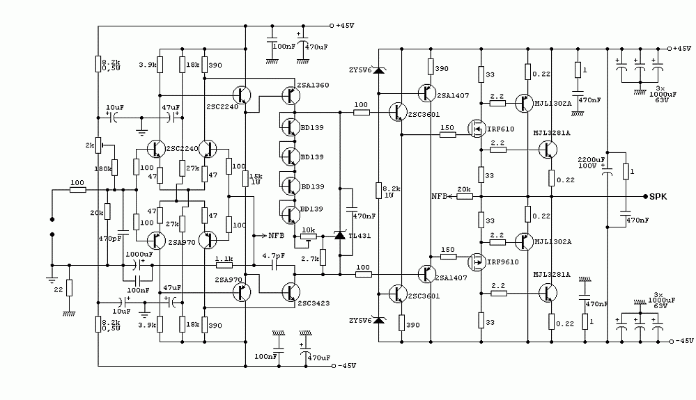

After I finish the DoGC MK3 and if I will be satisfied(probably I will) I think I will build one more amplifier from your collection .
I would like to build the Legend Stage-Master amplifier .
I have all the mosfets , transistors available at home , I have good quality 2200uF , 1000uF and 100uf capacitors .
My question to you it would be about the transformer size for two channel .
Please let me know what VA rating required . If I understood well these wold give close to 200W in 8 Ohm real power .
I'd like it because not much small transistors on the signal way.
Greetings
Greetings
It is clearly stated on the very schematic that StageMaster is capable of healthy 250W on 8ohms and that was proven in several cases from people which built it already.
If you can, try to provide a transformer of at least 800VA if only one transformer will supply both channels. If that transformer is of a toroidal type, make sure that you have some kind of a soft-start due to significant inrush-current inherent with high power toroidals.
Of course, you can go even with 500VA but if you are planning prolonged and “heavy” usage (hours of operation on very high power) then you are likely to have frequent problems! In that case of a “hard labor” consider some kind of forced cooling even if you have substantial heatsinks.
