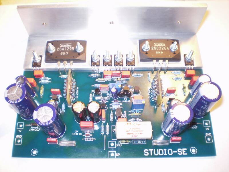

RAJ will send me boards to Studio Amplifier
In a couple of monthes i will be listening at them.
Yeeeesssss!!!
