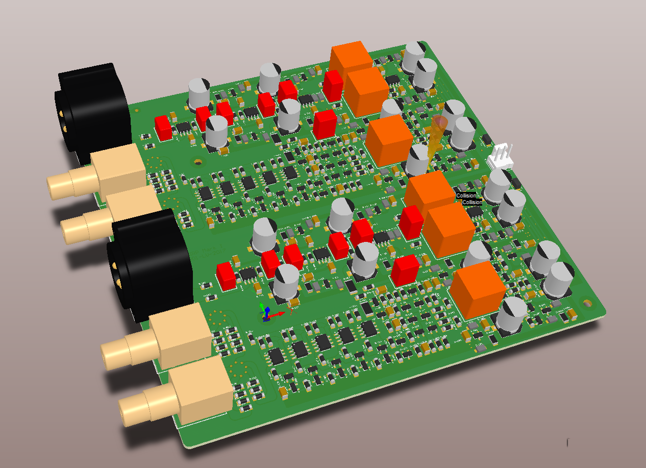

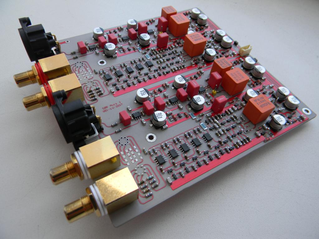

PCB finished, ordered, manufactured and 50% soldered.
3D view...

I design PCB for both MC and MM versions (MC version on picture).
Schematic was heavy modified. Only transconductance amp. with HF Eq. the same.
LF Eq, DC-servo, Output Buffers are different.
Now I waiting for PCB for external power supply.
