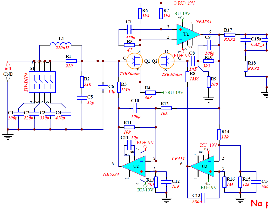

in general, is necessary C2 3u3 at the input in synthetic damping technique?
I think that in most preamps the DC blocking capacitor is needed. However, in a phono preamp that uses a JFET input like the way the VinylTrak does, no DC block capacitor is needed. Of course, the VinylTrak does not include synthetic cartridge loading, so this alone does not answer your question.
Since the synthetic loading feedback resistor is of a high value, connecting it to the cartridge will probably not cause a problem as long as the amplifier driving that feedback resistor has small offset, so that only a very small current flows in the synthetic loading feedback resistor.
Alternatively, you can put a DC blocking capacitor in series with the large synthetic loading feedback resistor and it can be of a much smaller value, and certainly not an evil electrlytic.
BTW, I mentioned earlier that I would not implement synthetic loading in the way Doug did. IIRC, Doug synthesized the load by hanging another op amp on the cartridge input to sense the signal. To me, this is intrusive and a possible source of increased noise due to op amp input current.
I have always used the approach where the buffering of the first stage of the preamp is used to provide the feedback signal for cartridge loading, much like that in the diagram shown. However, there is a tradeoff. If you start the preamp off with an input amplifier with a flat gain of 10X, then you will have reduced the overload margin a bit as compared with other phono preamp topologies. If your first stage can only provide 10V peak output, then the cartridge had better not supply a 500mV peak signal. Usually not a problem.

Hi
this is Dudek's Aktidamp 4 input, the synthetic loading is in the way which you prefer, do you think that damping circuit is OK for use with your mm input circuit presented in VinylTrak?

Hi
Hi Pawel,
I think it is compatible with a couple of caveats. The synthetic loading can definitely be used to load the MM cartidge more heavily, as is done in the "damped" mode in the VinylTrak. However, the first stage of the VinyTrak is an open-loop amplifier that includes the remainder of the 75us roll-off as a shunt R-C load on the VAS of the first stage. This means that the first stage does not have a frequency response that is flat, as is needed for a conventional implementation of the synthetic loading.
The solution is to take the R-C shunt out of the first stage and make the first stage flat, and then do the remainder of the 75us low-pass as a passive EQ after the first stage. I think the only disadvantage of this approach is that some high-frequency overload margin will be lost in comparison to the VinylTrak circuit. That extra margin in the VinylTrak is there because the R-C network that does the remainder of the 75us EQ keeps the voltage at that node from getting as large as it would if the first stage were flat.
Bob
