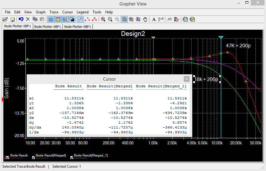

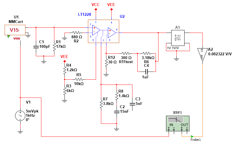

i simulated the 75uS response -- i don't think i will use a relay, just a molex jumper:
The simulation, fwiw, used the new transistors bob recommended, and the updated current mirror.

Is this answer suggesting that the V15/iv be loaded with 18k instead of 47k?
I believe that Bob calls it the "damped response" -- this relieves the first gain stage of the possibility of overload at 10kHz and up. He then compensates for the new curve in the RIAA amplifier.
Hi Jack,
Good explanation. The reduced load resistance brings one of the poles down in frequency so that it becomes real, allowing the addition of a zero into the 75us part of the RIAA response to compensate it.

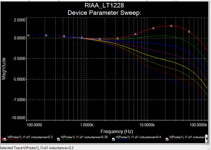

I'm still confused. If you model the phonograph cartridge as a low pass filter the transfer function has two poles and no zeros. If you reduce the Q to 0.5 by reducing the load resistor the poles are coincident on the negative real axis. As you reduce the Q further one pole moves out on the real axis toward minus infinity and the other pole moves in toward the origin. However if you model the cartridge as a parallel resonant circuit there is a low frequency zero at Rs/L where Rs is the source (cartridge) resistance and L is the inductance. The zero is much closer to the imaginary axis that the pole and is going to dominate the low frequency response. I don't understand how that pole is going to have much effect around 2,200 Hz.

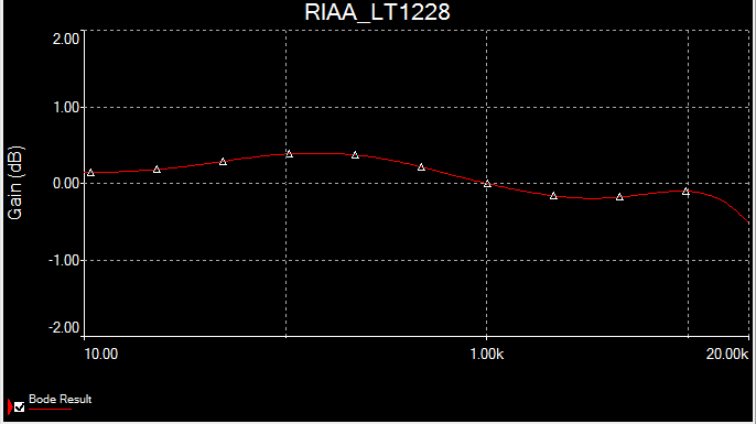

I swept the cartridge inductance from 300mH to 650mH with R1=18k
Hi Jack,
I like this data presentation. Quite revealing.
Bob
