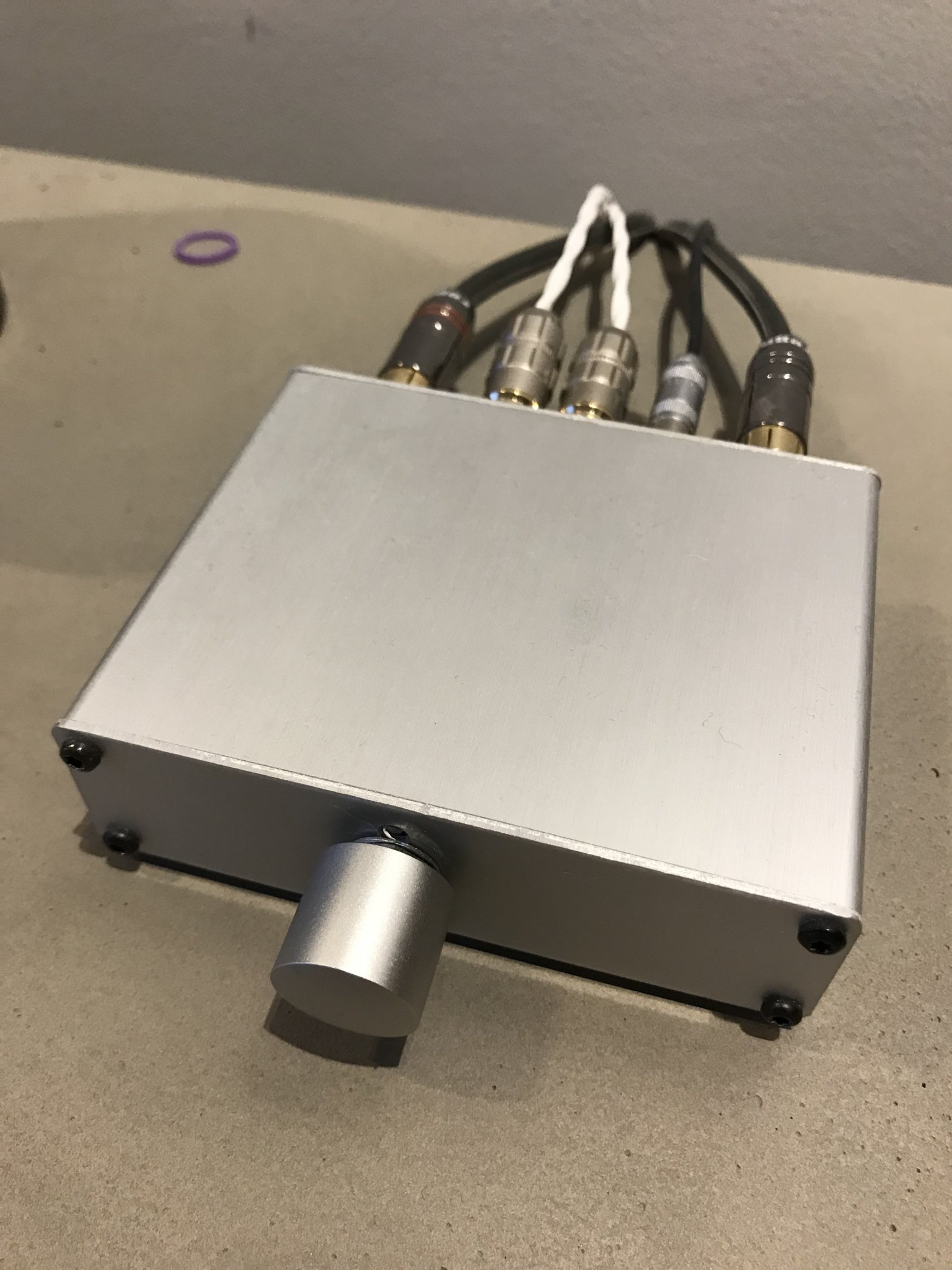

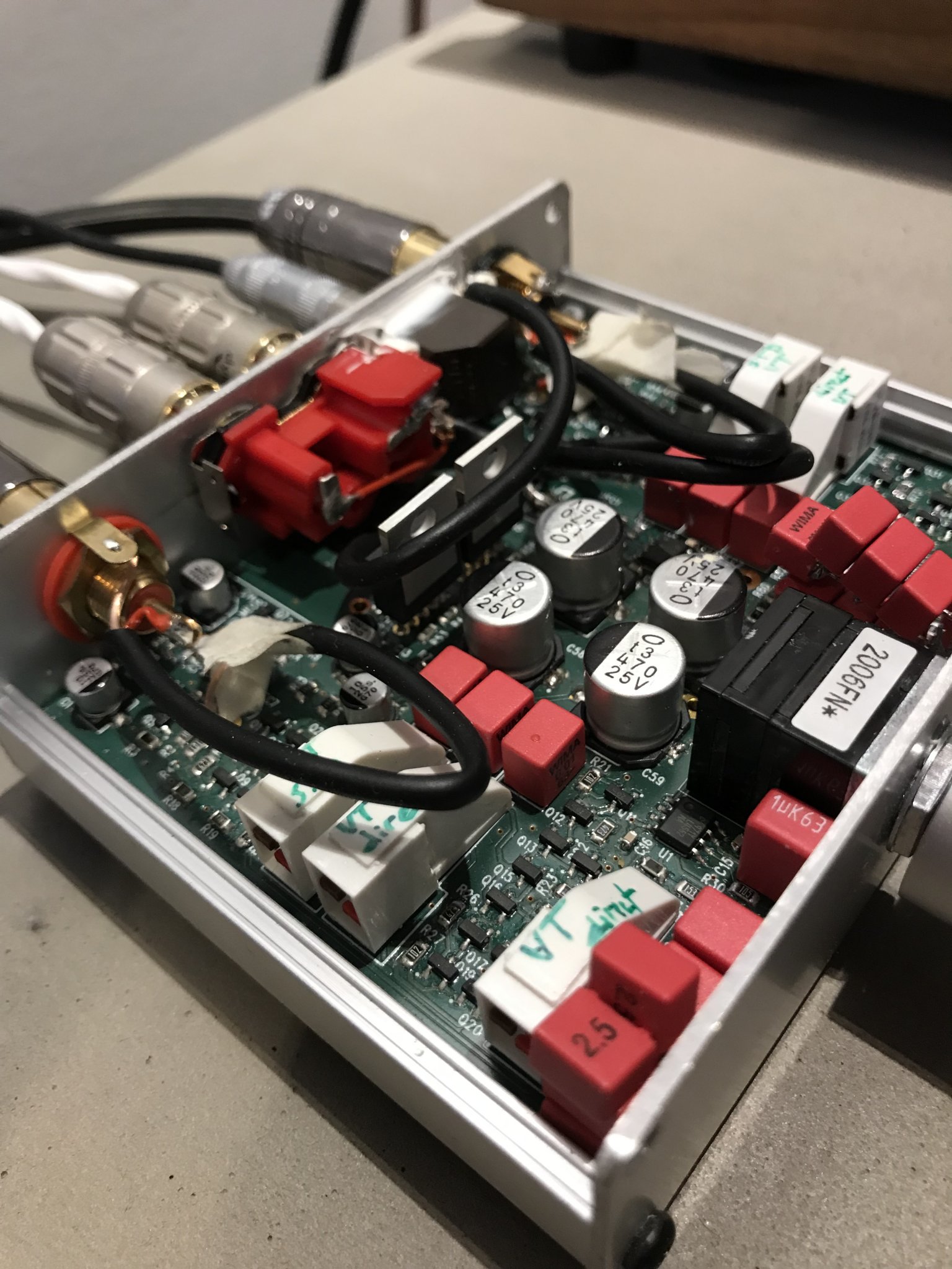

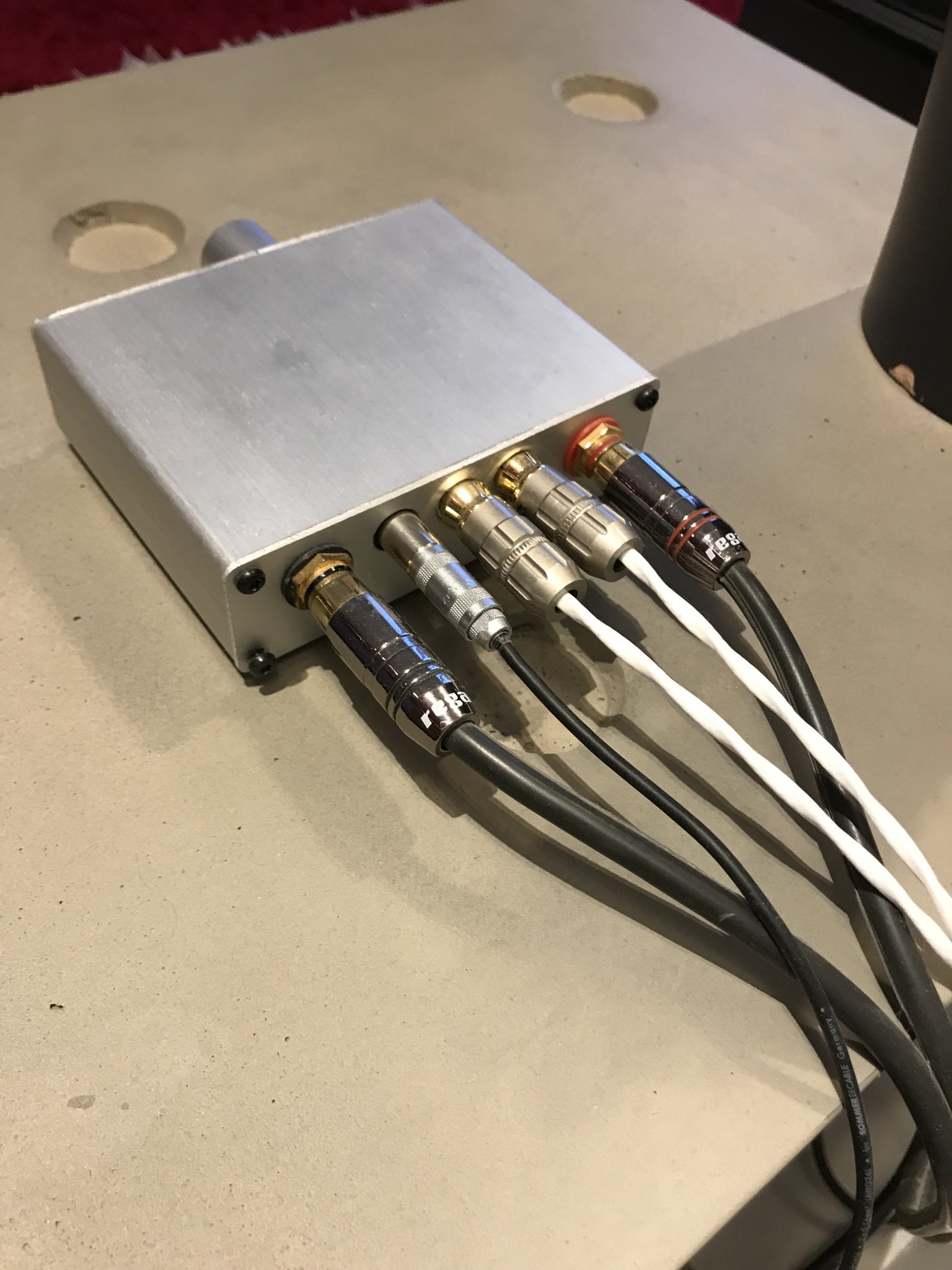

Purchased the linear audio article, to get closer to building this. Is anyone selling the boards and the parts list, or are we just re-inventing the wheel every time?
Hey!Purchased the linear audio article, to get closer to building this. Is anyone selling the boards and the parts list, or are we just re-inventing the wheel every time?
I built it into a nice box.
I'd be happy to share gerbers and bom with you.
You can send the gerbers to JLCPCB that will be very cheap.
I'm not using it in 'Vinyltrak' mode, just regular RIAA but using the pseudo, open loop, JFET input.
Runs every day on my system.
Let me know.
jb
Will post some pictures.
