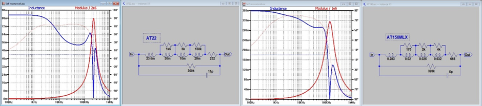

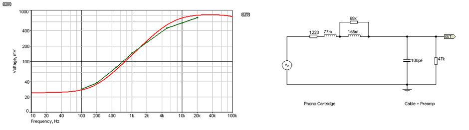

But what I don't understand is why you give this paper an elevated value where Rod used just a 1V source connected via a 47K resistor to the Cart's generator.
His measurement in green went only from 100Hz to 20Khz and only measured level and no phase and deviated from the simulated model in the higher frequency range, already showing the imperfection of his model.
According to his explanation, dividing the inductance in two sections had to be done because of eddy currents.
In my case I used a Voltage Network Analyzer measuring up to 1Mhz that produced way more information than Rod's tests.
See both examples below.
And I did not test with just one voltage but with a set of different voltages, all giving practically the same result, showing that no saturation effects had to be taken into account.
So the generated replacement models for the generators can be regarded as level independent, let's say within a few percent accurate, where my models with four induction sections do not deviate up to 1Mhz from the measurements.
Following Rod's explanation of the impact of Eddy current, this implies that my models now fully include and integrate the effects of eddy current up to 1Mhz, but also that the models are level independent !
So I have no idea what you mean when mentioning that eddy currents are not taken into account.
At the same time, when considering the complete model for a given Cart as a black box, and when proving it´s transfer to being accurate and exact to a real life recording on a calibrated recording chain, independent of load, it really should not be an issue what´s inside the black box, and what (eddy) currents are doing, does it ?
But in this case what´s inside the black box was even explained in great detail.

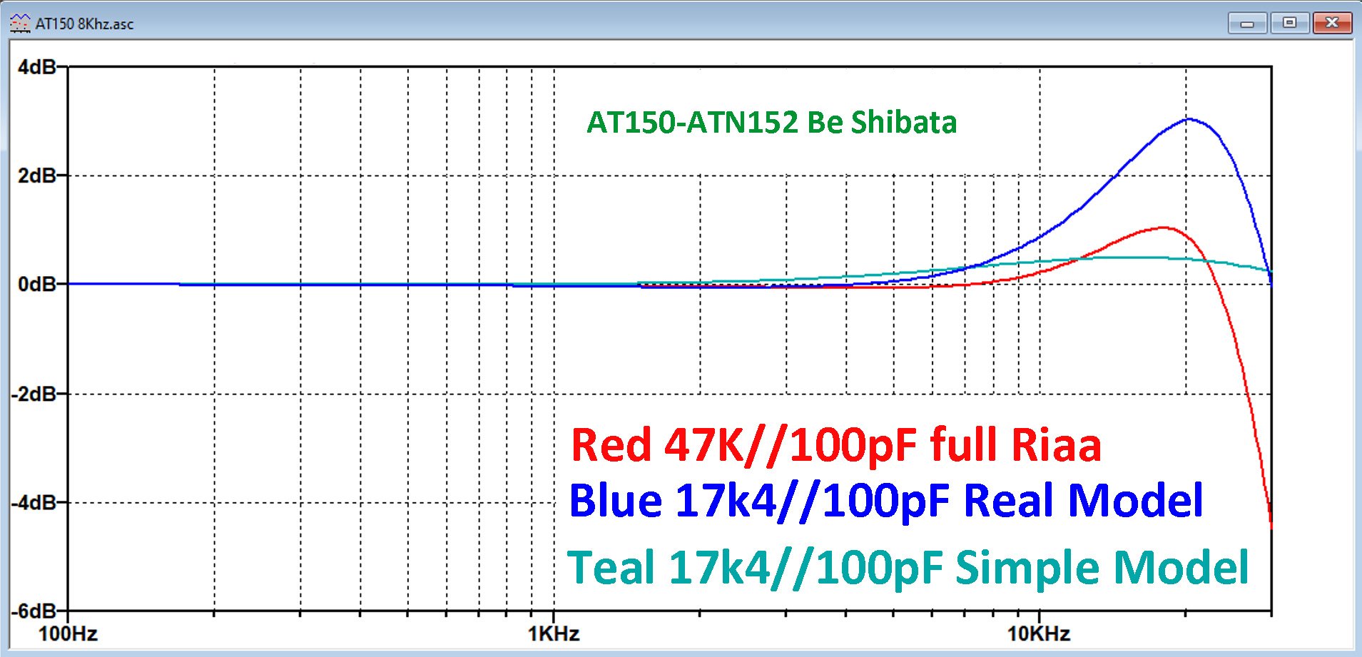

Please have a look at #154 where the 8Khz or 20usec pole was used.
Hans

Hi Bob,
I agree with every word you say, there is no disagreement whatsoever and I'm happy that we can discuss it in this civilized way.
It seems that we can agree that all separate inductor sections in parallel to a resistor are there to model the effects of Eddy current.
Where we differ in looking at the Generator is that I am looking at the Generator's transfer curve as a given fact without any room for guesswork, where you seem to have the desire to understand the background why the replacement model came out in it's current form.
This background is interesting indeed and of vital importance for a Cart manufacturer, but for a replacement model when regarded as a black box it was of second order importance for me.
My focus was fully oriented on getting a transfer curve for the Cantilever assembly, where I went in much more detail.
So when we can agree that the effects of eddy current are fully taken care of in the model, I don't see any reason why this subject can't be put to rest.
When a Cart's behavior can be predicted in the finest detail within almost +/- 0.1dB from 100Hz up to 30Mhz, fully independent from external load termination, what could an already compensated Eddy current possibly still add to this.
Maybe you could explain your concerns in more detail, preferably supported by physical evidence.

It's beyond my imagination that when model an recording are that accurate over a large BW and independent of load, that something may be still questionable.
IMO the only proof of the pudding is in the eating.
So let's start where the discussion began, being the unbelief that a 8Khz damping raises the high end of the spectrum instead of flattening it and that it complete deviates from a simple model of just Lcart and Rcart terminated with a 8Khz pole.
So I invite anyone to do the same test as in the attachment, recording from 100Hz to 30Khz with a 47K termination and with a 8Khz termination.
Hans
P.S. when having problems in making the graphics, when sending me the .wav files of the recordings I can turn this into an image,
