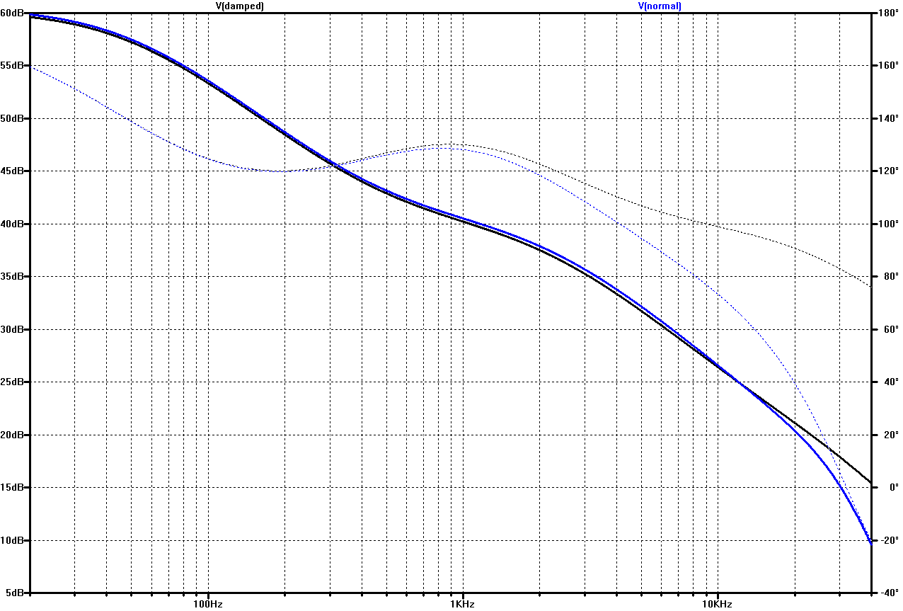

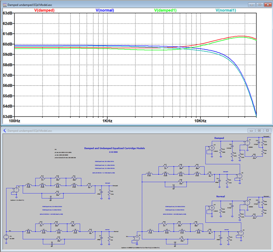

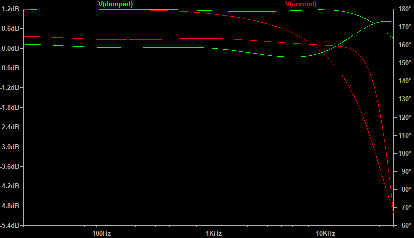

I am back from vacation and have done some simulation.
I am confining my observations to electrical simulations of the cartridge and its equalization, not anything having to do with mechanical effects like the cantilever because I am not qualified to address those issues and am unable to make those measurements.
I now think that Hans' cartridge model is accurate with the 100-pF loading. Furthermore, I think the Eddy current effects are small enough not to matter in this discussion. I simulated Hans' cartridge model with and without the resistors that account for Eddy current effects and found that the resulting frequency response differences were reasonably small. Removing those resistors across the inductors caused the response to increase by 0.25 dB at 11 kHz. At 19 kHz, response was unchanged. At 20 kHz response was down 0.1 dB.
I then simulated the cartridge model with 100-pF loading followed by full RIAA equalization for both the normal cartridge loading circuit and the damped cartridge loading described in my VinylTrak preamp article. In both cases a reasonably accurate RIAA-equalized result was produced. Results were normalized to 40 dB of gain at 1 kHz and gain was checked at 20 Hz, 20 kHz and 40 kHz for each implementation. Gain was 59.6 dB at 20 Hz, identical for both circuits as expected.
For the normal circuit implemented with 100 pF loading, gain at 20 kHz was 20.4 dB, while for the circuit with damped cartridge loading, gain at 20 kHz was 21.1 dB, a difference of +0.7 dB for the damped cartridge loading case. Notably, the difference in gain at 15 kHz was only 0.25 dB.
It appears that the normal case gain at 20 kHz being 0.7 dB below that for the damped case is due to the onset of some high-frequency loss in the normal EQ case, which can be expected.
At 40 kHz, gain for normal EQ is only 9.6 dB due to the expected loss of the cartridge model and loading as expected. At 40 kHz, the damped loading case, gain holds up at 15.4 dB, higher by 5.8 dB. The damping approach falls less at the higher frequencies above the audio band due to heavier resistive loading on the cartridge, making the effect of the 100-pF loading capacitance smaller.
Looking at the response difference at 40 kHz between the 2 approaches, we note that ideally the RIAA equalized response falls at pretty much 6 dB/octave at high frequencies due to the 75-us RIAA time constant. For the damped approach, the gain at 40 kHz is only down 5.7 dB as compared to that at 20 kHz, close to what is expected in the ideal RIAA-equalized case. For the normal cartridge loading case, response is down 10.8 dB at 40 kHz as compared to 20 kHz, much more significant than the damped case and as expected for a normal cartridge loading arrangement at such a high frequency.
The damped cartridge loading is thus very close to that of the normal case up to 20 kHz, but shows desirable extension of RIAA EQ to 40 kHz.
The LTspice simulation files for these cartridge loading comparisons is attached.
Bob

Bob,
Thx for taking the time to react.

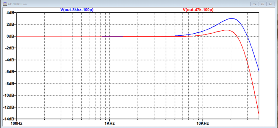

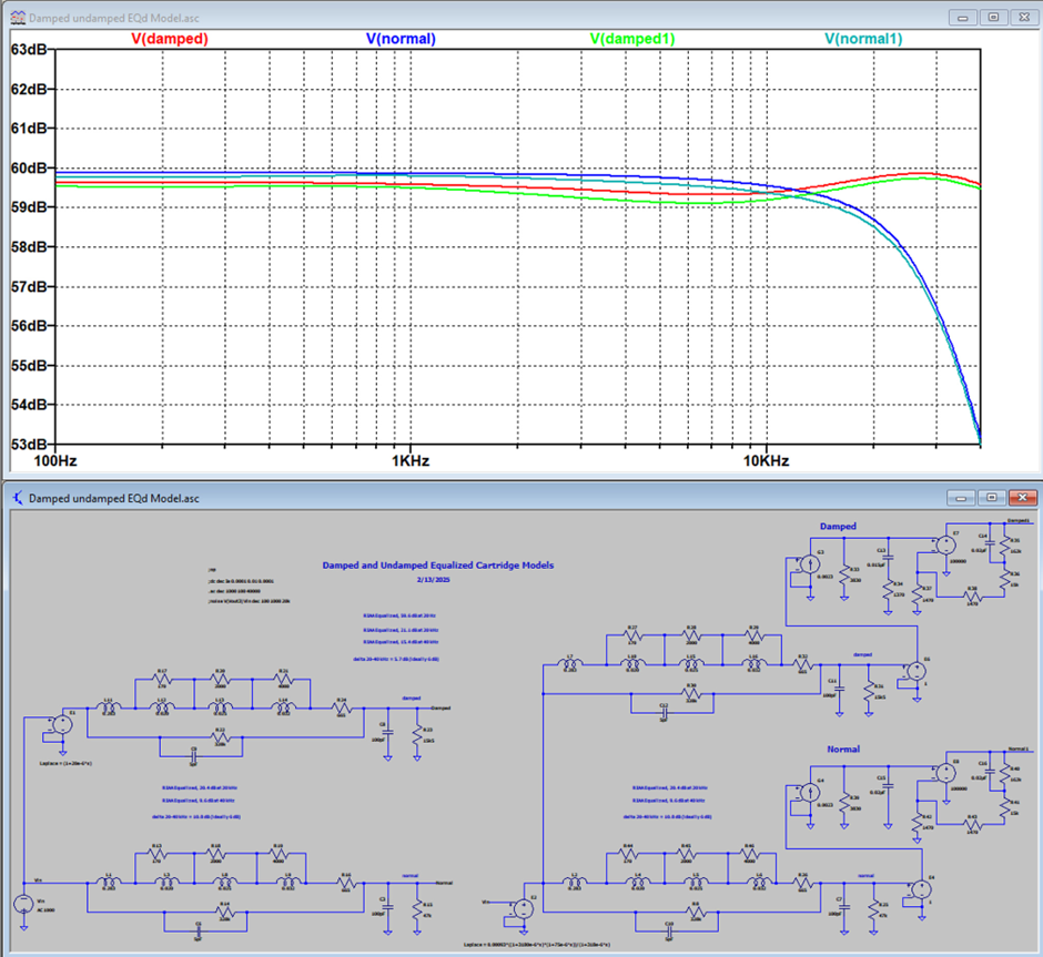

First let me simplify the LTSpice file that you provided and correct a few errors in the model.
The 380K//5pF in your model should be 328K//5pF, but more important, they should be connected between input and output of the generators model, seemingly small differences but giving noticeable differences.
By using Laplace controlled voltage sources, the circuit diagram can be simplified quite a bit.
Simulating your version driven from an anti-riaa source to get a flat response versus the simplified version including a correction for the 8Khz zero, you can see that results are of course equal but very much simpler to understand.
Point however is that a 8Khz zero results in Rload= (Lcart*2Pi*8000)-Rcart is 17K4 where you used 15K5.
Admittedly the FR becomes less elevated around 30Khz at the cost of a sag between 5Khz and 7Khz.
However when having used the calculated 17K4, you would have seen the FR shown below.
Now there is no sag below 10Khz, but at 30Khz FR has raised by more than 1dB.
Now combining this with the response of the mechanical part, we come to the image below, where the overall FR can be seen .
This is exactly as was already shown in posting #184.
The .asc file having both your and the simplified model are attached.
And maybe using a lower termination like 15K5 would help to flatten the FR somewhat, although getting a sag between 5Khz and 7Khz should be avoided.
So I still can't see the benefit of using damping.

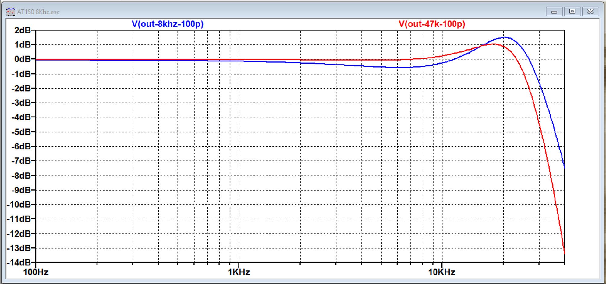

To complete things, I lowered the 17k4 resistor for getting the 8Khz zero to 14K3, being some sort of an optimum between a sag that's not to deep and a response at 20Khz that's not too high, while letting the corrective zero at 8Khz.
Result is in the attachment below.
I suspect however that the sag will most likely be noticeable.

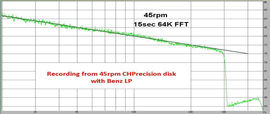

Apart from this simple issue about the test disk that was used., I need some extra time to properly answer your questions.
This is what I wrote about the used test disk.
One of the biggest problems found in measuring cartridge frequency response is a suitable test record. Many of those from the ‘golden era’ of vinyl have potential anomalies that skew results. For this testing we used an Riaa corrected pink noise recording from 500Hz to 30kHz on a 45rpm disk from CH Precision. This was computer generated in order to provide accuracy that is rare to find in a test record.
Pink noise has equal energy per octave, and when displaying the FR with a FFT having fixed frequency bin widths, it will show as a negative slope of 10dB/decade.
To verify the correctness of the recorded signal on this disk, record was played back with a Benz LP MC cartridge, whose FR is specified from 10Hz-50Khz within 1dB.
Figure 2, checking the Test signal on the CHPrecision test disk.
Figure 2 seems to fully confirm that the Disk can be used for our purpose as a reference. Up to 28.5Khz the response is within +/- 0.5dB and from there -1.5dB@30Khz.
Does this answer your question so far?
