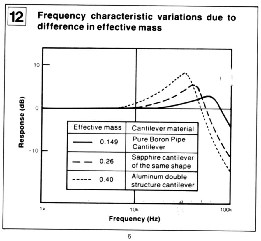

1) There is Fres from the tip in the vinyl groove that’s dependent on the ETM according to the fr = (0.632/πSqrt(m)*(E0²FvR)^1/6
ETM (equivalent tip mass m) is the dominant factor for the achievable BW proportional to 1/sqrt(m).
The tip diameter R plays a much lesser role.
See documentation from Technics to show the effect of ETM to Bandwidth and Fr.
Of course the cantilever's suspension can be used to flatten the FR as can be seen in the calculated transfer functions below.

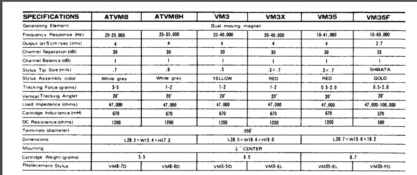

This is another table from Dagfinn with Audio Technica carts where only the last was specially made for CD4.
Quite remarkable is that they all were advised to use a 47K termination and for the shibata version from 47K to 100K , preferably with a short interlink to keep capacity low.
For the Shibata Cart with the high BW, a 370mH coil was used to shift the generator's Fr into a higher frequency, like Technics also did for their high BW carts.

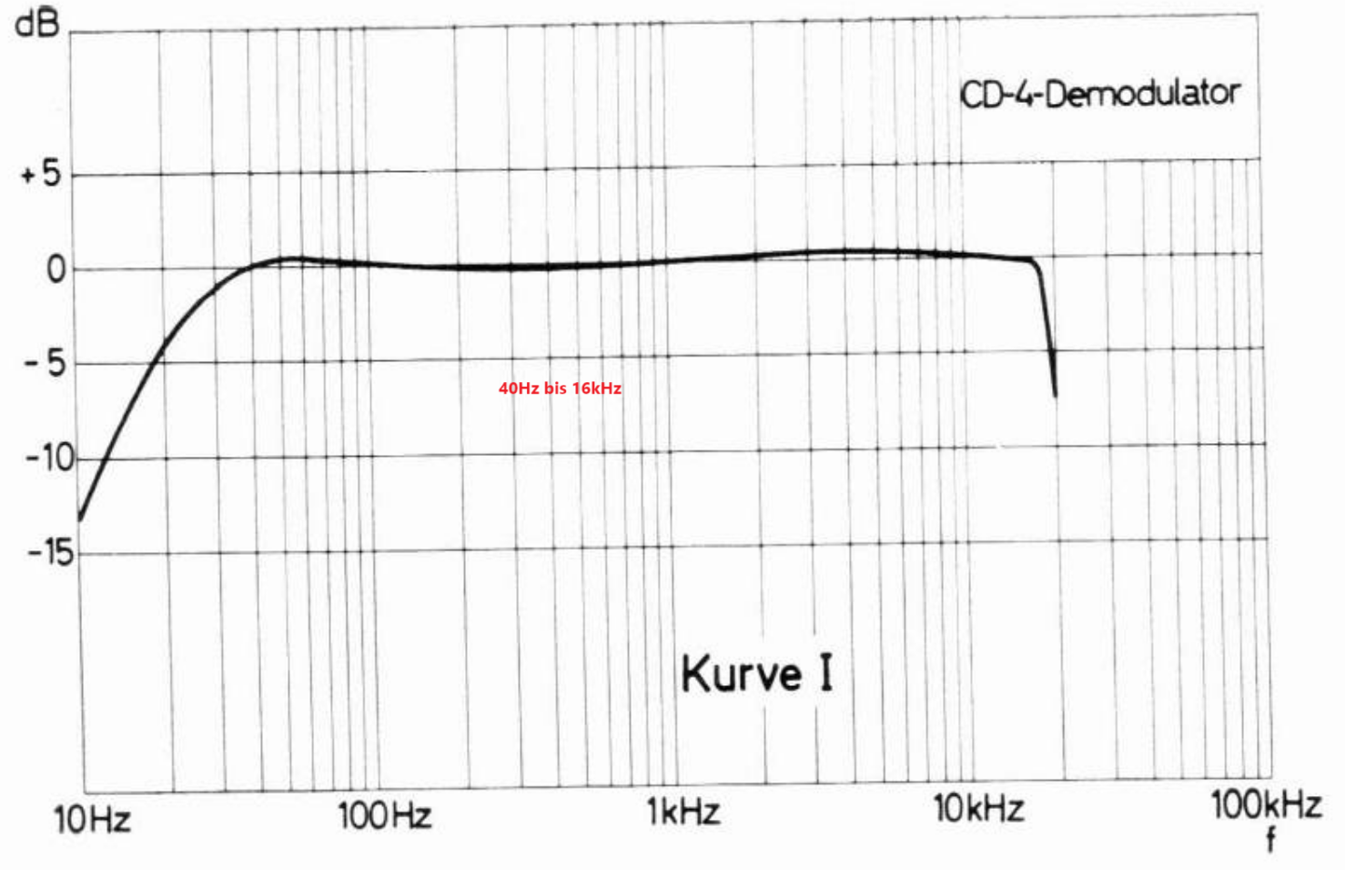

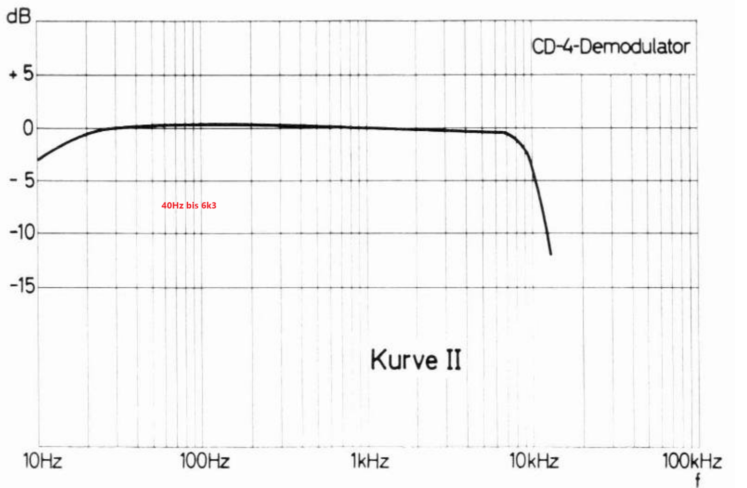

Grundig CD4 Demodulator / Decoder
Based on this circuit, we can find out in detail how the quadraphonic process of the 1970s must have worked.
No more speculation! I doubt whether this excursion will catapult us any further forward in terms of normal stereo playback of a long-playing record.
All points concerning the pickup and its mechanics are completely undisputed.
HBt.

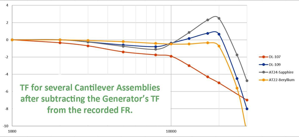

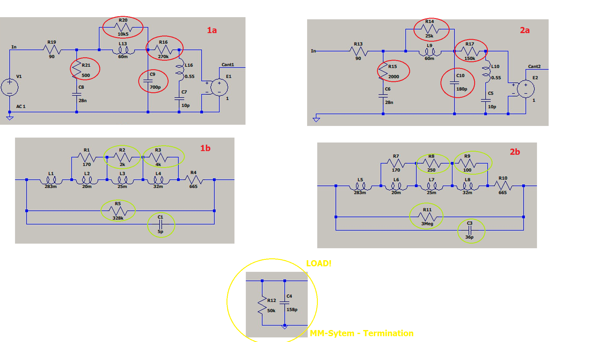

As a final attempt to prove things I’ve made simulations for two cart models, both having the same FR with the 50K//158pF termination as recorded with the AT150-ATN152.
To achieve this, it’s obvious that when the mechanical has been changed, the generator will have to be changed also to achieve the same FR with 50K//158pF between the two models.
But in both versions the basic 360mH and 665R Cart properties are still kept intact.

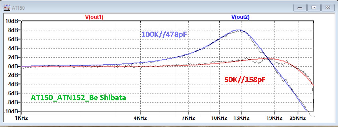

However, when applying the second 100K//478pF recorded termination for the AT150-ATN152, you can see that only one of the two models conforms to the life recorded FR with that second termination load.

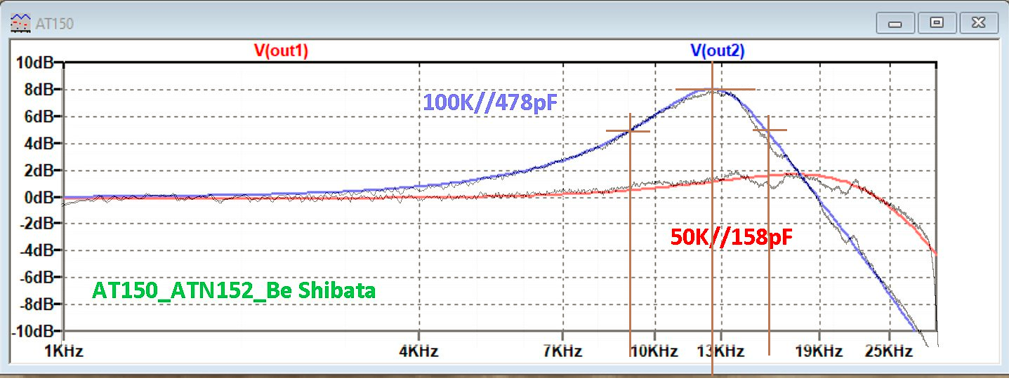

See below the original image as published in my paper with recorded signal versus simulated signal, both being almost within +/- 0.1dB when flattened.

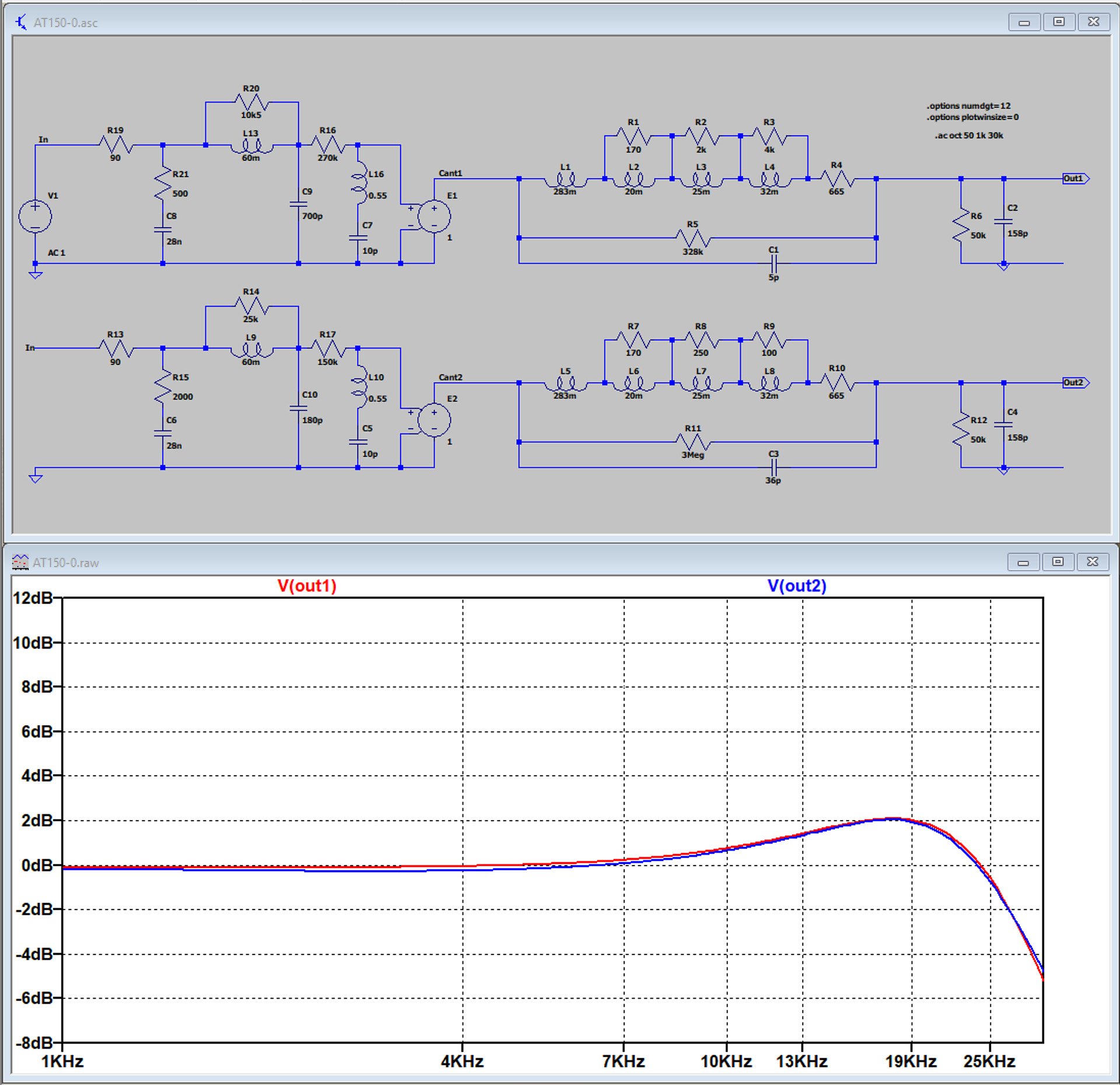

Second attachment shows the two different models, but having the same FR when terminated with 50K//158pF.

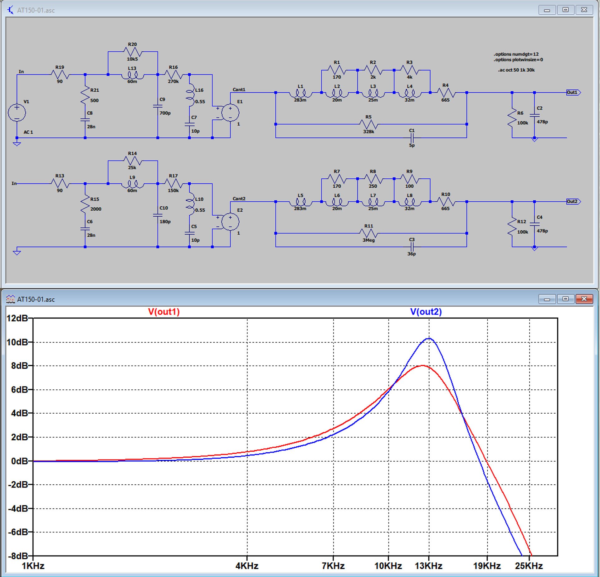

In the third attachment, when both being loaded with 100k//478pF, there is a large difference of 2dB around 13Khz.
This should do as a prove that only one set of models for the mechanical part and the Generator can exist, ergo the replacement model for the mechanical part has to be correct.
But also the model for the generator has to be correct for the same reason and using the reciprocity when turning the Generator from Impedance into a model worked out to be correct.
When the models for as well the mechanical part and also for the Generator are correct, then a simulation showing the effect of damping can only be correct also.
And although the extended FR for the Generator is undisputed when applying damping, fact remains that while increasing the Generator's BW at the same time it will have impact on the overall FR that depends on the mechanical response as shown in #184 and in #206.
So a life recording from you with and without damping should be welcome.

W wouldn't believe what we can quickly extract from a graphic ?!
Please take this as a good estimate. No more and no less. This approach is not 100% correct. Let's see it as an approximation. And so it goes with the disenchantment:
f1 = 9.083kHz
fc = 12.49kHz
f2 = 15.6kHz
fo = sqrt(f1 * f2)
= 11.904kHz
L = (1/ 478pF) * 1 / (2*PI*fo)^2
= 374mH
Z´= sqrt( L/C)
= 27.97kOhm
b = f2 - f1
= 6.517kHz
Q = fo / b
= 1.83
Z = Rl / Q
= 100kOhm / 1.83 = 54.644kOhm
sqrt( (54.644kOhm)^2 - (27.97kOhm)^2 ) = 46.943kOhm this is the correct termination of this pickup, it follows in the further rollover:
fh = 19.976kHz
Rp < 47kOhm
Cp = 169.7pF
Q = 1 !!!
The red curve fully confirms the rollover. Now I ask myself what Mr. Polak's mission is actually about?

That's a good point Hans P. :
If the mechanical, i.e. the moving part is changed -> for example the mass, the damper, the suspension and the armature in the yoke, i.e. our moving permanent magnets (magnetic flux) -> then the generator model also changes ..!
Something essential is missing in a correct (really complete) model of our transducer.
