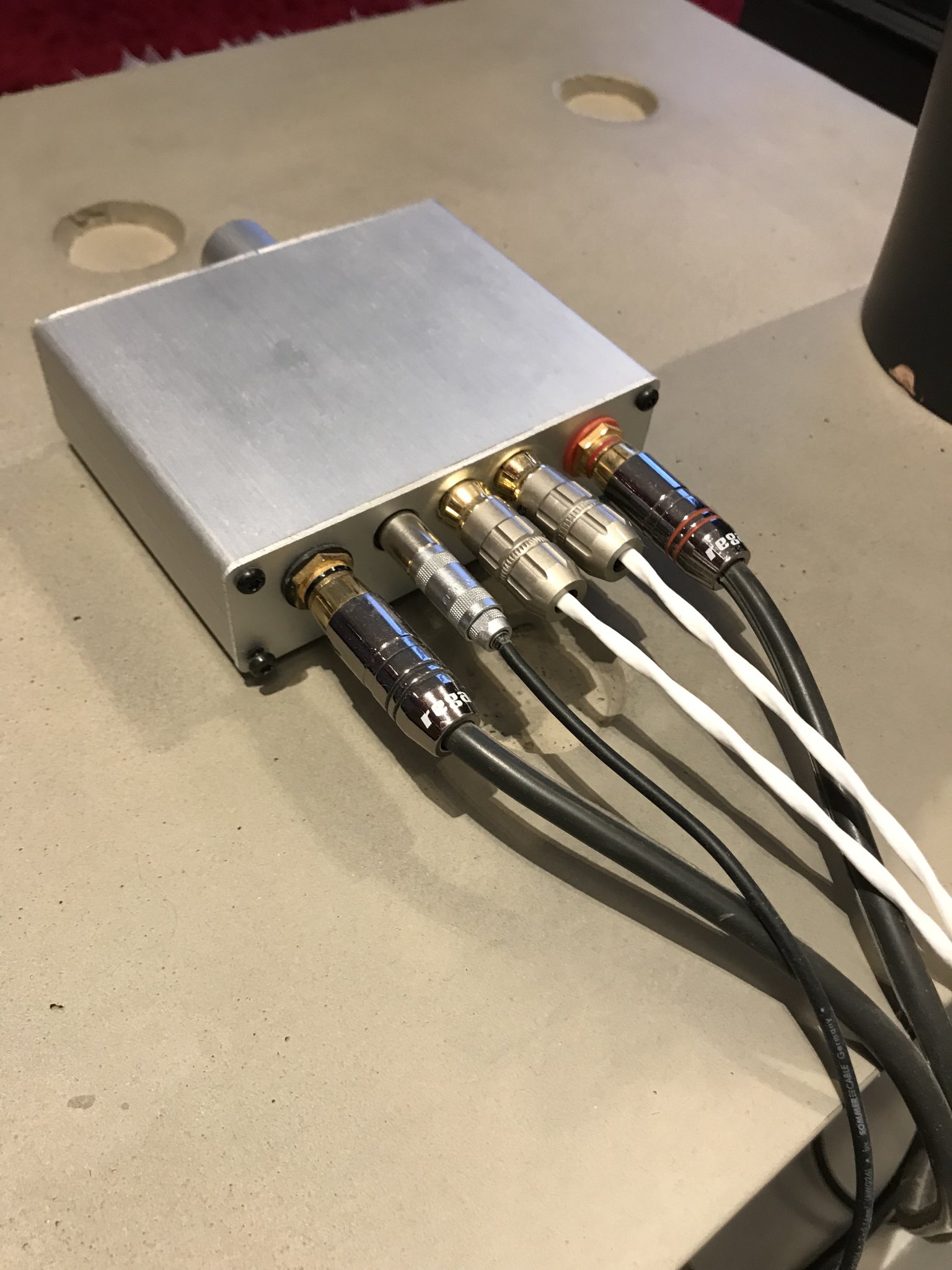

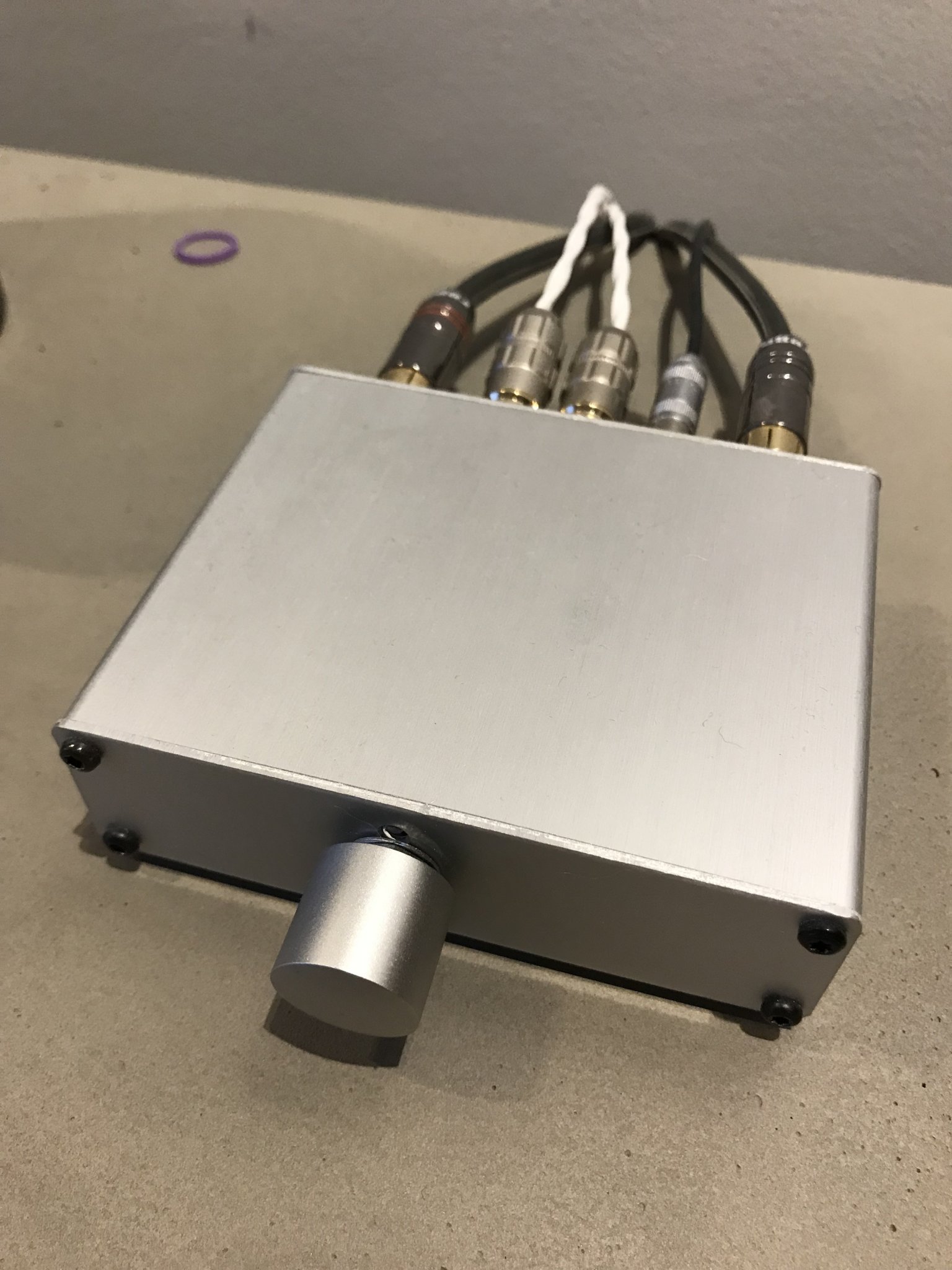

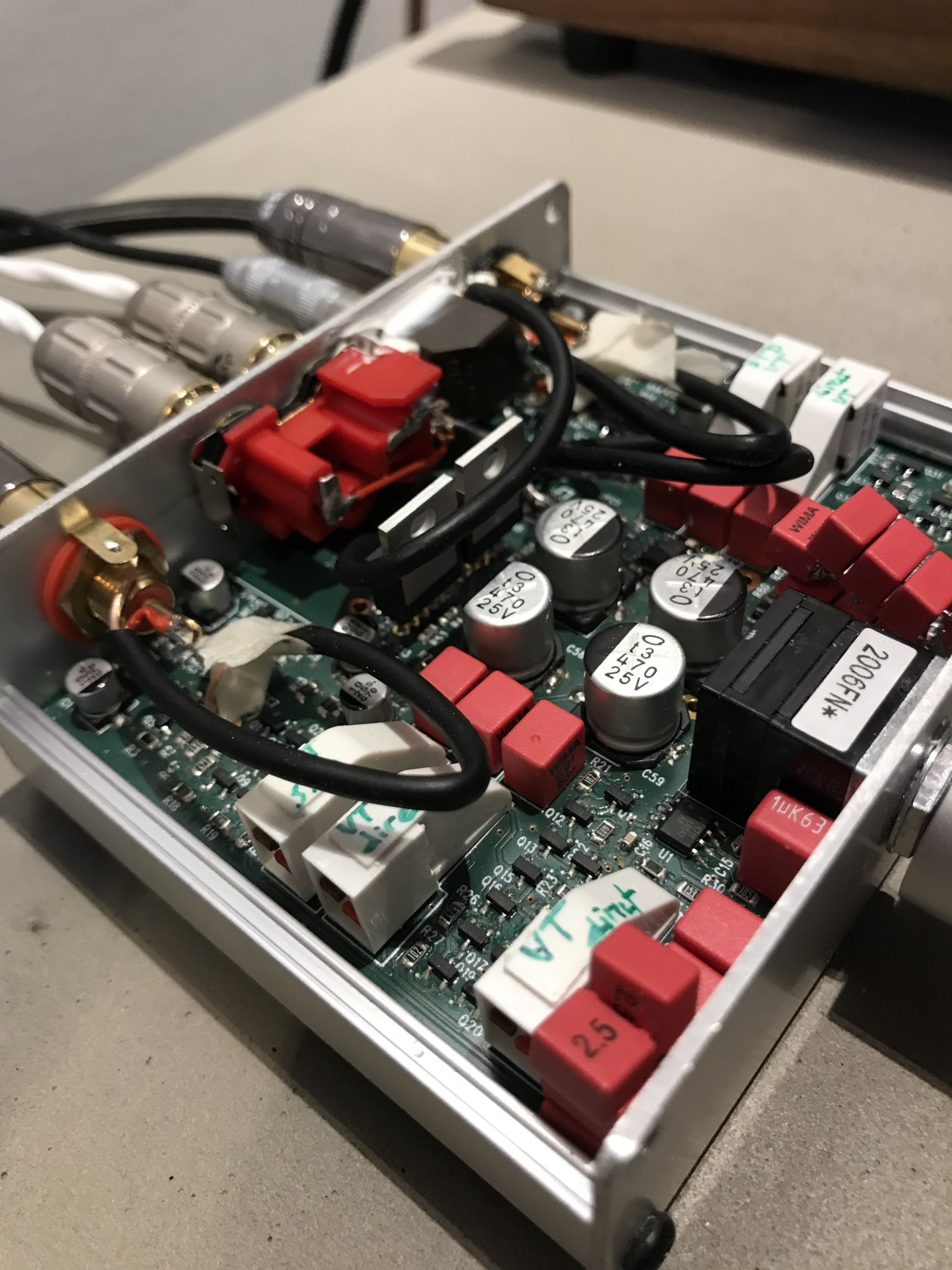

Hi JB, Very nice job; the pictures look really good.Hey!
I built it into a nice box.
I'd be happy to share gerbers and bom with you.
You can send the gerbers to JLCPCB that will be very cheap.
I'm not using it in 'Vinyltrak' mode, just regular RIAA but using the pseudo, open loop, JFET input.
Runs every day on my system.

May I ask you the reason for the diamond buffer when it is going straight to an opamp input?
Many thanks,
jb
Thanks jb,
does your design skip the vinyltrak mode circuitry? Also, any matching of transistors or other components required?
It is all optionnal : you can bypass it or not.
Same for the diamond buffer: you can have it in the pass or not.
Using configuration switches. You may want to hard wire the configuration you want (these are switches I had in the lab : I don't have a part number fo it).
The assembly drawing (PDF) should make clear how to configure the switches.
Matching transistors is not required: the LSK489 does the important job there itself.
Don't hesitate if you have mre questions,
jb

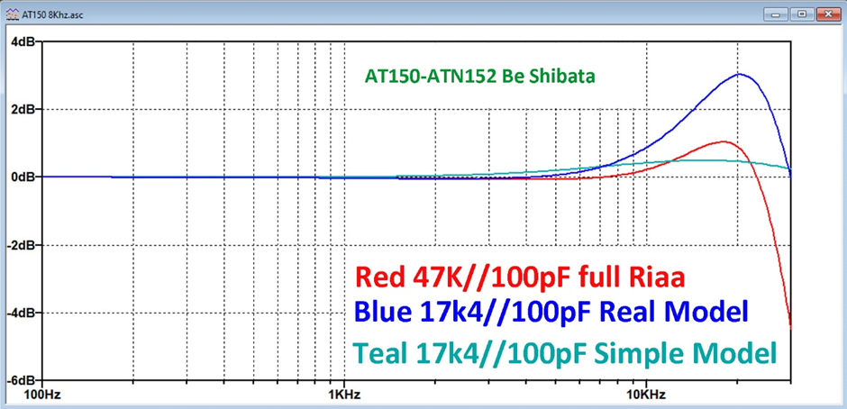

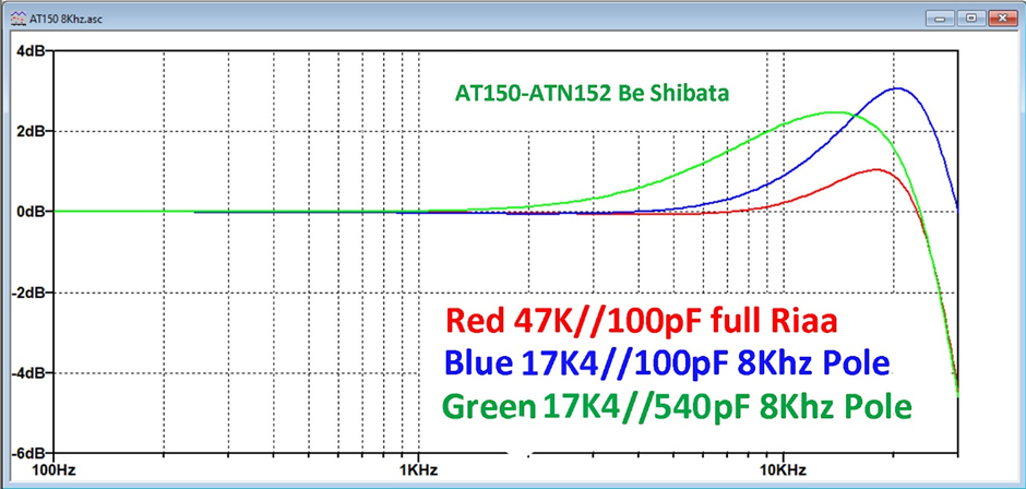

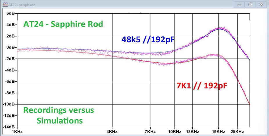

Bob,
For replying to your posting, I used an AT150 with ATN152 Cantilever, having a comparable nominal inductance and tip resonance as the V15 that was mentioned in your article in Linear Audio.
But since the VinylTrak damping option was not just meant for a V15 type V, this AT150 may be considered a good test vehicle for examining the effect of loading with a 8kHz pole.
Just to resume, this Cart amongst many others was first measured in greatest detail, it’s electrical part translated into a replacement circuit having a frequency response FR1, the Cart’s overall frequency response FR2 recorded from a calibrated test disk, while using a calibrated load termination, enabling to make a replacement model for the mechanical part with transfer FR3, constructed from FR2 minus FR1 including the exact same load termination as during recording.
Even the disk speed and position on the disk, having their effect on response, were taken into account,
With the complete replacement model, FR1 and FR3 in succession, various capacitive and resistive loads where simulated and successively compared versus the recorded response with exact identical resistive and capacitive loadings.
The outcome was that the constructed model could give a perfect prediction of the real recordings.
So far for explaining how each Cart model was meticulously validated.
Now for the AT150 with 360mH nominal inductance and 665Ohm internal resistance, inserting a 8Khz or 19.9usec damping for this 360mH cart results in an external load of:
360mH/19.9usec minus 665R = 17K4
Simulating with the standard 47K and with this external damping of 17K4 while corrected for the 19.9usec pole resulted in the image below, this after normalizing all levels at 1Khz.
As a general experience during validating Cart’s, reducing the Cart’s load, while at the same correcting for the additionally created pole, always resulted in a strong rise at the upper frequency range.
This is no different in this case with the AT150 where a 3dB peak at 20Khz becomes visible.
To reduce this peak somewhat, a higher load capacity could be inserted, in this case 540pF just as an example to learn what impact this has.
This higher capacity made the peak drop from 3.0dB@20Khz to 2.4dB@14Khz, but at the cost of worsening the FR’s flatness that went originally up to almost 10Khz, now reduced to a much lower 2Khz.
So, in both cases the 8Khz damping with either 100pF or 560pF did not give any improvement. For that reason I repeated the previous simulation, but now added the frequency response when just using the simple model with 360mH plus 665R series resistance, loaded with the 17k4 damped pole // to 100pF like fig 4 in the VinylTrak article.
The result is visible in the image below, two curves that where already shown, but now added with the simple model’s frequency response in teal and the conventional EQ still in red.
Quite obvious is that this simple model deviates largely from reality and is therefore quite misleading indeed.
To conclude:
Did I completely miss the point of loading with a 8Khz pole ?
I think the above results speak for themselves.
That damping completely eliminates the electrical resonance resulting in a first order rolloff does not live up to the expectations.
Here the advantage of having a validated prediction model made this quite obvious.
So it’s better to stay with the 47K load that was originally selected by the Cart’s manufacturer, but finding the best fitting load capacity to get the optimal FR should be the way to go.
For completeness I have added the LTSpice models.
Hans
To conclude:
Hans

You keep talking about eddy currents as the reason why my models are incomplete or even wrong, thereby completely negating the fact that the models are validated against real recordings, all the time resulting in perfect matches.
You also overlook the fact that the generators where modelled after having tested them with a large spread of voltages, not giving significant impedance differences that would have occurred when eddy currents would have given a significant impact.
So, no eddy current problems whatsoever seem to introduce complications of any significance in this, resulting in overall models as accurate as the can be.
Have a look look at the huge spread in load from 48k5 to 7k1 in the image below as an example.
When eddy current would have played an important role, it would have become visible.
To criticize the attempt of trying an extra capacity when the applied 8Khz damping doesn´t bring the predicted results, and to call this a fools errand or apples to oranges is rather illustrative for your attempts to defend the damping theory with just words but without physical prove of any kind of a recording from a validated recording chain without and with damping.
That would lead to the constructive discussion it should be in the first place, a discussion for which I´m open.
So I´m looking forward to continue this discussion when real facts from recordings are available from your side.
Hans
