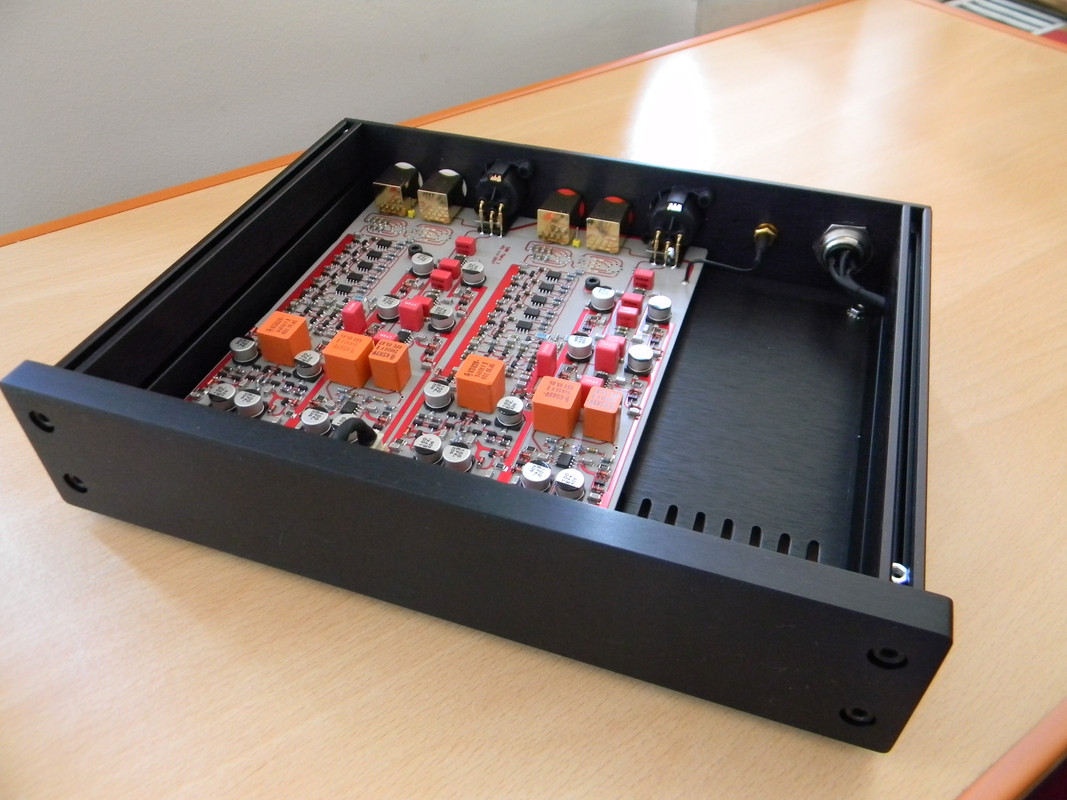

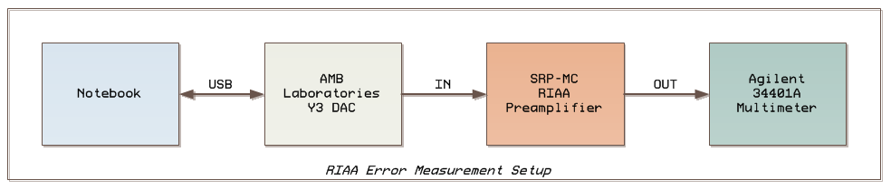

Some measurements
(SRP-MC my version of Bob Cordell`s VinylTrak)
To be cont.

It is interesting that in the right channel there is a delta 0.35 dB with the left channel.
Probably because some mismatch in DC-Servo components values.
Yes, I noticed that. The delta begins to exceed 0.1 dB at 30 Hz. You are probably right about it being the DC servo.

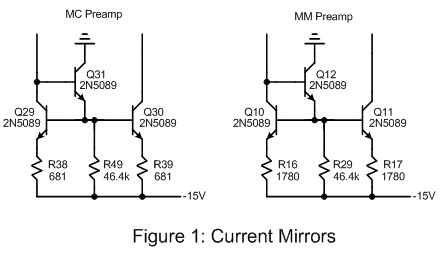

I have a question regarding Wilson current mirror. Do I have to match Q10 and Q11 (Q29 and Q30 as well) for better performance?
Matching not needed 🙂

In general, matching in audio will *always* give you a better performance. However, there is a point of diminishing returns. If I would build the VinylTrak, I would not match Q10/11 resp. Q29/Q30. My reasoning is as follows:
I assume you would match beta of the BJTs. I am very sure that the performance of the VinylTrak is mainly limited by the matching of (the Idss of) the input JFETs. That is why Bob uses dual JFETS (sry, can't find the thread righ now). Compared to the variation between the individual FETs, the input/output current variation in the current mirror due to unmatched beta of the BJTs will typically be negligable, especially since beta is already very high for the 2N5089. Therefore, I would rather spend my time listening to the preamp than matching transistors. 🙂
BUT, if you already have matched the transistors, of course use them. There is nothing to loose here. 😉
By the way, Bob found later that a 3-transistor current mirror gave better noise performance, see http://www.cordellaudio.com/preamplifiers/vinyltrak.shtml. I added the picture below.

Thanks for your comments! I've finally decided to play it safe and put in a matched dual transistor in the current mirror. But what you are saying absolutely makes sence.
