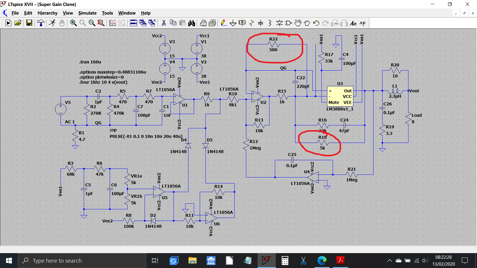

One trick you could experiment with is altering the noise gain.
The chip is stable from gains of 10 upward and so we have to trick the chip into thinking it is running at higher gain when it in fact (for your wanted signal) it isn't.
We do that be adding one resistor between the two inputs. Lets say we want a signal gain of just 5.
The chip now thinks it sees a feedback network of (in this example below) of 5k and 1k as far as signal goes, and that gives us a signal gain of 5000/1000 which is just 5.
That's OK for our signal but way below the minimum gain requirement of the chip. So we add another resistor between the inputs, in this case 500.
The chip now see a 'noise gain' feedback network of 5k (the feedback resistor) and now the 1k is in parallel with our newly added 500 ohm resistor.
How does that work? Well the 500 ohm sees no signal across it because both inputs are effectively at ground potential. So now the feedback network (for noise gain) gives a value of 5000 divided by the equivalent parallel value the two resistors. The 1k and 500 in parallel equate to a single 333 ohm.
Now we get a noise gain of 5000/333 which is 15. The chip is happy as we are comfortably over the minimum of 10.

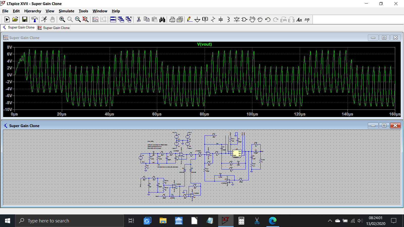

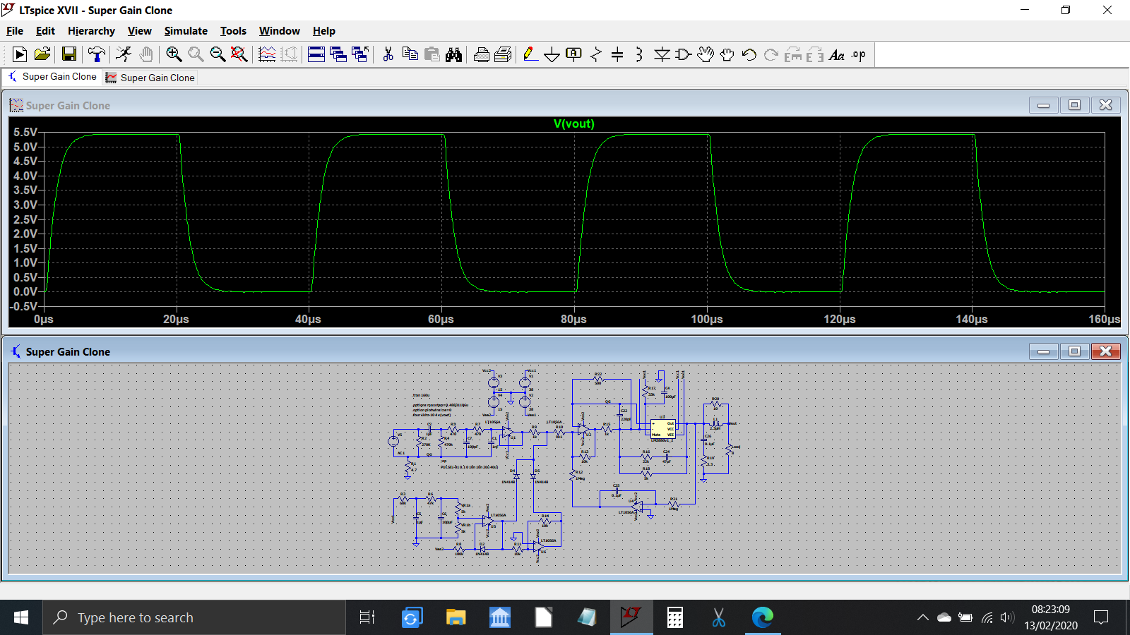

Does it work? Yes, it works really well and here is a squarewave test of the amp configured in this way. Squarewave testing is really revealing of stability.
If we remove the 500 ohm we can see just how unstable (as expected) the amp has become (last image).

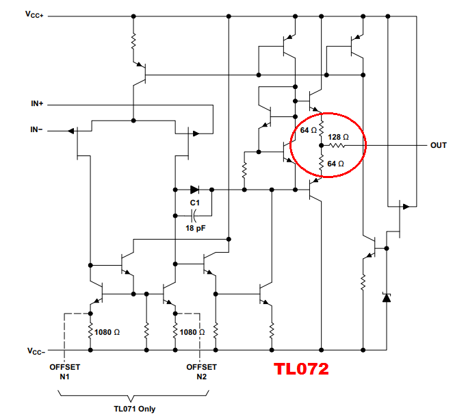

I definitely would NOT recommend a TL072 in Bob's Klever Klipper: its relative huge resistors in series with the output, won't give the soft clipping behavior that Bob designed.
I'd recommend NE5532 or NJM5532 or RC4580 or NJM2068 .

I'm going to beg to differ here and say that the TL072 (not a TL071 which is a single opamp) would be fine. Those series resistors internal to the chip are within the overall feedback loop which is applied externally.
I like the TL0 series and they can be capable of excellent sonics.
The LM833 is another excellent device but be aware that two versions exist, the old original device and a revamped version with a quasi complementary output stage (imo the one to go for).
