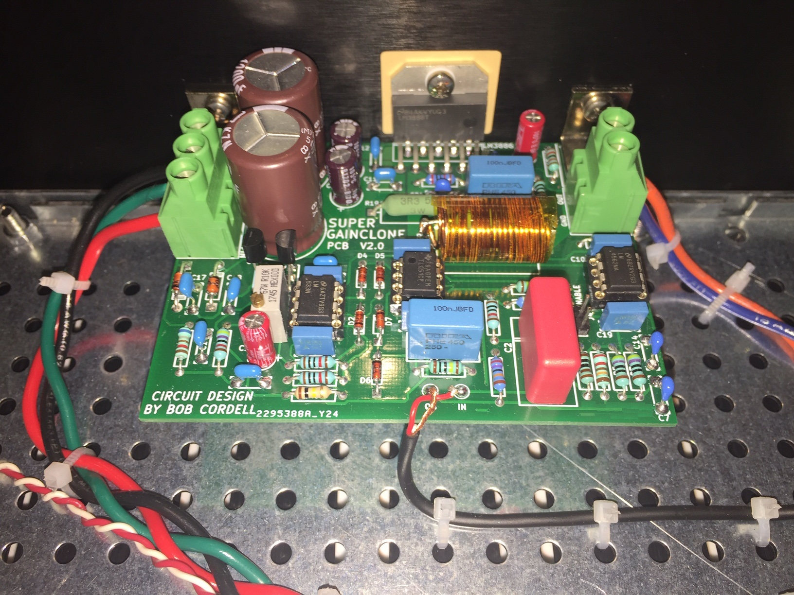

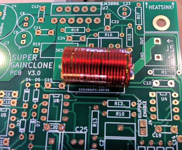

I hope you're planning to install a hand-built output inductor "L1" (2.3 microhenries, air core) on each of your boards; the pictures don't seem to show L1, at least not yet.
Here's a copy of the board photo I attached to post #1 of this thread. Thanks to the Kapton tape wrapped around the coil, the inductor is a dark amber / light brown color. It's just to the right of the words "SUPER GAINCLONE".
Yes the inductors and the VR1 are the last remaining things. I'll wind the inductors on Tuesday. That 10 ohm resistor is not soldered. My power supply will also be like your build, the one from diy audio store.

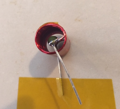

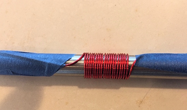

This morning, I built up a pair of output inductor assemblies for a Super Gain Clone stereo amp. Each assembly consists of "R20" and "L1" on the schematic (attached to post #1).

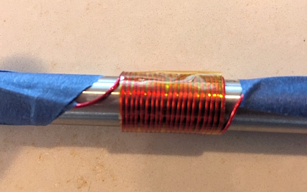

I cut off about 1 meter of enamel insulated AWG-20 "magnet wire" and taped the left end of the wire to the left end of my coil former, see photo 1. Then I tightly wound 20 turns of wire, compacted the coil as tightly as possible, and taped the remaining wire to the right end of the coil former. (I was using an 11 mm diameter steel rod as a coil former).

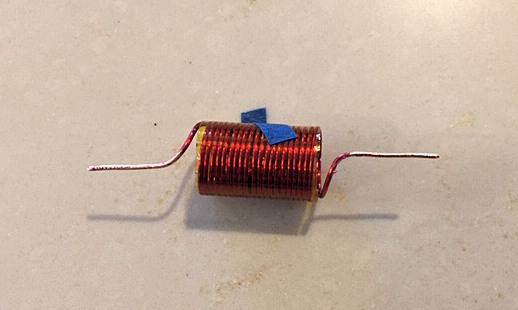

The Kapton tape, shown in photo 2, keeps the turns of the coil compact and tight. I used a piece of tape about 2.5 inches long, which was enough to wrap around the entire coil twice.
After removing the coil from the forming rod, I trimmed the leads to about 1 inch long and removed the red enamel insulation, revealing the copper wire beneath: photo 3. Some people use pliers, some use a utility knife, and some use sandpaper to remove the insulation. I used a flat "needle file" that I bought from Amazon (link). I find that a needle file removes enamel insulation faster than the other methods I tried.

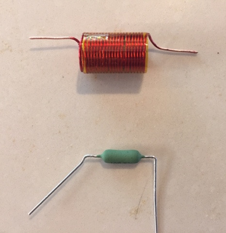

Next, I bent the leads of the resistor R20 so it fits perfectly in the PCB footprint. Then I un-bent one of its leads by ~ 45 degrees, which makes it possible to slide the resistor inside the body of the inductor. See photo 4.

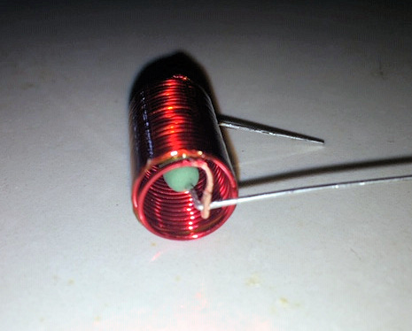

After inserting the resistor inside the inductor, I bent the inductor leads around the resistor leads, and trimmed off the excess. This is shown in photo 5. I soldered the inductor leads to the resistor leads as shown in photo 6.
Finally I performed a test fitting, to ensure that the L+R assembly matched the footprint on the PCB. As expected, it did. See photo 7.

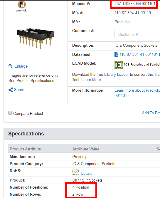

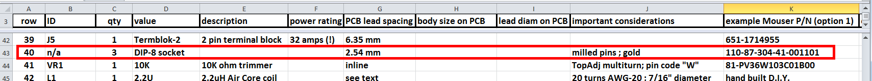

Mark,
I found an error in the SGC BOM. The part number you specified is for a 4 pin DIP socket and not an 8 pin. The correct part number for the 8 pin DIP is:
437-1108730841001101 This is the number that Mouser uses. Same manufacturer with 8 milled gold pins. I hope this helps anyone who has yet to order parts for the SGC!
Also R8, R9 are back ordered at Mouser with a stocking date of around mid March sometime. Can a 1K .5W metal film be substituted for these resistors?

I opened the .xls spreadsheet containing the detailed Parts List, and copied the DIP-8 socket part number to my clipboard. When I pasted it into the search box at Mouser.com, I got this DIP socket.
It has eight pins: four columns by 2 rows. That's eight pins.

You are correct, Mark. Sorry about the misinformation on my post!
It seem that Mouser simply got the numbe rwrong somehow and sent me 4 pin sockets.

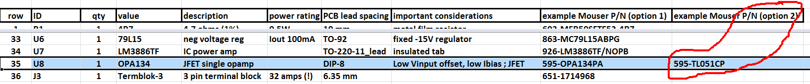

Is the TL051 a decent substitute for OPA134.
The image in post#1 has the former , but the schematic and BOM is per the latter.
TL051 is "option 2" for the DC servo. However I do recommend you use option 1 (OPA134) if at all possible. Image below
Bob Cordell's second edition devotes an entire section (10.3) to this and I recommend you read it in its entirety. You will encounter these words:
However, my parts bin of OPA134s was empty when I put together the amps whose photos are attached to post #1 of this thread. So I used TL051s because I had them on hand. Later, after the whirlwind of Burning Amp 2019 subsided, I ordered another tube of OPA134s and swapped them in.
