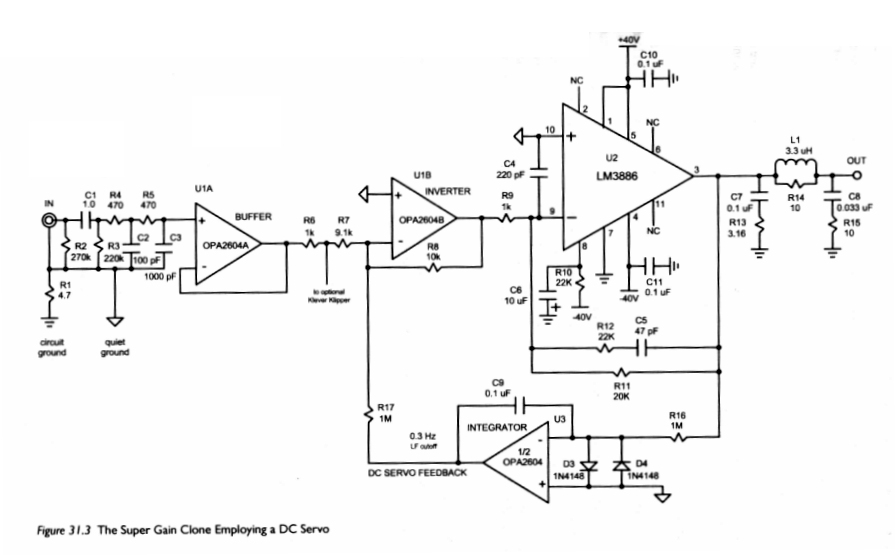

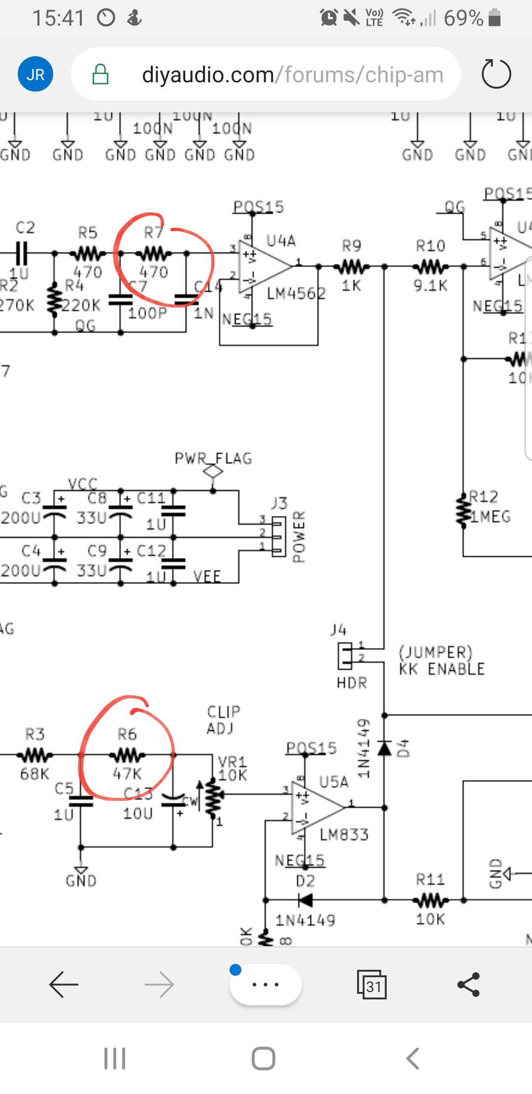

Here is the pencil and paper method of gain calculation. It gives answers that are about 5% below yours. More importantly, pencil+paper matches the gain number Bob Cordell wrote in his book: page 686 of the 2nd edition, page 541 of the 1st edition.
_
Thanks for that.
The schematic shows R6 as 47k and R7 as 470. You used different values for the calculation. Any reason for this that I should be aware of before the build.
Referring to Bob's official schematic in post #9 of this thread, gain is equal to (R11 / R9).

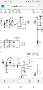

Each of the three DIP-8 integrated circuits has its own dedicated pair of supply bypass capacitors. On the printed circuit board, these caps are immediately adjacent to the supply pins of the DIP, for tight coupling and effective bypassing. However, on the schematic, these caps have been moved out of the way, to make the signal paths easier to read (less cluttered).
"U4" (the input receiver chip) has C10 and C19
"U5" (the Klever Klipper chip) has C16 and C21
"U8" (the DC servo chip) has C15 and C20
You can verify this when you've got a PCB in your hands.

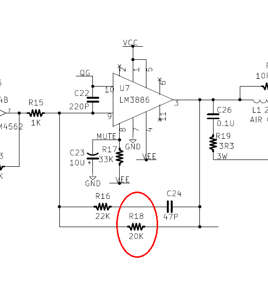

value of C23, mute pin capacitor
l notice that the datasheet application circuit uses 100 uf instead of 10 uf in the supergainclone circuit .
i am learning electronic and in this circuit if l use 100uf, there will be a switch off thump on powering off because the power supply to the DIP op amp collapsed earlier .
Am l correct with the reasoning?
Bob Cordell's design is shown in post #9. It has ten microfarads on the LM3886 MUTE pin. The schematic for this Super Gain Clone PCB (in post #1) also has ten microfarads on the LM3886 MUTE pin. I recommend that you connect ten microfarads to the MUTE pin.

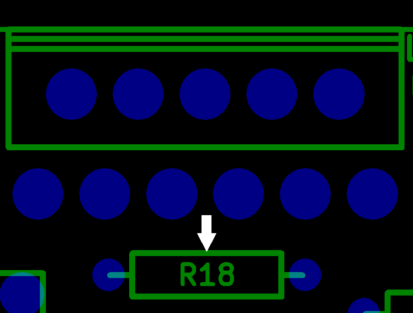

Please have a look at the "silk screen" lettering on the top side of the PCB. Its purpose is to help you know which layout footprint corresponds to a certain schematic component.
You can also treat the question as a recreational puzzle: figure out what goes where by gathering all the clues and then following them to a conclusion. For example ...
The schematic says that one of R18's legs is connected to LM3886 pin 3, and its other leg is connected to LM3886 pin 9.
Therefore we expect to find R18 somewhere close the LM3886. And indeed it is close! R18 is the very first component below the LM3886. See plot below.
