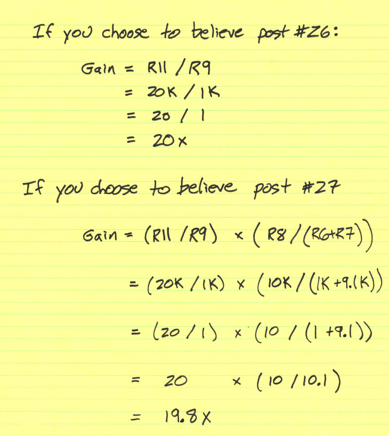

The power amp will be fed from my Salas DCG3 preamp that I think I set to 2x gain. Currently using a tpa3255 class d power amp with 20db gain.
Gain = 21 then by my maths.
You're about 5% too high; try it using pencil and paper instead of a calculator. The arithmetic is easy, and pencil+paper eliminates "fat finger" data entry errors.
If you're deriving from first principles, keep in mind that SGC is a cascade of two inverting amplifiers. Don't used memorized expressions that apply to non-inverting topologies.
I just used the R values from the schematic and admittedly used a calculator, although I think I hit the right keys.
What I dont understand is if R6 is part of the equation for gain, and yet R6 can be omitted if not using the klipper?
I am by the way very new to electronics!
Your last paragraph meant nothing to me.!
Here is the pencil and paper method of gain calculation. It gives answers that are about 5% below yours. More importantly, pencil+paper matches the gain number Bob Cordell wrote in his book: page 686 of the 2nd edition, page 541 of the 1st edition.
