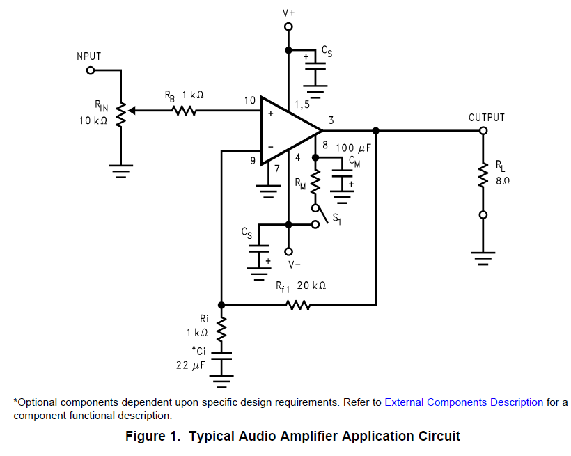

Offset is a non issue in the "compact" because of C7 that reduce the gain at DC and C1 which isolates the input.
Both are missing in Peter Daniel's kit which got rid of all the components Peter deemed unnecessary. Thankfully, Mark didn't and as such I don't understand why he's linking his design to such misguided former designs.
The "unity gain at DC" capacitor is present in TI's Typical Application Circuit, they call it "*Ci". On the Compact3886 schematic in post 1, its name is "C7". I happen to like the Nichicon Green Sleeve nonpolar capacitors, so I spec'd one in that position.
The input coupling capacitor was copied from the Super Gain Clone into the Compact3886. I spec'd a polypropylene capacitor in that position: it's C1 on Compact3886 schematic.
Since we're getting technical, it's possible to remove the influence of that cap by the respective sizing of the input and feedback caps. The input cap (a high quality mkp) should set the high pass filter f3 frequency. The feedback cap value is then selected to set a f3 point which is significantly lower. No voltage will thus develop across the feedback cap and its influence vanishes.The "unity gain at DC" capacitor is present in TI's Typical Application Circuit, they call it "*Ci". On the Compact3886 schematic in post 1, its name is "C7". I happen to like the Nichicon Green Sleeve nonpolar capacitors, so I spec'd one in that position.

to dhssettim: wow, that's surprising! The LM3886 has a mute feature built-in to the chip, which the Super Gain Clone board enables exactly as per the datasheet. None of the four SGC amps I've built and listened to, have had any turn-on or turn-off thumps at all.
Could you say a little more about the power supplies being used? Are they the "PSU for Chipamps" boards from this site? Other boards? SMPS's? What are the details?
Referring to the Super Gain Clone schematic attached to post #1 of this thread, capacitor "C23" is connected to the MUTE pin of the LM3886. Is there a chance it is installed "backwards"?
