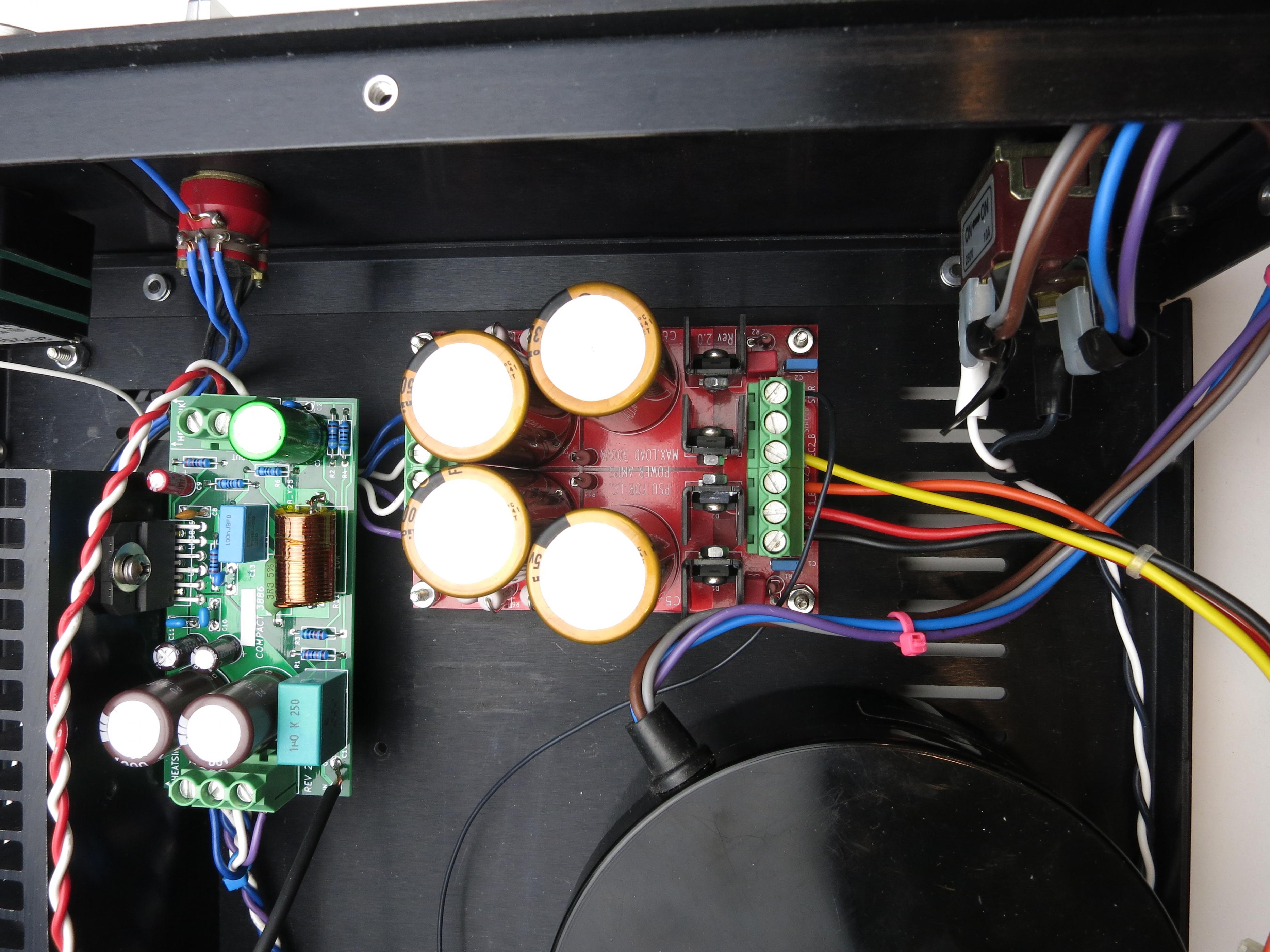

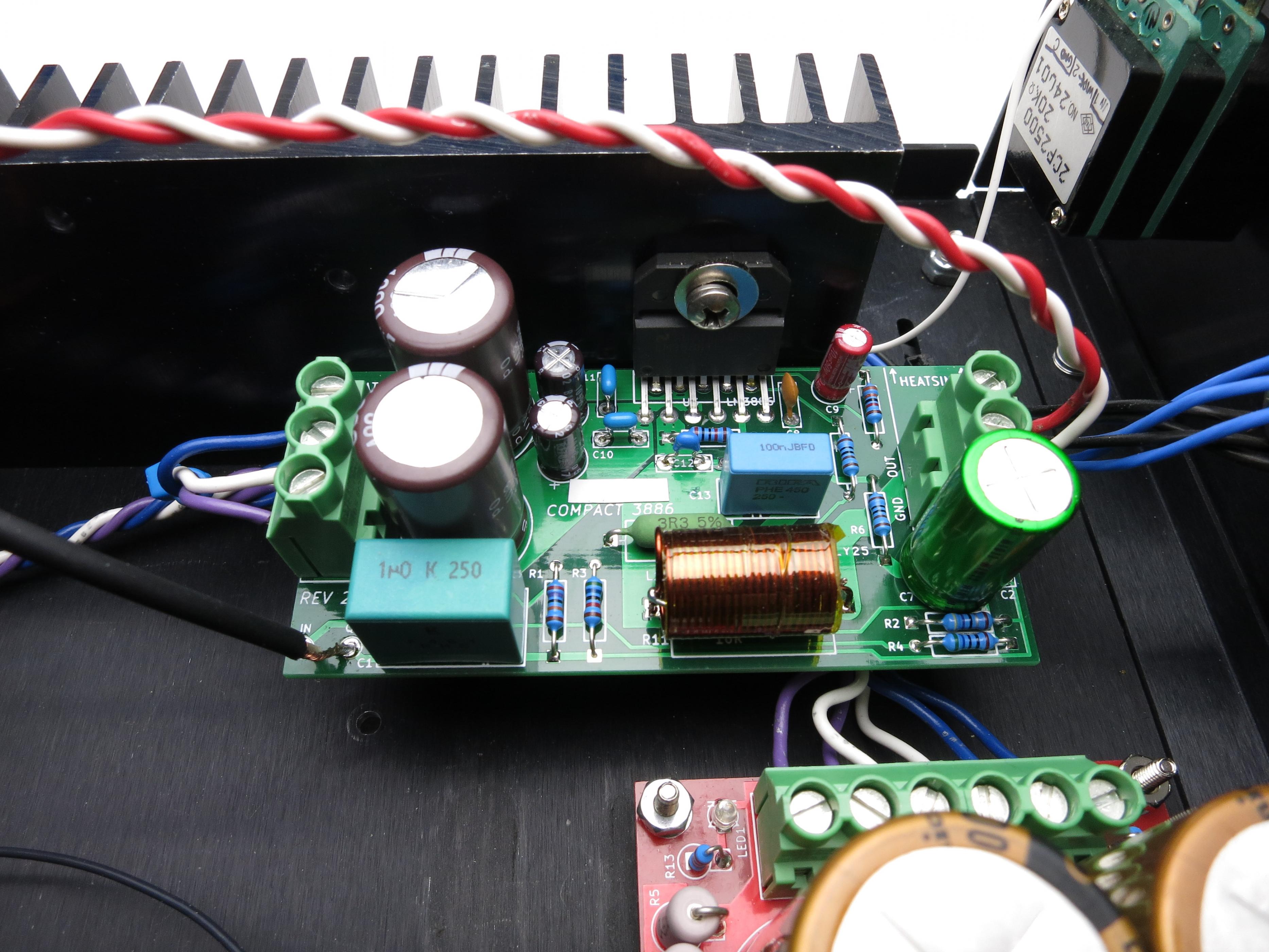

I striped out a different project from my test chassis and hooked up the compact 3886 (with a slightly earlier revision PSU.) It is quiet, works and sounds fantastic, even with the less than optimal wiring and layout that used a lot of preexisting holes.
I'm very pleased.
Anybody else have one built? I'm going to build up the super gain clone as well as the compact and have them in much better looking chassis than this one.

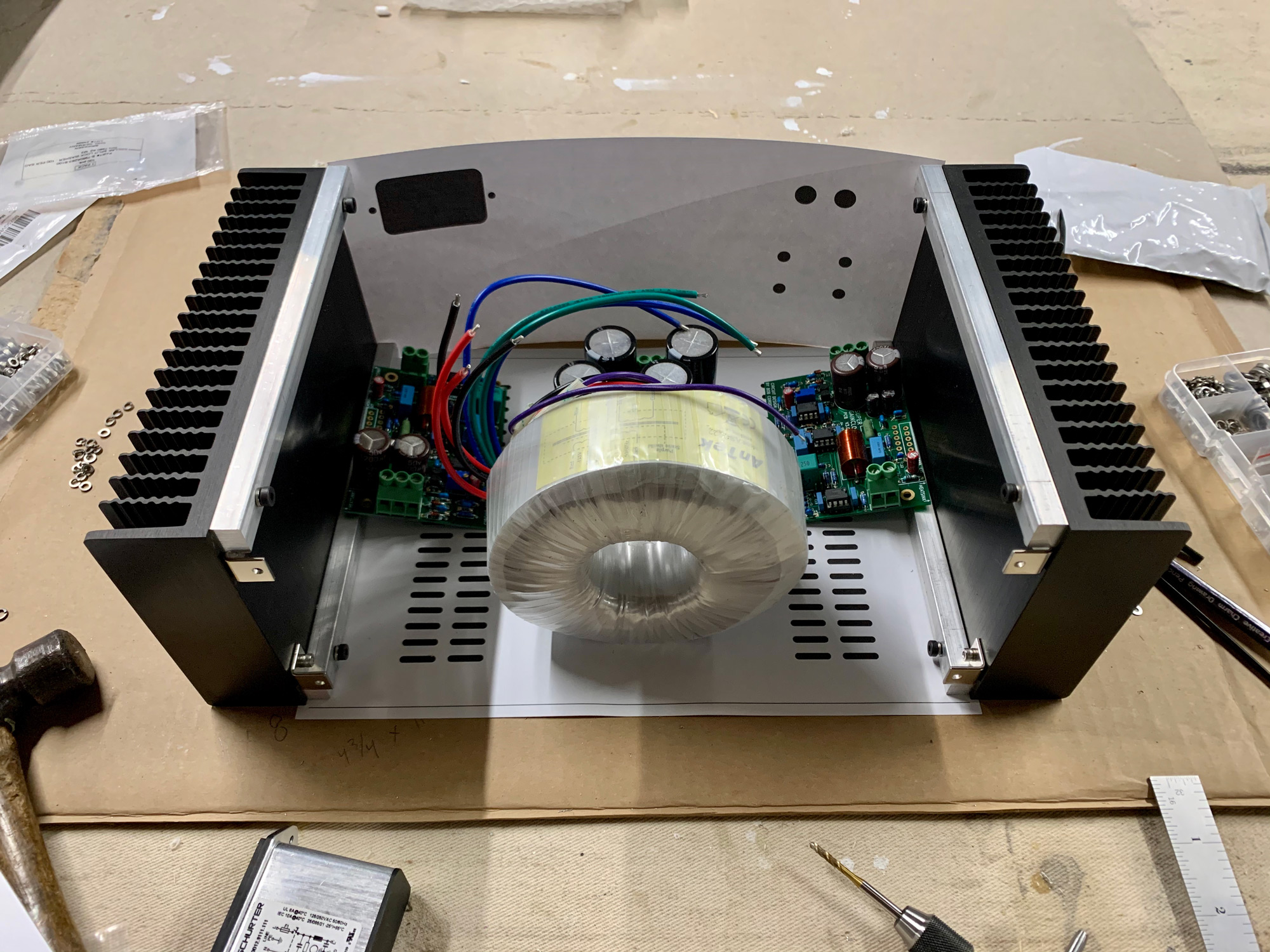

In the spirit of "use what you have" I found these 4.75 x 8" sinks that I must have ordered as extra at some point (also IEC from Whammy kit!)... Seems like they will be perfect for making a tidy amp about 14.5" wide—the donut in the pic IS the recommended Antek—but it's too tall for 4.75" tall chassis so I sourced a 150VA 2x22 that will fit the chassis on an L bracket. Top, bottom and back will be 3mm sheet aluminum—I'll add some holes for airflow—maybe even have them CNCd... front will be wood based... Not sure yet of look....
And I need to buckle down and figure out how to set the Klever Klipper! One of the many reasons I wanted to build this—more learning!
Also making good use of the the L brackets from the BOM!

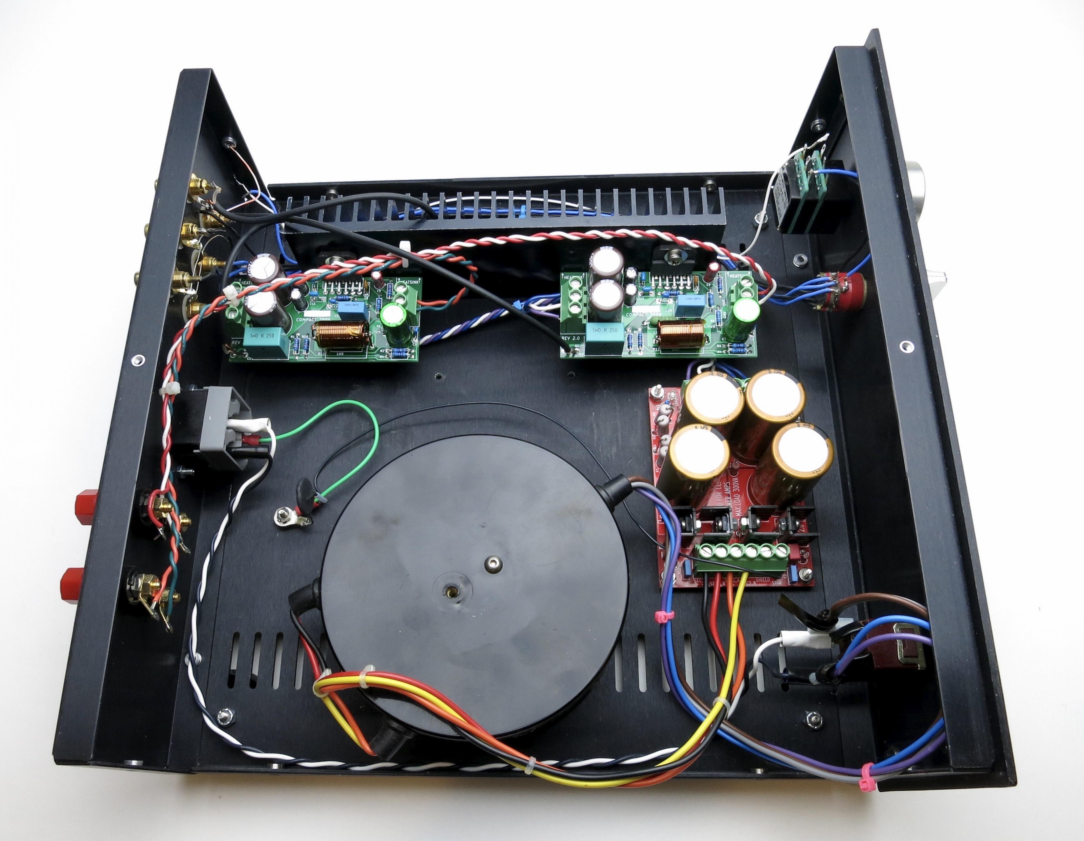

With Mark's help, thank you, I/we have dealt to my turn-on thump and turn-off pop.
I installed Mark's suggested new/altered mute circuit components and I'm a happy camper.
This is one sweet sounding amp.
