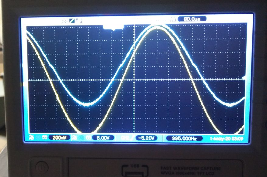

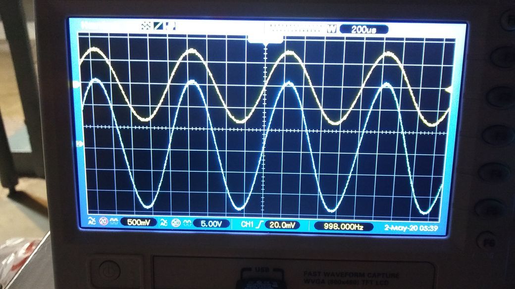

Is that the output of the amp we are looking at there? Left and Right channels.
Yes it is. Frequency was 1Khz and I believe that pic was "zoomed in" at 2v/division.
Input signal was set at ~ 500mv
8 ohm dummy load on both channels.
I used 2 sources....the first was an old Trio signal generator and for the second I used a function generator app by Kewlsoft on my android phone. The later only provided about 300mv output but showed the same results. I'll try to redo the test scoping both input & output, one channel at a time and take a few more pics.
I should add that this is my first scope and I'm still learning with it.
I don't know if it makes a difference or not but the pic was taken with the klipper disabled.

The klipper could not introduce distortion like as far as I can see. It might be worth trying with no load as well and seeing if the distortion goes.
Are there such things as fake LM3886's? as I can't really think of anything else that could generate a non linearity like that.
Is it all built on a proper PCB with proper return of the load currents back to the power supply?

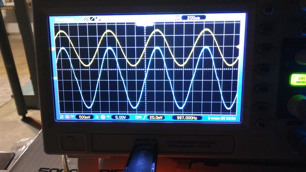

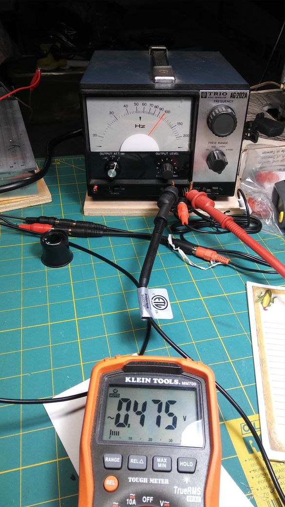

More scope shots
For these pics I only used the Trio signal generator as I needed the phone to take the pics. Pay no attention to the date on the scope screen as it is not set correctly.
Amp was built exactly as specified in Mark's schematic & BOM using Mark's boards. Parts were purchased from Mouser & Digikey. In both scope shots, the yellow trace is the input and the blue is the output into the 8 ohm load. first up is the left channel followed by the right. 3rd pic is a pic of the trio and the signals voltage level taken at the Trio's output. I ran the self calibration of the scope and did a check of both probes before starting.
did the tests with the volume pot wide open. When I get a chance should I repeat the test without a load?

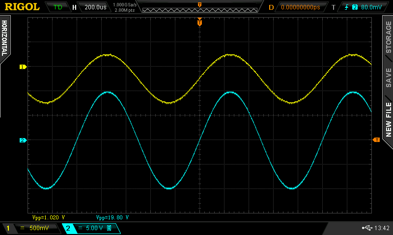

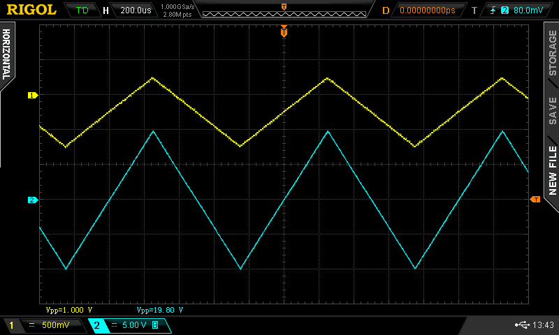

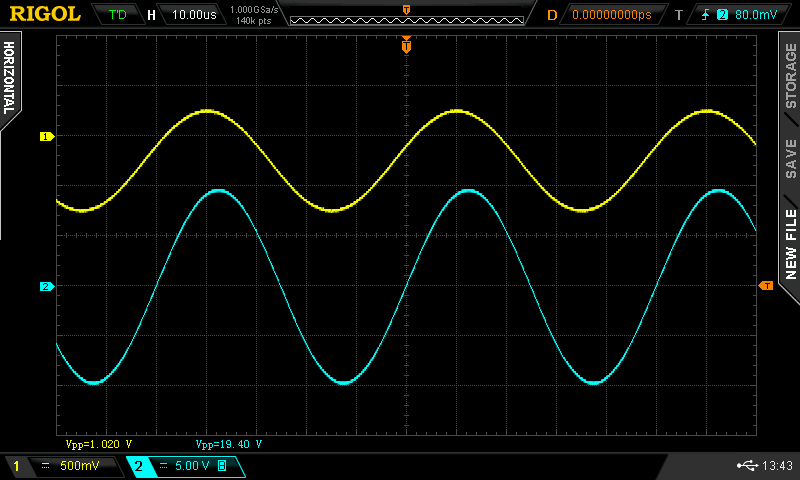

I powered up the Super Gain Clone stereo amp shown in photo #3 of the very first post in this discussion thread. I told the oscilloscope to make screen-capture-png image files; in each case the input is on top, in yellow; and the output is at bottom, in blue.
You can see that the amplifier's input-to-output gain is almost 20X, except for resistor tolerances in the amp and, I expect more importantly, scope A-to-D quantization and waveform feature extraction tolerances in the scope itself.
The first screen grab shows a 1 kilohertz sinewave, the second shows a 1 kilohertz triangle wave, and the third shows a 20 kilohertz sinewave. They all look reasonable to me.

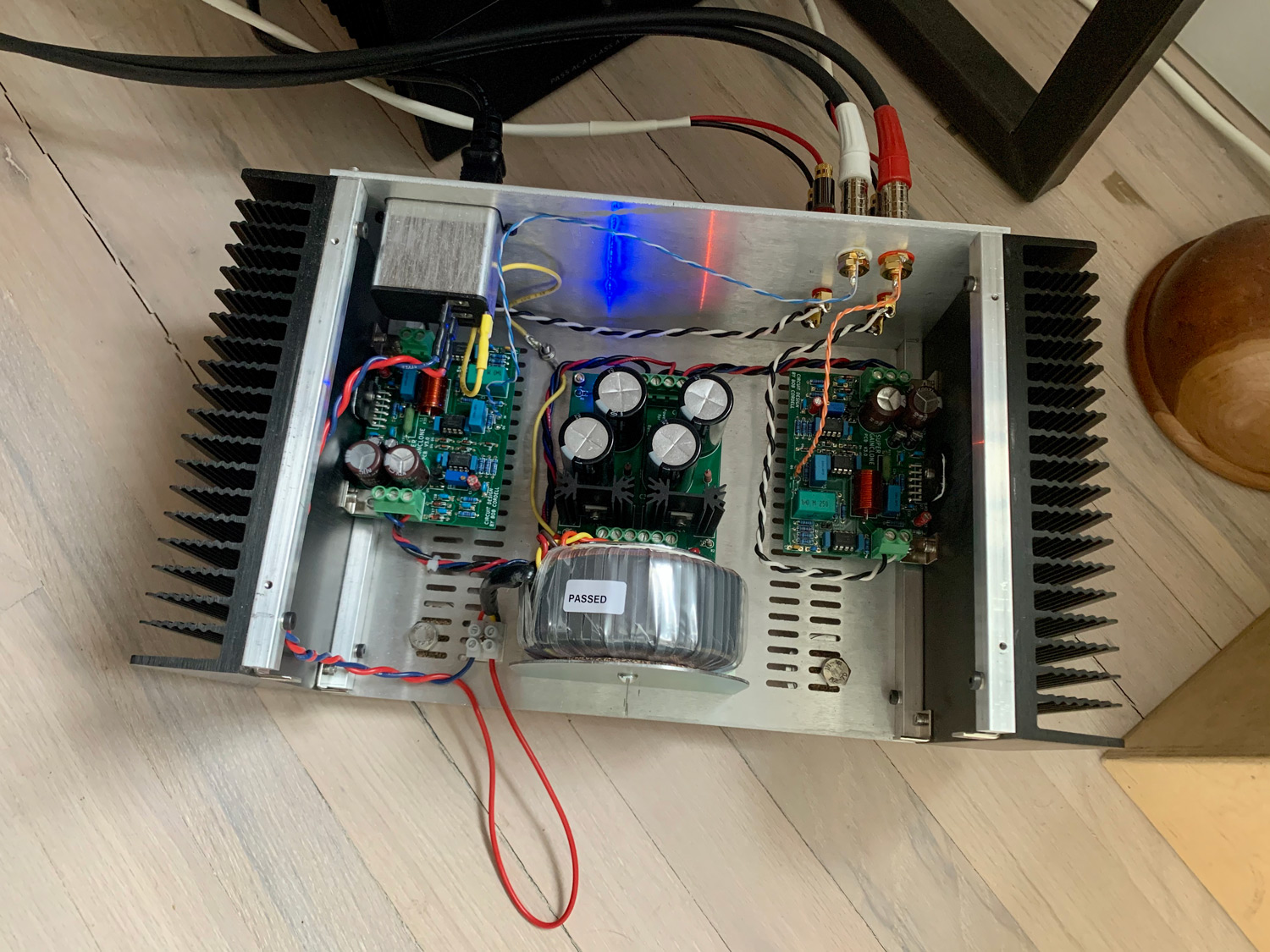

YES!
Couldn't wait to finish it completely. Sounds FANTASTIC with Noir in front. And I love the weeny proportions I ended up with in terms of physical amp size (built around a pair of 3U sinks from Modushop I had laying about.—Likely WAY overkill, I can't really feel any heat on them...been running for an hour—I think you could build this with internal sinks).
I did make this amp concurrent with a some M2X mono blocks. It's been fascinating to A/B them in the shop. I plugged earbuds directly into the speaker jacks with the inputs shorted. Was able to tune the transfo—huge difference—also got quieter with the lid on. And could hear the left has a bit more "noise/buzz" than right—longer AC? routing... overall it's not HUM—just some "hush". I was testing it with the B1K in the shop—that does have some noise in my main system—silent with no ringing with the M2X mono blocks—slightly ringing and some noise is back with Cordell—ground loop with B1K? Monoblocks difference? The M2Xs are absolute ghosts. Incredible. Anyway—I can't hear any buzz or hum with the Cordell and some B+W speaks with Noir—Tidal on the Mac as source (I will check again later since we do have a fair amount of ambient noise in the studio). Great bass (like I can feel it in my feet)—good all around really. VERY very pleased.
Also, there's a different sound profile between 3886 and all the other Pass amps I've made so far...hard to describe. It's a "refinement" thing. More "music" with the Pass designs maybe—but no difference in listenability. Cordell is sticking around. I do prefer it to the mono ACAs it's sitting in for in the office..... ah... there I said it! (My Opinion).
I have the Klipper disabled til I can figure out if the device I have in the shop that my uncle sent me is a signal generator or not (Stanford Research Systems DS360 Ultra Low Distortion Function Generator) Need to read the manual—and it needs probes. I'd rather do the full Klipper setup as opposed to the no scope version.
Yea! Mark Johnson. Thank you! (and Cordell too of course. Ha!)
I'll post a finished pic after I make the front.

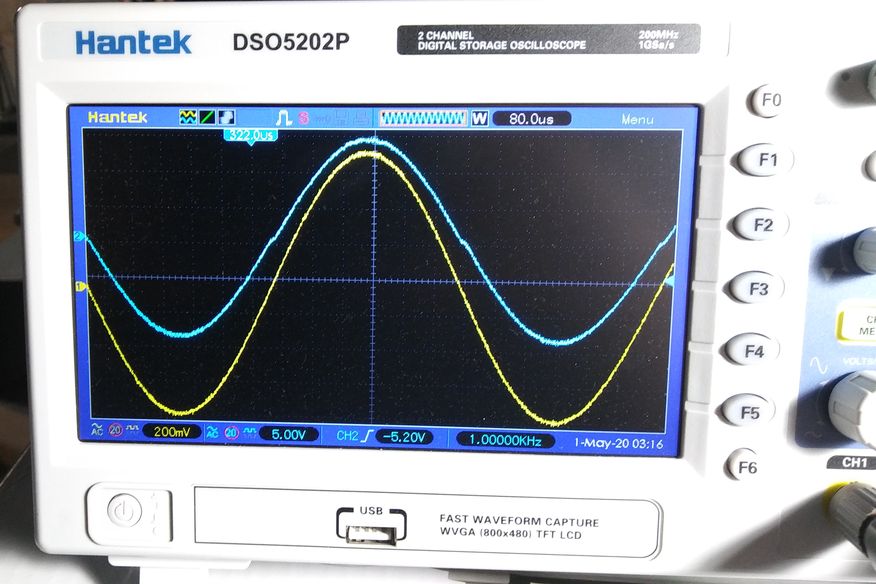

4R & No load pics
Mooly,
Sorry this took two days but yard work called!
No pic but there was a clean signal at the junction of D4 & 5.
3mv at the servo output.
Still had crossover distortion at 4R load but with no load it vanished! What does this indicate to you?
Output is the blue trace, yellow the input.
Oh, and the same results at 10Khz but no pics.

Well it points to crossover distortion and no bias but it must be said even if that were so its pretty extreme to be so visible.
Lets throw a wild card out there... scope the rails with the amp under load and producing the distortion. Use AC coupling for the scope. The rails on the board should be clean (and be careful measuring... don't blow it up ;))
Have you used any sort of chokes in the DC supplies to the PCB, particularly anything shared between the pos and neg rail like chokes on a common former.
Also have you used any kind of ferrite component in the output feed. The output inductor must be air spaced and not wound on a magnetic former.
Also no ferrite beads slipped over any leads?

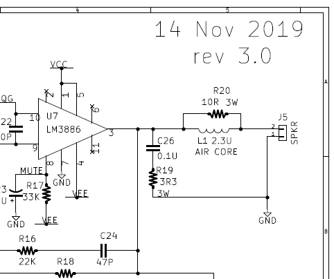

I realize this is a longshot since it presupposes two identical, simultaneous flaws ; one for Left and another for Right ....
Maybe the hand-wound output inductors did not expose enough bare copper (after scraping away the enamel coating) on both ends, to get two good solder joints and two good electrical connections.
I.e., perhaps a DC ohmmeter would tell you that the end-to-end resistance of (R20 parallel L1) is closer to 10 ohms than to 0.001 ohms ... ?

Mark... the last scope shot does show a loss of around 'half a divisions worth' of amplitude when going from no load to 4 ohm.
It might be worth looking at the signal before and after the coil and maybe also just trying the resistive load connected to the input side of the coil rather than the output side... so short out the 10 ohm in other words.
A resistive load should not cause any stability issues without the coil present.

Mark & Mooly,
Since this would be the easiest thing to check I will start that.
I'll also scope the signal at the input of the coils.
