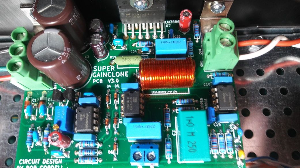

Tim applied several changes to his SGC PCB and none of them helped. Eventually that board became unusable due to multiple rework operations. Could have been lifted copper pad, broken track, I don't remember. Then he built a second SGC PCB on a brand new board, with brand new components and a tiny circuit modification I suggested. The second board made no pops either at turn-on or turn-off. But he never removed the mod on the second PCB to see if the pops would return. So we don't actually know whether the problem was simply an error or bad component on the first PCB, which disappeared when he threw that board away and built the second PCB.
To apply the tiny mod, you must first measure the DC voltage of the two power supplies at the inputs to the SGC board (labeled "+IN" and "-IN" on the silkscreen), with both the PSU and the SGC board(s) mounted in the chassis. Tim was using a transformer with unusually high secondary voltage (and correspondingly larger heatsink), as I recall. I doubt that his measured voltages would match anybody else's.
Also, Tim had the good fortune to live in an Australian city with a Jaycar retail store, so he could buy electronic components and solder them in, an hour later. Not everyone is so lucky!

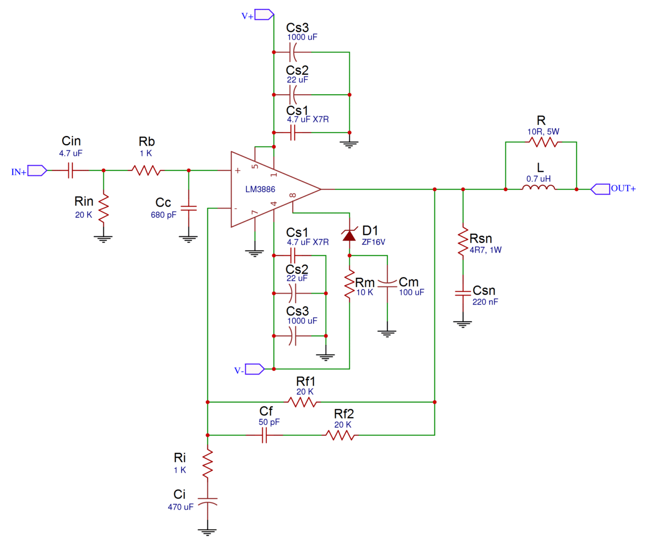

Mark was very helpful in my quest toelminate the turn on and turn off pop.
I tried several RC combinations in the mute circuit to change the time constant.
Eventually I wired in (at Mark's suggestion) a combination with a zener (I would need to look up the details) and that fixed both pops.
I was happy.
Thanks again Mark.

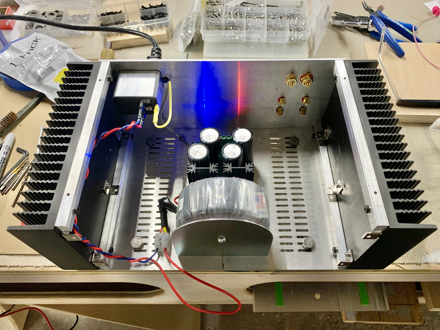

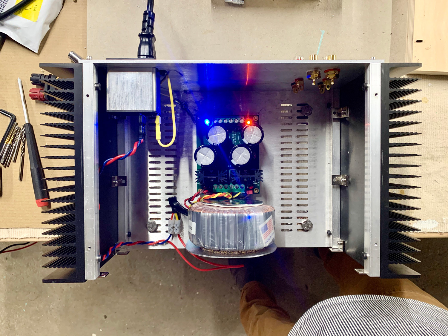

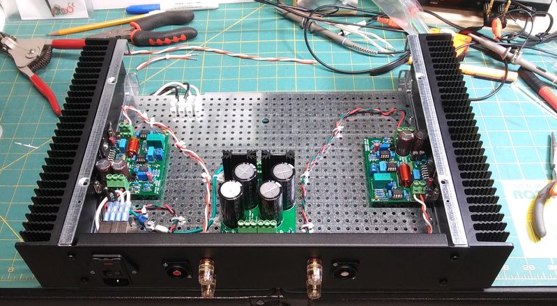

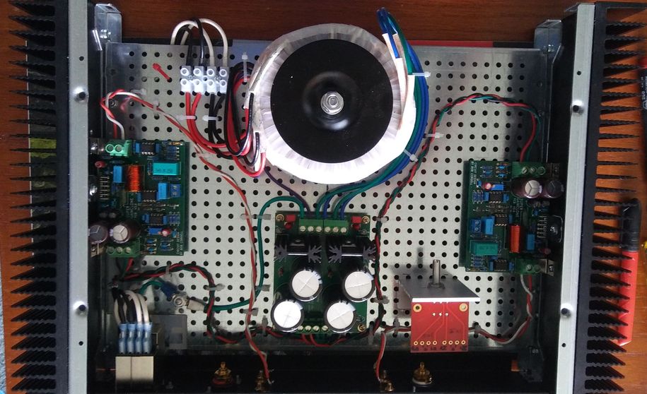

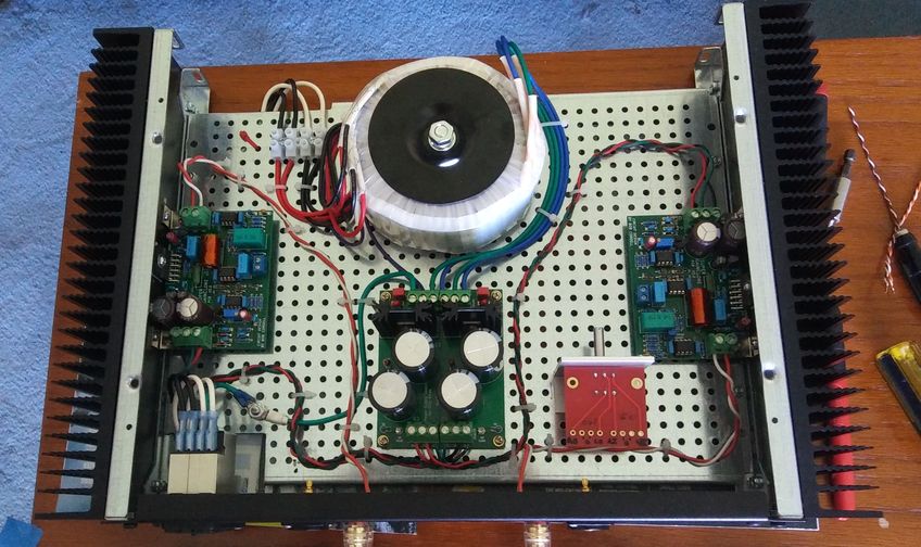

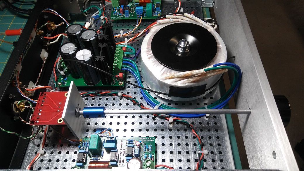

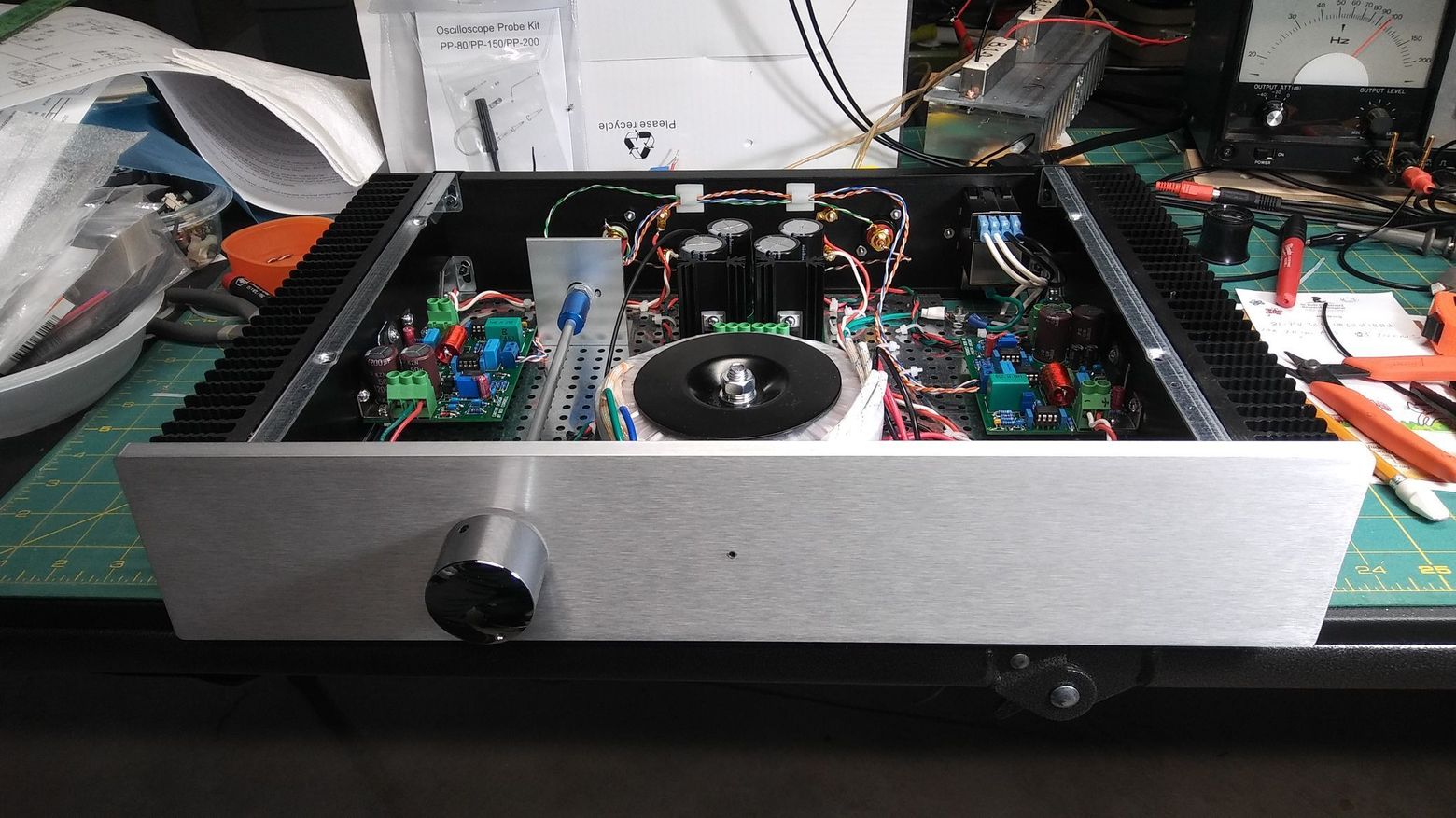

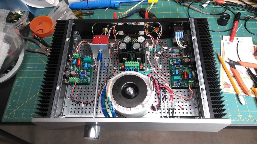

Some long ovebuild pics
After installing the new components Mark suggested, my turn off pop was gone.
here's a few pics of the build. Imitation being the sincerest form of flattery, I pretty much copied Mark's layout with a few minor changes. I added a filtered and shielded ac inlet, a volume pot and an input terminal to the amp boards after doing some careful surgery on the back corner of them with a Dremel so they'd fit over a resistor.

Very beautiful, congratulations! A clean and tidy layout, well executed. I really like the way you notched the shiny silver mounting plate, to give extra clearance for the AC mains power inlet. BTW your inductors are a lot nicer than the ones I've made so far.

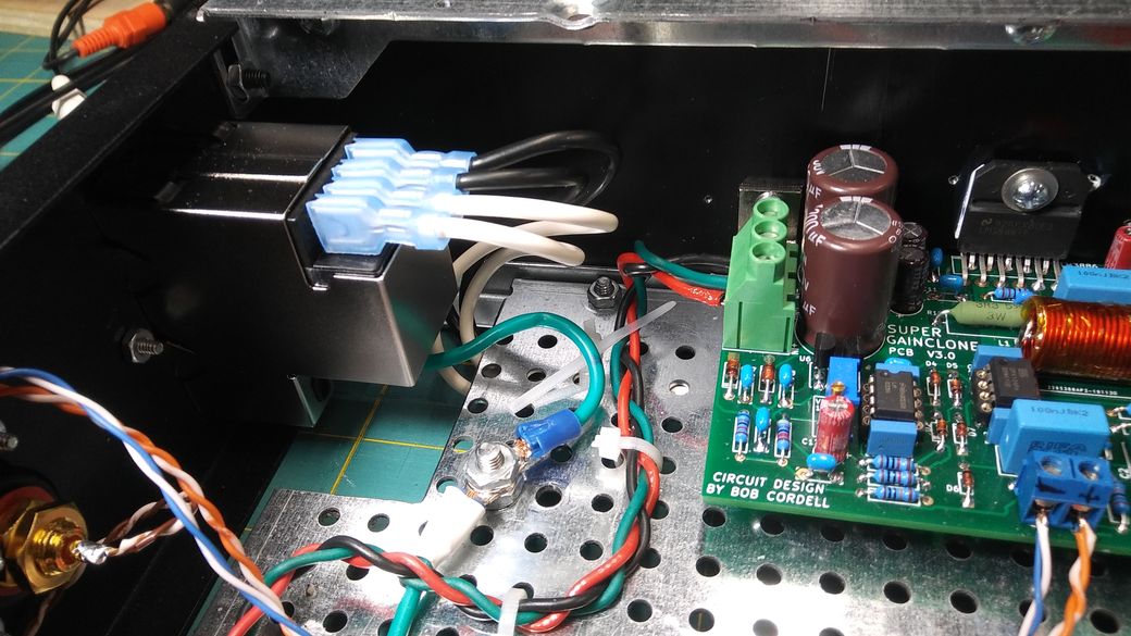

I wanted a power indicator on the front panel but I'm not a big fan of blinding blue LEDs
in that position so I came up with the idea of attaching a cheap, thin length of fiber optic
cable to the blue led on the power board using a couple different diameters of heat shrink tubing. then I merely attached it to the tranny using gorrilla tape and snaked it out the center of the front panel. hard to see the the heat shrink in the pic below but you can see how it was routed through the front. I did tie a wire strap around the output of the PS
to act as a strain relief at the LED.
