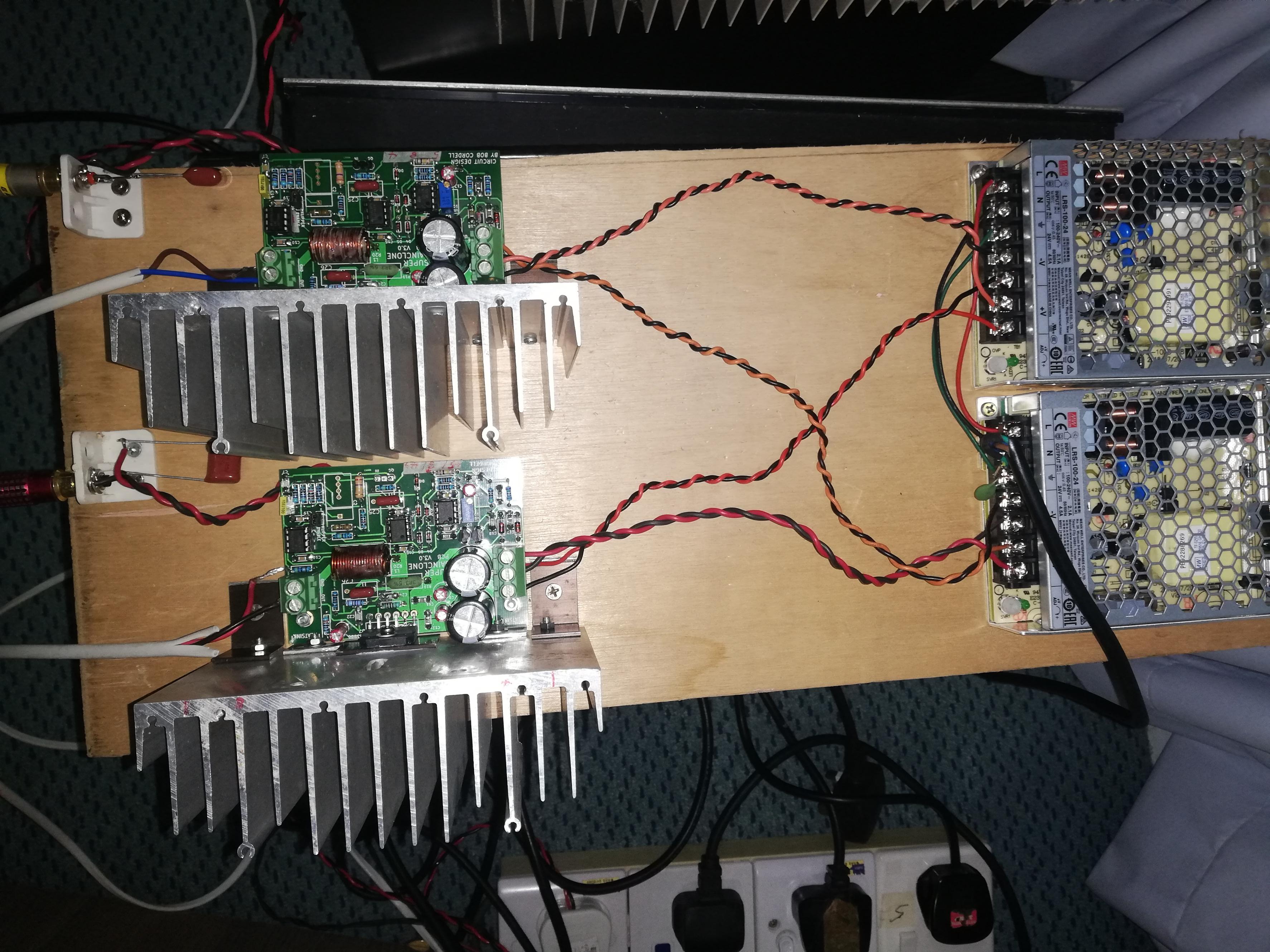

I also have a switch on and off thump also .
My input voltage is + and - 27 v smps meanwell power supply.
can l use the same value of 22k resistor in series with 22 v or 24 v zener in place of the 33k mute resistor at R17?
Want to thank Mark for the pcb and the support. Nice calm and quiet amp that l like. Very detail and precise amp. Worth casing up
there is a little bit of buzz with ears right close to the markaudio 12 p speakers with the input shorted.
Otherwise, it sound very natural across the entire frequency range . BIG soundstage wll beyond the speakers and music surrounds you .
The amp and power supply generate almost no perceptible increase in temperature after many hrs of use.
I use AB epoxy resin glue to keep the inductor in place.
First attempt at this
