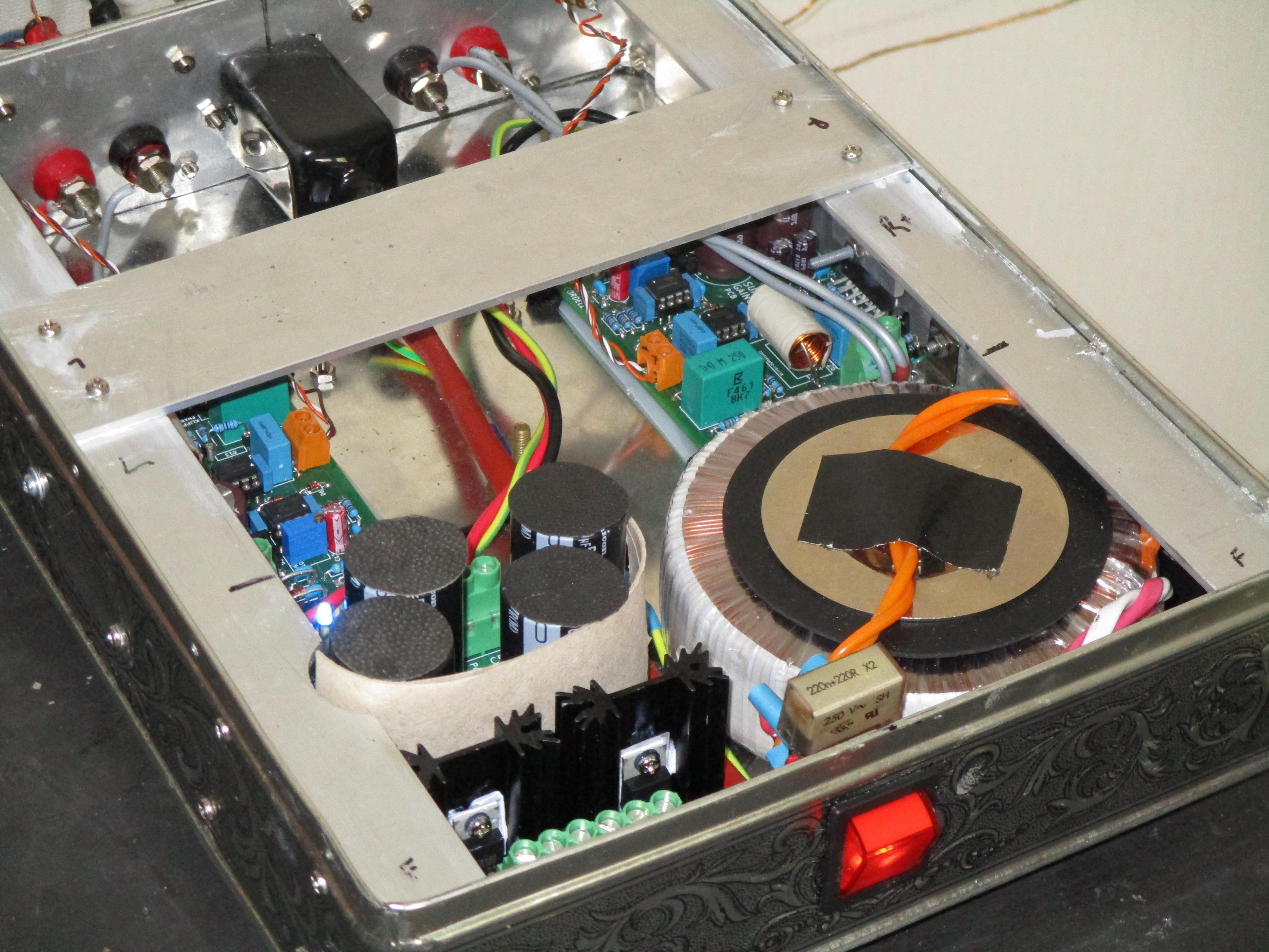

I've built a 2nd, lower power, BCSGC.
I used a 0-18v (x2) transformer and have used the chassis (a biscuit tin) as the heatsink.
Again I used 5k1 for R13 and 18K for R18.
Another very nice sounding amp.
Thank you Mark and Bob.
