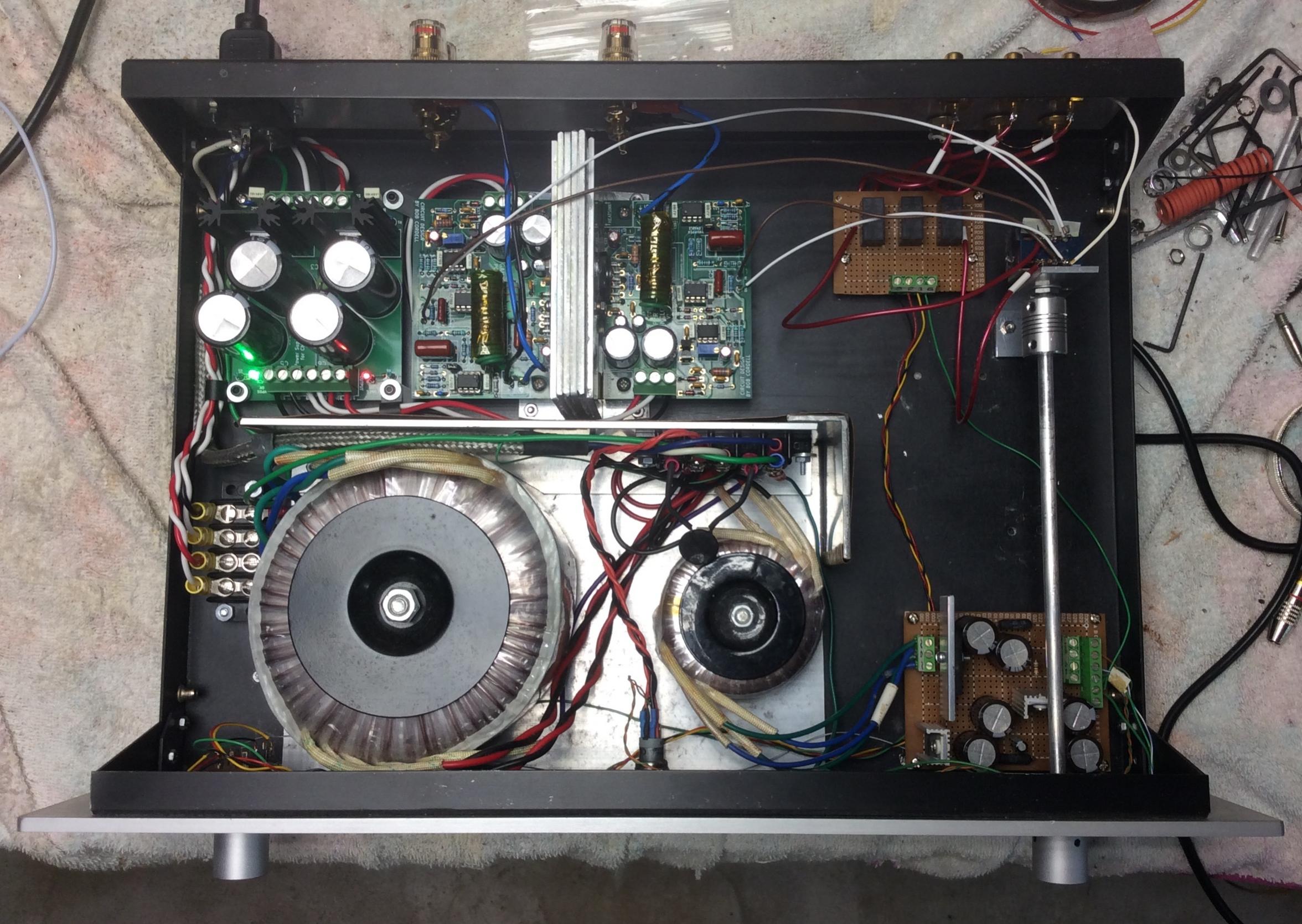

Folks:
I recently acquired a set of Mark Johnson's version of Bob Cordell's Super GainClone and power supply pcbs (thanks Patrick!) and am working out how to fit the boards into a partially-completed but long dormant project. I have a dumb question: the transformer that is already installed in the chassis is an Antek AS-4224, which is a 400VA toroid and twice the size recommended by Mark. I'm fine leaving it in place unless there is a compelling reason to downsize. Is this an issue?
Scott
Scott
Mark:
Thanks! There is room in the chassis for only one of your power supply boards, so dual mono isn't going to happen. I've found Nichicon VR series 10k uF 50V caps for the power supply, but have not found any higher capacity caps with a 25mm diameter. I trust that a single power supply board with a total of 20k uF per rail isn't a deal-breaker?
Scott
Scott

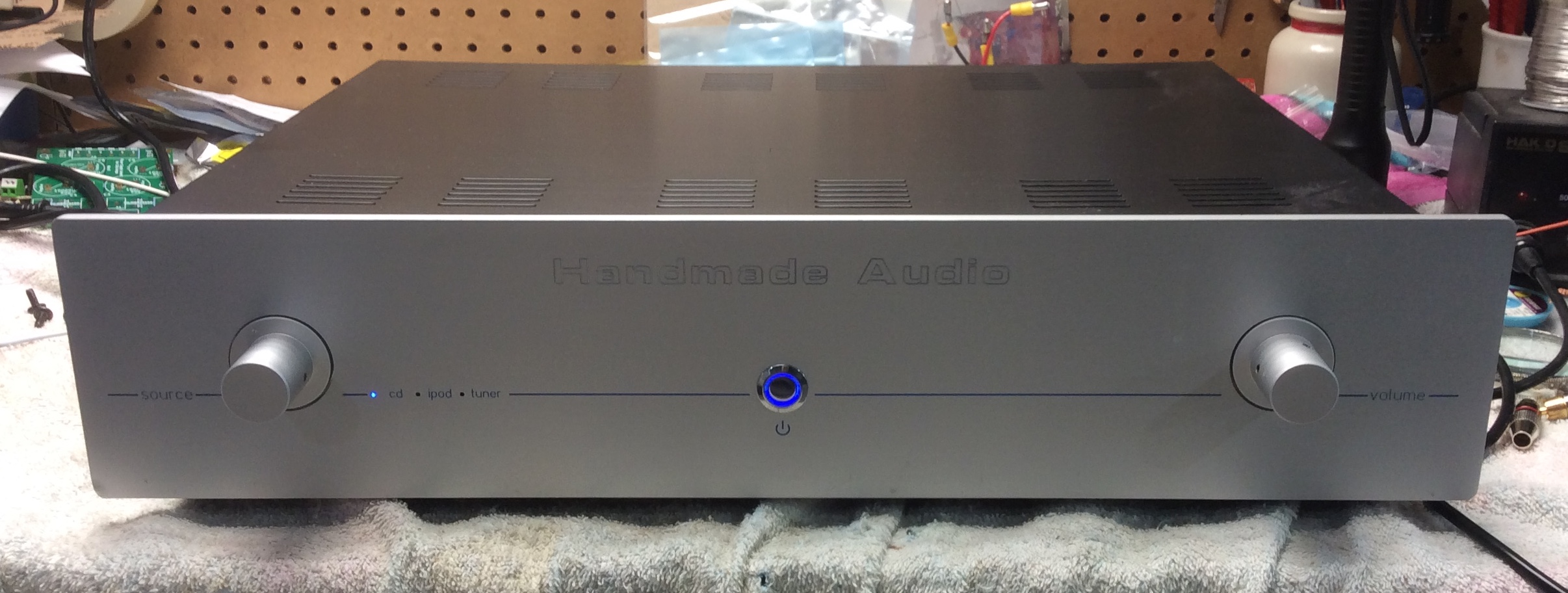

I have everything soldered up and mounted in the Dissipante 2U case, Just need to start wiring everything together. Since I bought two of each board, I have an extra set laying around for the simple version. I was thinking of building the simple version as a subwoofer amp. Since this would be a mono amplifier, can I use both the left and right channels together to get 80 watts out of this amplifier? If so, how do I wire them up?
Folks:
I started a chipamp build about 10 years ago that was troubled from the start; I didn’t have a schematic for that particular chipamp pcb and I foolishly tried using an undocumented buffer circuit. Frustrated by the problems I encountered, I shelved the project.
Inspired by Mark’s Super Gain Clone implementation, I decided to resurrect the project and see what could be salvaged. ItsAllInMyHead graciously sent me an extra set of SGC and PS boards and the project progressed very nicely. The resulting amplifier sounds terrific – far better than the vastly simpler chipamp.com-based amp it replaced. And there is room for further tweaking: the chassis has ample space to add a preamplifier or buffer downstream (the power supply for either is already in place). I also have a nice DACT attenuator that will be swapped in for the Blue Velvet that’s currently installed.
Many thanks to Bob Cordell, Mr. Johnson and Patrick (ItsAllInMYHead)!
Scott
Scott
Mark:
Yes, but to be honest that was mostly fortuitous. There was a little space in which to slide the power supply and SGC pcbs, and the final position was chosen as much as anything else to maximize the space that could be used for a linestage or buffer (plus some additional ps capacitance for the line stage or buffer).
Sometimes / blind squirrel / nut. Y'know?
Scott
Scott
It appears the heat sink is a "T" design right? The bottom panel is likely sinking a lot of the heat anyway.Mark:
Scott
