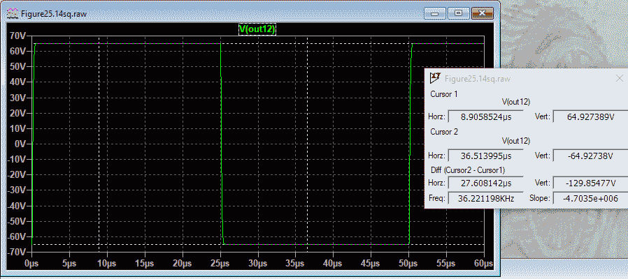

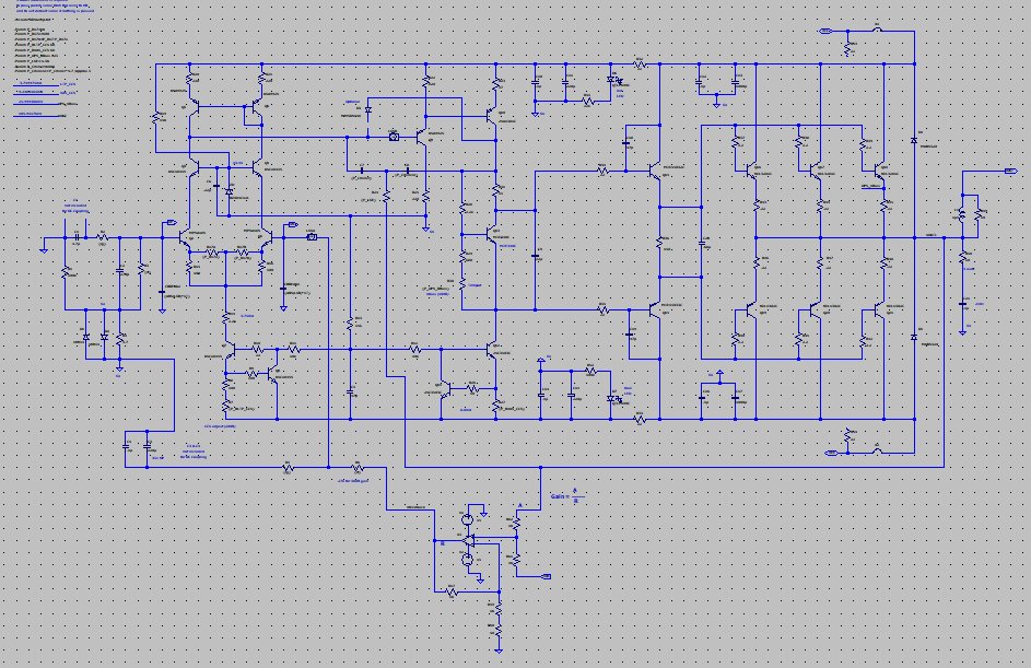

See mods attached.
  1. A VCVS is added to get "out12 = vout-1 - vout-2. It's effectively an ideal diff amp. It's needed to do FFT and .Four
  2. Also added Schottky diodes across Q17 etc base-collector to stop sticking when clipping.
  3. One split power supply (not two).
BTW where is the feedback in this amp?😀
How can I optimize to make the square wave look good
Hi hwckent,
I did not notice your earlier circuit had R3 as 100 ohms when it should be the same as R2 2k to match Bob's circuit.
With R2=R3=2k you get a gain of 22 requiring 2.5Vpk input. So for twice the gain I set R2=R3=1k requiring 1.3Vpk. See plot.
attachment.php
Next, to get a clean squarewave response I reduced 'c' to 100pF and connected input filter caps C11,C12 and increased them to 100pF.
It's clean to 65Vpk (max) and transitions 100V in about 200ns, that's about 500V/us slew rate 😱

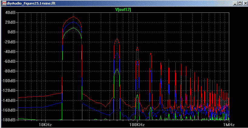

Hi hwckent,
The attached gives distortion at 1W 20W and 200W
attachment.php
At 1W THD is 0.007% most of the distortion is from the output stage (IPS is 0.001%). At 200W most of the distortion is from the input stage 0.7%. I don't think this is a concern since music hovers around 1W on average.
Increasing the idle current from 150mA per pair to 200mA reduces 1W THD to 0.005%. But dissipation is 33% higher or 100Wpc😱 so I'd stay with 150mA.

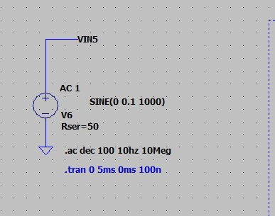

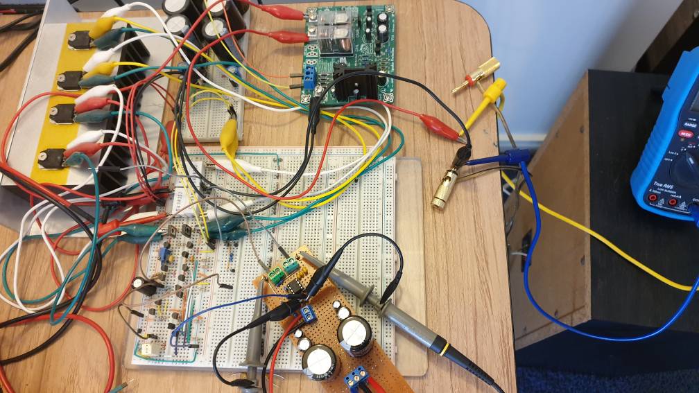

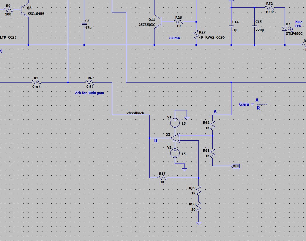

Hi Bob and other forum members

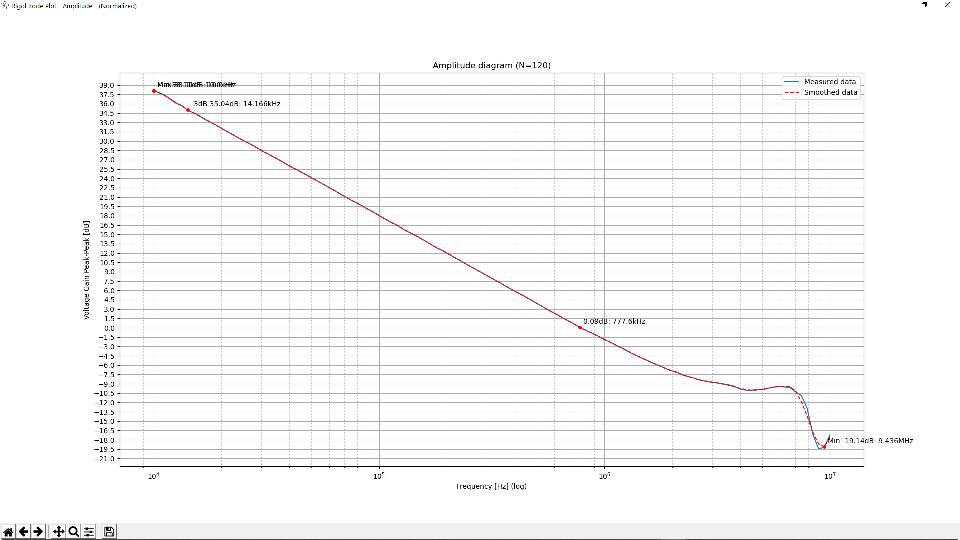

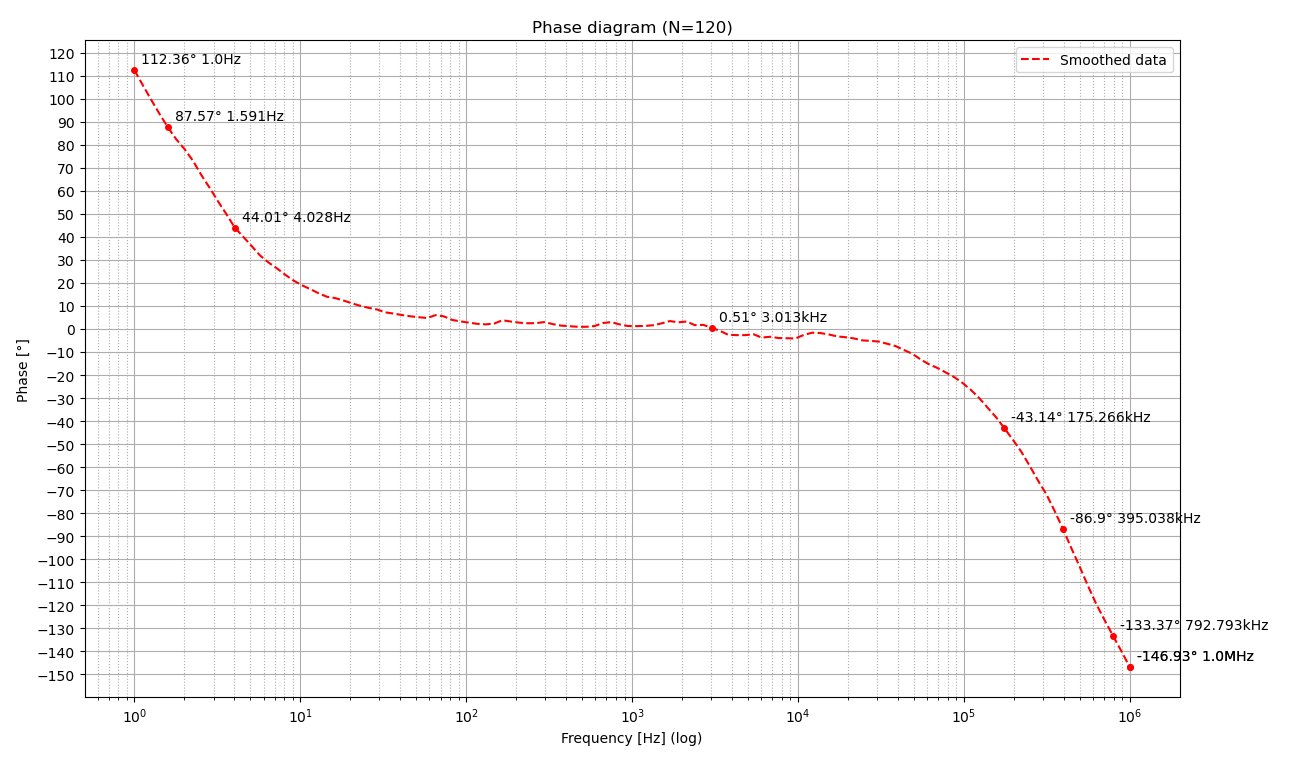

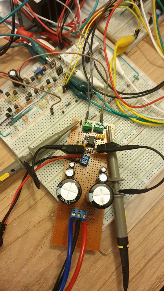

Awhile ago before I build my first amplifier (The honey badger (HB)) I built one of your amplifiers on a bread board as a learning exercise.
Now, I want to measure the loop gain of my HB so I can optimise my phase and gain margins by tweaking the compensation capacitors.

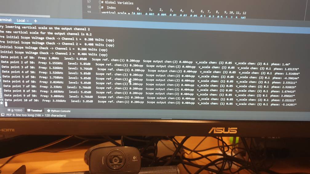

To do this I wrote a python script on my computer using pycharm to control my signal generator and oscilloscope.
The script then captures all the data and generates the loop gain plots.
I then built a small op amp circuit to inject a voltage signal into the feedback path so the loop gain can be measured.
I used my breadboard amplifier to do the testing and proof of concept.
I now hope to test my HB using the same setup.
I would be interested in what you guys think.
In the plots shown I'm using a 20pf composition cap. 20201024_090134.jpgdownload_20201026_052532.jpgdownload_20201026_052536.jpgdownload_20201026_052538.jpgdownload_20201026_052506.jpgdownload_20201026_052508.jpgdownload_20201026_052511.jpgdownload_20201026_052546.jpgdownload_20201026_000406.jpgdownload_20201026_000422.jpg
In the plots shown I'm using a 20pf composition cap. View attachment 887640View attachment 887641View attachment 887642View attachment 887643View attachment 887645View attachment 887646View attachment 887647View attachment 887648View attachment 887649View attachment 887650
Did you describe your setup anywhere else? I also have a Rigol scope and might want to
try it out if you are willing to share your scripts. What signal generator are you using?
Does the Pycharm script run on a Linux platform?

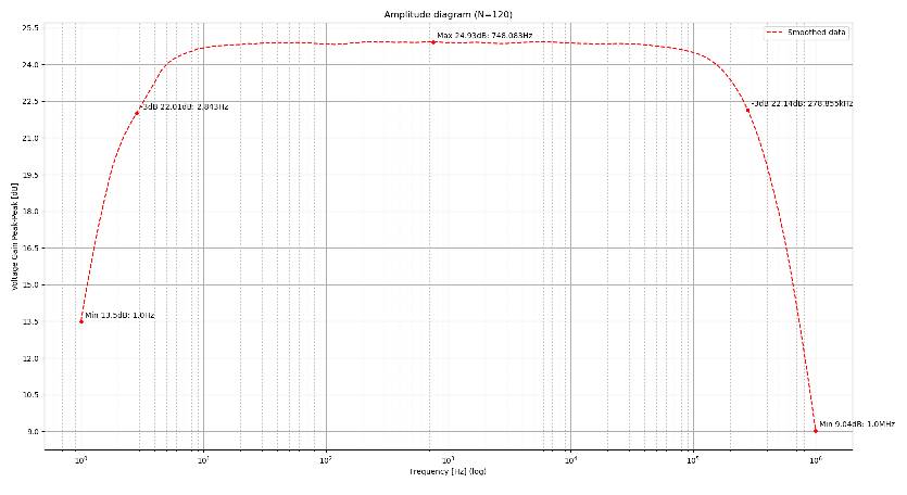

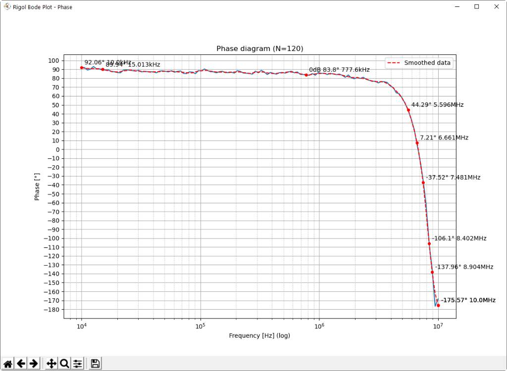

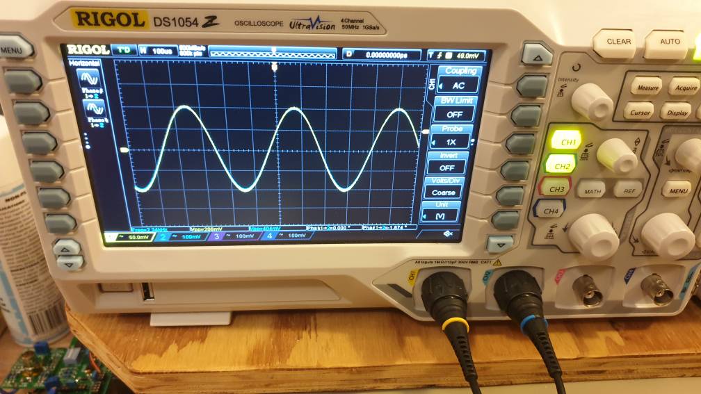

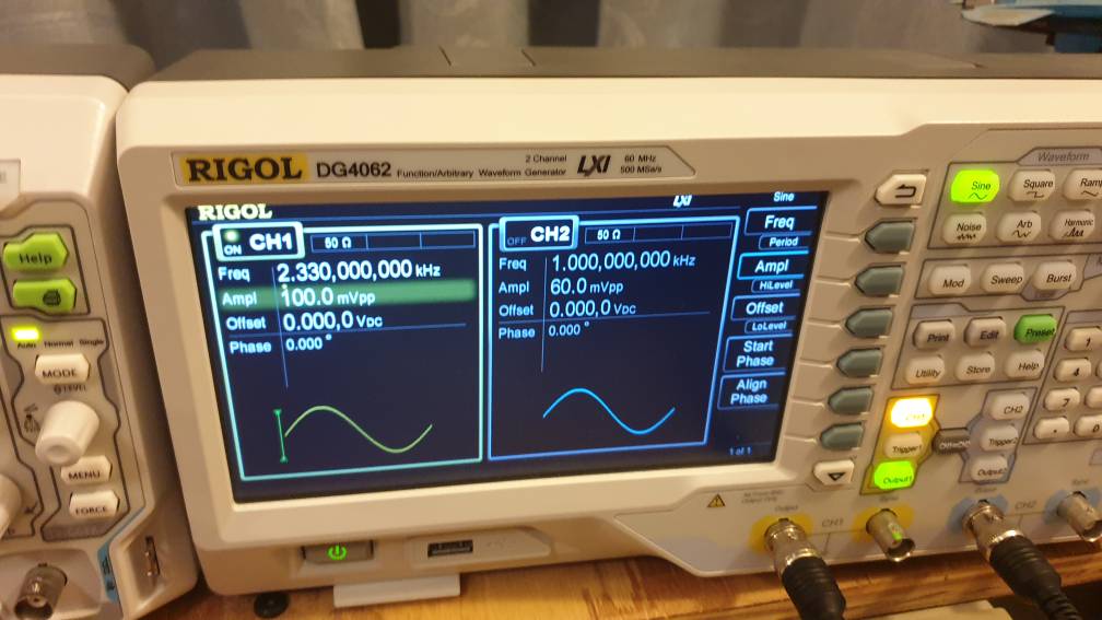

Hi Pete,
No I haven't discussed this on any other thread as I basically just got it all working. I asked Bob back in late August about testing phase and gain margins. This is were I've ened up.
I first worked on producing straight bode plots using Vin after the input filter network and Vout measured before the zobel network.
See attached samples.
The plot has a 300pf cap installed.
Its quite tricky to capture measurements. I'm using the fine or vernier scale to maximise the scopes 8bit DAC and do math on the vertical scale to ensure my vertical scale is at about 7 divisions. You have to do a fair bit of error checking as well to ensure that you are capturing valid data.
Now moved on to measuring the loop gain using the op-amp as the injection source.
I'm now working my injection circuit to maximise my measuring range.
I hope to be able to measure from 53dB down to -23dB for a total range of 77dB
The scope and signal generator programming manuals contain all the info you need to create your script.
Pycharm suits nearly all operating systems including Linux.
While I would not share my code as it has taken many, many hours to develop. Send me a pm if you get in trouble getting your communication link going.
I'm using a Rigol DG4062 with cracked firmware to enable 200Mhz bandwidth. Its shown in my above photos. But any signal generator with programming interference should work.

I guess I love to hear what fellow more experienced forum members think of my testing methods.
Are they valid?
Can I do anything further to improve things?
I'm currently using a LME49720NA op-amp. But have a HA9P5002-5Z on order as it will give me more measuring range.

Hi hwckent,
Hi Ian, you may want to watch this as your distortion plot may not be accurate as your fft resolution is to high.
LTspice tutorial - Ep6 Basics of FFT analysis and .four statment - YouTube
