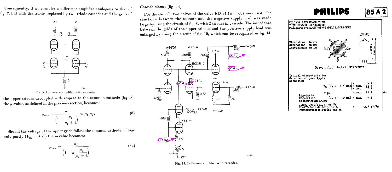

The driven cascode as I described it (cascode gates or bases driven from an output-derived replica of the feedback signal) is indeed old - I employed in the 80's....
Not exactly the same, but a parallel idea from 1955.
Philips, Rejection Factor Of Difference Amplifiers
Cascodes bootstrapped with a conceptual battery or a gas "Zener".
Cost HAD to be an objection to these schemes; more likely poking at limits than a practical application.
(I now suspect that "M18" is 0.18 Meg or 180K; odd to US eyes but probably common around Philips.)

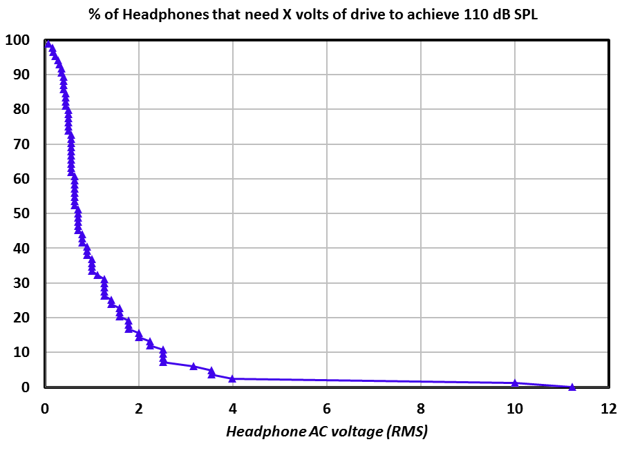

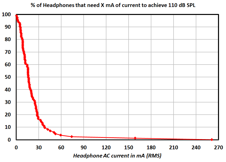

Agreed, its unlikely the headphone amps are clipping unless they are really crappy. However, the load impedance range of headphones themselves is all over the place, ranging from as low as 16 ohms to perhaps 600 ohms. Some may not be able to supply the current for low-Z phones. Others may have poor damping factor (ill-defined for headphones) and may interact with the frequency-dependent impedance of lower-impedance headphones.
Bob
The most comprehensive work I've ever seen on Headphone characterization is this list:
Headphone List - Google Sheets
Don't know who the author is but the link was given to me around 3 years ago, so it may not include the latest models. The list includes circa 500 headphone brands and models, their impedance and the required power/current/voltage to achieve 90/100/105/110/115 dB SPL, its the product of a massive ammount of work and research and its been a real eye opener for me when designing headphone amps.

Mark is this correct? It seems to indicate that 100% of the headphones need 0V or 0mA.
Jan
Yes.
100% of the headphones need 0.0V or more, to achieve 110dB SPL
90% of the headphones need 0.4V or more, to achieve 110dB SPL ... and 10% of them don't
80% of the headphones need 0.5V or more, to achieve 110dB SPL ... and 20% of them don't
70% of the headphones need 0.7V or more, to achieve 110dB SPL ... and 30% of them don't
Similarly,
100% of the headphones need 0mA or more, to achieve 110dB SPL
90% of the headphones need 5mA or more, to achieve 110dB SPL
80% of the headphones need 10mA or more, to achieve 110dB SPL
They are plots of the cumulative distribution.
