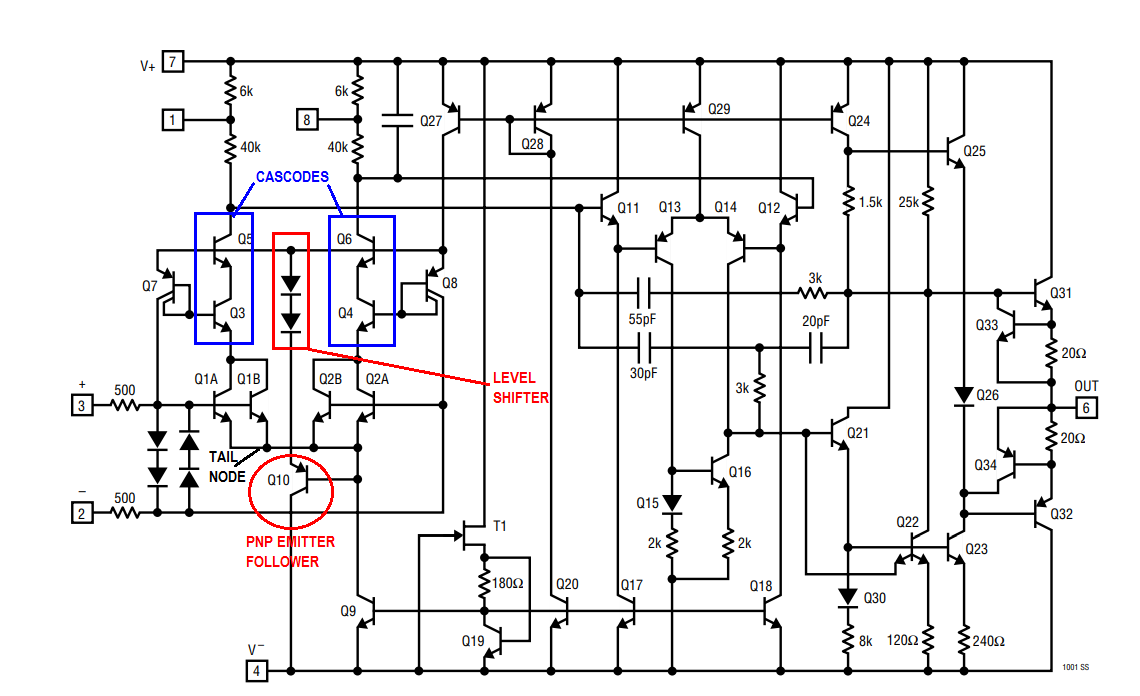

Just like the LT1001 "precision" opamp shown below

The driven cascode is really an archaic circuit from the days where transistors were expensive. Nowadays, the circuit that Mark shows is much superior. All precision op-amps pretty much use a similar scheme.
To be more precise, the scheme used in the LT0001 was abandoned many years ago. Q3 and Q4 are actually not cascodes, they are current sampling transistors that are used to cancel the base current of the input transistors Q1 and Q2. Q5 and Q6 actually both serve as a cascode and equalizes the VCE of Q1/Q2 and Q3/Q4. The problem of this scheme though is headroom, it eats a VBE worth.
Nowadays you just cascode once (do away with Q3/4, Q7/8) and inject 2 laser trimmed currents into the bases of Q1 and Q2 to achieve perfect cancellation.

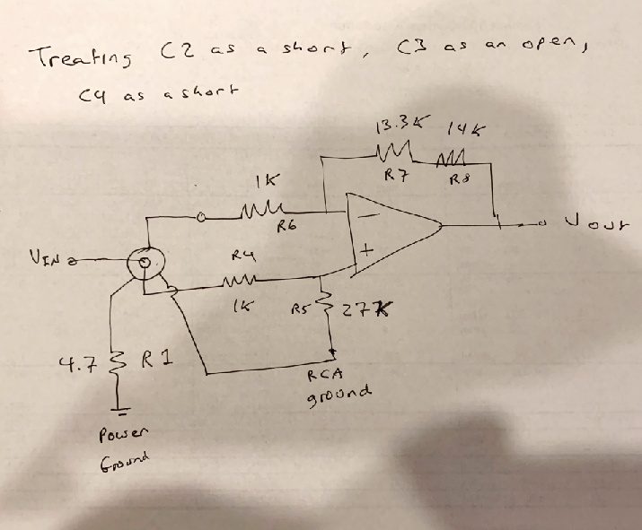

Hi Jerome,
I am completely fine with posting a scan of a page from my book. It helps everyone understand the post, especially those who don't have a copy of my book.
The quasi-differential input can be thought of as follows. Consider the classic single op-amp differential amplifier with four equal resistors; R1 to the negative input, R2 to the positive input, R3 from output to negative input; R4 from positive input to ground.
Note that R2 merely provides the overall positive signal input to the op amp positive input through some attenuation.
Now think of the core of the power amplifier as an op amp. The main feedback resistor corresponds to R3 and the feedback shunt resistor corresponds to R1. The series input resistance corresponds to R2 and the subsequent shunt resistance corresponds to R4. We have an approximation of the classic single op amp differential amplifier, in which "R1", the inverting input, is connected to the shield of the amplifier input jack.
The resistors are not all equal, as the gain is set to be about 28, as determined by the ratio of "R3" to "R1". Moreover, the actual values of "R2" and "R4" need not be the same as "R3" and "R1" as long as their ratio is appropriate for differential amplifier operation with some common mode rejection. The common mode rejection of this arrangement is, of course, degraded by the source impedance of the preamplifier.
Bob

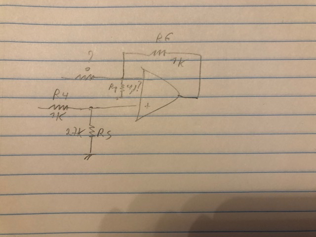

Hi Bob,
I don't really "see" the differential output amplifier. Is this schematic correct?

Hi Bob,
See the attached picture...
