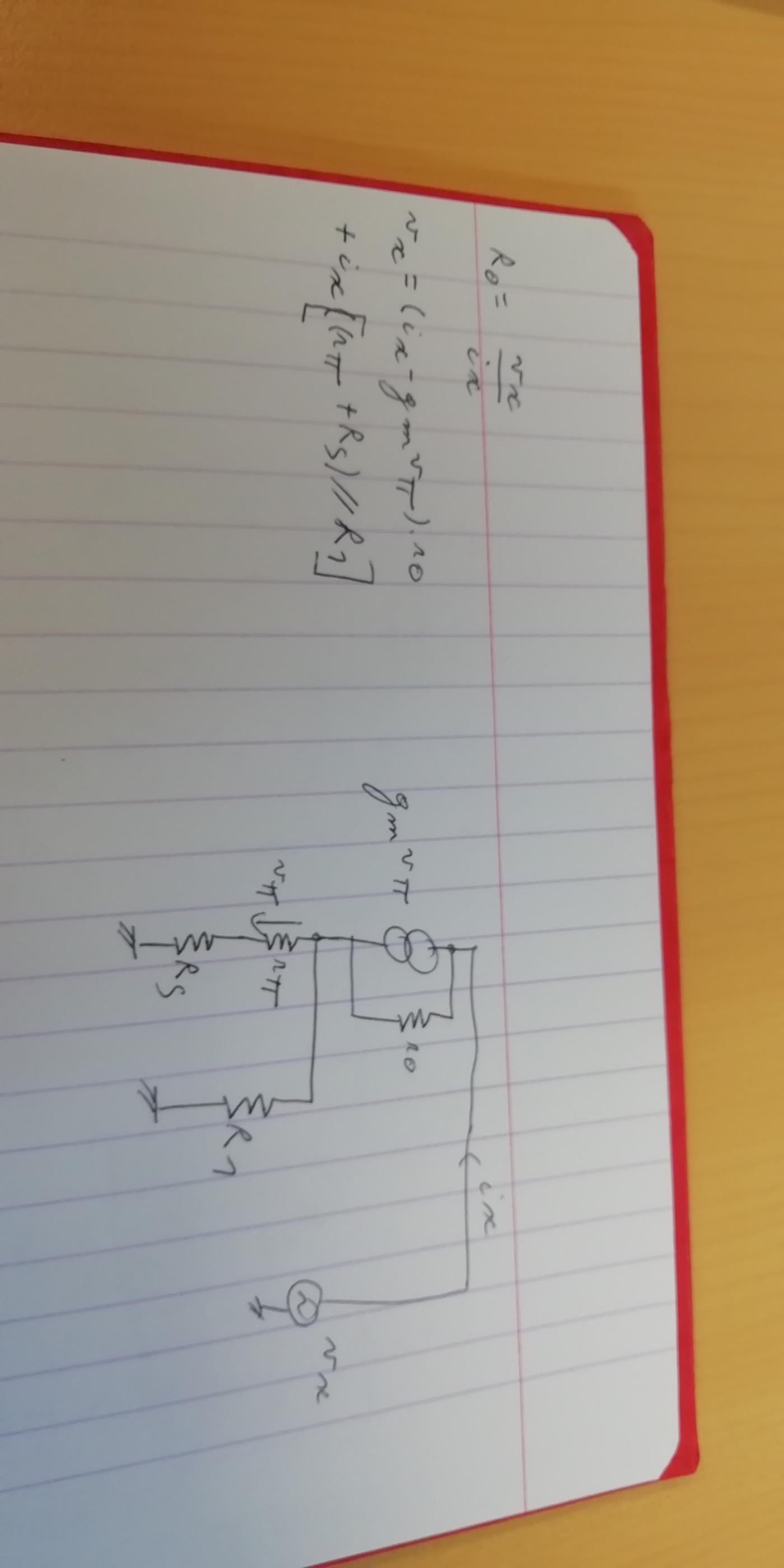

Small signal analysis. Rout is the impedance looking into the collector of Q1.
I know about that is the impedance looking into collector, could you developp, because my reasoning doesn't seem correct?
You are on the right track... just finish solving the 2nd equation...
v_pi = - r_pi*(R1 / (r_pi + Rs)*i_x)
Replacing v_pi into your 2nd equation, all the terms on the RHS are a function of i_x.
Now solve for ro = v_x / i_x as in your first equation, do some simplications like I showed a few posts back, and you are done. :happy1:
