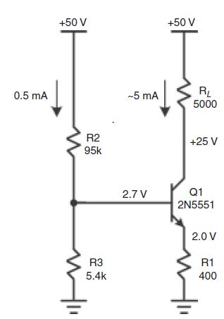

...., Why?
Variation of collector voltage leaks-back to the base and is not so much absorbed by the high-impedance base divider resistors.
Replace that divider with a 2.7V car battery(!), the external base pin will not be influenced by collector voltage. Change 95K+5.4K to 9.5K+540r, leak-back is much less. A lower useful limit is the 10-100 Ohms between external base pin and the internal base junction. For "constant" current we often use a few diodes at a few mA to get some dozens-Ohm impedance rather than 5k. Of course if this is a current multiplying mirror then that's different. (You might cite a page number so folks don't have to flip all the pages. Even Bob may not remember a specific figure after months of production.)

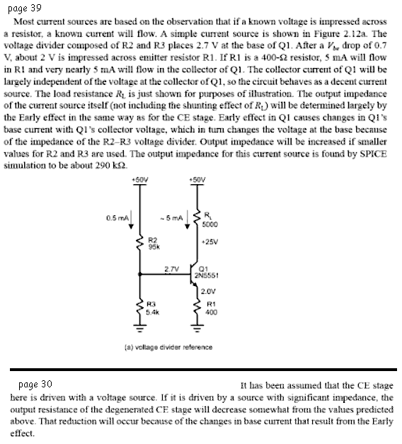

This is on page 39. Thank you for answer, but Early effect means that there is a variation of collector current when collector voltage increase, so the value of beta increase. There is a base width modulation. In my mind, base current stays the same, isn't it?
Hi Jerome, BJT basics 101.
When you have a BJT biased at a fixed IC, when you change VCE you will get an associated change in VBE and in IB. If VCE increases, VBE will also decrease and IB will also decrease.
Now, going back to original question. What does "output impedance will be increased if smaller values for R2 and R3 are used" mean?
Well if the collector voltage of Q1 goes up, with smaller values of R2 and R3 the IC of Q1 increases less, less Delta IC.
So, if the collector voltage of Q1 goes up, its VCE goes up and hence the IB decreases, which is the same as a delta IB being injected into the junction of R2 and R3. This current injection, raises the base voltage of Q1, which leads to an increase in IC. This voltage increase = Delta IB x (R2||R3) and Rout = Delta V at Q1's collector / Delta IC.
Now you can see that if R2||R3 is smaller, the raise in Q1's base voltage should be smaller due to a Delta IB (caused by a delta VCE) which in turn leads to a smaller Delta IC and hence a higher Rout.

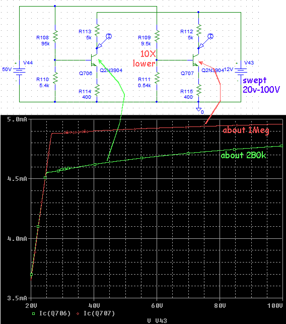

Or ask The Idiot. SPICE can give utterly wrong answers to 8 places, but the core models do good at all the main trends inside a BJT at reasonable biases.
I set up your base resistor values, and 1/10th values, and swept the collector voltage. This plots the collector dynamic impedance. I held a phone-bill to the screen to estimate the slant of the curves, to get values for collector impedance.
I am mildly surprised that 10:1 change of base impedance is only 3:1 change of collector impedance but it is too muggy here now to think.

These are all good and correct answers. I apologize for not having made this more clear in the book.

It's explained. At page 39, and back at page 30.

I am mildly shocked that my Idiot's "about 280k" was anticipated by Cordell's "about 290k", despite my different (and inappropriate) transistor. (It may only mean that mass-compiled models don't differ all that much from some default.)

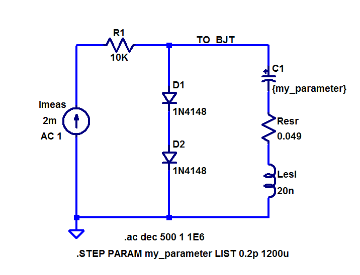

Coming back do the circuit in page 39, it is better to have R3 as forward diodes or a zener, such the new effective RS = R2||incremental resistance of diodes is low and you get higher Rout.

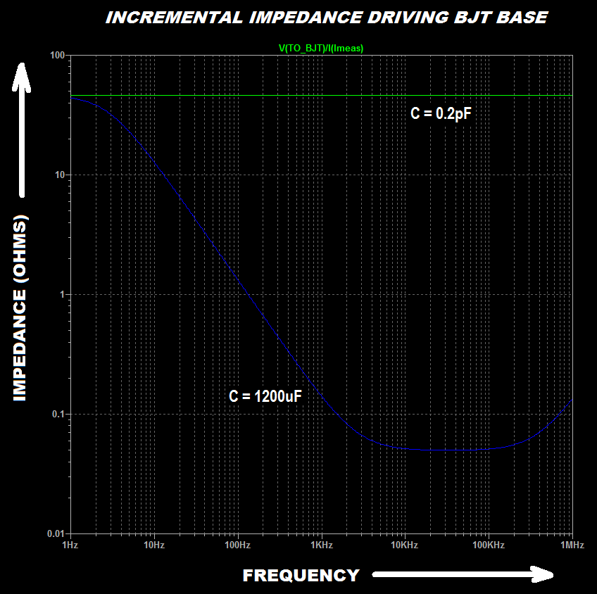

Might as well use a 6.3WVDC electrolytic capacitor to drop the impedance at the current source base even lower, at audio frequencies. If low is good then lower is better.
This 1200uF cap is only 13 mm tall and 3.5mm diameter. Its Equivalent Series Resistance is 0.049 ohms and DigiKey sells it for 41 cents (19 cents if you buy 100 of them).
LTSPICE simulation below: green trace is "no capacitance" (0.2pF in LTSPICE); blue trace is 1200uF. Impedance is lower (better) across the entire audio band. Not bad for $0.41.
By the way, you get this benefit whether the base bias scheme is a pair of resistors, a resistor and two diodes as shown here, or a resistor and a Zener diode.
