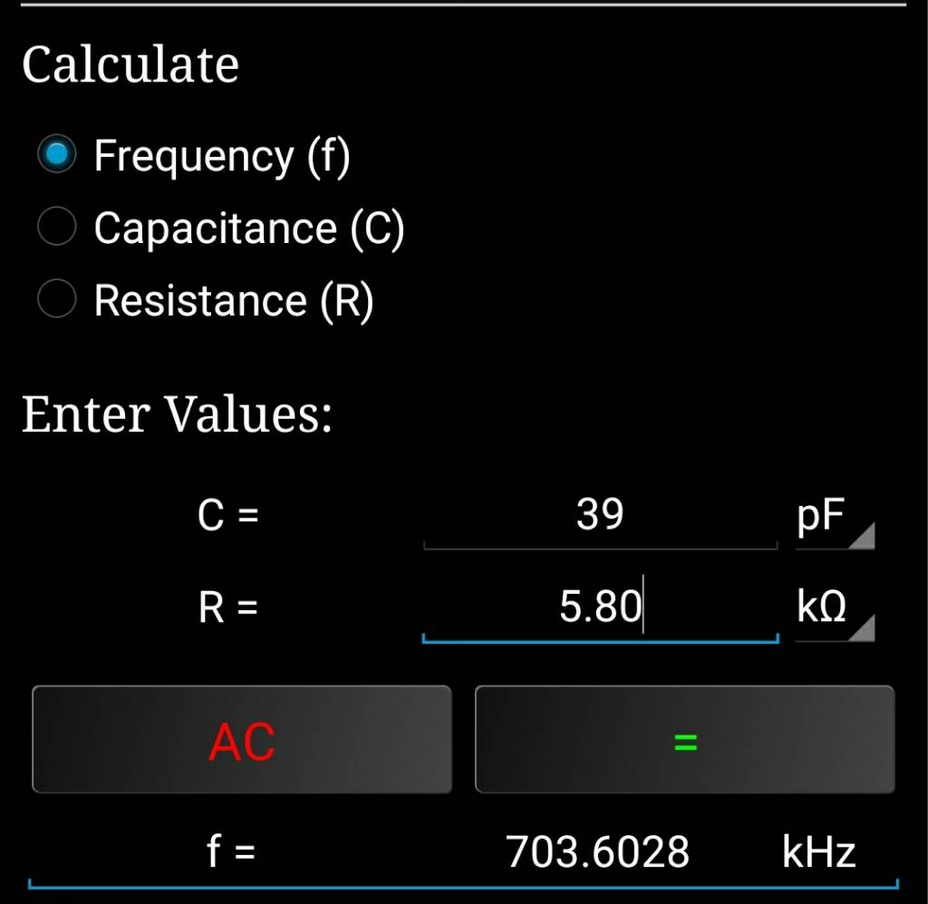

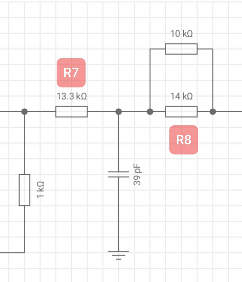

I have also made a sketch. Can you confirm what I have sketched is correct.
Hi Stuart,
The net resistance seen by the 39 pF capacitor is the parallel combination of the resistances on the branches to the left and right of the node. On the left is 13.3k + 1k (14.3k). On the right is the parallel combination of 14.3k and 10k (5.83k). The parallel combination of 14.3k and 5.83k is 4.14k. This resistance combined with 39 pF creates a pole at 985 kHz.
Bob

Perfect, this now makes sense and I can apply it to other situations.
Thanks Bob.

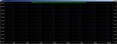

I have been working though the stability evaluation testing a bit more on the simulator this week and had two more question for you.
The book says "Shunt R8 with a 10K resistor to increase loop gain by 3 dB.
Shunt the junction of R7 and R8 to ground with a 39-pF capacitor.
This introduces a pole and 3 dB of loss at 1 MHz. Existing phase margin has now been reduced by 45 degrees. If the amplifier does not oscillate,
it has at least 45 degrees of phase margin. Measure the amount of peaking in the frequency response. Peaking of 3dB would suggest a phase margin of 45 degrees."
Q1. Should I run the square wave response before I connect the
39-pf capacitor ? ( Gain margin will be reduced by 3dB at this stage)
Q2. The book says to measure the amount of peaking in the frequency response. Peaking of 3dB would suggest a phase margin of 45 degrees.
Am I measuring this on the square frequency response? If not where is the peaking of 3dB measured ?

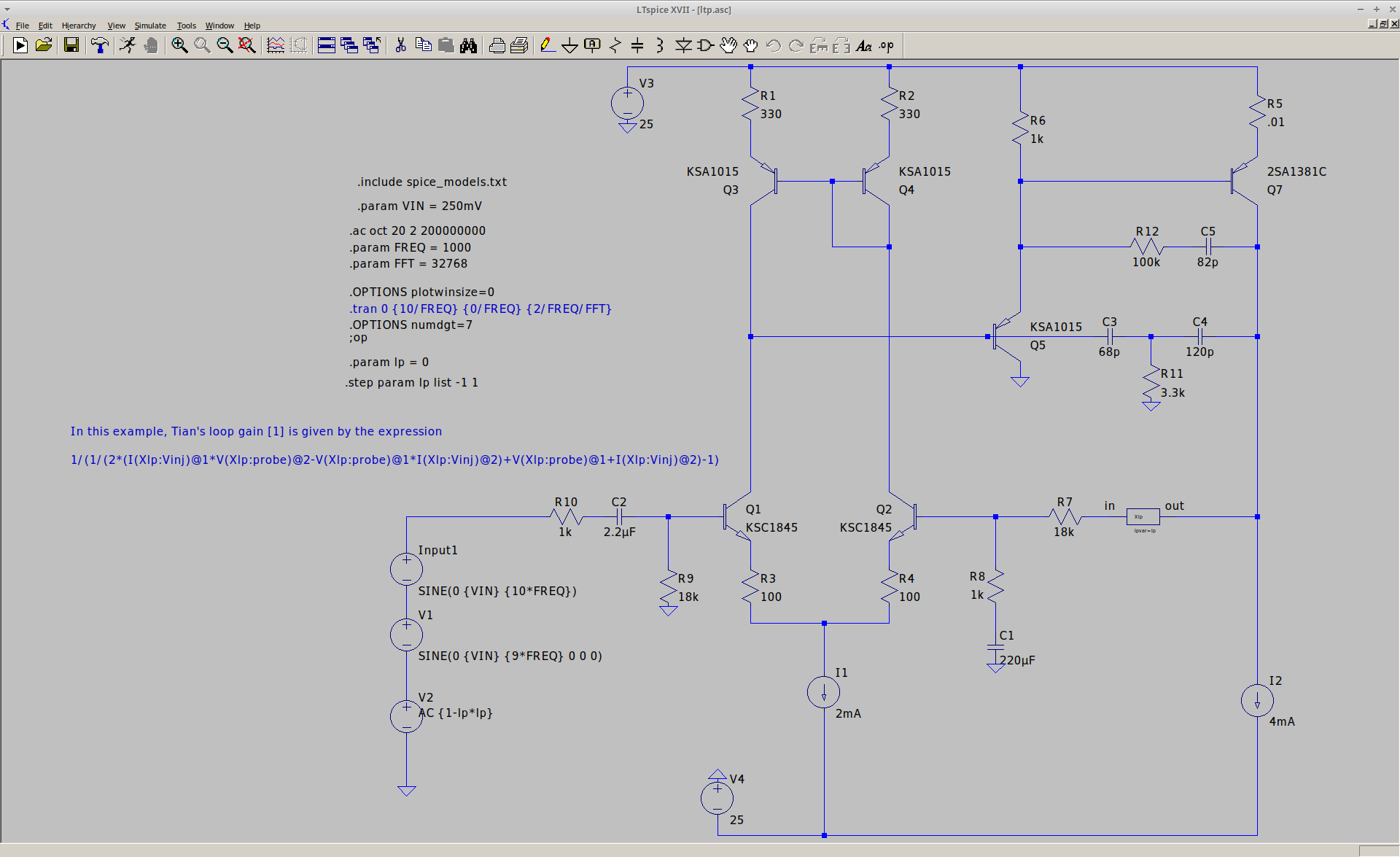

I found a nice way to tame TPC's audio-band loopgain peak, see attached.
With this approach, we don't have to degenerate the VAS if we don't want to, and we don't have to increase load on the IPS. The caveats are, this only works with a buffered VAS and it could reduce slew rate.

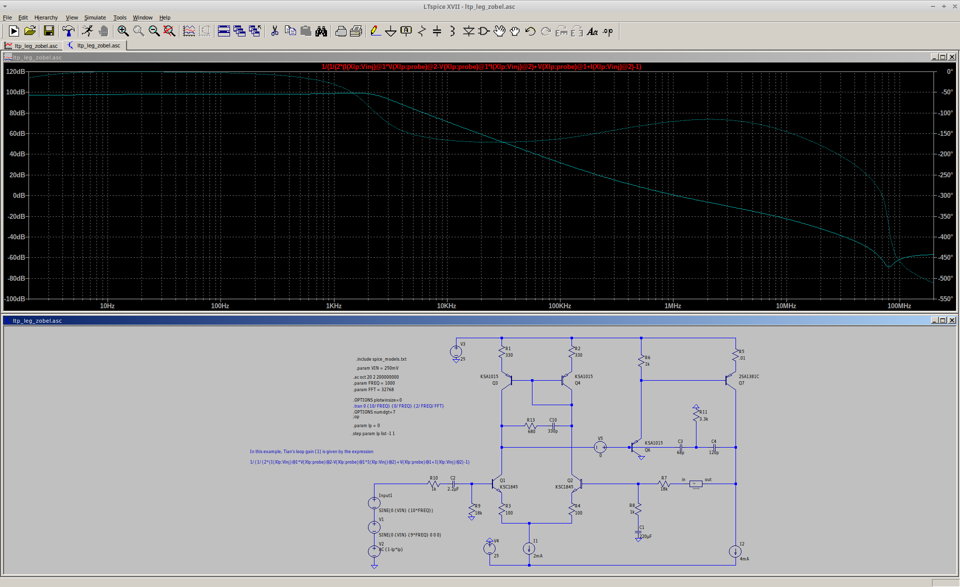

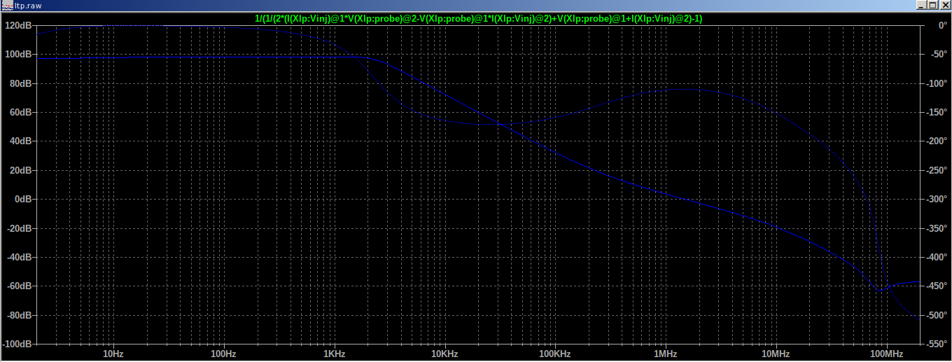

Here's what I suspect is going on.
The TPC peak happens when the TPC caps "kick in" around 2kHz and pivot the VAS phase from 0 to -180 degrees all at once. At some frequency there's a deep null, where the 0 degree and -180 degree components cancel and the input needed for a given VAS output approaches zero. So we get that asymptote in the loop gain.
This fix works by having C5 add some phase lag starting at LF. When TPC takes over around 2kHz, VAS phase pivots from about -30 degrees to -180 degrees avoiding the deep null. Above 2kHz C5 has little effect, and R12 minimizes its effect at HF.

It's possible that the TPC topology I mentioned above is equivalent to bridged-T.
I've had two doubts about bridged-T:
1) If you place the loopgain probe such that the traditional TPC network pick-off point and the bridge cap pick-off point are on opposite sides of the probe, there's still a peak.
2) It asks the IPS to drive a cap with the full output voltage swing on the other side, and it's the distorted VAS output voltage at that.
It turns out that (1) is true of the alternate topology as well, see attached.
To some extent, (2) is true of the alternate topology too. The IPS must drive C5. The VAS buffer hFE helps, yet C5 is >10x larger than a typical "bridged T" cap which partly cancels that benefit.
They're so similar, let's call this variant a "buffered bridge."

A Darlington VAS has two poles and if they are too close together the VAS becomes an unstable feedback loop all by itself. The two transistors should be different speeds so that one will dominate and stabilize the local loop. The pull down resistor between the two transistors needs to be small enough to allow a decent slew rate but too small brings the second pole up near the first causing instability.
I don't like to see the first transistor without a collector resistor but the resistor needs a decoupling cap to avoid aggravating the local loop instability.
C5/R12 looks good in charts, but is not very useful because ultimately you are conducting distortion into the preceding stages. This means you are both increasing distortion and reducing loop gain at the same time.
Furthermore you are loading the VAS which increases it's own contribution to distortion.
If you have a good reason to need to get rid of the resonance (it MIGHT, but probably won't, matter during overload durations longer than it's wavelength), one solution is a 1pF cap bypassing both TPC capacitors, or a 10nF cap in series with the 3.3k resistor. These do not needlessly load the VAS but perform the same function.
The usefulness of the resonance as a loop gain boost is arguable as, like any resonance, it has an associated group delay and very narrow frequency range where it's effective. On the other hand, it's effect is never to increase distortion, just to reduce distortion in a limited capacity.
So to decide what to do about it, you really need to investigate whether it matters in the context of listening to music. Alas, LTspice cannot simulate humans...
