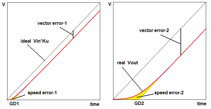

Filter processing softens the effect of speed distortion, but does not eliminate it. If the amplifier had enough bandwidth of 30 kHz with an output voltage slew rate of 5 V / μs, then today amplifiers with a bandwidth of 5 MHz and higher would not be designed.
Personally, I agree with Kyrill Hammer and with my tests I try to show that he is right, that's all.
Well I started to drag myself past the marketing stuff in that Hammer piece until I hit his basic misunderstanding of feedback and time delay, then I gave up.
But let's stick to your graphs and what they mean. Interested in your reply to my questions.

I looked at the article posted. The ‘speed’ distortion the loop making a rapid adjustment at either frequency or amplitude or a combo of both occurs.
You can see this type behavior by comparing a fast rise time square wave signal with a slower one and looking at the diff amp output.
To minimize this, limit the BW and a obviously the compensation design has to be spot on.
I’m not a mathematical sort of guy, but if you take a 20 kHz signal and change its amplitude instantaneously as the OP has done in the test, you are going to get signal artifacts >> than the stimulus signals themselves.
The amplifier is behaving normally.
Jan: "Also, to judge the performance for audio, the input signal should first be run through an input low pass filter at, say, 30kHz or so."
Jan, I first of all evaluate the parameters of amplifiers, in particular such a speed parameter as speed distortion, and I evaluate the sound quality with my ears. As for the application of a filter for signal processing, I think it would be foolish to measure the slew rate of the output voltage using a meander of a processed low-pass filter with a cutoff frequency of 20 kHz, like here.
I think there is no need to explain which amplifier has more high-speed distortion

The issue is that, as pointed out above by others, if you have an instantaneously changing signal you introduce very high frequencies. In the limit, if your signal changes infinitely last, that signal will have an infinite bandwidth.
It is nonsense to test an audio amplifier with an infinite bandwidth signal and then think you can give a meaningful comment on how they will perform as an audio amplifier.
The reason to send the input signal through an input low pass is exactly to let you do meaningful comments on how the amplifier works for audio. Is that not what you want?

All music signals are bandwidth limited. Microphones, preamplifiers and recording equipment all have finite bandwidth.
If you have a 20 kHz sine wave at say and you instantaneously increase/decrease its output (anywhere on the waveform) you will introduce HF components well above the stimulus frequency.
So, indeed this type of waveform does test for amplifier behavior in the presence of HF content, and it should behave under these conditions - easy to accomplish through good compensation design and with band limiting. However, you don’t get instantaneous changes in music signals precisely because that are BW limited.
I don’t think this has anything to do with DAC/ADC either because you’re supposed to BW limit the input signal to ensure good behavior.
