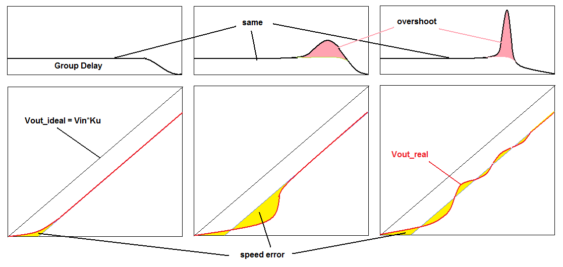

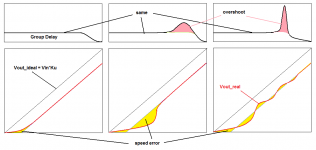

There is no ideal in real output signal (black line). The task of the developer is to make such an amplifier so that the real output voltage is as close as possible to the ideal

chip_mk: “Do you consider this speed distortion to be the major determining factor of amplifier's perceived quality? Can you explain psychoacoustics of it? Any reference (beside C. Hammer) to a research backing it?”
There are publications of studies by Walter Jung where, based on the results of studies of more than 100 operational amplifiers, he concludes that op amps with higher slew rates sound better. Velocity distortion is related to other velocity parameters of amplifiers, as well as group delay time and its behavior far beyond the audio band.

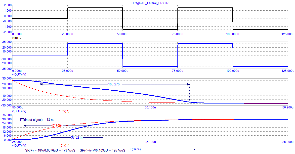

The slew rate specification of an amplifier is the maximal slew-rate that the output of the amplifier is capable of. In usual conditions, the signal at the output of an amplifier has as a slew-rate of less than 1 V/µs. An amplifier having a two long tale pairs input stage proposed by Giovanni Stochino's amplifier had a 300 V/µs slew rate.
Of course I know it. It is not the slew rate of the audio signal.
But you can compare by yourself the sound different if you add low pass filter at input amplifier about 15kHz and limit the full power bandwidth (slew rate) of the amplifier about 15kHz.
If you know the sound different then you can compare amplifier with full power bandwidth about 200kHz and 1MHz with low pass filter in input amplifier about 500kHz.
Jan didden: “A real engineer would only do this with a low pass between the source and the amp or in the amp circuit. A real engineer would understand what he is doing“.
The rise time of the pulse signal for the output voltage slew rate test should be at least 3 times shorter than the rise time of the output voltage of the amplifier under test.
I used a 5 MHz LPF with a 48 ns rise time
For information: When testing high-speed op amps, use pulses with a rise time of less than 1 ns
