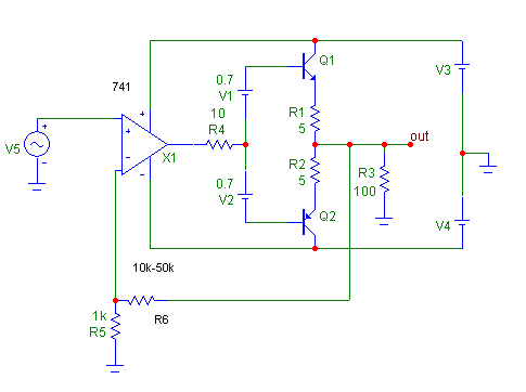

EF AB in 741 NFB at 10kHz
I got this, at first circuit:

lumanauw said:
Maybe those irritating high order harmonics from x-over distortion would appear if the state is "underbiased". In this case it would be interesting, adding more NFB will make the result better or worse?
Class AB output stages ALWAYS have high order harmonics. Their level is lowest for optimal bias current, and it is quite difficult to keep this optimal value, as very small change of this current quickly changes level of harmonics.
Both overbiasing and underbiasing lead to increase of level of harmonics. Yes, for heavily underbiased AB stage the amplitude of harmonics is not only high but also almost constant even for very high harmonics.
But overbiasing creates high order harmonics of high amplitude as well. Their amplitude (of n-th) depends on actual bias current (and signal amplitude as well - as long as you keep class A it is fine. Helas when you get over class A amplitude limit!)
Heavy use of negative feedback promotes UNDERBIASING, not OVERBIASING. After all, if it measures OK, why add extra heat, etc? Wake up and smell the coffee!:smash:
Think of a small hill that you have created by G(m) doubling, rather than the open manhole cover (real xover distortion) and adding power to your automobile. You might note with pride that your 250 HP auto didn't even notice the hill, BUT just wait for what happens when you drive over that open manhole in the street. :xeye:
NO PMA, you do NOT have a really problem with overbiasing, here. You have the choice of the WRONG VALUE of emitter resistor. Run the sim again with .15 ohms like I use. Check it out! Poor design is poor design. Bob did this, on purpose to see what happens, but it is UNDERBIASING that will show the potential problems of feedback.
If I get you right PMA, feedback fixes just about everything, so why bother with anything else?
