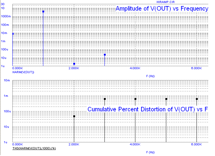

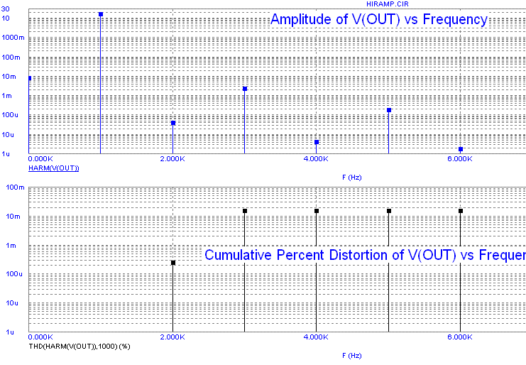

PMA said:
Colleagues fellowdesigners,
I would like to share with you measurements made on my real-life power amplifier. High biased, non-global NFB, local NFB CFP diamond buffer based output stage, biased at 1A.
the 1st image is for 1W/8ohm, pure class A
http://web.telecom.cz/macura/pma1_1w_8o.gif
the 2nd is for 17W/8ohm, just after transition to AB
http://web.telecom.cz/macura/pma1_17w_8o.gif
Not bad results, are they?
P.S. Noise raise at higher freq. is converter noise shaping, not amplifier noise.

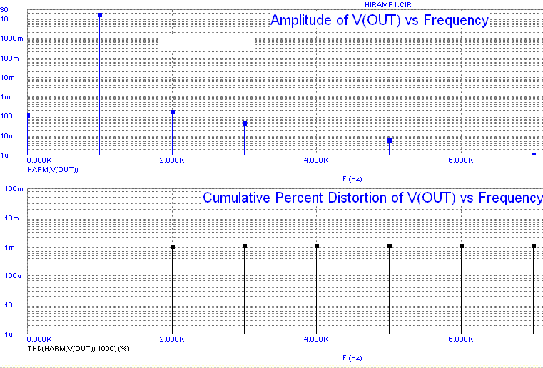

Yesterday I showed my 5 years old results on a real-life amplifier. I have just played with this circuit in MC8 and I am quite impressed by the similarity of measured and simulated results. Please see simulated result for 1W and compare with the measured one:
