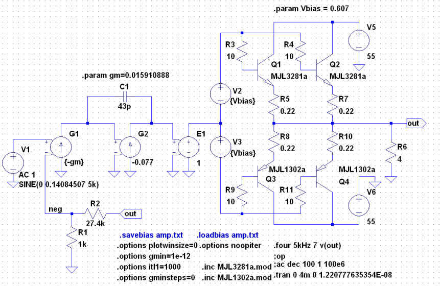

Pavel made this request, so I did a sim mostly as described in this post. The exception is that I used a 4 Ohm load instead of 6 Ohms to get a higher simulated distortion while still using "best design practice" (optimum bias) in the output stage. The schematic of the simulated circuit is shown below.
There are 2+2 BJTs in the output stage, with 0.22 Ohm resistors. Bias is adjusted to Self's optimum of 107 mA per device with this RE value. Base resistors of 10 Ohm are present (same as Leach amp) and supplies are +/- 55V (about the same as Leach).
The open-loop amplifier is an idealized integrator with variable time constant and zero output impedance. That time constant is varied to adjust the unity loop gain frequency as described in the post I referenced above. This was done by changing input stage transconductance.
The output signal was set to 4V peak, corresponding to 1A peak. Crossover distortion decreases as the output voltage goes above and below this value. THD of the output stage by itself was just slightly less than 0.1 percent at this output level without feedback.
The output stage distortion was simulated by itself (zero feedback case), as it's not possible to have zero feedback with an integrator in the feedback loop. All other data points had the integrator in the loop.

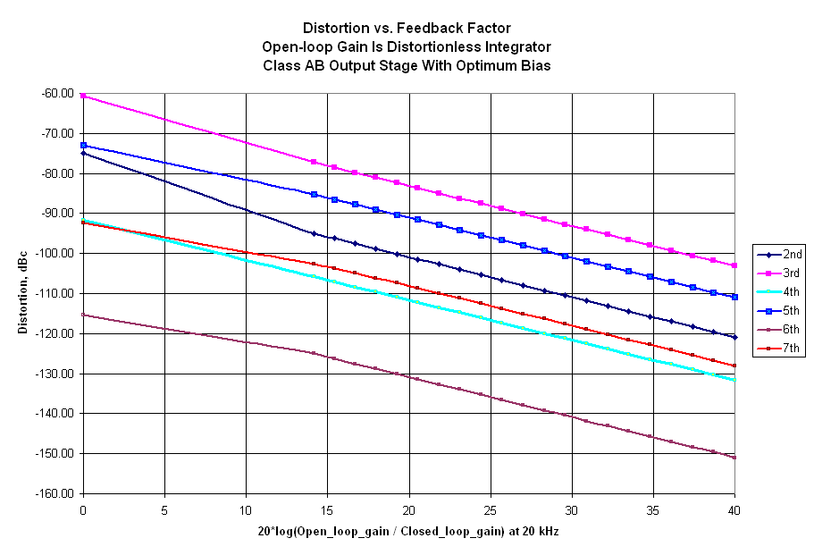

Here is the plot of distortion vs. feedback. A little explanation is in order here.
The x-axis data is feedback factor in dB, or 20*log(|(1+AB|). So the zero dB point is with no feedback. The frequency at which the feedback factor is evaluated is 20 kHz, to correspond to the convention Self uses to distinguish high-feedback and low-feedback designs. There is a jump at the lower feedback values, where the first feedback factor is 0 dB (no feedback at all), and the second is about 14 dB. This 14 dB number corresponds to an amp with heavy overcompensation such that its closed-loop bandwidth without input filter would be only 100 kHz. The maximum feedback factor of 40 dB at 20 kHz corresponds to an aggressive high-feedback design such as Bob's EC amp, with a closed-loop bandwidth without input filter of about 2 MHz.
Because the x-axis data jumps from 0 dB to 14 dB, I've put markers on the plot lines to show where the simulated data was actually taken. There were 21 simulation points.
One thing that can be seen is that when you go from zero feedback to very low feedback, the relative harmonic levels of the 7th and 4th "trade places" due to the feedback being able to reduce lower-order harmonics more than the higher-order ones. But as you go from low feedback to high feedback, the relative levels are approximately preserved, and they are all reduced in level as feedback increases. There is no evidence of feedback increasing distortion as it is increased.
Edit: Oops, I forgot to mention that the distortion was simulated at 5 kHz.
I guess that increasing distortion with feedback increased is just a myth.
Also, we can see that it makes no sense to use very small amount of feedback.
The increasing distortion with increasing feedback does seem to occur when the open-loop distortion is dominated by the second harmonic. One of Bob's earlier sims in this thread seems to verify Baxandall's results in that regard. But that seems to be a very special case. I think this special case result has been generalized incorrectly, most notably by Cheever. Then people have taken Cheever's results and waved them around in various online forums, etc. Then it spreads.

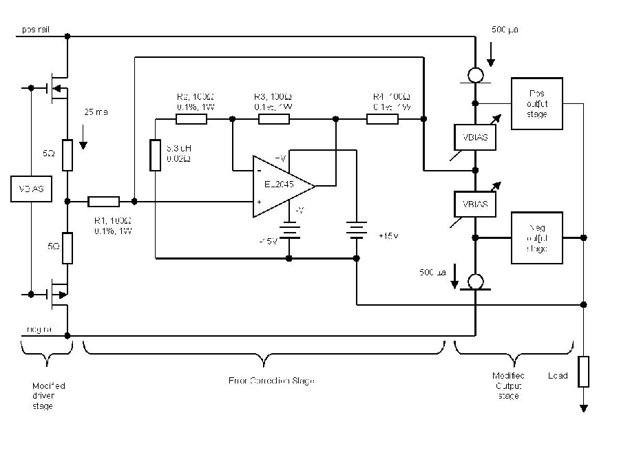

I don't understand much of this, but EC seems different than feedback. It has additional "energy" to fix things, that is not coming from the previous stage (it has it's own energy source).
In this example, an opamp (It only compares 1:1, not making any voltage gain) is powered +/-15V floating (bootstrapped) towards the output node. This way, opamp can give more positive or more negative signal than the previous stage can, just to fix the output stage only.

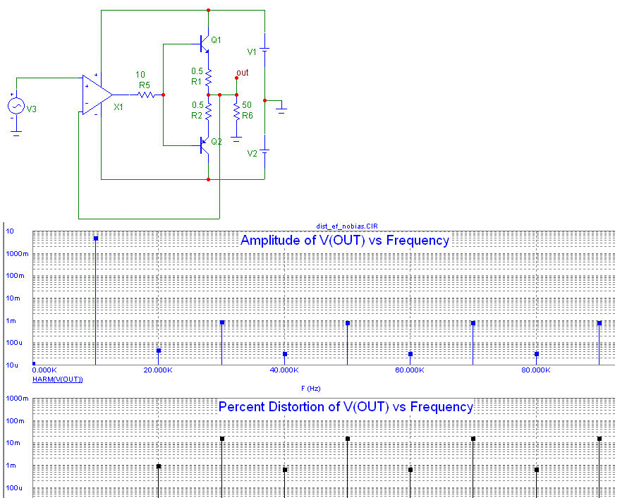

lumanauw said:
Feedback will not help for underbiased output stage.
Feedback reduces distortion even for underbiased output stage (less than optimal Iq). Of course it does not mean that feedback makes a good amplifier from that with underbiased output stage.
P.S.: here is the image showing that feedback reduces distortion even for no-bias output stage. Pure crossover distortion. OPA134.
